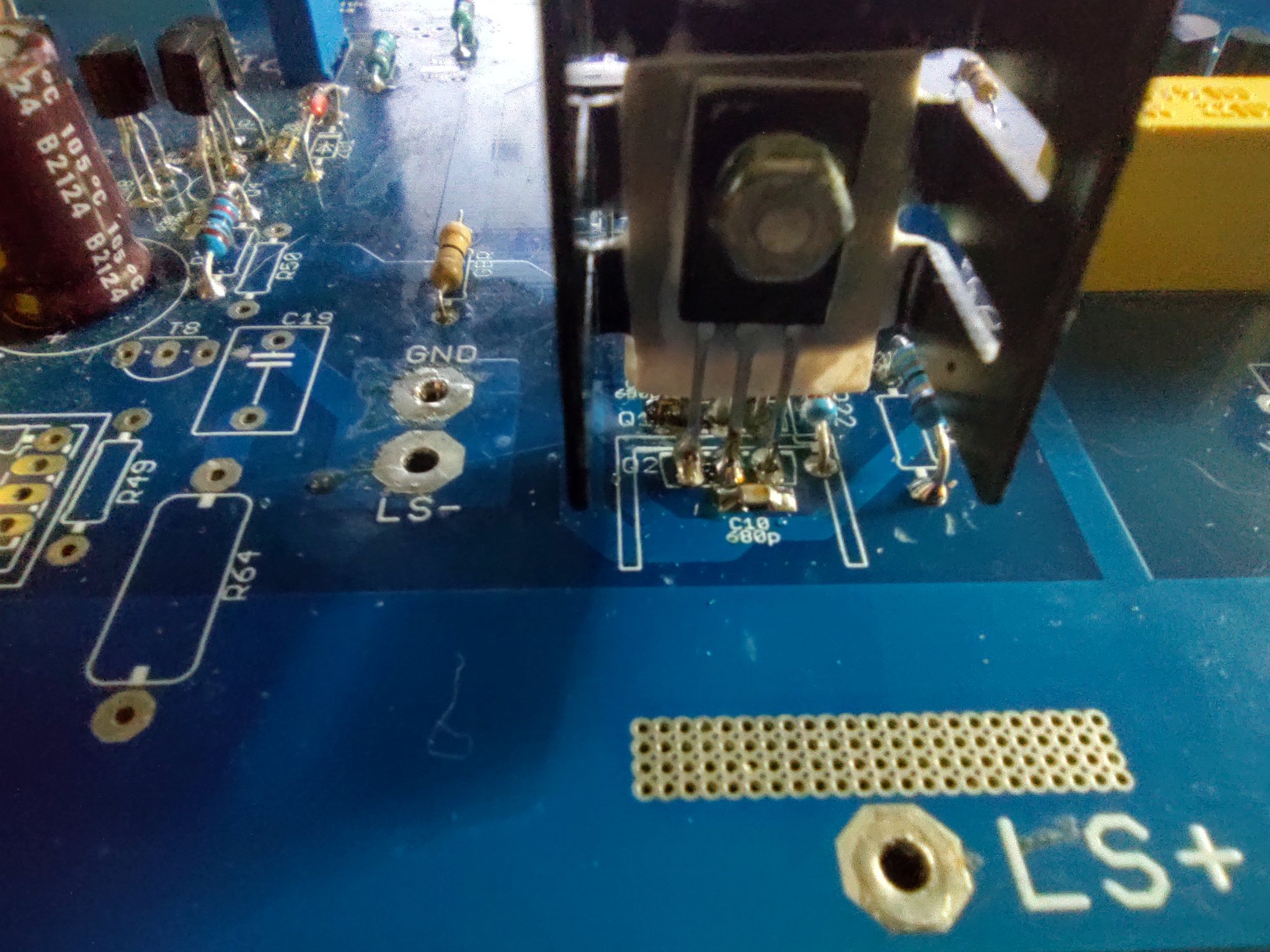

Mine was bullet proof, taking command of all my 92 dB and up speakers. Very stable, I killed mine through stupidity, not amps fault. Testing "repair I have attempted, some of the pads from Q1 and Q2 vaporized. A few more parts were burnt in this channel than the other one. figuring that out cost a few sets of Q1 and Q2, and I wore the pads out. The other channel fixed great, came right back. We will see.The thing is.... it seems like the only time this happens is when I plug into into the Maggies, which at 83 db/w are particularly mean.

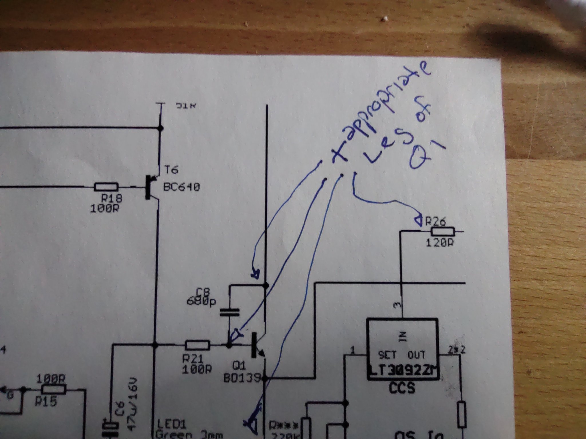

Q1 and Q2 - Q9 also?I'm planning to change these to MJE340/350 in future

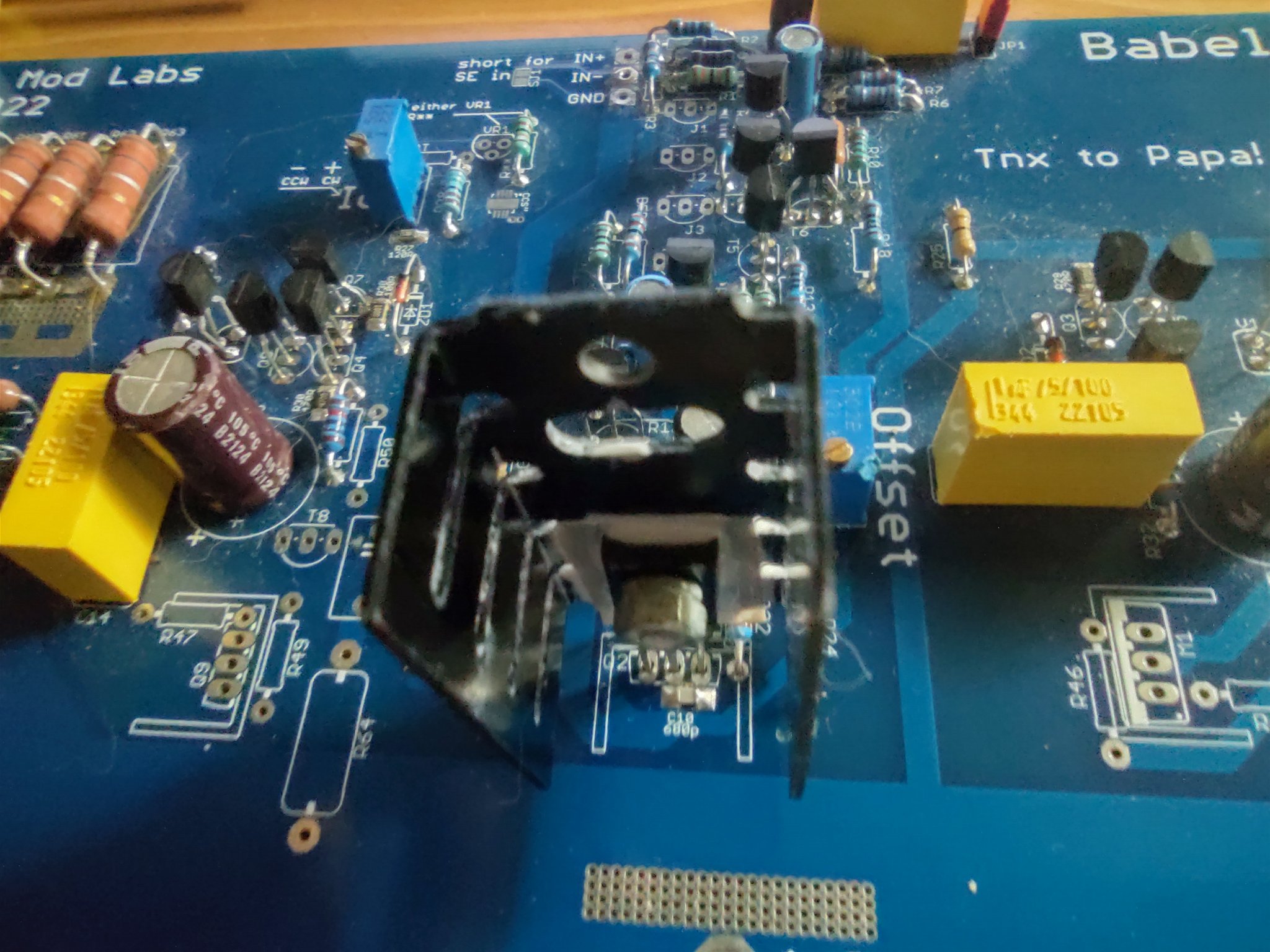

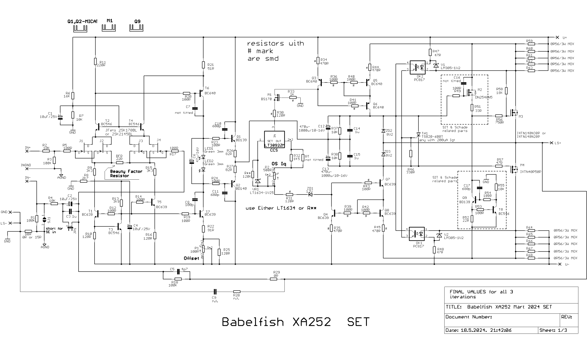

Repair went not bad, now to check continuity from each of the legs of Q1 and Q2 to where traces did exist and hopefully good to next connection.
I have noted on this pic of the schematic. If continuity, great, if not I left the legs long on back side for attaching some 22 gauge solid core for repair.
Most of the locations have at least one pad on one side or the other, a few have both, one has lost pads on both sides. I let a small amount of solder go down the leg into the leg hole. Once continuity is established, hook up the variac and bang it!

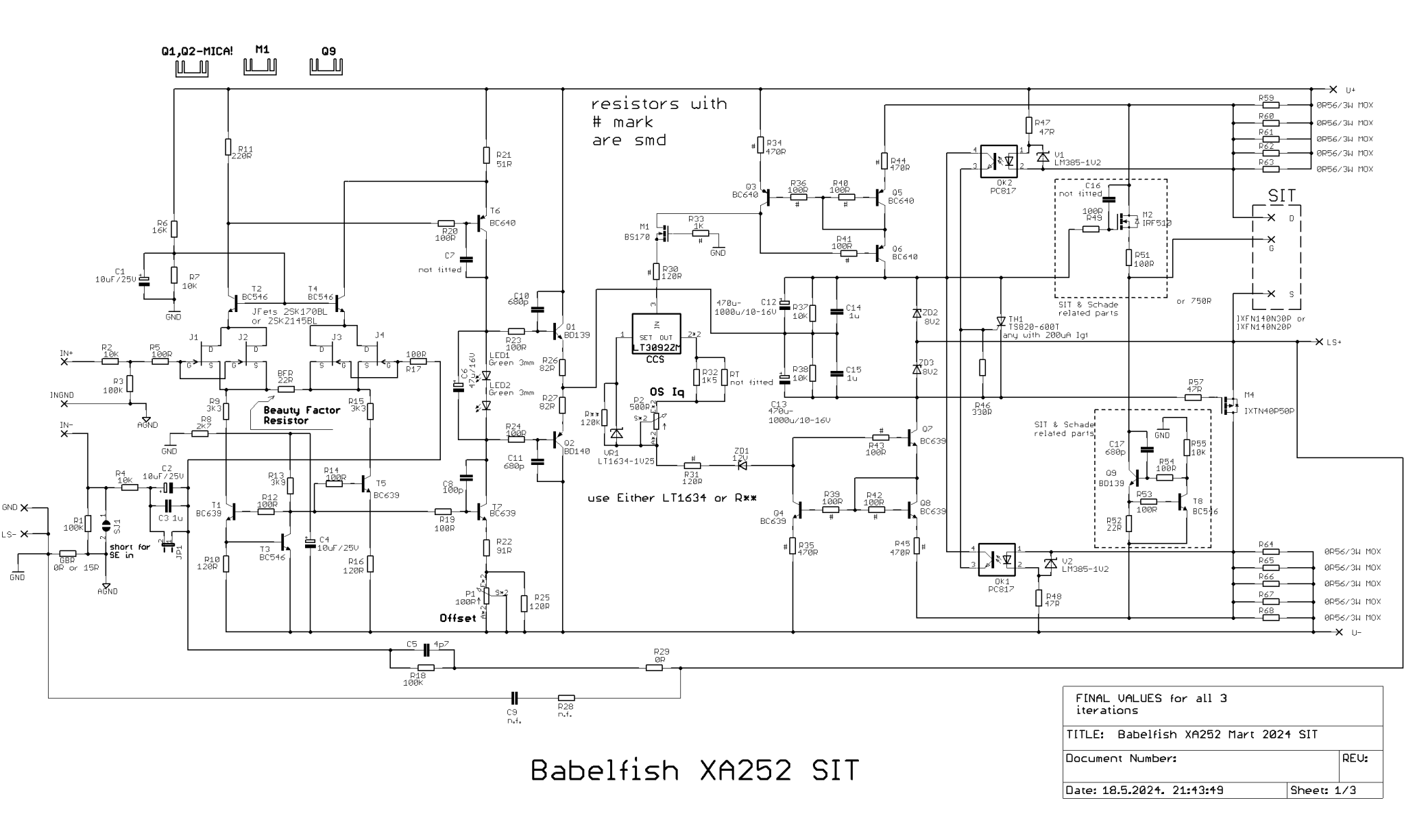

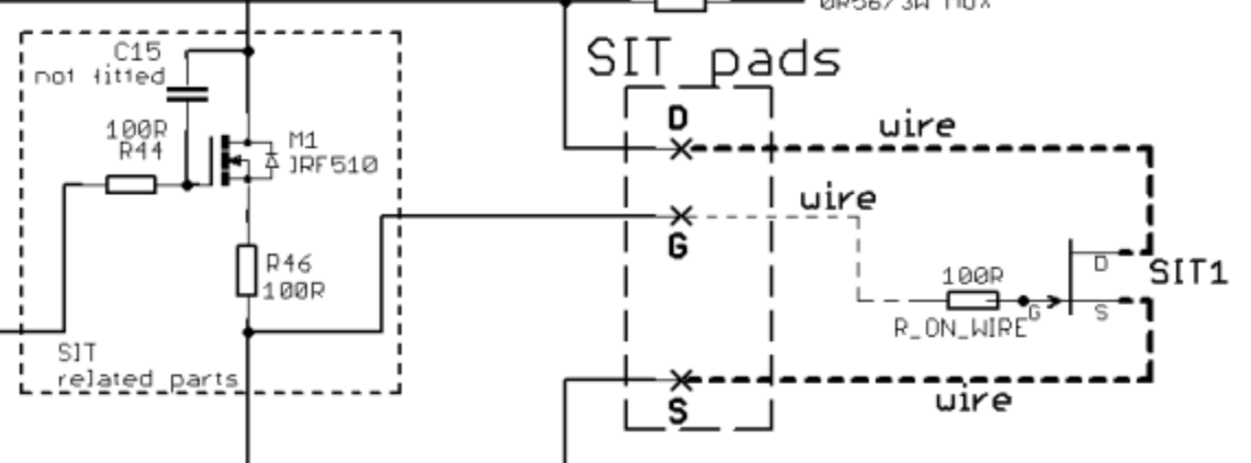

I am planning to convert XA252 SET to SIT version. Do I need to change R51 from 33R to 100R or I can keep the 33R? Do I also need to remove R58? R56 can be populated because SIT gate connection goes before that resistor? Then I need to change DN2540 to IRF510.
Anything else I need to know? I am using +-24V rails.

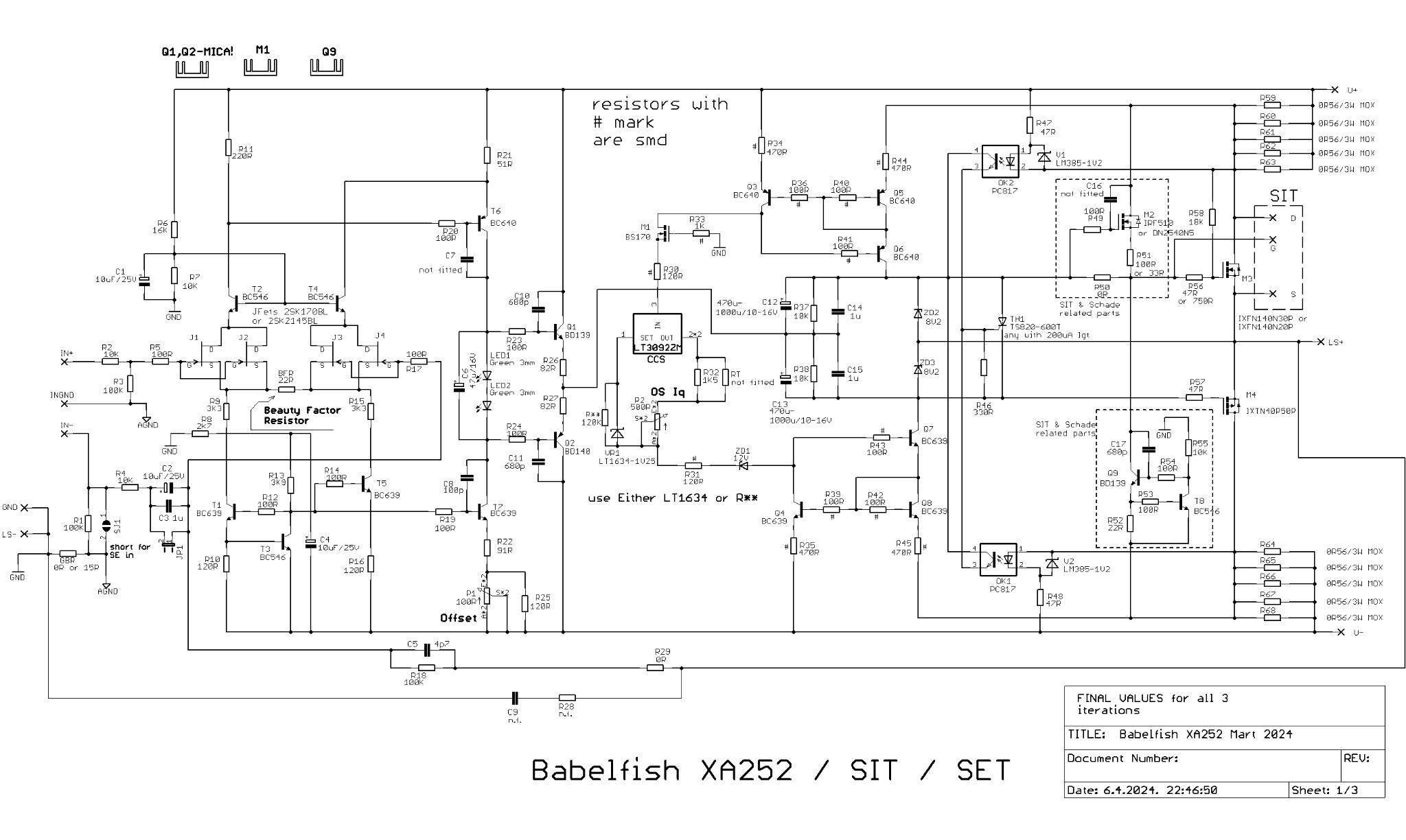

this is cumulative schematic, showing all parts on pcb
I believe I've sent you full set of files, just pull one with SIT in name, post here for confirmation
reminder - solder additional 47R resistors in parallel to both LM385, practically at pins 1,2 of optocouplers
24Vdc rails will not give you full shine, whatever iteration you're going to build
I soldered 100R.reminder - solder additional 47R resistors in parallel to both LM385, practically at pins 1,2 of optocouplers
I know. I do not have right now better donut.24Vdc rails will not give you full shine, whatever iteration you're going to build
Yes, questions remain the same. How to convert SET to SIT pulling out or changing minimal things. Do I need to change R51 from 33R to 100R or I can keep the 33R? Do I also need to remove R58? R56 can be populated because SIT gate connection goes before that resistor?I believe I've sent you full set of files, just pull one with SIT in name, post here for confirmation
SIT version schematic.
