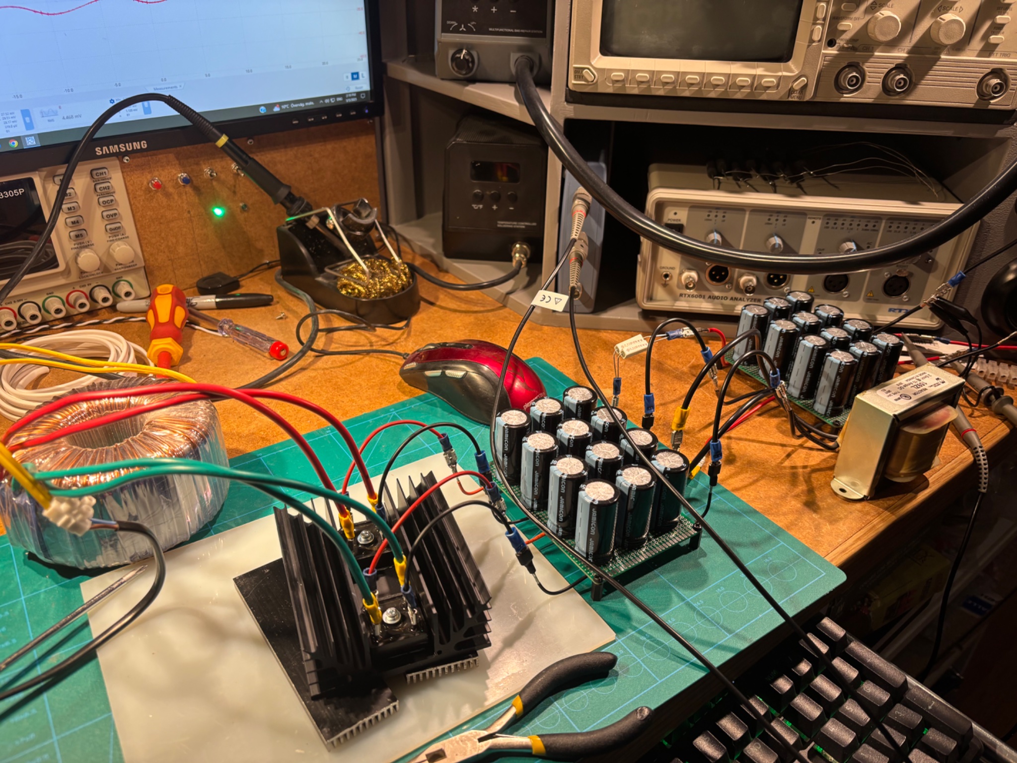

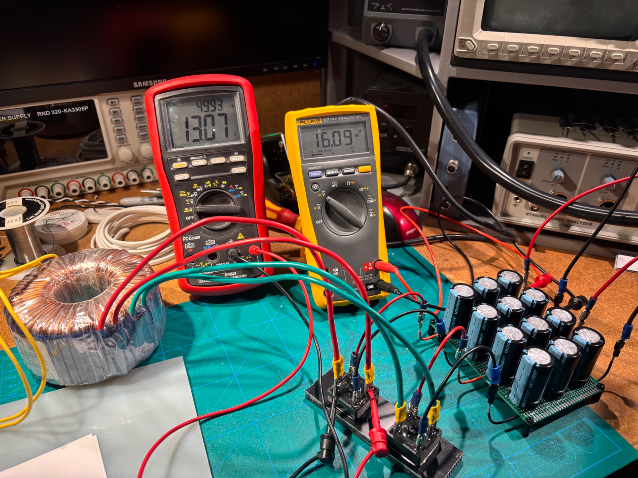

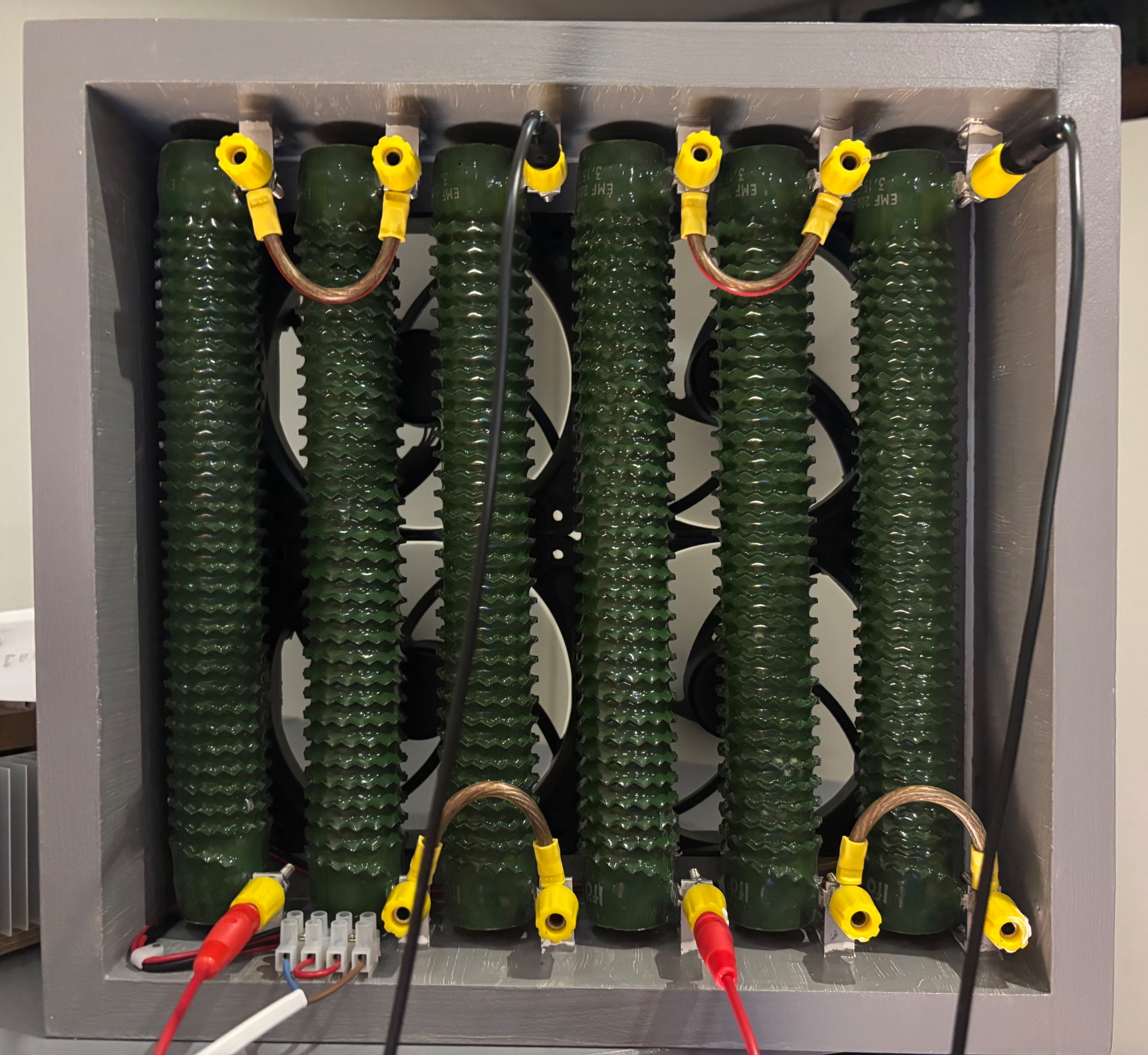

Making test of test rig. 2x12x200va booty donut, 3504 and 2x9,3 ohms load, abt 1,74 amps. Donut loves it. Would need 2 of those for an XA252. I have 8 so no worries

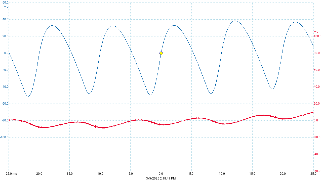

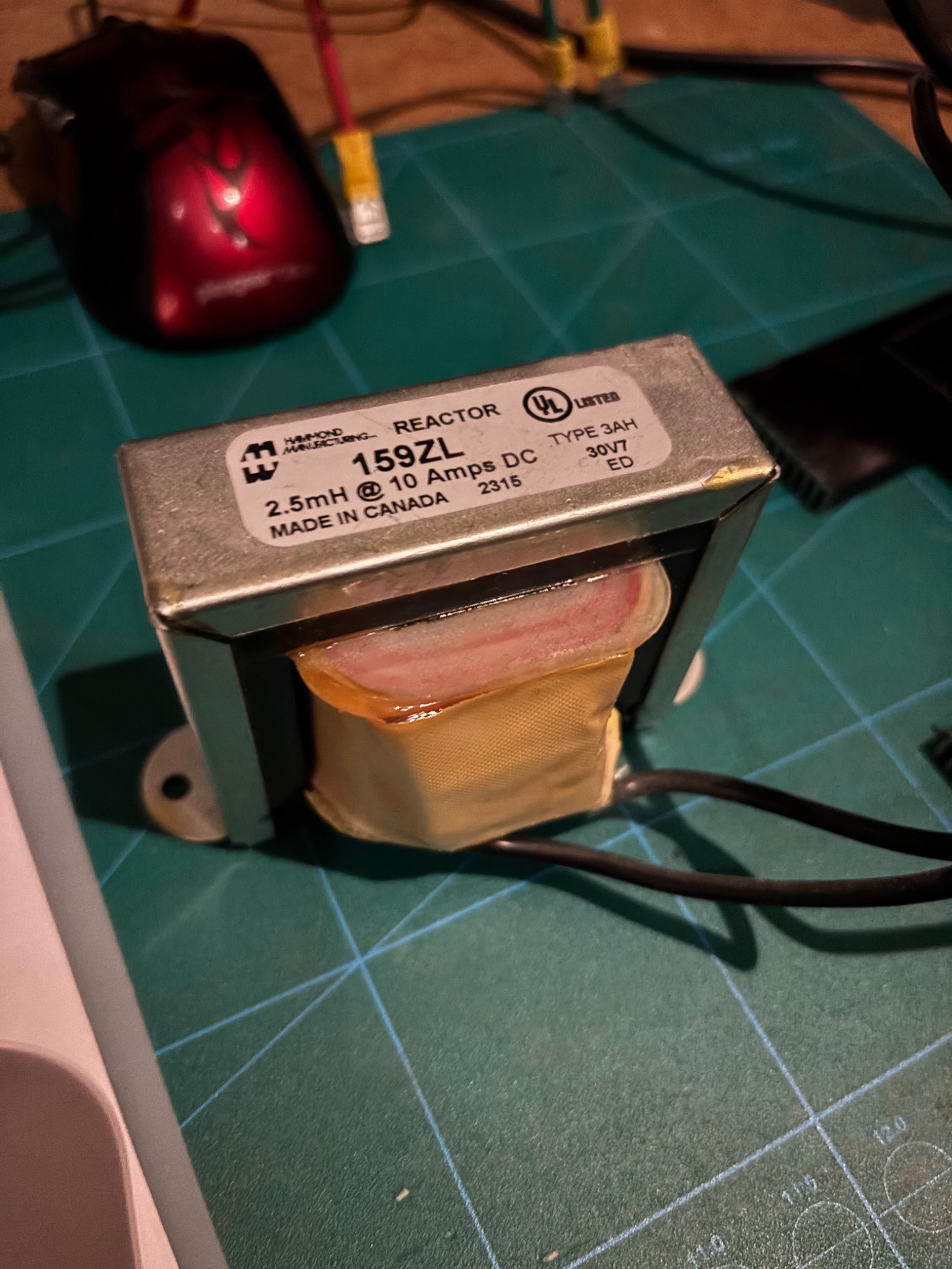

40mF-0R1-40mF
or even better
40mF-2.5mH-40mF
I got my act together and built another 2x40mF C and plugged one of the two 12 vac secondaries to a C-R-C and the other to a C-L-C and the 0V's together. The R and the L (Hammond159ZL) has exactly the same DCR, 0,11 ohms so they drop the same voltage. I putted a probe to each of the outs on the second C banks and took a pic. C-R-C has a remaining ripple of 27,85 mV and the C-L-C a remaining ripple of 3,07 mV, both peak to peak. Very good result of the C-L-C, almost preamp levels.
Load same as yesterday, 1,7 A each
Iron for the win!

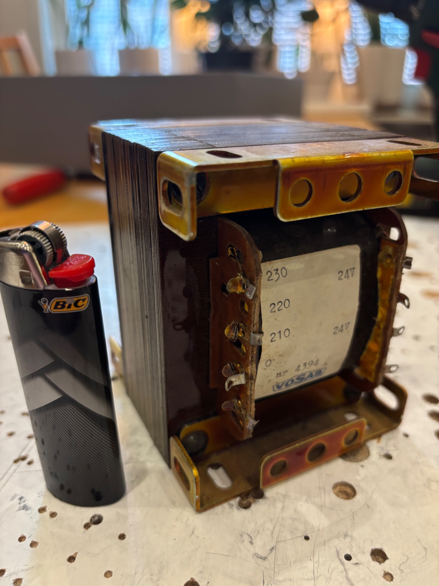

No, it will get boxed up and tucked away from donuts, whenever that act is to come. Doing some basic research before I make my mind up for a future config. I have an overcomplicated chassis in my delirium brain to make sure I don’t sleep at night 😉
Reactions: cwlo
Now I know that a pair of those will give me a clean and sturdy (800 VA in total) +/- 32 volts for applications needing that, and that they can chew 80 mF on first C without complaining.
Next in line will be some cuter EI cores that I suspect can stop at 100-150 VA.
So for those donuts I will need two for the voltage, for the EI’s I might need two for the amps.
Would be nice to put some old Iron from Smaugs stashes to use if I can anyhow.
