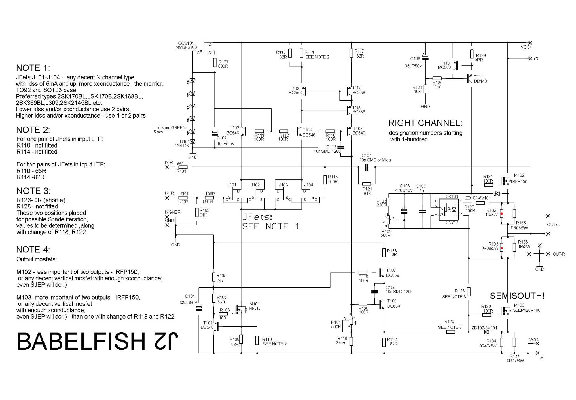

Just repeating ZM below. I did not fully follow your build. Just noticed that you have higher rails and don't remember what they were before the new transformers. Mine has 18V secondaries. I don't know if the resistor values in the snip below are correct for your setup. The point being P102 for Iq and P101 for offset; Increase series resistor as appropriate. And readjust pots and measure before power up.
And Denver, CO ? Small world.
P102 is for Iq set, while P101 is for output DC offset chase
if you need more of any, just increase resistor in series with trimpot
for instance, R123 goes to 510R, R118 goes to 1K2
do not forget to go back with trimpot before powering up
everything referring to schm in post #1

I realized Semisouth down R118 is only 270R so I swapped for 499R. And R123 I swapped for 510R as prescribed. Didn’t quite work out. I can only get Iq up to about 775mV. Offset won’t go below 435mV with pot maxed out. Doh! Thinking I should put R118 back to 270R and leave R123 at 510R?
just one more detail - at which resistor group you are measuring Iq (as voltage sag)
which figure (in A) you are shooting for?
Using this schema for Semisouth down with .68/1R resistor groups. Iq measures the same at all source resistors. A little update too. Just remeasured. Iq settles at max 758mV. DC offset is actually -358mV with pot turned all the way in.
So in addition to the last post I did some more math. Source resistors for Semisouth down total .405R. I would like 1.8A Iq. So 1.8x.405=.729mV. Looks like I'm fine on R123. I'll readjust and see where that puts me on DC offset.
Okay. Readjusted Px02 for 729mV for Iq of 1.8A. Offset went to -400mV. Iq seems good but Offset is heading in the wrong direction.
if you're good with Iq, and DC offset is a problem, that means:
- offset positive - increase R118
-offset negative - decrease R118 (or just short it, do everything with P101)
Eureka! Offset is dialing in nicely now. I paralleled 1.05kOhms with the 499R I have at Rx18. Thanks for the guidance ZM. A little more dressing of wires and I should have the BabelJ2 singing again.

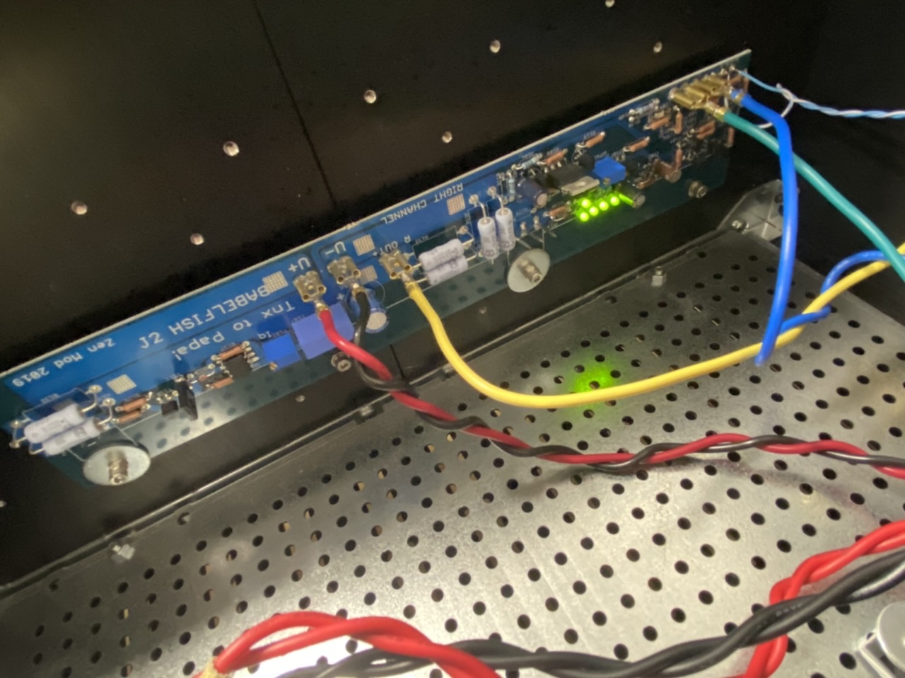

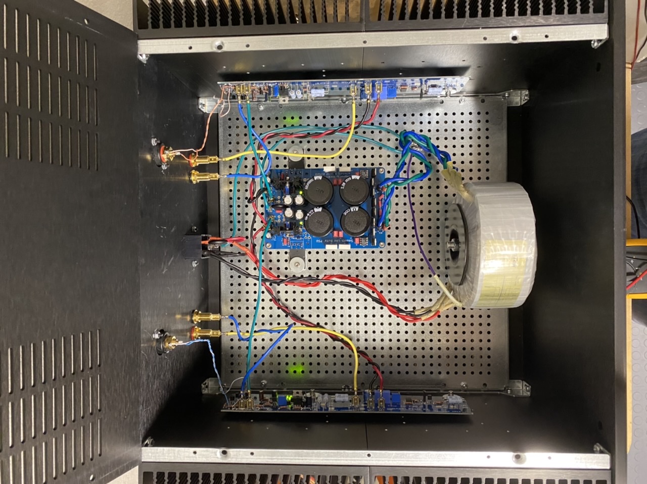

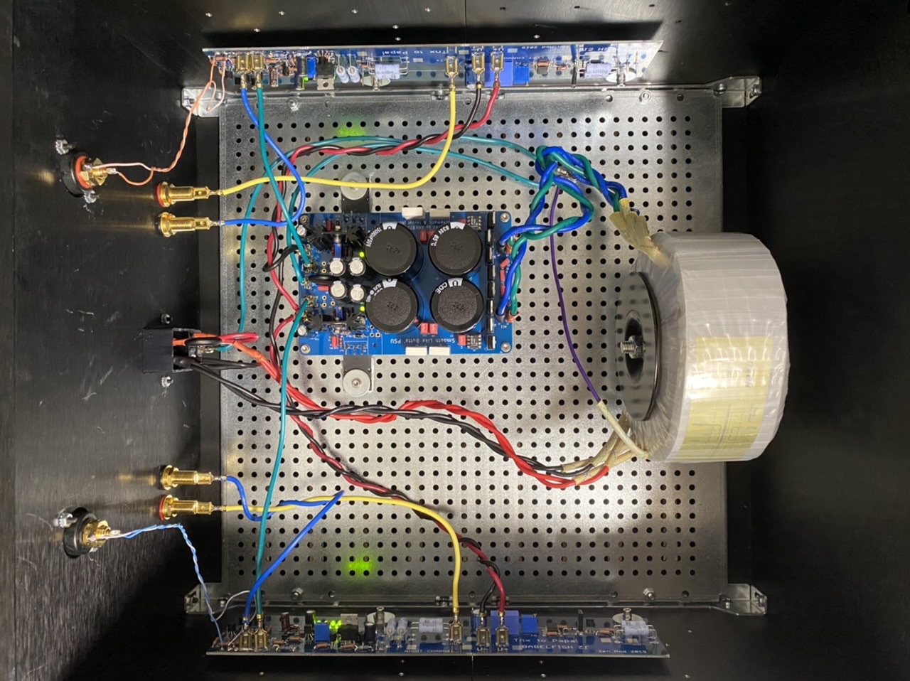

BabelJ2 is fully operational. It is a little tricky to really dial in the offset on this one. Bias is 1.8A. Heat sinks on the 5U 400 hold steady just a smidge below 50C. I had an Antek 400va with 22V secondaries but voltage seemed a little too high. Swapped out for 400va with 20V secondaries. The SLB is 23.4V +/-.
And the sound. Ooo the sound. I’ve only tested with my workshop speakers with a cheap Bluetooth receiver as the source. Dayton PS95-8 is karlson foamcore enclosures. So far this amp has phenomenal imaging. Listened to A few tracks from Roger Waters, Amused to Death. I have never heard a soundstage like that. I didn’t know it was possible. Also, Eric Clapton Unplugged. Very nice. Can’t wait to get this into my main system with a real pre-amp. Will report back again soon. Here are some photos of the final product. Glad I really took my time with the wiring on this one. Those BabelJ2 boards really deserve it. Thank you ZM! I had the prescribed 270R in Rx18’s but I couldn’t adjust offset enough. Paralleled the 499 with 1.05k because I got a little lazy to look for any 330R in my parts stash and I didn’t want to risk lifting any pads on desoldering those again. Worked out well in the end. 😀
