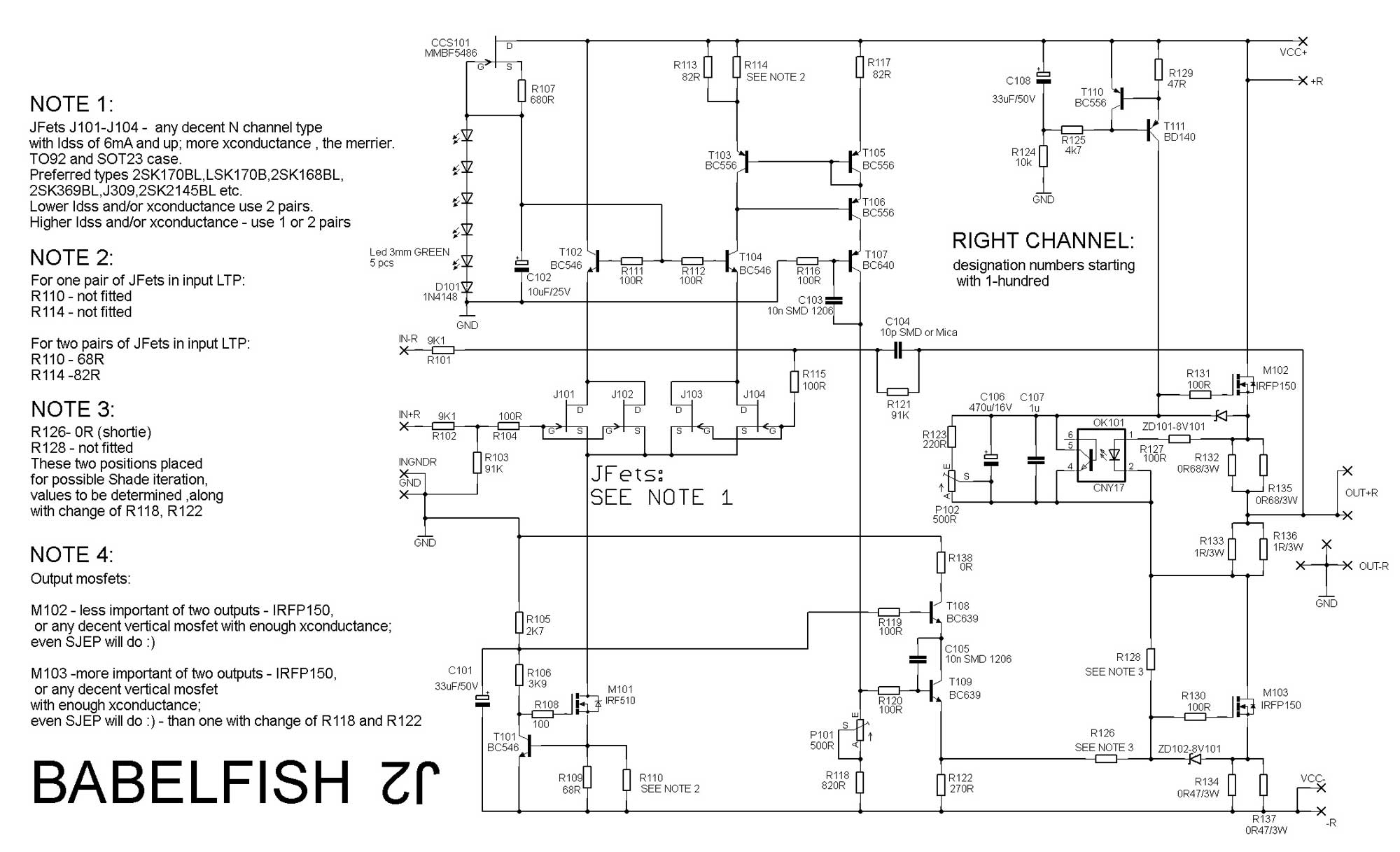

now - I already explained that to your fuzzy Mentor Chakija - solder resistor between -IN and GND pads , value whatever you have in drawer - 100K to 1M, lower the better
that will cure problem with open inputs; though, never was my big concern, simply because of habit to ground inputs while setting and later inputs are always "terminated" in proper way
now , when inputs are grounded, clarify/confirm:
- you can bias it to intended Iq
- there is positive 1V4 DC offset at output?

Ok, 110k resitor added between - and gnd input.
I can lower the offset to 0 with input like this.
Max voltage across R133/R136 that I can get now is 20mV. If I open the input, I can bias it to 900mV.

gnd both inputs
ignore offset for now - can you bias it to intended Iq (even if setting dc offset for worse is needed for that) and, if yes, how much is that?

Oki.. with both inputs having 110k to gnd.
Pots are both at the end of their travel. Bias voltage across R133/R136 is 25mV (while offset is -1.3V).
I can't get it to more then 25mV..

when I said "gnd both inputs" that means - short both inputs to GND, tie all XLR pins together, or whichever way you can do this
once when you're in ballpark with settings, funny behavior with inputs would stop
if offset is negative, that means lower mosfet is open more than upper one
ref to sch in post #1, also attached here, set P102 to zero, replace R123 with 510R or 620R or 680, and try again

Zen, with inputs grounded and R123 680R, I can get desired bias.
Offset is positive 1.4v. To increase R118 to 1K from 820R? R122 is still 270R.

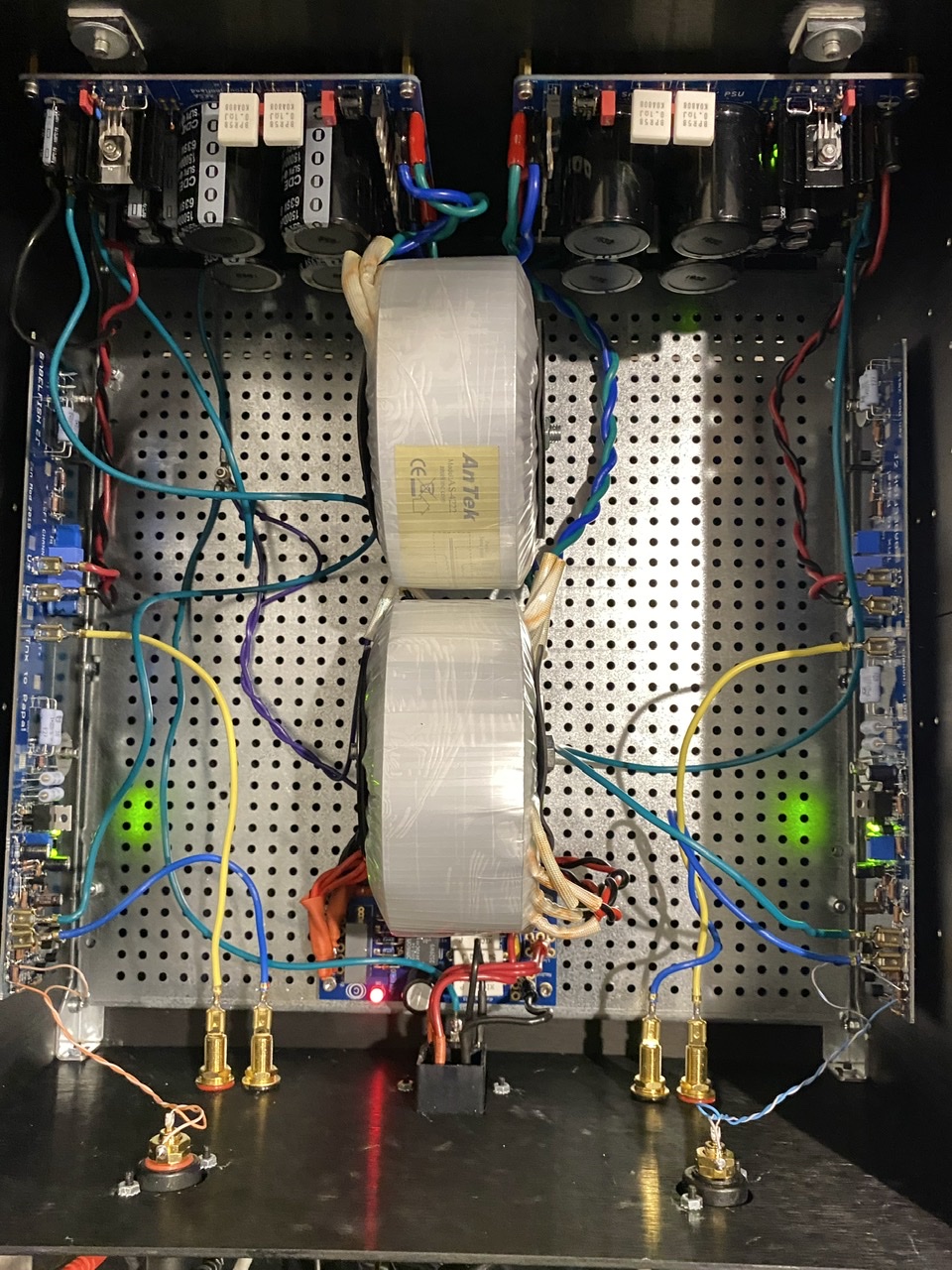

Babel J2 is happy in its new home. Dissipate 5U Deluxe. PSU’s are SLB. One per channel, fed by Antek 4222, 400va 22v secondaries. Getting +/-26.9v per board on the supply, under load. Playing some vinyl right now. Gillian Welch - The Harrow & The Harvest and Herbie Hancock - Fat Albert Rotunda. Phenomenal. Thanks again ZM. 🙂
