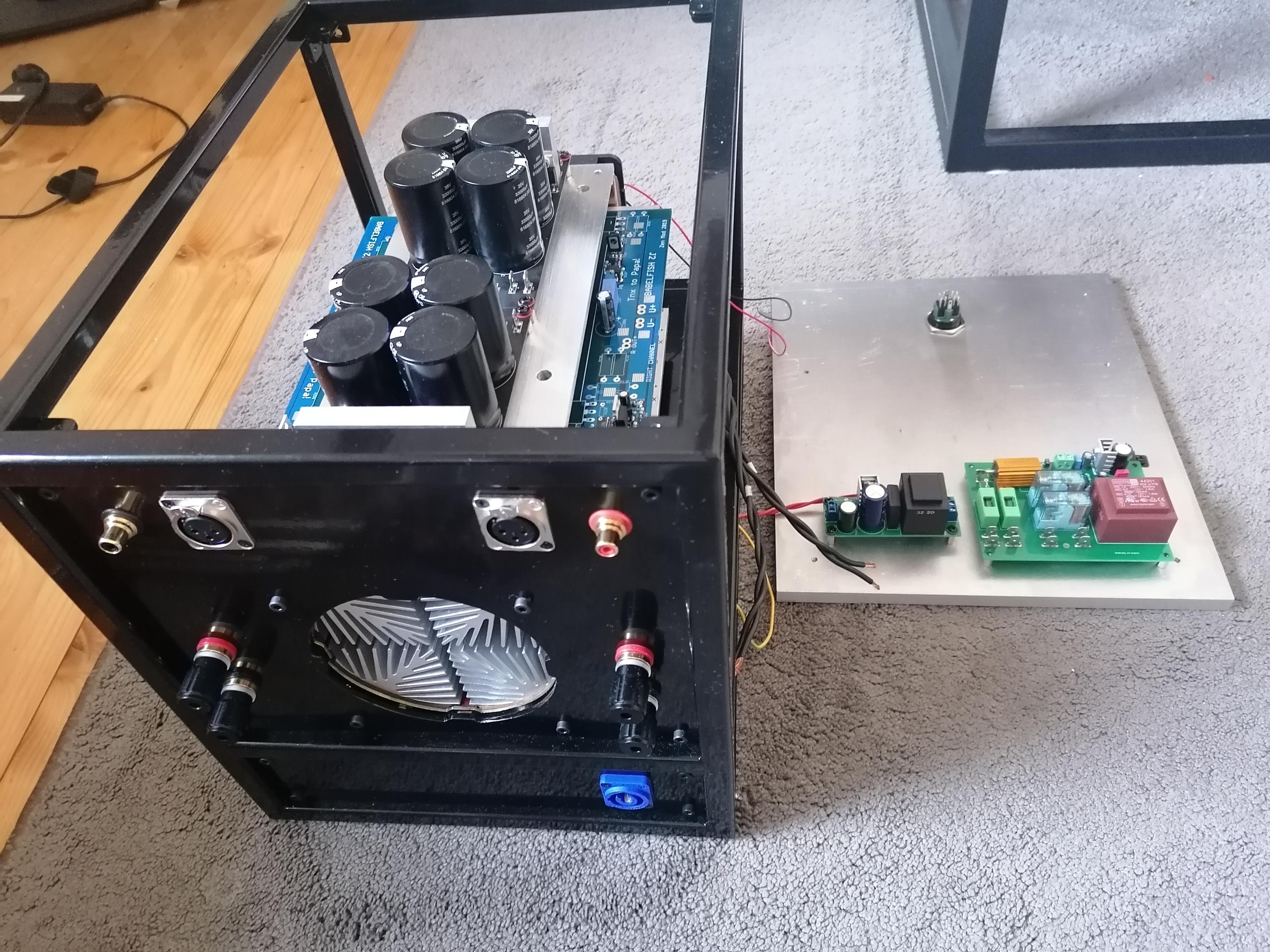

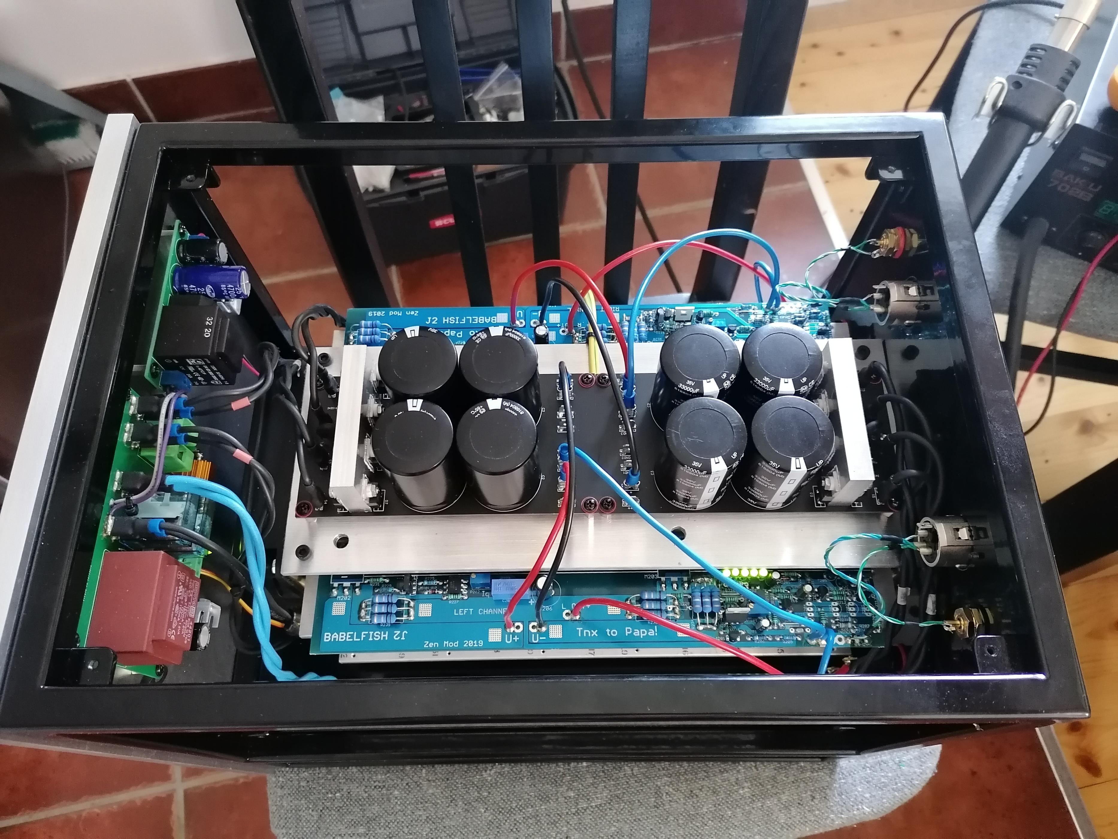

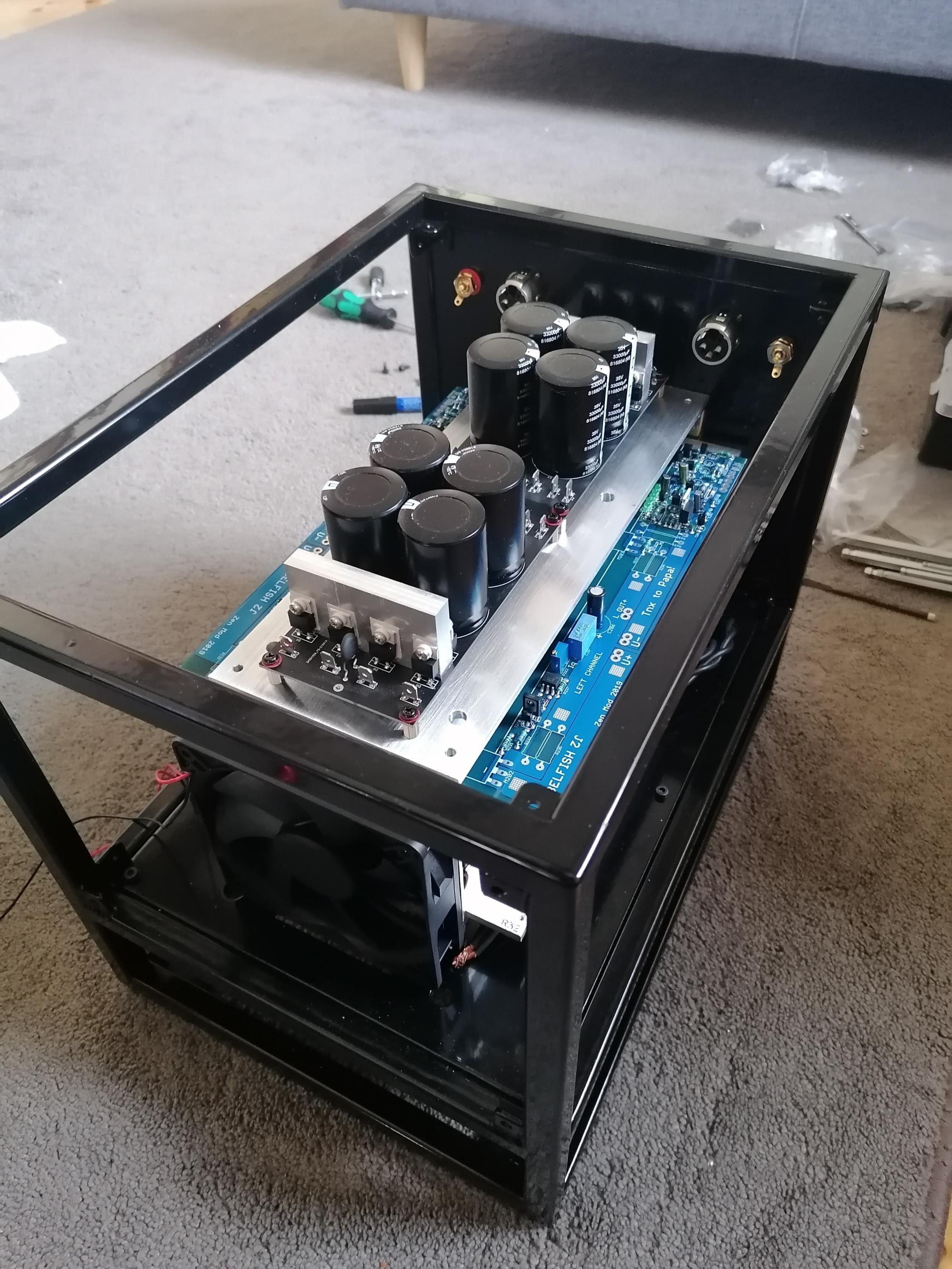

I made it.. TIG welded from 15x15mm profiles and powdercoated. Sides are 3mm alu, middle shelf is 6mm alu that caries two 500w toroids from bottom and 30cm long tunnel above. Everything is also manually machined by me.
I had that cooling tunnel collecting dust for almost 15years. Finally pulled some free time to make a chassis that will accommodate any A class amp. As Zen will not stop 🙂.. I'm just waiting for next creations like sexy bush, warm aunt, etc..

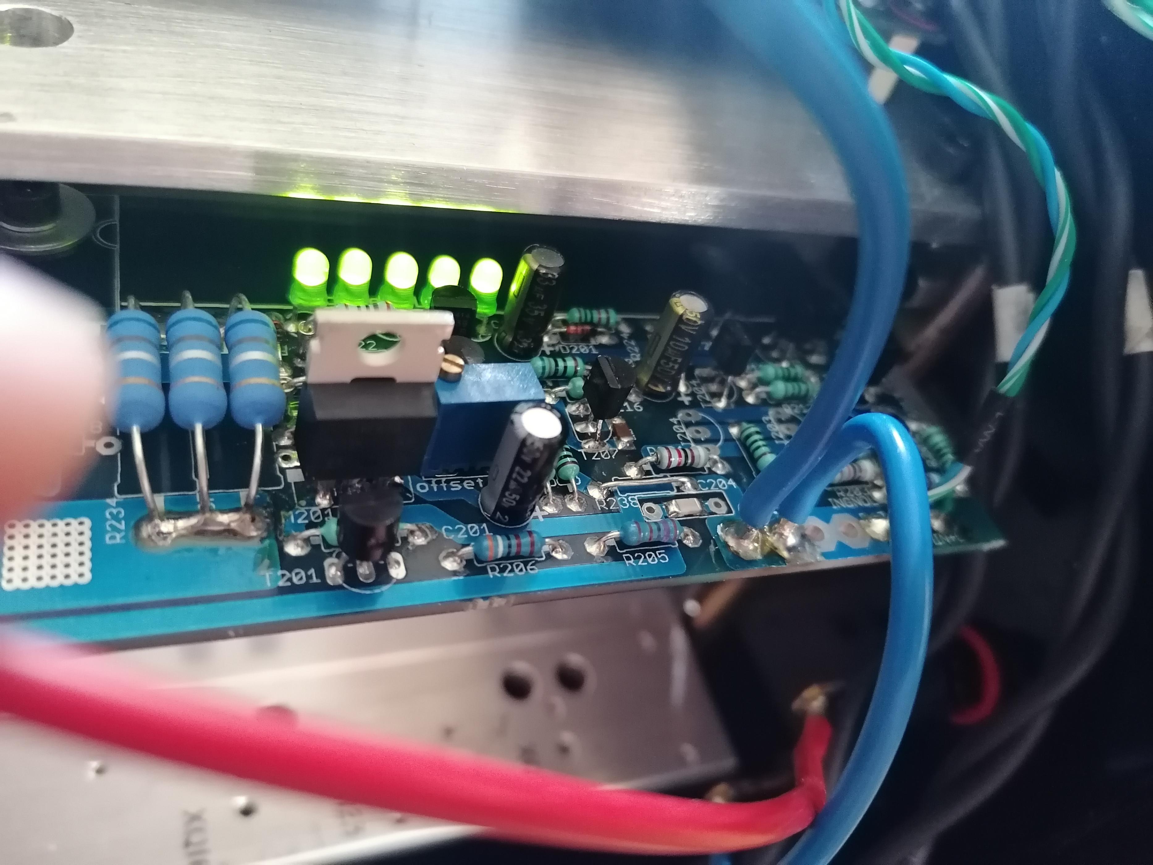

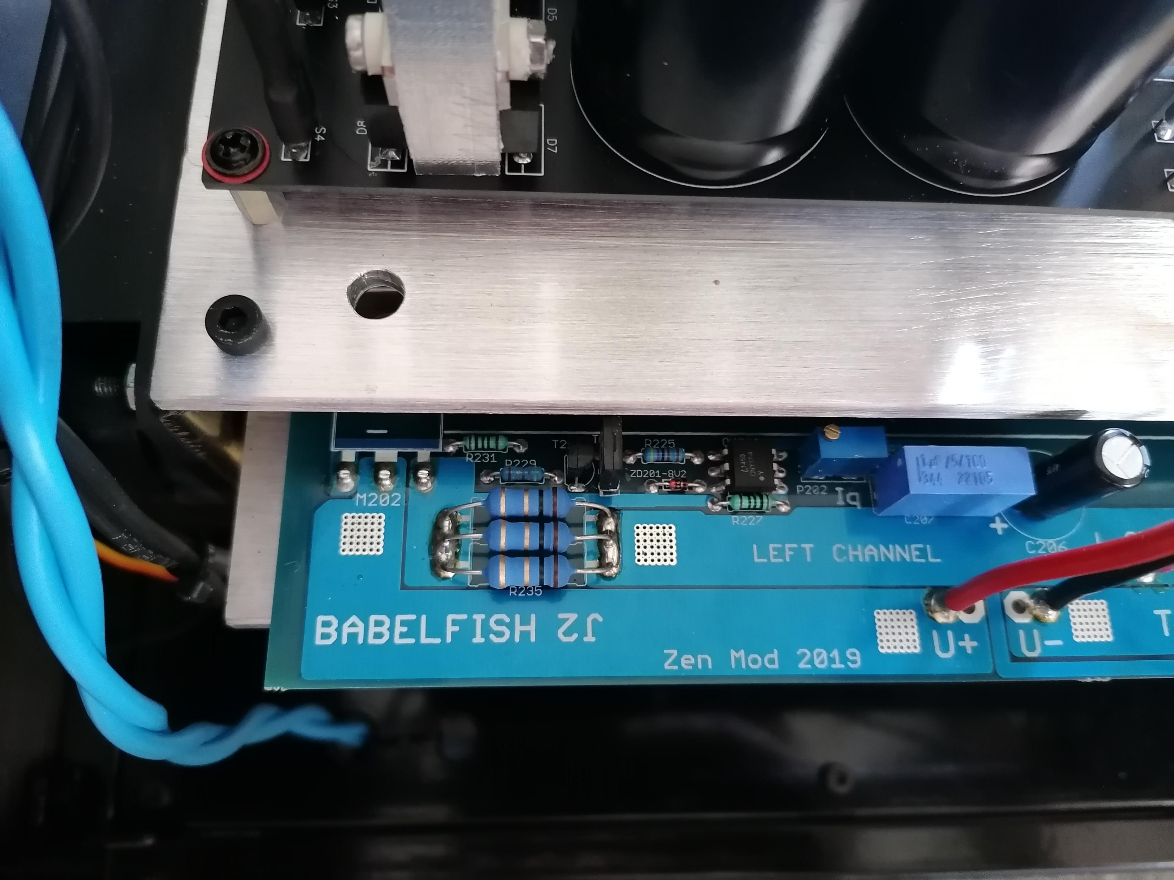

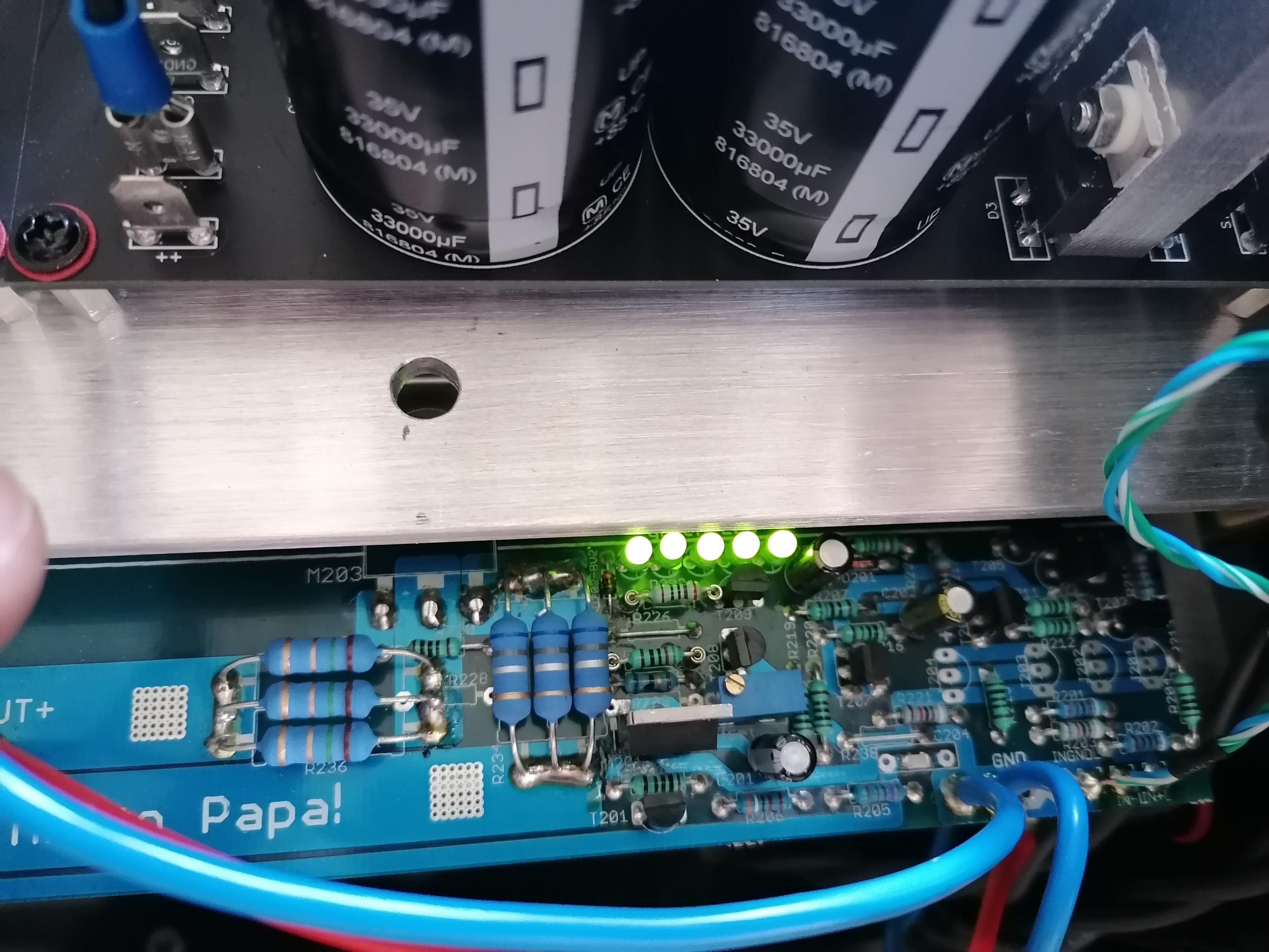

I have some strange behavior on both channels..
Sale (Zen) what would be your first hint if mosfets are not pulling current if input is not shorted out?
So, input shorted - mosfets are pulling current but there is almost 1.5v of output offset that cannot be trimmed out. Inputs open - no current but offset is ok and trimable.

both channels same behavior?
inputs must be shorted, in fact - neg input must be shorted, simply because MZM forgot to include 1M resistor from neg in to GND, for steady reference ( later corrected)
explain which parts you have in output, and what you put of resistors, regarding Notes in schm
Yes, both channels are acting the same.
With input shorted I cannot lower offset lest then 1.4v and as I open up the input, bias goes to almost zero.
Outputs are both IRFP150. As I couldn't get 3W mox ones locally, I drilled additional holes and used 2W ones - 3x1R, 3x1.5R and 3x0.68R (top to bottom..)
Also:
R123=270R
R118=820R
R122=270R
Also:
R123=270R
R118=820R
R122=270R
