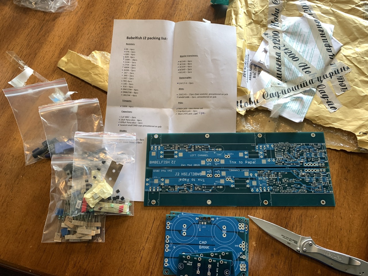

ZM, In the iteration I got from you, J101, J102, J103 and J104 are stuffed, 4 SMD per channel.
Can you please confirm that I have to add R114 and R110 ? I'm also building with IRFP150 at M102 and M103.

Time to start building! 😀
Have fun codyt! I'm about to start mine as well now that my Pearl 2 is finished. Just waiting on my Semisouths from jama via South America. 😎
ZM, I may have gone too far. The Semisouths are SEJP120R063 or double die 120's. I've read through other posts they should behave as 120's just better dissipation. Any thoughts on changes needed for the circuit with these or just bang em in?

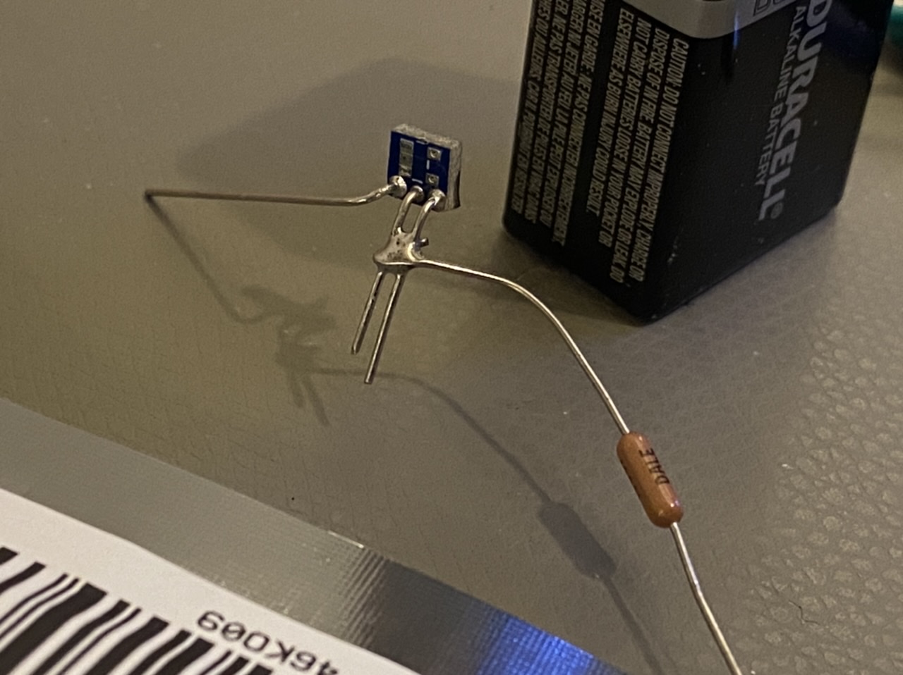

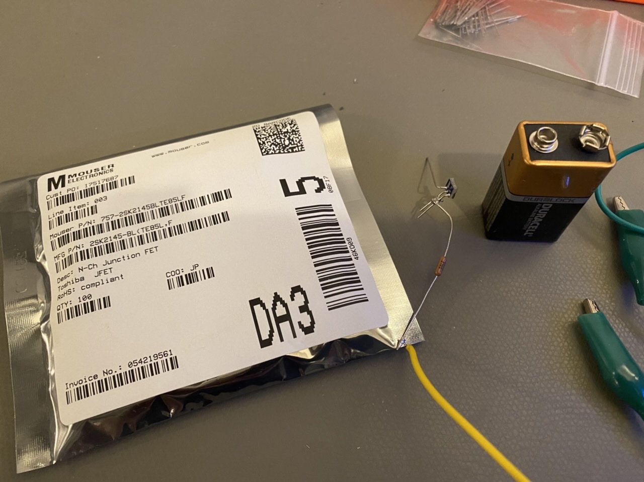

Time to start matching. I made up some 5x5mm pcbs from the very generous EUVL’s (Patrick) gerber files for miniature 2sk2145 breakout boards. I soldered one up with gate and source connected to a 100ohm RN55. 9 volt battery is ready to go, although I may try a 12v switcher I have laying around.
switcher is better, no voltage slide through time
put some RC in rail, say 100R and 10uF is enough
remember - both connected in parallel, threat them as one JFet
I'll go with the switcher then for sure.
Good thought on the RC. I might have a few parts scattered around the bench for that. 😉
The breakout boards combine both sides as one. Handy little buggers.

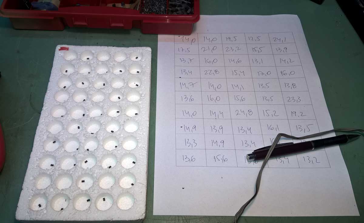

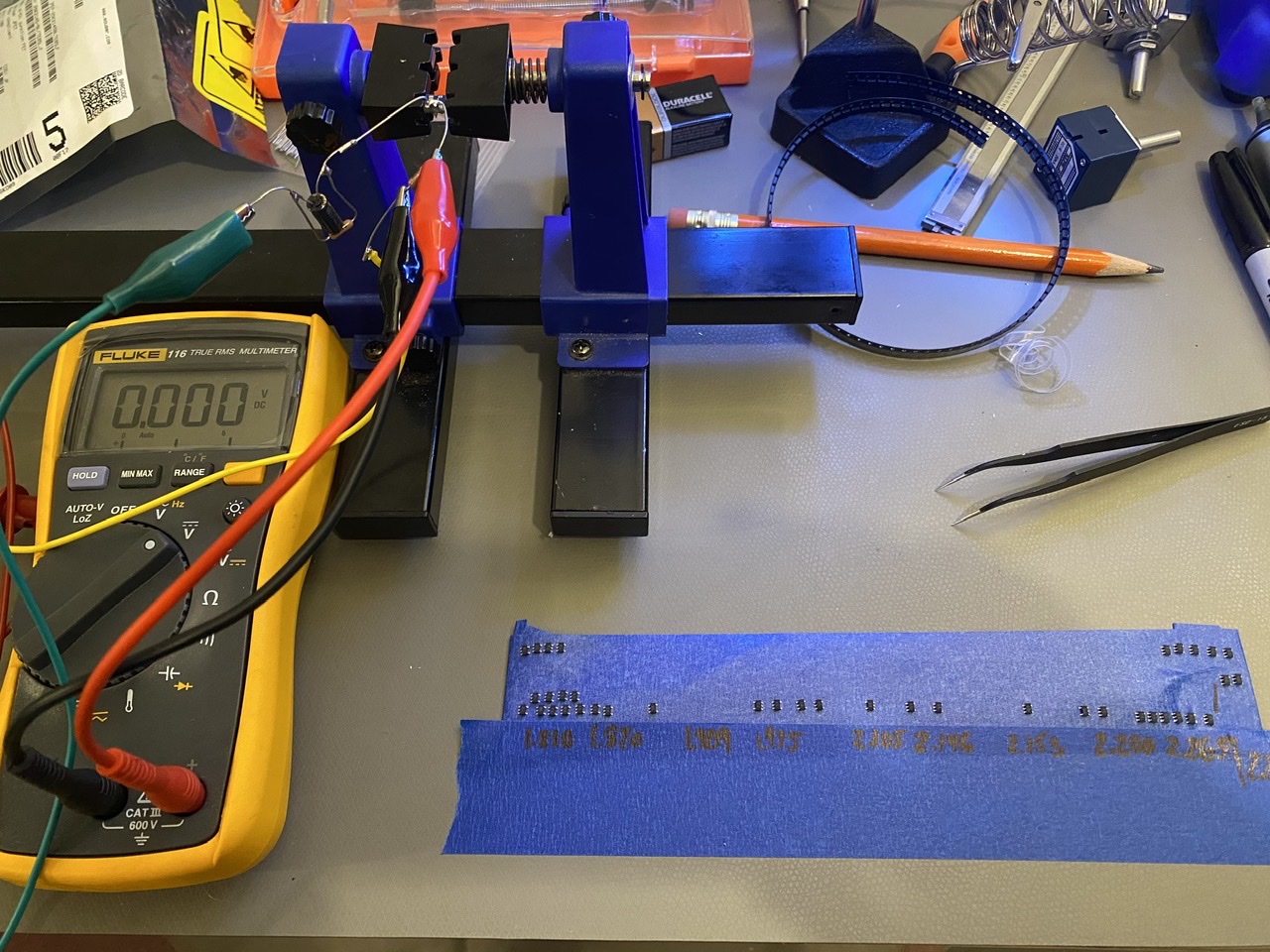

My matching rig. Curious to know others technique. I held the jfets on for 10 seconds then took the idss, but in some cases it seemed like this might not be long enough.
you must wait for temp equilibrium - when reading is steady..... do not count time, look at display
no free lunch

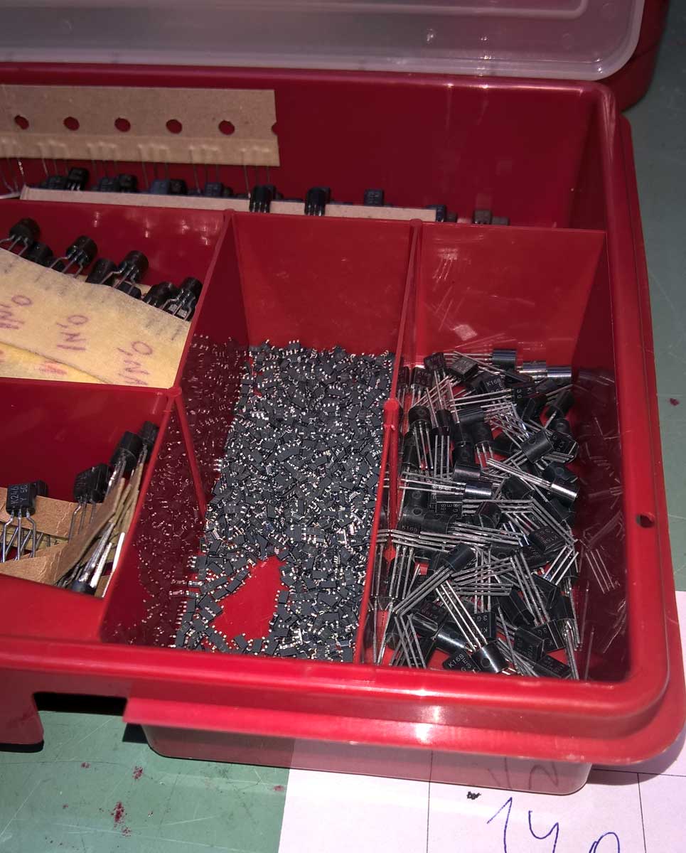

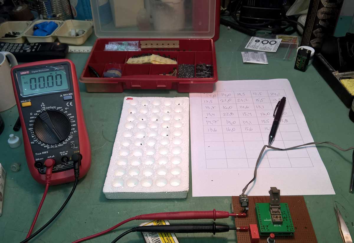

I have fast socket thingie ........ and even with that , how fast you think that I'm doing batch of 50?
(having handy plate of Styrofoam , with 50 small holes in it)
ignore taster on thingie pic, later I put nice small relay and switch, so I can do other things while JFet is cooking, instead of keeping my finger on taster
edit- I'm testing proper Idss, no resistors in source or drain....... DMM connected as mAmeter in drain
no free lunch

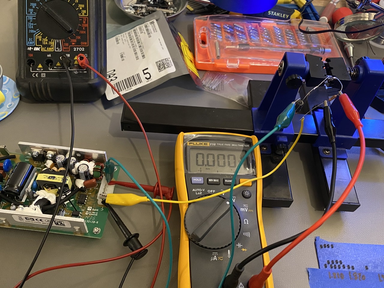

Thanks for the pointers ZM. Looks like I’m going to start over and go for equilibrium. Is there any risk to the jfets measuring true idss with no resistor?
So DMM as Ammeter does not use a current sensing resistor.
And the ammeter has a lower tempco than say a S102.
Patrick
Patrick
If you've got good equipment of know quality (eg Fluke, Keysight Lab Bench Meters) it's easier just using the meter, and the accuracy is good enough.
If you've got a cheap crap multimeter of unknown quality then use a good current sense resistor.
I have decent tools, so I use a meter, same as ZM.
