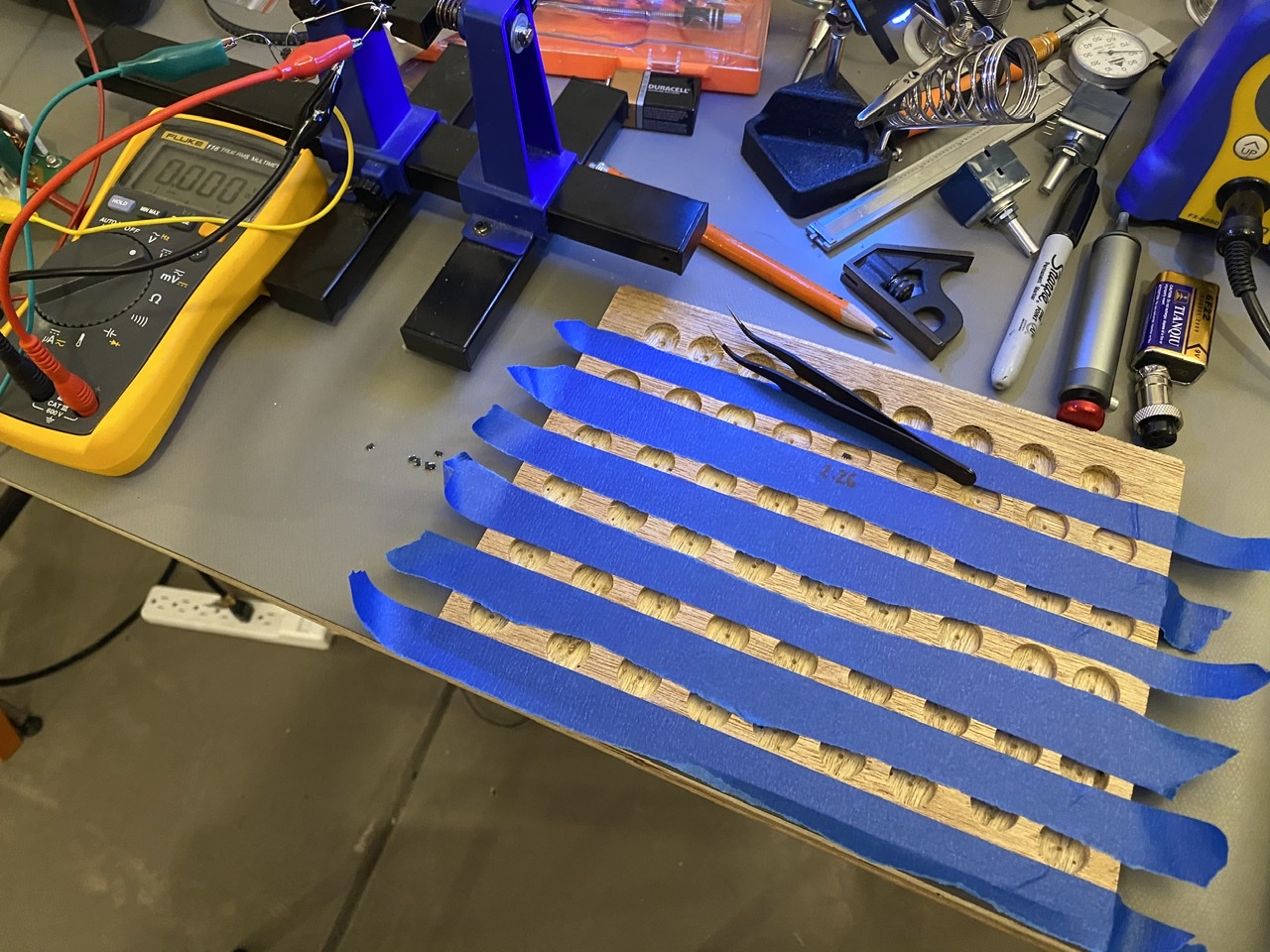

Of course I don’t have the patience to what for the testing jig. I’m sure it will come in handy again though. Revised my jfet sorting tray. I drilled a series of 5/8” dia. holes halfway into a piece of wood flooring with a forstner bit. Thanks for the idea ZM. Starting from the beginning testing until the reading settles. We’ll see how long it takes me to get through 50 jfets. 😀
