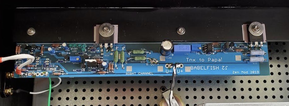

Late to the party as usual, but the boards are finally soldered up and waiting.
I'd like to put to use a 500VA 2x22V transformer, any issues other than maybe having to lower the bias depending on heatsinks ?

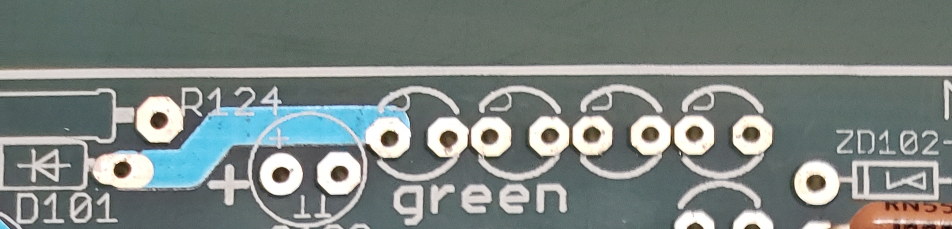

'twas my attempt to be smarter than Eagle, which is not having C mark for Cathode
so, there it is ..... it took me just few years to finally understand how to edit existing and make new packages
Whoa, Blue Car! .......... I even made my own for 2SK77B and for Mos-pucks

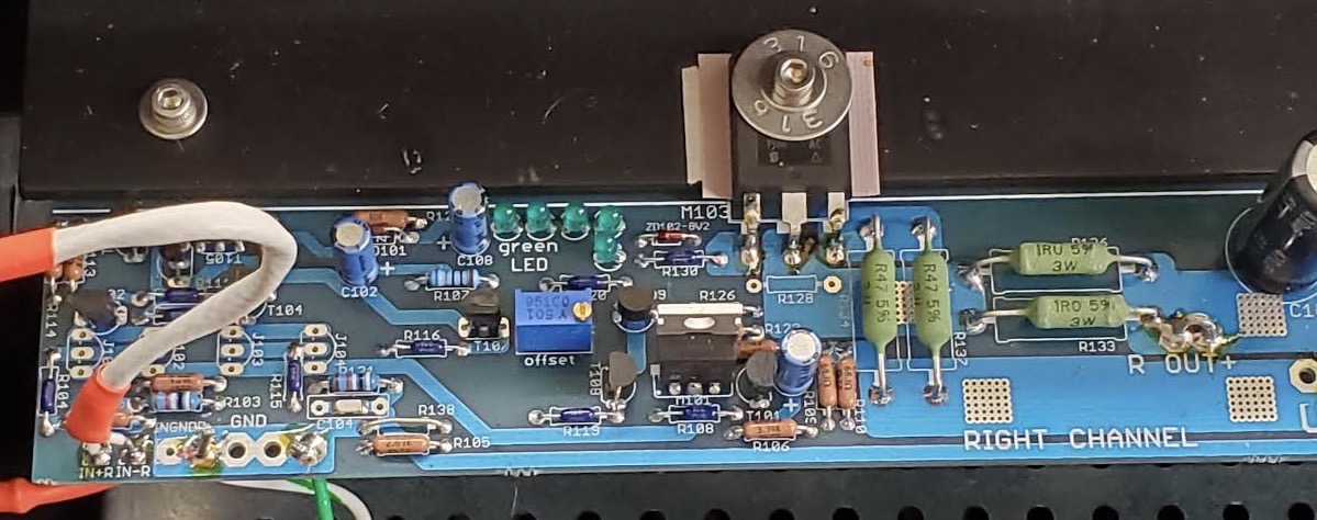

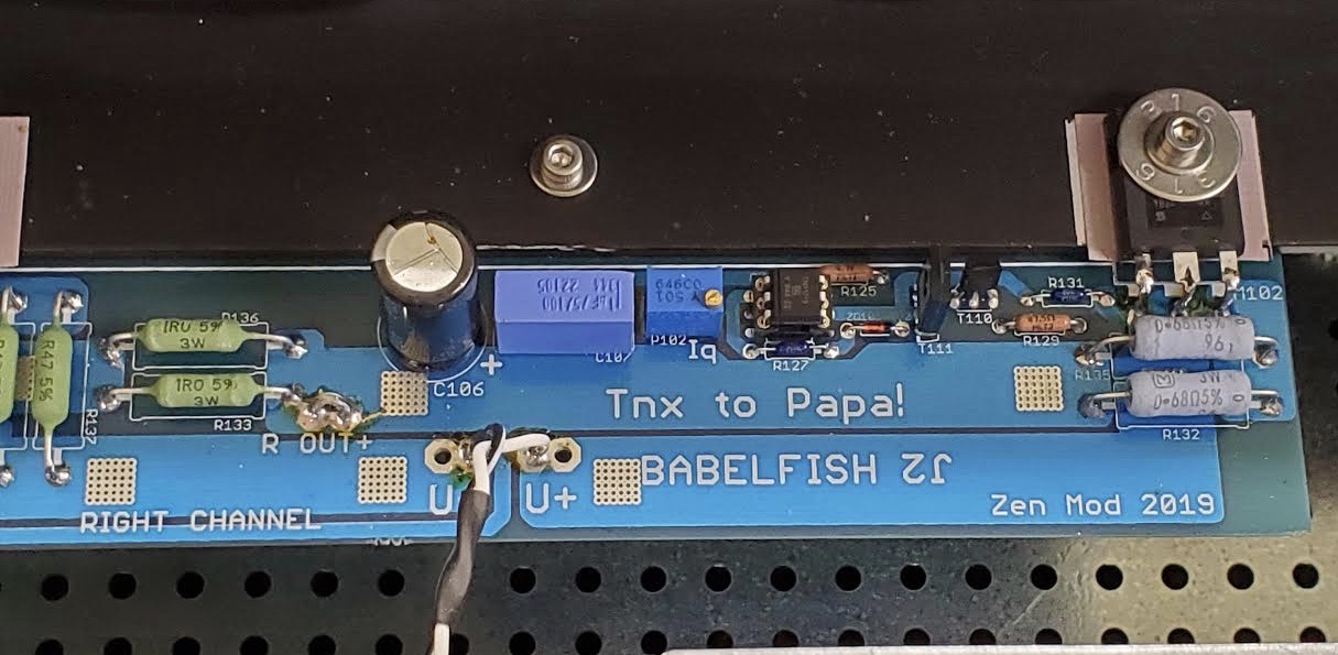

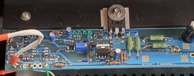

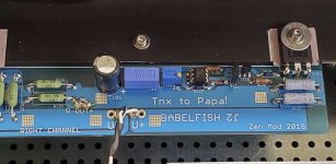

I am trying to fire up my amp, but am not able to get current through the power fets.
Rails are about 24 VDC plus and minus, separate dual mono supplies.
I am using IRFP150 in both the M102 and M103 positions.
All parts are as called out by ZM.
The led's all light fine, the offset can be adjusted no problem.
When I adjust P102, however, nothing happens, with only about 20 mV across either R133 or R136, and minimal current across any of the power resistors.
It is acting the same in both the right and left channel when they were tested separately.
Does anyone have schematics with expected voltages, so I can do some trouble shooting in the optoisolator CCS, bias and emiter follower areas, especially.
thanks
thanks

I have the jumpers where they are supposed to be, the correct value R110 and R114 for the 4 jefts, and confirmed the 1R0, 0r47, and 0R68 power resistors are in the right places for IRFP150 power mosfets.
