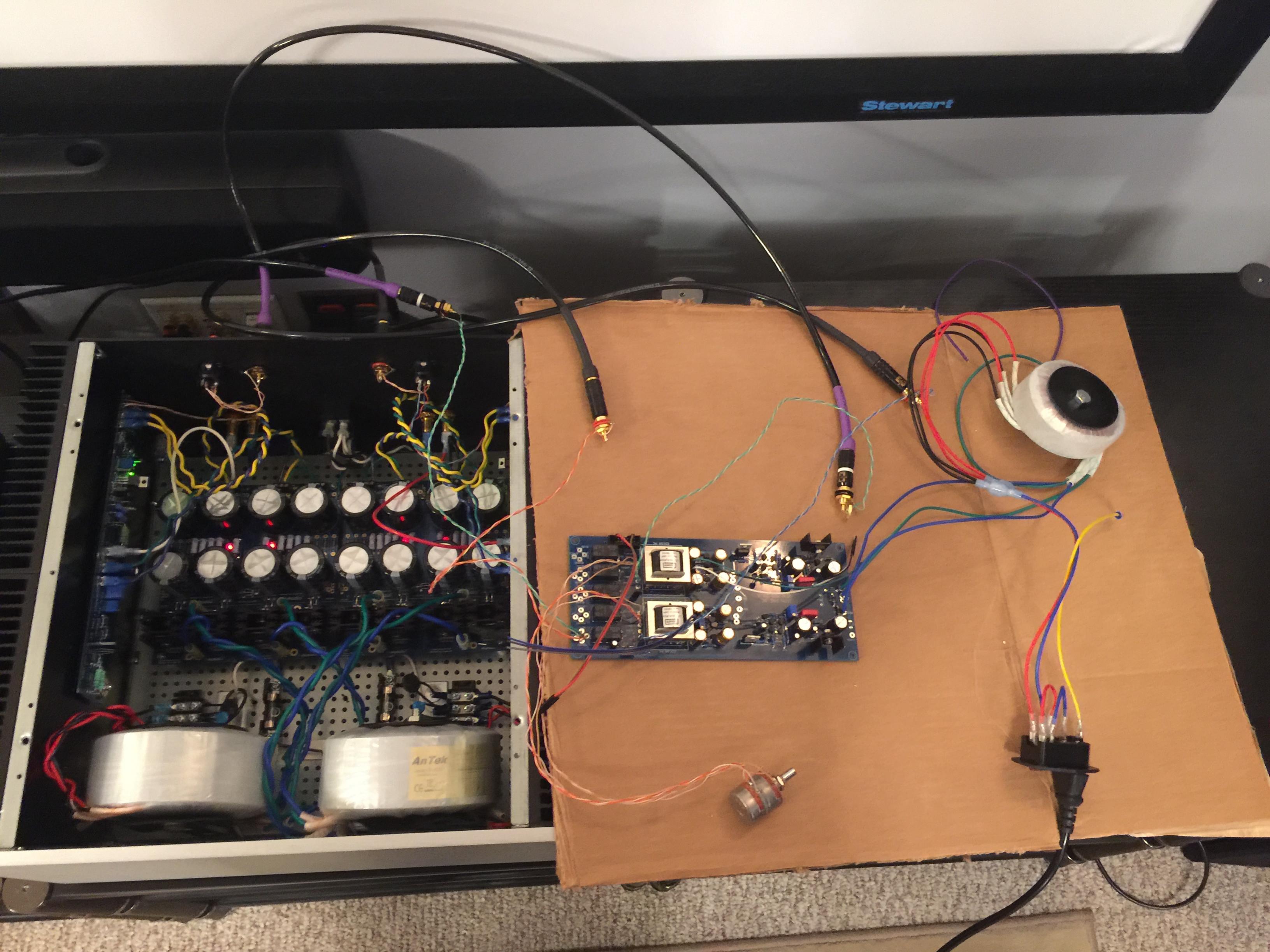

Stable after 2hrs cooking. Ready to try some music, but I noticed when I shut down the power, I get 3V41 DC at outputs...
Null perfect when powered up, but a lot of DC at output at power down. Slowly drains over time.
Is that acceptable / expected? Seems like it may result in a BIG turn off thump? Is that correct, or am I paranoid again?

Edited to add - also checked at power up - 1V8 that then starts to decrease. Note, both turn on and off were w/o inputs shorted.

I did not want to edit again - It may be useful to know that with a 8ohm dummy load, the voltage at on and off is only short burst of ~100+mV or so, then quickly goes to normal. I'm not worried. Sorry for so many questions.

ZM - I left the amp on for the evening and all morning. All stable!
I got the new pot for the Iron Pre this morning. Very early FedEx 😀 So, I swapped out the pot, and I have added the RCA inputs to the Babel J2 chassis.
I admit I get confused with some of the options for simply adding the input. For this amp which has In-, In+, and GND - I think I would:
1) Wire RCA Signal (center) to XLR pin 2 (In+)
2) Wire RCA GND to XLR GND (Pin 1). Note - Edited
I have seen some people use resistors between the two GNDs for the inputs. Is this necessary if only ever having one set of inputs connected? Recommended? Is this to reduce hum? I see lots of values used. If recommended, is there a value that you like?
When using RCA input for this amp, I would need to use a jumper to short pins 3 (In-) and GND (pin 1) at the XLR, correct?

XLR:
1-GND
2-hot positive
3-hot negative
connect whichever way with RCA you want ..... plenty of pics how I did it..... as majority are doing it - connect pin 1 to RCA GND and pin 2 to RCA hot
for SE input (RCA) you need to put U shortie to tie 1 and 3 of XLR

Thanks for confirming, ZM! I looked at a lot of examples, but I wanted to ensure I had it correct.
I had to pause for a few hours for some work. Below is some early porn with things still open-air. Babel J2 with new RCA inputs added and Iron Pre making beautiful music together. Chassis for Iron Pre should be here soon. New pot is installed, but I need to still order the pot extension to the front of chassis etc. to get it final and tidy.
Hooked it up to "main system" to enjoy until I have to tear it down to install into the chassis and get a remote / motorized pot. Too lazy ...

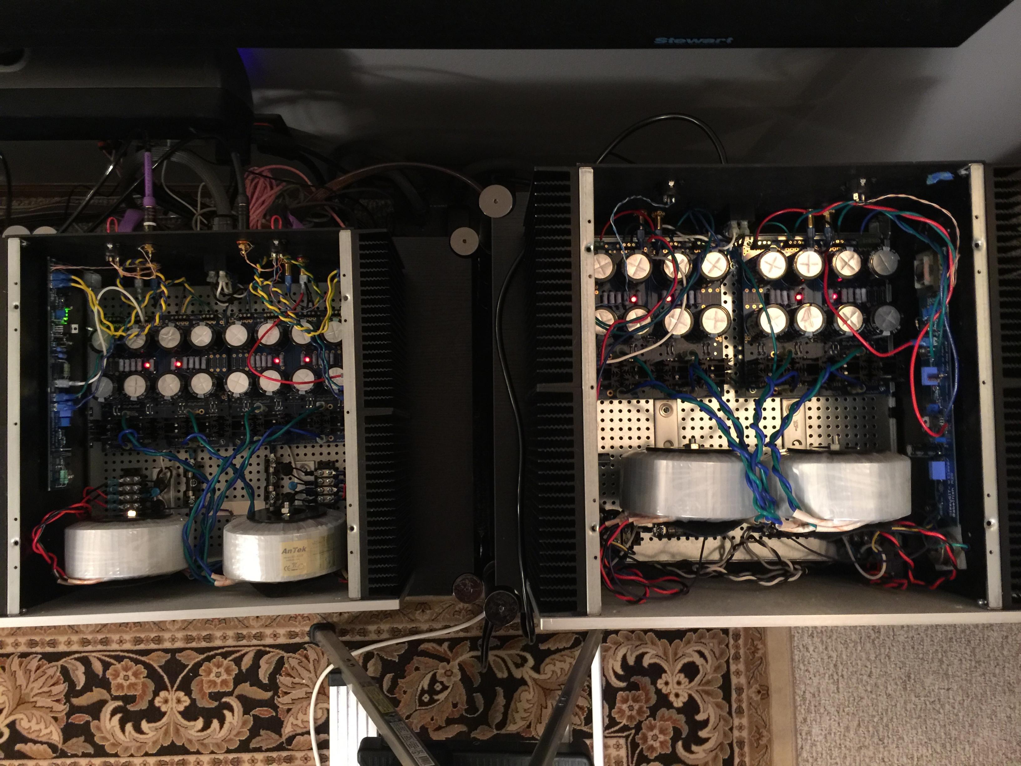

I did... Your timing is uncanny...
I haven't ever done a back to back comparison using the same kit with those two. Also, I just got the SissySIT back a little while ago. I loaned it to a friend. So, I built the Babel J2 😀
Now, they're both back in identical chassis / PSU boxes (only layout is a bit different).... and ready to go. I just got Sissy off the bench for her checkup to make sure all is well.
I can say without even listening back to back that they are two of the finest amps I've ever paired with my speakers. That's why I want to listen to them more closely together in time. I'm trying to learn a bit more about what works well with certain speakers - these both work for me!

Here are the siblings .... Left is J2 playing now. Right is SissySIT warming up to temp and getting all hot and bothered. 😀
I'll post some thoughts in a few days or so. Keep in mind that my speakers (Tekton DIs) seem to play nicely with some amps and not others (to an extent). So, my impressions and needs may differ.
Edited to Add - Well, I may not use the ACP+ first. I just noticed that I forgot to put the RCA inputs on the SissySIT. I'll either use another commercial pre-amp or add the RCA inputs to the SissySIT tomorrow. 😀
