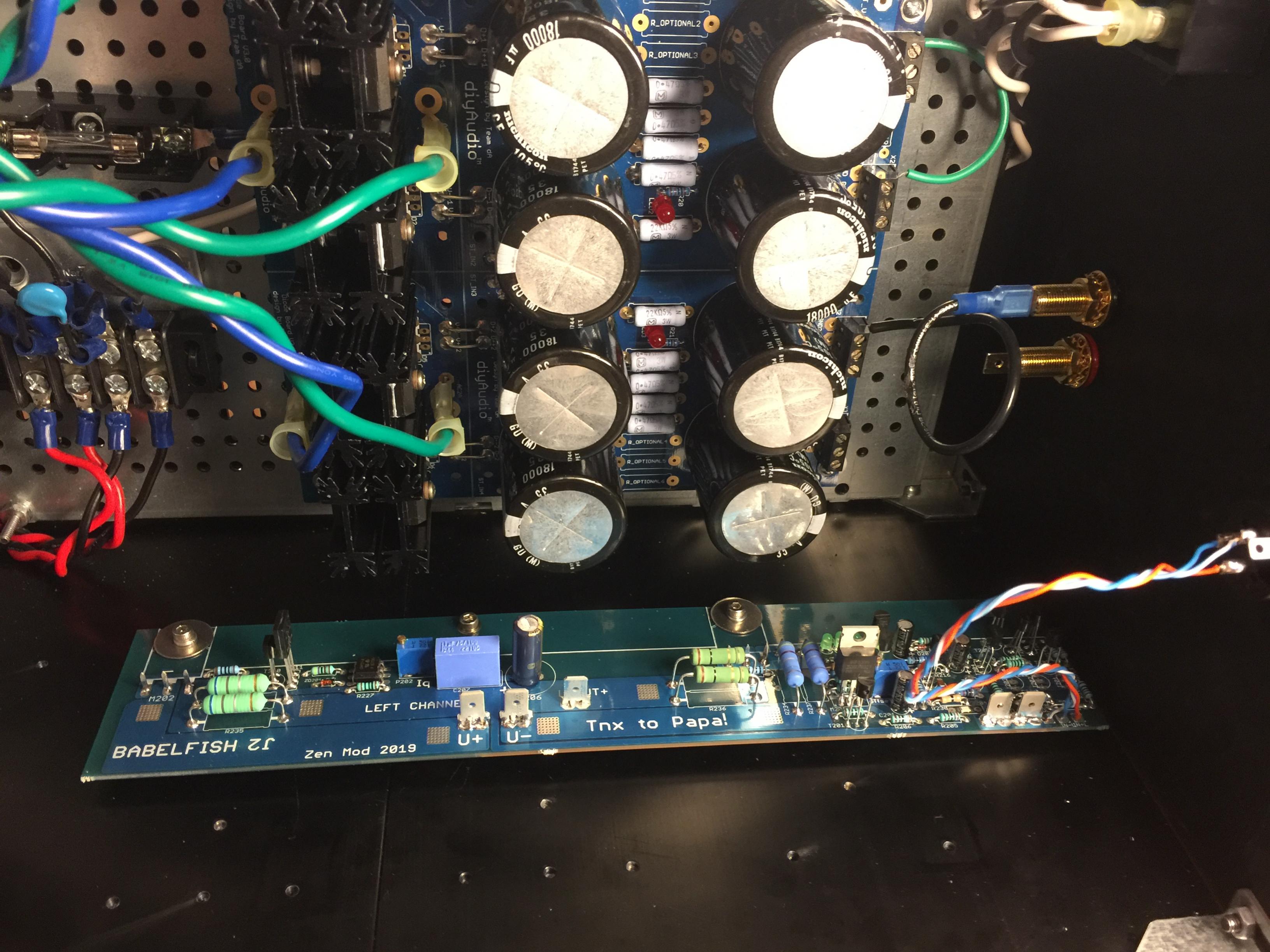

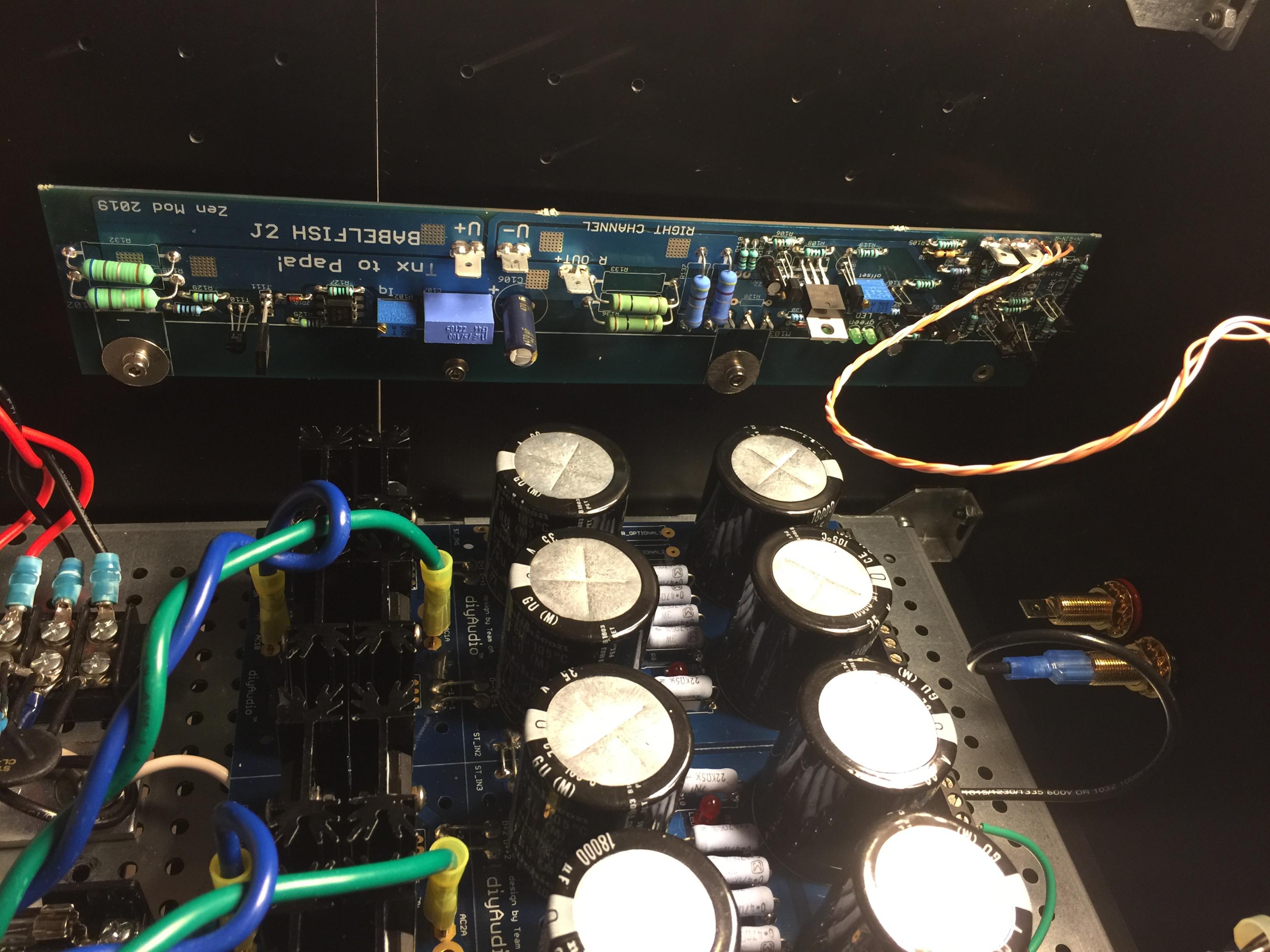

Board marked left channel biased up on test quite nicely. Have not baked to null offset, but it started at 0V000 until I played with the pot to see if I was getting a proper measurement, then it started drifting. Silly me. I will null once it has baked 😀
The board marked as right channel had a problem with the dim bulb check. 😕 I have a problem somewhere on the amp board. The PSU checked fine (and has worked for a long time). I tried some continuity checks for key places. Nothing looks funny, but the bulb test acts like I have a short. (Bulb stays bright and does not dim).
With PSU disconnected and board mounted to sinks -
No continuity from output FET pins to Sink or GND (with PSU disconnected).
No continuity from V+ to Sink or GND
No continuity from V- to Sink or GND
No continuity from In+ or In- to Sink or GND
No continuity from GND to Sink
No continuity from Output to V+, V-, GND, or Chassis
I'll take a break and come back to it. Are there any other simple things to check that you can advise? Next step is to remove the board and inspect again.

Thank you as always, ZM. I had both pots at midpoint. Minimized Iq and Offset pot on board. Passed Dim Bulb. 😀
Both channels are cooking at 0V850 with minimal DC. 😀 Two hours check and tweak set points, then music test.
Thanks, Dennis! Much appreciated. Still fighting through the paranoia vs. circuit knowledge. I read more and more but - I still cringe a bit when throwing the switch with full mains no matter how prepared I think I am. 😀
After a bit over an hour, things are stable.
Bias reduced slightly after warming. I can't get past 0V841 on one side and 0V843 the other with trimmers maxed, but that is close enough for now. ZM - should I swap R123 or leave it alone? Is that the right resistor to alter for increased bias ability and keeping some range in trimmer? If so, do you have a suggested value? 😀
DC nulled. One more hour with top on, then music. Sinks hardly warm.
840mV at 0R5 means 1A68 Iq , pretty close to 1A7 to 1A8 as I prescribed
I would leave it as that
