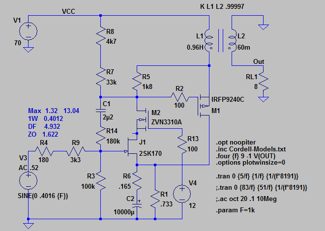

no changes, if schematic is followed by series of measurements
though , expect changes in Schade iteration , that one still needs ....... help
as Papa is used to say that Joseph Sammut used to say - this one need some help

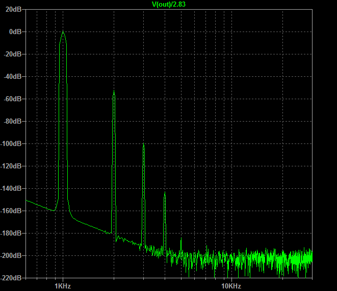

What do you find to be lacking?... Schade iteration , that one still needs ......
I'm guessing the sound still too sparkly. This last few days I just found out that a schaded half F5 acts very similarly to a SIT in terms of harmonic spectra. 🙂
well , I did it in LTS , while in vivo it's behaving little different , as always ....
