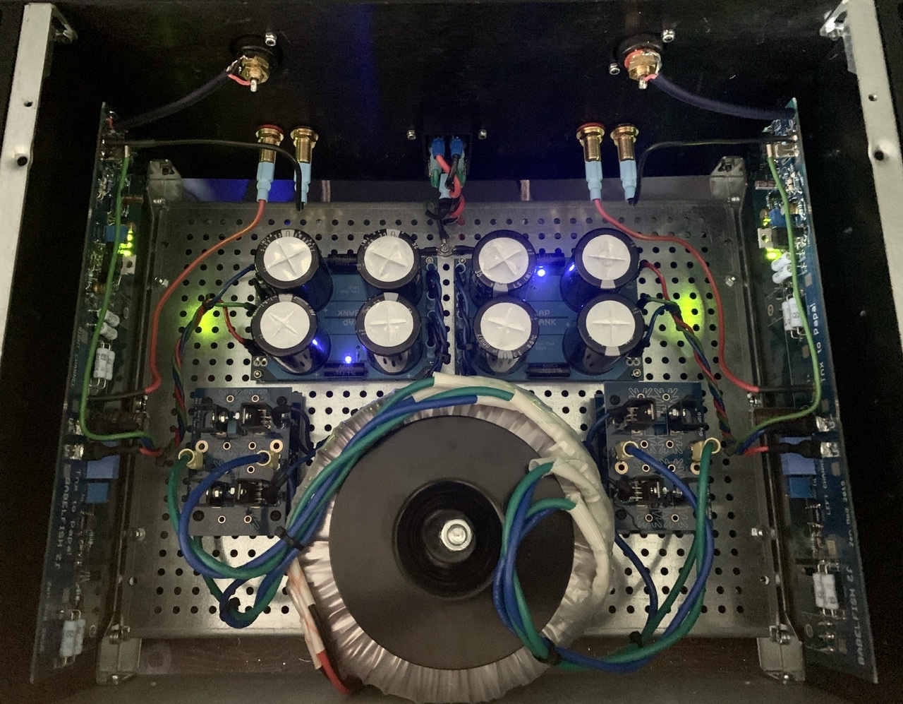

Smooth build, and great kit. WOW - this amp is amazing. Musical pinpoint machine of the highest order. Thank you ZM (and pa)!! I’ll have to redo my wiring, as this chassis has finally found a permanent resident. With that in mind - ZM, do you recommend taking speaker (-) from the board or PSU? I’m using single-ended, so I jumpered IN(-) to Gnd. Correct?

if your wiring is neat and tidy - thin for signal in and fat for everything energy related - it's pretty much same thing - take speaker return from Cap Bank or from channel pcb
neg in grounded , that's ok

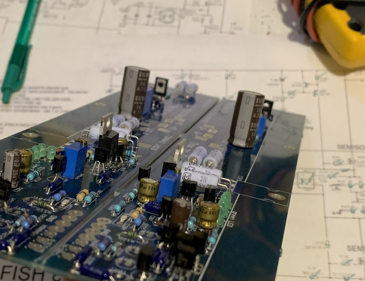

Of course I don’t have the patience to what for the testing jig. I’m sure it will come in handy again though. Revised my jfet sorting tray. I drilled a series of 5/8” dia. holes halfway into a piece of wood flooring with a forstner bit. Thanks for the idea ZM. Starting from the beginning testing until the reading settles. We’ll see how long it takes me to get through 50 jfets. 😀

enjoy in process of matching itself, that's great Zen practice

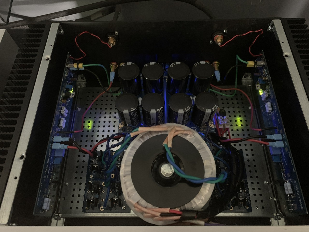

I finished up the ZM-ification of my ZMJ2. I was dealing with a bit of hum and took the opportunity to rebuild my PSU with ZM’s cap banks and NTC boards. Great PCBs, and my hum is resolved. It’s a pseudo-dual mono setup - I’m using the dramatically oversized Antek 8420.
Long story short, I’m still loving this amp! I picked up a pair of 90db Triangle’s and the amp really sings with them. That said, it still does an awesome job with my 85db LS50’s. They’re both 8R nominal with dips around 4R, so I guess it shouldn’t be too surprising.

Love the glow of those LEDs. 😉 Nice work codyt!
