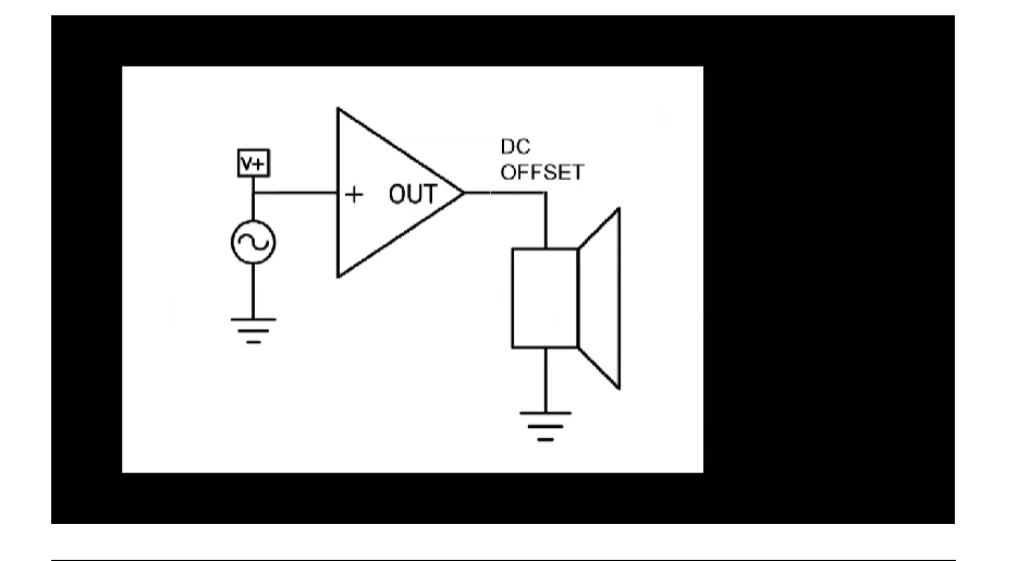

It is R.2 and I have put a 0R1 resistor in line with negative rail from PSU across which is my DMM.
Robin - with 68mV across 0R1 your'e at just 680mA of Iq
you need to dial higher Iq and only when you are having stable 1A4 or 1A5 , you can attend to dial DC output offset
so, figure of interest across your 0R1 is 150mV for 1A5 and later - 170 to 180mV

Offset keeps drifting between + and -30 mv, after lid on top and 30 min warmup I could not remember if I read it, but this is expected behaviour?

everything up to 100mV (hot) is completely normal - fo any amp around, except can amps
so - just readjust it when amp is hot and forgetaboutit
