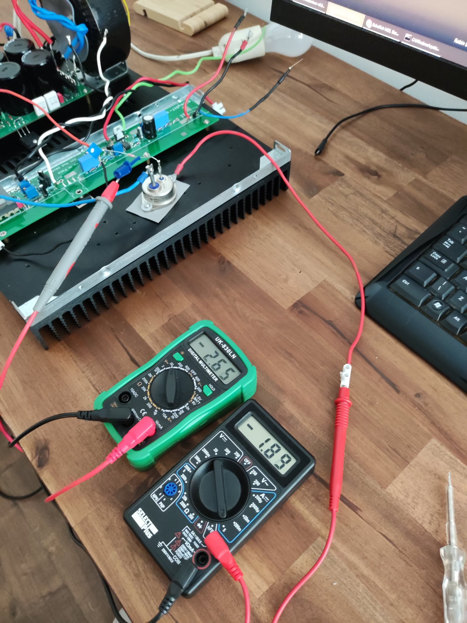

. So I soldered in the wire on r21. No luck so far, SIT does not seem to warm up so I measured PSU, which is ok. Then I measured only 5mV across resistor in line with negative rail (0R1 resistor). I did not change the trimpot so would be expecting 160mv. Where can I start troubleshooting? :spin:

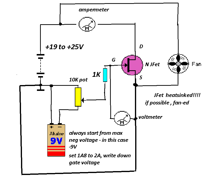

This measurement circuit?
Test setup with SLB PSU is ready. I've read the notes on the measurement circuit drawing. Just for my understanding, starting at -9 volts at gate of SIT means trimpots fully open, so lowest resistance, right?

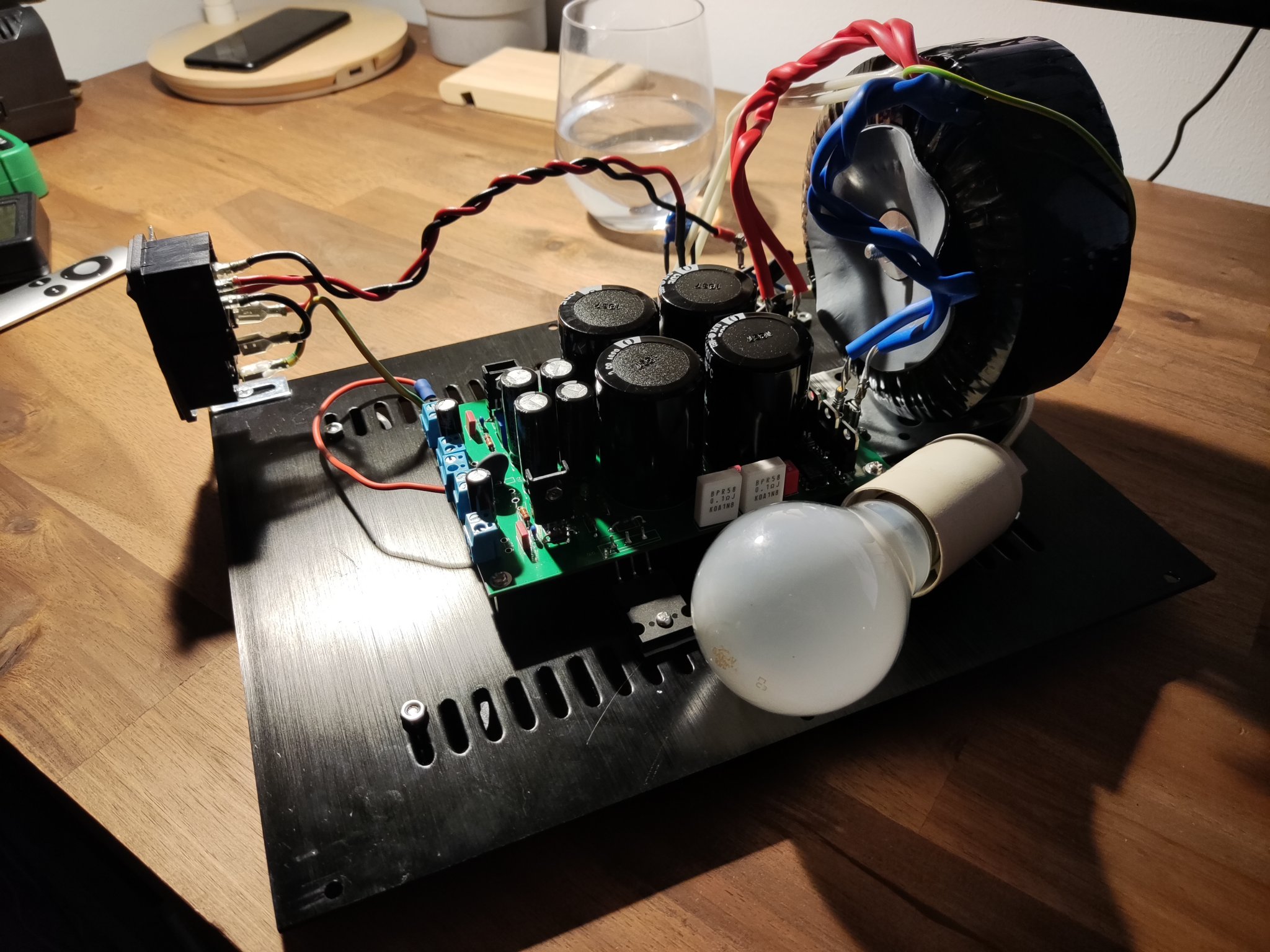

Can I try the setup with bulb in place (on positive) just for safety sake? As I turn the pot the bulb should glow increasingly, right?
After previous errors I'd made I am slinging the bulb in where possible😅
dunno about pot twiddling orientation - can't remember so I don't care - multimeter is thing I'm trusting always, in memory never
so - without SIT drain connected, feel free to check neg value on SIT gate, ref to gnd, and set it to lowest down (as much negative it goes)
bulb in line with SIT drain will work it's job only at start of testing/setting, while Iq is still low
clever thing is to include 3A15 fuse in positive rail; when everything done - you can leave it in, or move it out

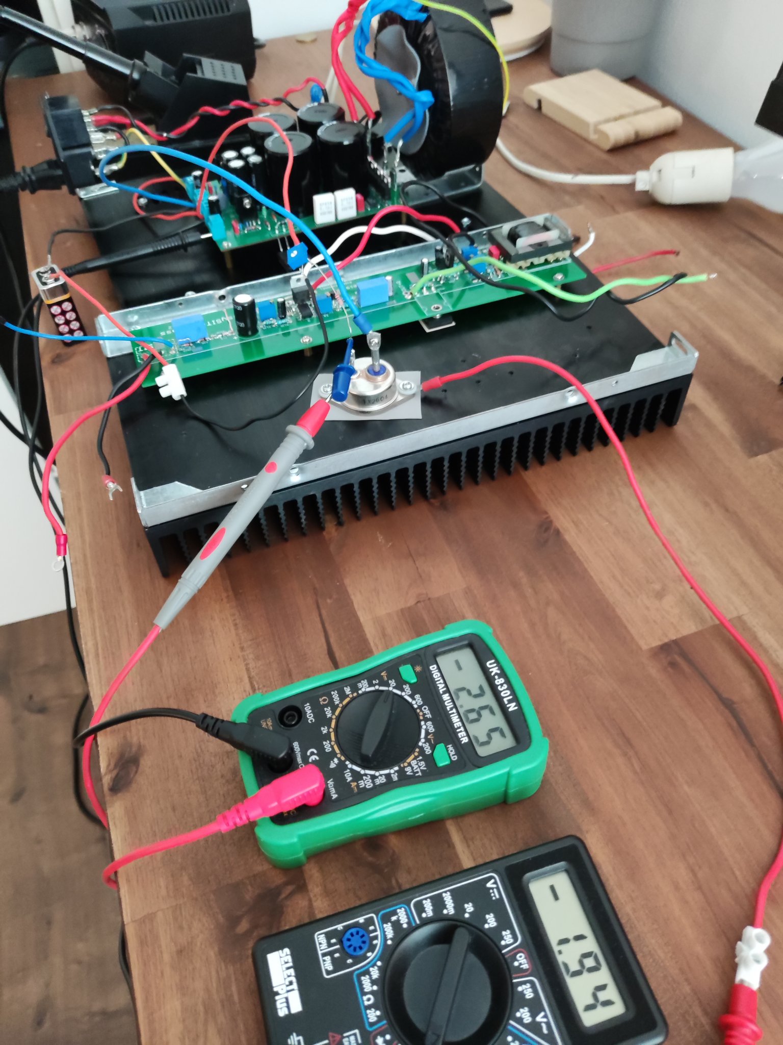

I have made good progress! Biasing up as we speak, slowly increasing to 160mv on negative rails. I did notice something strange. I shorted the input with solder wire. If the short is not proper, or if the input is not shorted, It lowers by approx. 80mv on the negative rails (to 80/90mv). If i short the input properly, it goes back to 160mv. Is this expected behaviour?
If so, how does it bias if you have the inputs not shorted after you have soldered wires to your rca connectors?
it is not expected behavior
there is no DC connection between input and output stage ( see that 10-22uF SIlmic) and input (voltage) state shouldn't influence output biasing in any way
is that the case with both channels?
it would be extremely handy that you have a scope, to check for any oscillations on output
no logic in that exactly, but Gremlins are above our Mortal Logic
though - be sure to recheck setting of input buffer - Iq (20mV across 1R) and DC Offset, rails voltage ( after cascodes)
