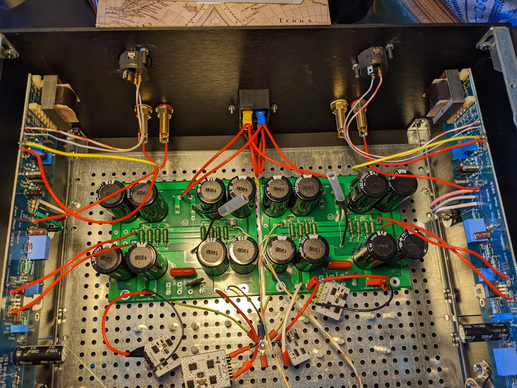

I have 2 secondary per toroid, 1 diode bridge per secondary, then two Firstwatt style PSU PCB, the 2009 revision with thermal switch (used without the resetting fuses) and all CL60 onboard (mains live & audio gnd) https://6moons.com/audioreviews/firstwatt11/board.jpg

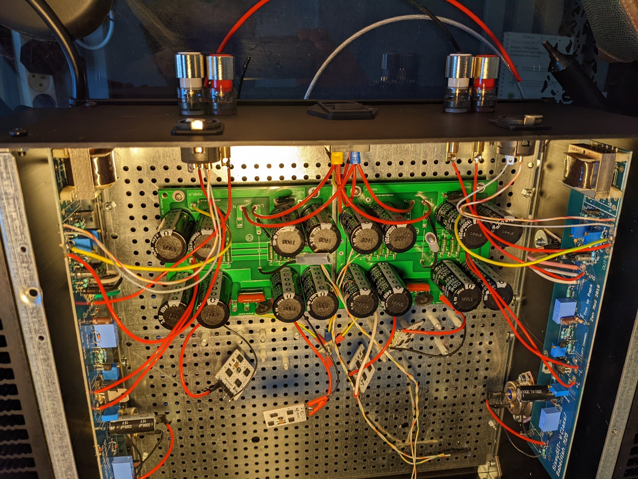

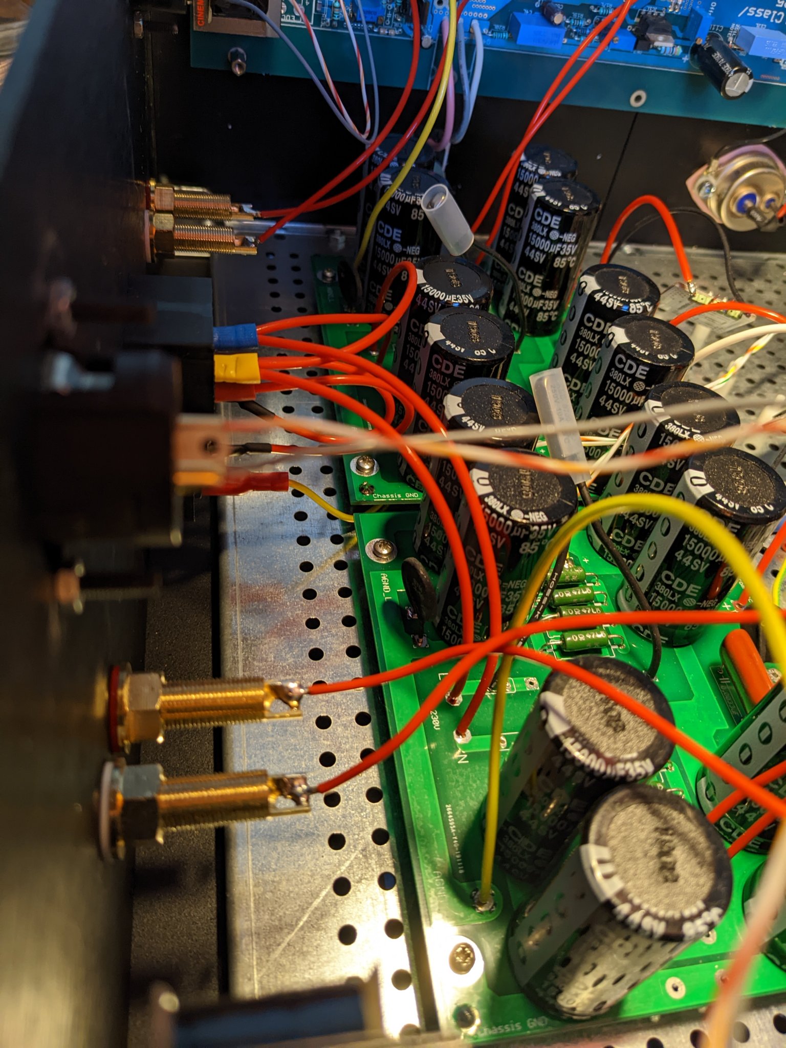

Sorry for the fat images, dunno how to make the forum system to reduce them.
Note that the mosfet rectifiers are in temporary state for testing, they need a PCB for proper use, and I'll be drawing one (my very first).

Looking at the PS board at the AC connection to the transformer, there may be an issue there.
1. There is no picture of your transformer so does it have only one primary winding?
2. Your sketch of your power supply wiring shows a thermistor from power supply ground to chassis safety ground. I do not see that in the pictures.
3. I do see a thermistor in the AC out location on the PS board to suppress the start-up current surge. I am not familiar with the FW PS board so I do not know if the AC surge thermistor is in the proper location.
4. I am not familiar with the wiring for the transformer to the AC out location on the FW PS board, and you do not show how you have connected your transformer to that location.
You may have connected the transformer primary or the AC input thermistor or both improperly to the PS board AC out causing a high current to run through the transformer, causing the buzz.

1- yes, single 240v primary
2- the ground lifting thermistor is a bit hard top locate, it's at the speaker side. You see it in the first pic, right behind the cap
3 & 4- i'm not using the mains lines as written on silkscreen. I may check again under the board if everything is nominal.

Zen Mod is probably familiar with the First Watt power supply board so if you post pictures of your hook-up, he will probably tell you whether it is connected properly or not for single primary 240VAC transformer.

I believe that these pcbs (Papa's Cap Bank) are in group of those I don't have any info about ( no files, in other words)
Frankly - I'm too much of a Chicken to combine mains and DC in Papa's way, so didn't even tried anything similar, except having Papa's original PSU pcb in DEFiSIT
anyway, it's easy checking with ohmmeter is there proper connection between IEC and xformer primary, situation being simple with single 230Vac primary, as we are usually having on this side of Big Splash
so - measuring at bare primary wires - reading X Ohms, when connected to IEC through Papaclone pcbs, same reading when shorting NTC pins, increased for 10-15R if NTC is included

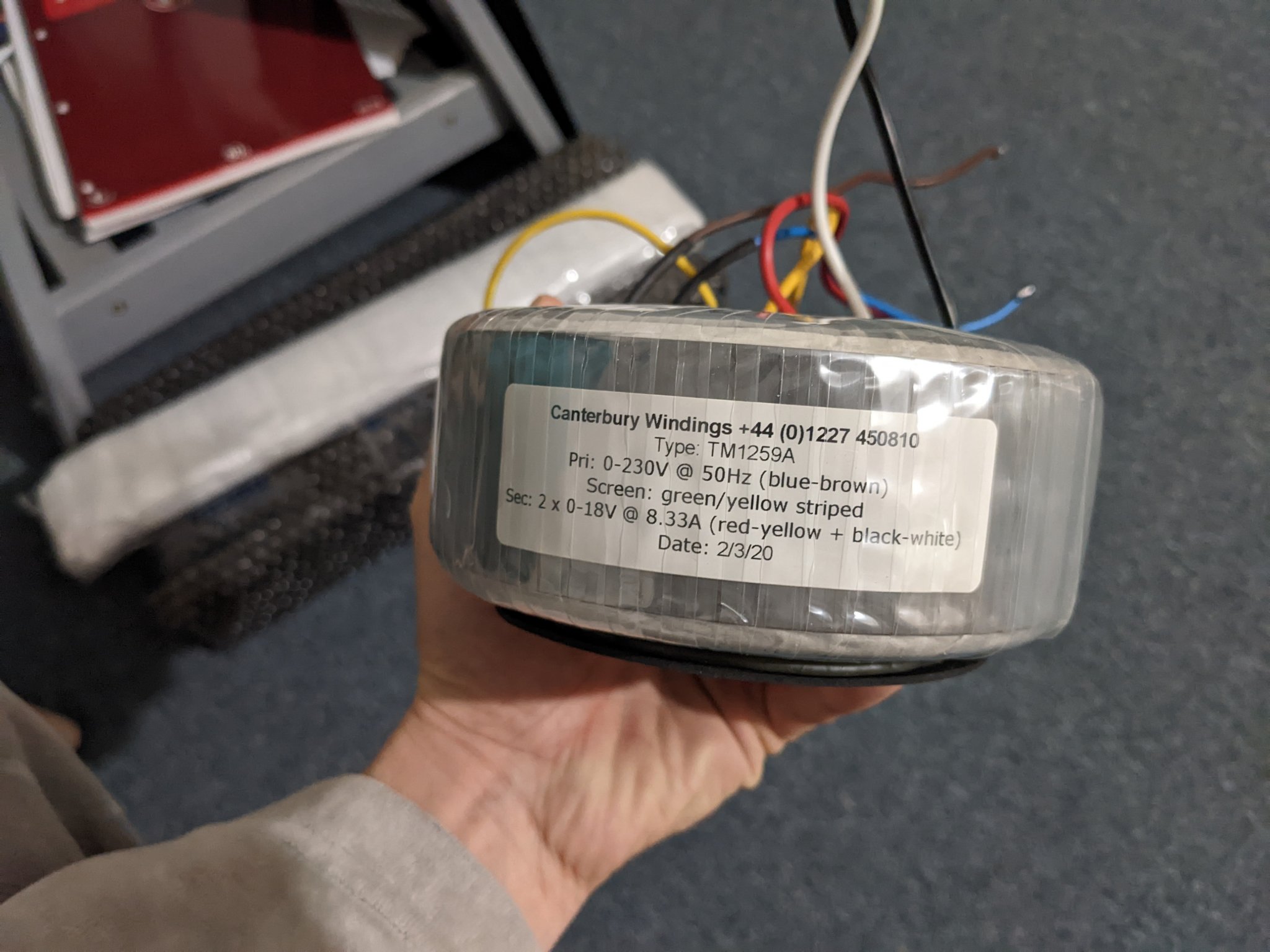

now, origin of Donuts, declared VA, pics pretty please?

Donuts are from Canterbury windings, 300va, static screen and goss band. They are BIG boyz.

Could a too tightly designed toroid buzz? It was designed for 230v, and I cannot recall the tolerance, but this may be the culprit?

If I narrow down the options of mistake to an overvoltaged trannie, the winder is okay for rewinding them.
It's the good part of choosing expensive "local" craftsmnen : they stand behind their products.

there is no need to exactly rewind them
he can add some additional turns for primary without butchering everything else, so you will have 230Vac and 250Vac taps
no penalty that way, practically just reworking some isolation and GOSS screen
