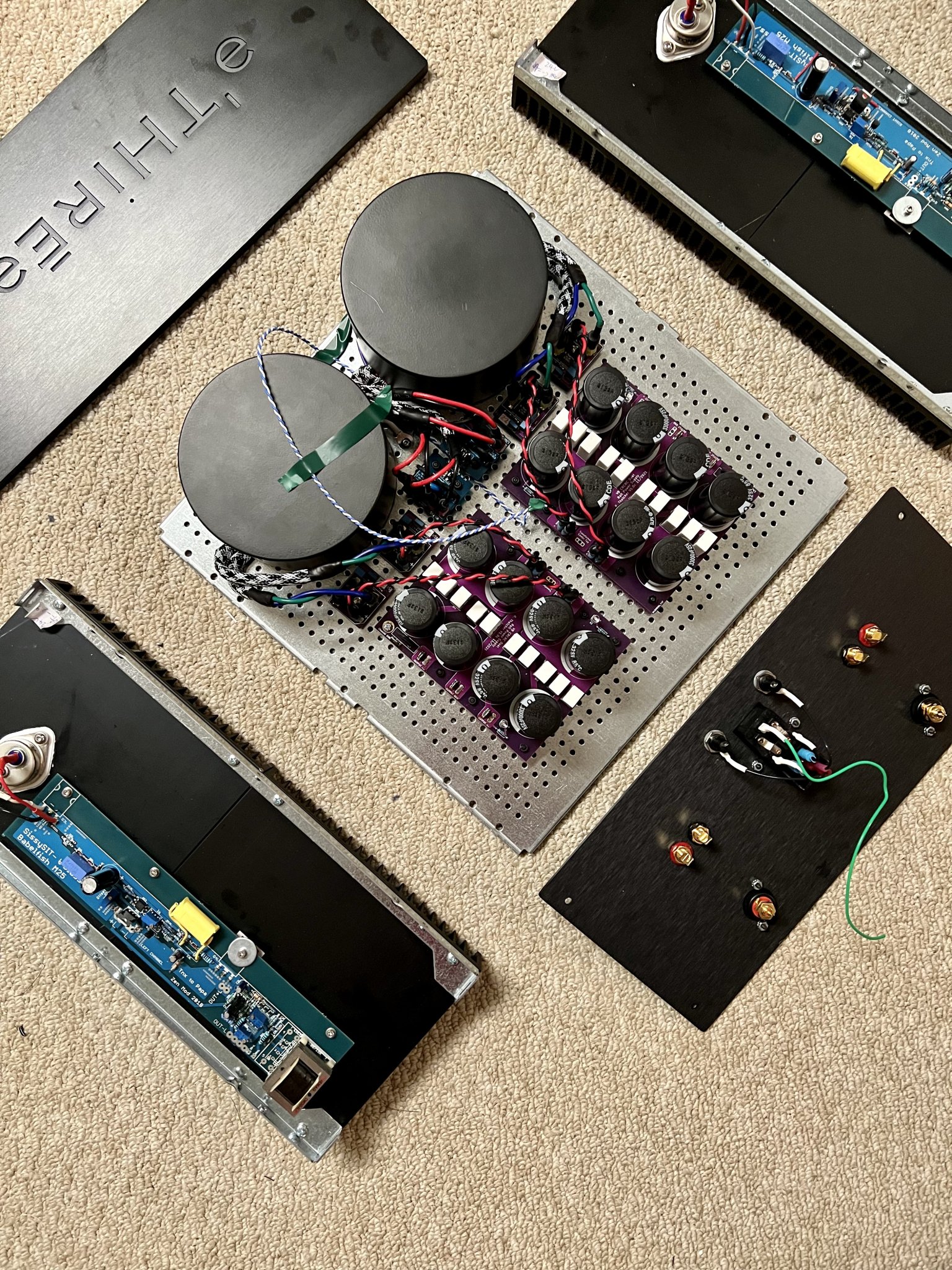

I need some guidance on the choose wisely part, I honestly don’t know.

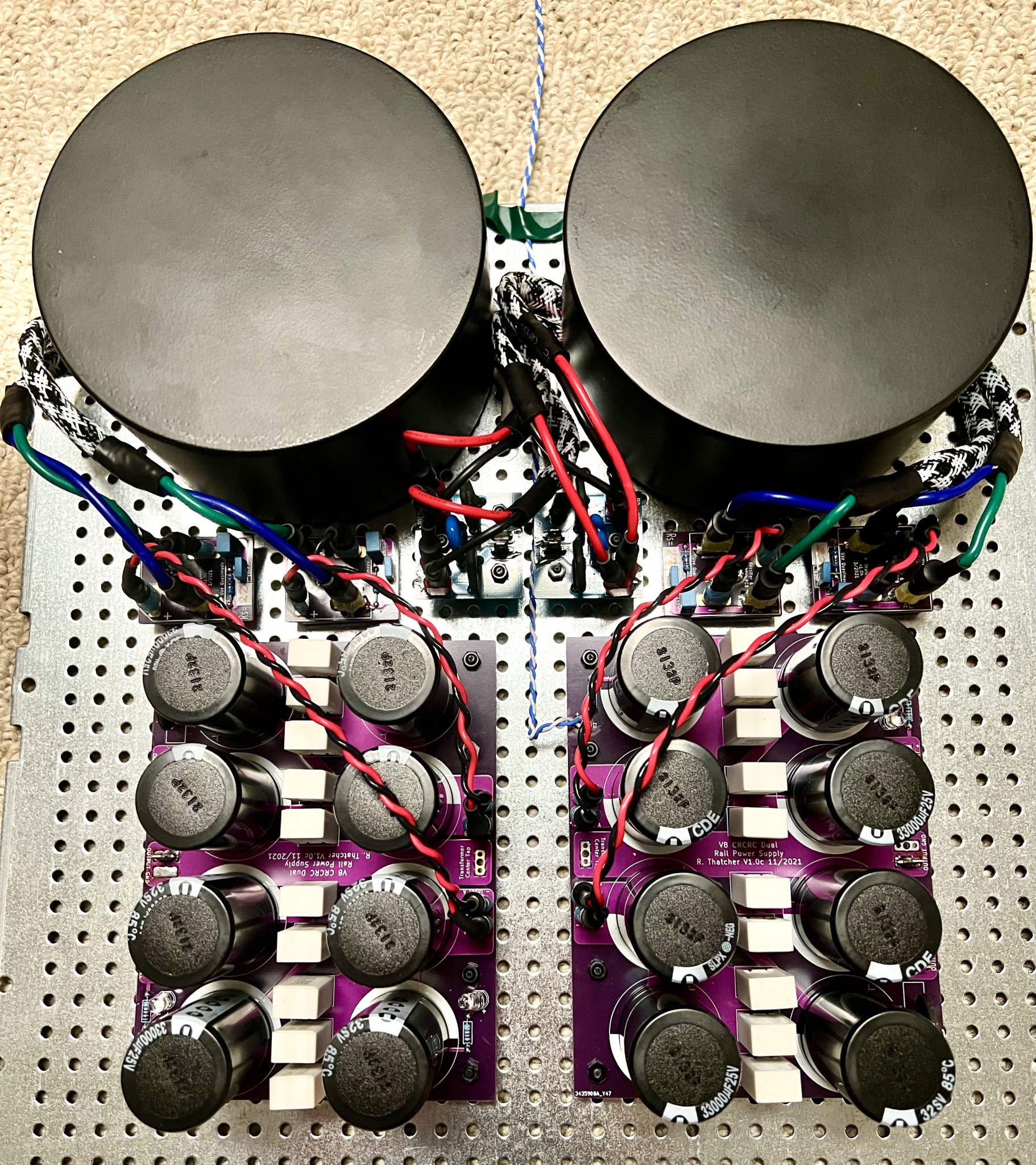

Donut VA/Mains Voltage = Fuse A
choose closest standard value
if you got often popped fuse during power On, means Soft Start ( whatever it is, I'm using CL60 as Pa) is not soft enough
in that case, increase fuse value to first next standard value
for mains, use Slow Blow, often marked ( in Europe) as "T" , most likely from German Trage (Umlaut at a, can't type that)
Getting started with the M25 Rev.2 🙂 And much inspiration in this thread :cheers:
I still would make an external psu, that's why I would like to know, does the psu itself (with 400va donut) generate so much heat that there must be ventilation openings on its chassis? Further, do I need thermal paste when using purple Keratherm 86/82?

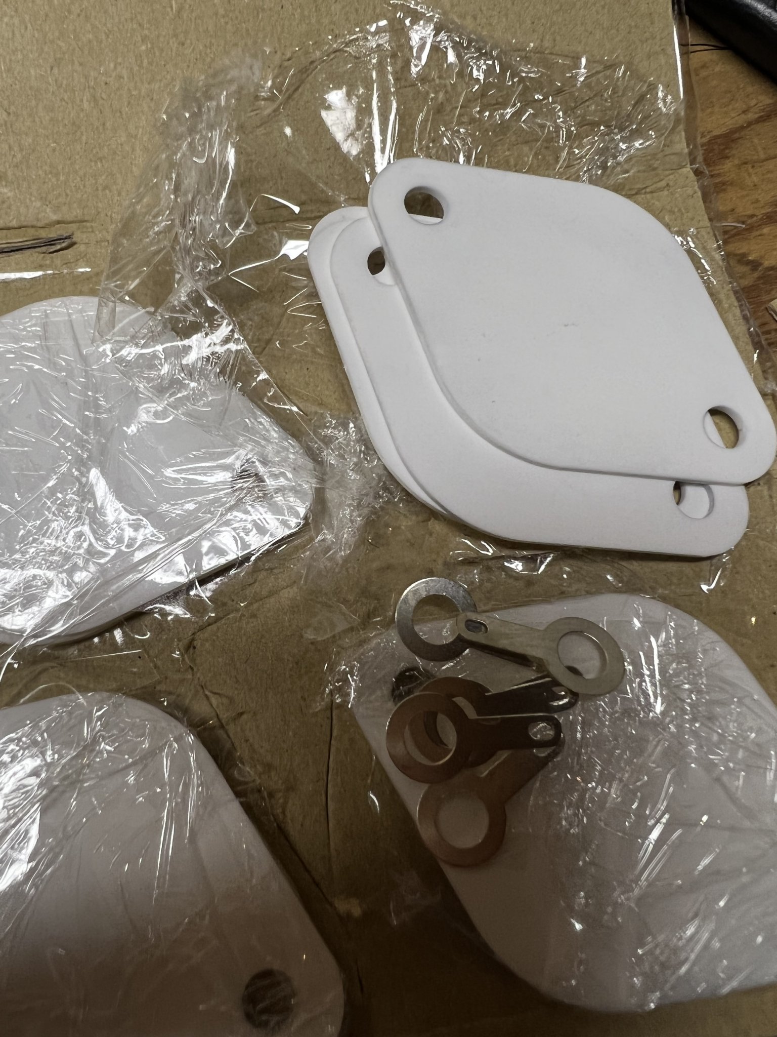

Keratherm, no goop, torque-meter (0.9Nm) very handy, to control squish

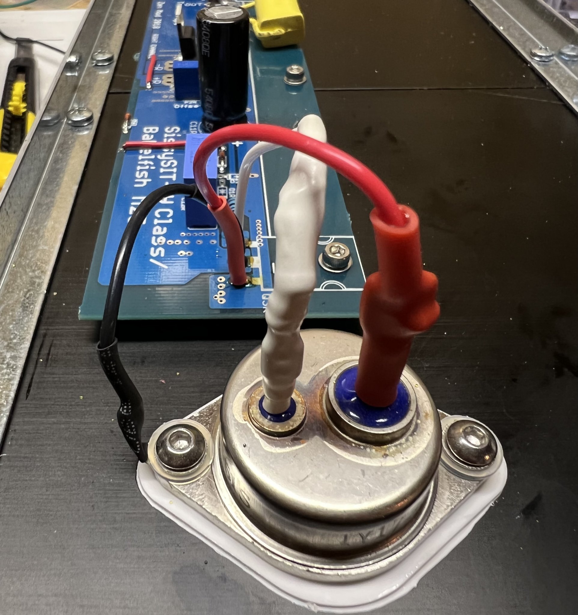

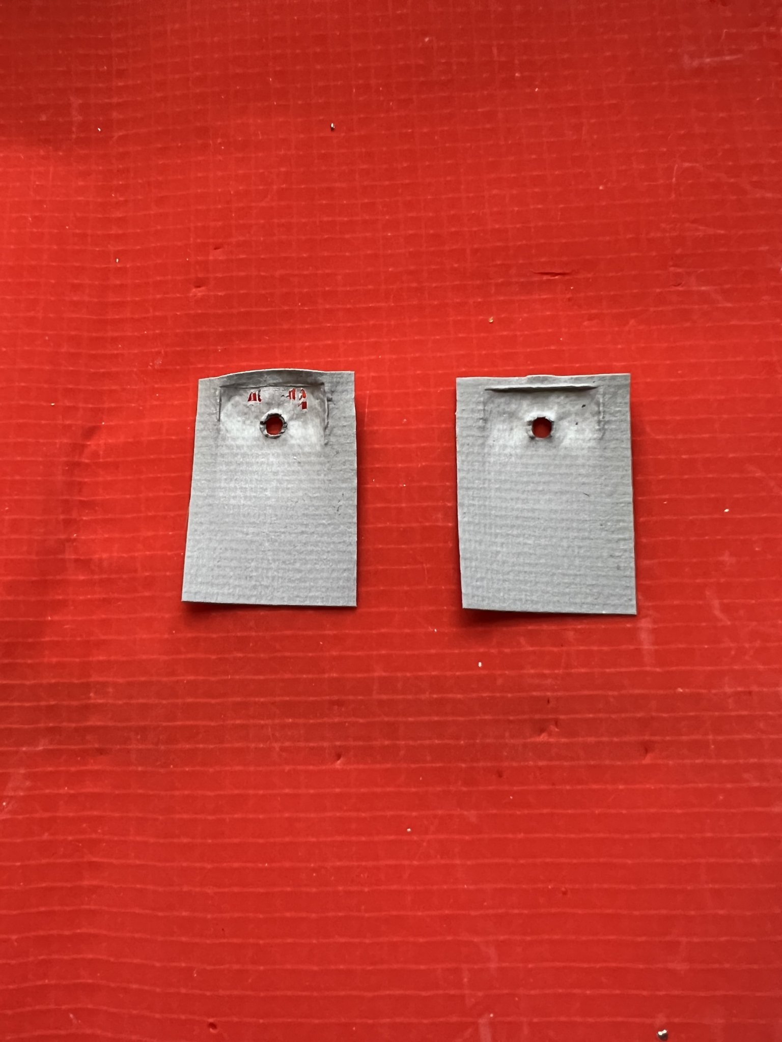

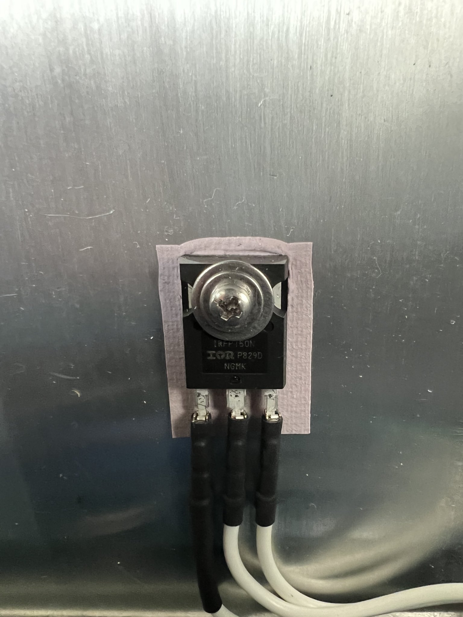

I recently became more concerned with “controlling the squish” when I was swapping out transistors in my BJ2.
I noticed the Keratherm was distorting and when the IRFP150 were pulled out there was an obvious uneven thinning of the Keratherm to the point where it tore apart in the high pressure area surrounding the mounting screw when I removed it from the heatsink.
I’ve seen others using coins to distribute pressure on transistors. I had stacked a secondary washer of larger diameter to try and help with that. I thought its smooth surface might be better than a coin. However, it doesn’t really seem to help much if you consider what the used pads look like.
I have been using philips head screws to mount with and really just torquing them “Goodentite” thinking that with that type of screw it would be difficult to get enough grip to over tighten them.
I did purchase some M3 socket cap screws to try mounting transistors with. I’m thinking its time to get a proper tool to torque them.

0.9Nm for M3, 1.2Nm for M4 and you did cover all possible transistor cases
screws - if you can't get normal steel ones in declared quality, use stainless ones
edit: Keratherm , if torqued to 0.9Nm, using big washer, ignore uneven/angled squish - it's normal
