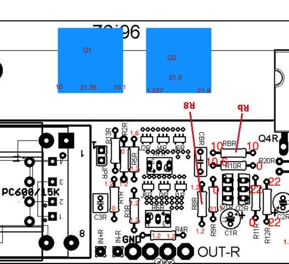

check voltages at Q2 pins, post #2081
you must be able to trace voltage, to find point where you have it and point where you don't have it

confirm polarity of C2, positive must be aligned with mark on pcb, thus positive connected to gnd
if that is OK
remove Q2, test it with diode tester or in any other way known to you
then check 10K resistors (R11, R12) with ohmmeter
confirm with ohmmeter that one end of R12 is connected to negative rail , other end to R11
confirm with ohmmeter that one end of R11 is connected to gnd, other end to R12
when looking at BD 139/140, letters to you, legs down, then you have ECB from left to right
something is not logical even with your Q1, which is supposedly operational - there must be difference between B and E voltage ; if you have something around Rail/2 voltage at B, then you must have 600-700mV lesser voltage at E

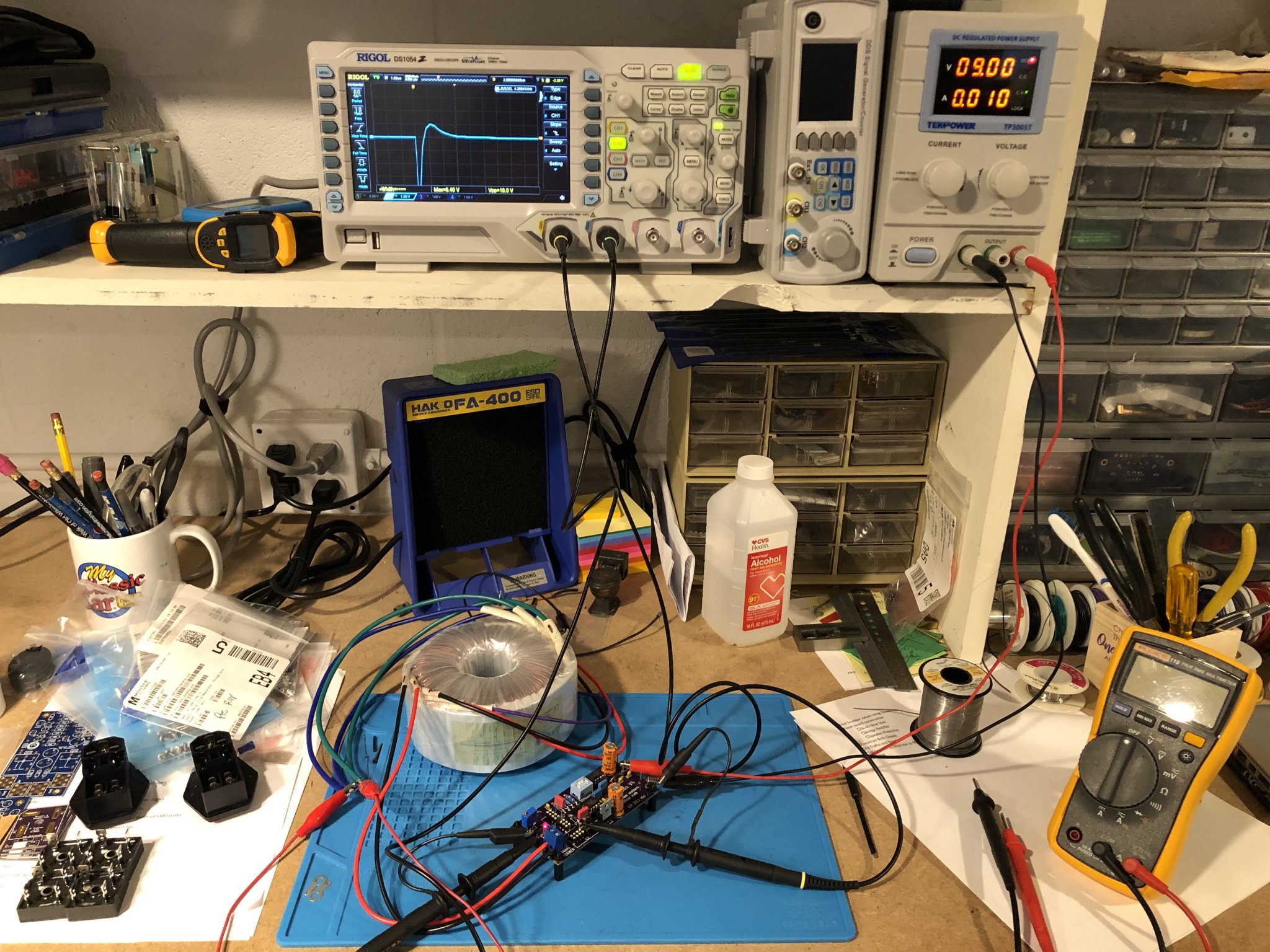

The buffer is FIXED 😁!!! Thank you once again! I replaced the two pots (they didn’t stop on one end, just spins), and I replaced the BD 140 and 139 (one showed up as a resistor in my mega 328 tester, and the other had very different values than the bag of new bd’s).confirm polarity of C2, positive must be aligned with mark on pcb, thus positive connected to gnd

Good work! The Mega is a great little analyzer for $15.The buffer is FIXED 😁!!! Thank you once again! I replaced the two pots (they didn’t stop on one end, just spins), and I replaced the BD 140 and 139 (one showed up as a resistor in my mega 328 tester, and the other had very different values than the bag of new bd’s).
trimpots are spinning in both ends, some not clicking at all, some clicking just on one end, some clicking on both ends
so, only ohmmeter can confirm is trimpot OK or not
all trimpots I'm sending in kits are checked
now, what you really did to loose negative rail, I can't figure out from information you gave
anyway, it's OK now, that's what counts 🙂

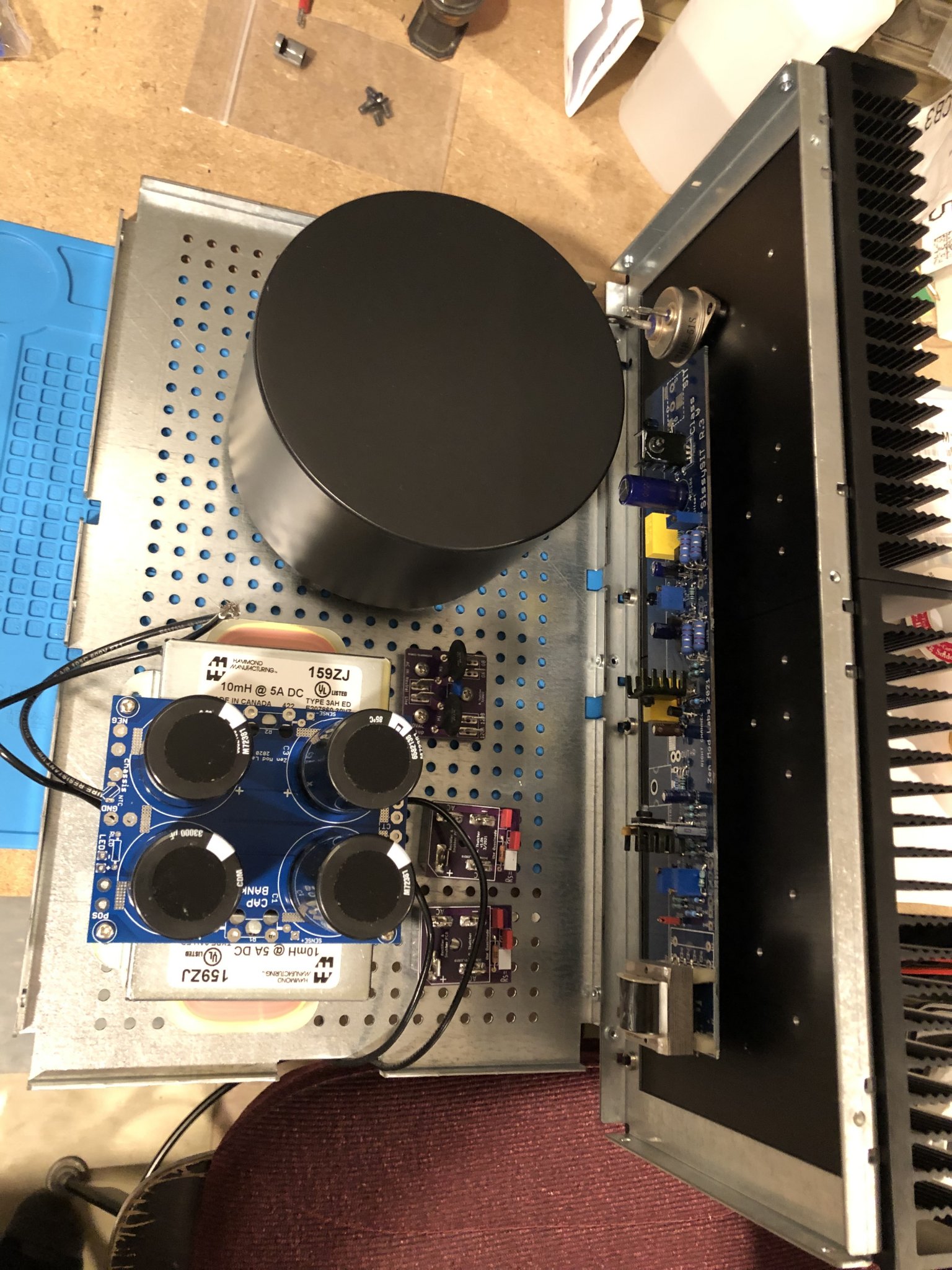

Thought I would share the progress I am making on my SissySIT R.3 . After assembling the boards, Quasimodo led the way on the R value for the Snubbers. Scratching a particular diy itch, I decided to go with a Hammond 159ZJ based CLC PSU with 33,000uF Cornell Dubilier 380LX caps. These caps have a 6.84 amp Ripple Current, which along with the Hammonds, ought to keep things smooth, quiet and under control.
Next up, I am playing around with component placement in the Modushop monoblocks. Then wiring. Then component testing before finally lighting these puppies up to crank out some sweet sounds.
