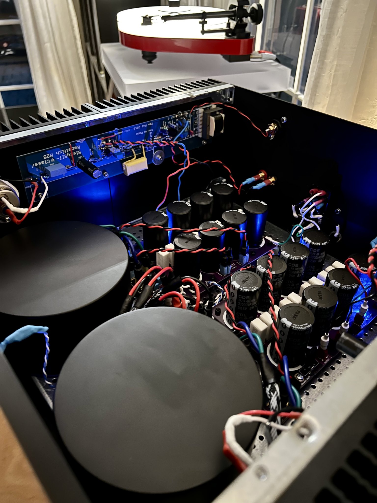

Looks great!Time for the lid to go on and bake for a while 😁

It’s up and running and sounds amazing. Super spooky.

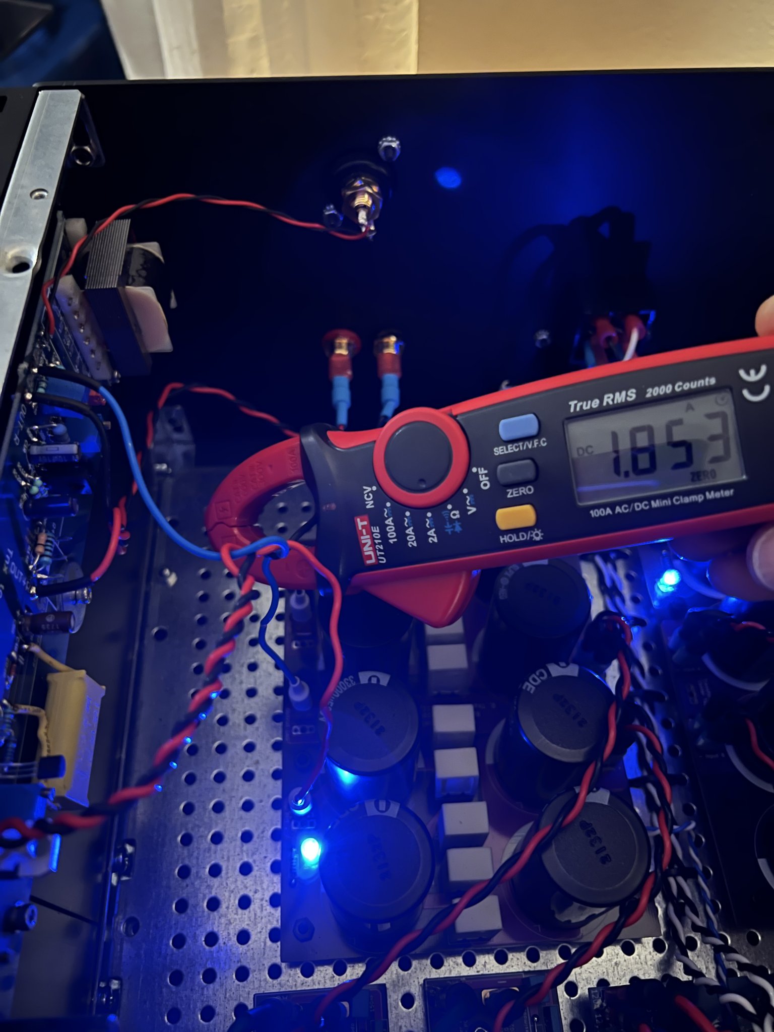

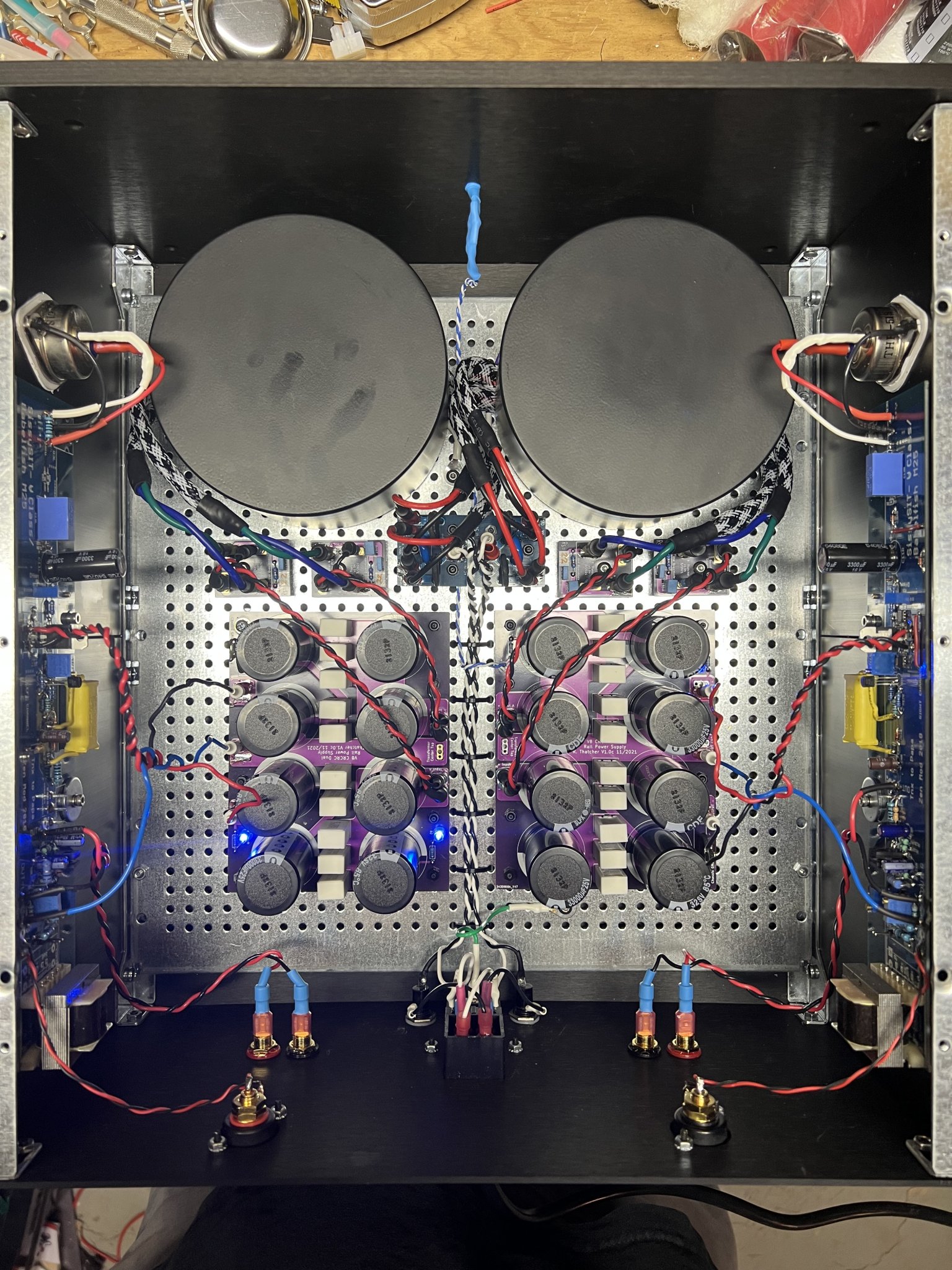

I did something dumb. Instead of leaving well enough alone, I decided to redo the whole biasing sequence after the amp was on for a while.
When I put the multimeter across R8, R6 (pot) does nothing. R8 reads 1.6mv. Do I assume the pot is bad?
Actually it’s worse. It’s both pots on one side that (R6, R7) do nothing when turned. Pots will only click in one direction. The other side is flawless.I did something dumb. Instead of leaving well enough alone, I decided to redo the whole biasing sequence after the amp was on for a while.

cool it down, remove jumper between buffer and autoformer
set R6 trimpot (which Fool named trimpot with R, instead of P??) to max ohm readout across R4 - somewhere around 23-24R (39R//100R)
set R7 trimmpot arbitrary in middle position; confirm with ohm readout across R5
power up again, observing (mili)voltage across R8, set to 20mV rotating R6, set 0mV at jumper (buffer output pin) rotating R7
all ref. to schm in post #1
if/when everything OK, put jumper back

Across R4 I am getting 0.0mv. Do I need a new pot?cool it down, remove jumper between buffer and autoformer

Something is off I can get much higher than 23-24 ohms across r4 on the r6 potI said Ohms
meaning amp is powered Off while measuring resistances
Maybe I did something wrong earlier, i got like 80ohm, now it’s max ing aroumd 30ohm (p6,across r4)
But when I then pwr on, i can only get a reading of 1.5-1.7mv across R8 no matter how much I turn R6Maybe I did something wrong earlier, i got like 80ohm, now it’s max ing aroumd 30ohm (p6,across r4)
first carefully (with probes, easy to slip ) confirm that you have around +11Vdc at top of buffer and -11Vdc at bottom of buffer
for lower one - any side of 1R resistor
for top one , RBR resistor ( as I see , you have original/starting iteration of pcbs)
ref. to GND (black probe to GND), nomenclature by schm in post #1

RBR to gnd is 10.64v, side of R8 to gnd… 0.5vfirst carefully (with probes, easy to slip ) confirm that you have around +11Vdc at top of buffer and -11Vdc at bottom of buffer
