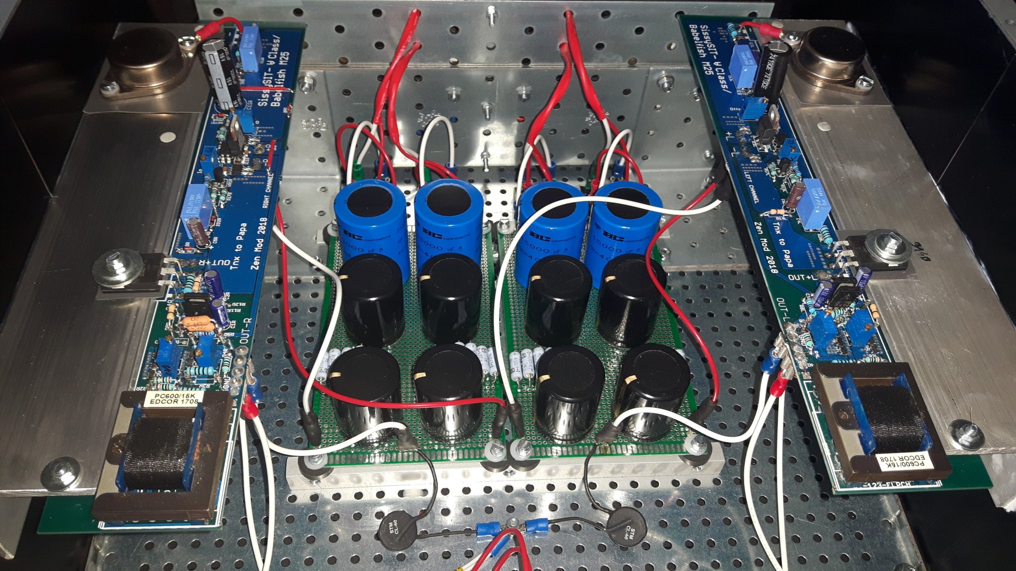

what happens if the irf9140 fails in the SissySIT and the SIT continues to work (SK180 in my case)?
After 4 years of music I suddenly fried a woofer of my Adamantes when I turned on the device (very bad experience).

well, dc on output, unfortunately
though, SIT is so robust that it certainly lives
logic of your mishap is that mosfet simply gave up, tired of heat
what was your thermal arrangement for mosfet?
mobile modushop 5U / 400mm. the transistors are placed on 4 mm aluminum angles. Temperature around 50 ° C of the heatsinks
I see gray drek under mosfets, certain recipe for catastrophe
use either Keratherm 86/82 or Alumina pads with goop

The angle seems a bit thin at 4mm. It also looks like the mosfet is not fully on the angle. There seems to be a bit of overhang. When temperature is at a critical level, every little bit makes a difference, including the thermal interface as ZM said.
Since the mosfet is mounted on the angle, the heat sink temperature is not a good indicator of mosfet temperature, especially when the angle is thin. The angle is offering some thermal resistance between the mosfet and the heat sink.
I fully agree with the factors enunciated by both ZenMod and Ben Mah.
Maybe I should have used Keratherm and maybe I should have considered using the angle exclusively for the SIT.
I was too confident and paid with a lot of pain.
Unfortunately you learn about mistakes.

and I don't remember that you posted pictures of build, earlier .... or I would react about squishy silpads and maybe even thickness of L profiles
5mm is really minimum thickness (though, it still looks as 5mm on pictures)
if you did, sorry that I didn't spotted it

when you have TO247 mosfet heated close to 40W or even more, it's clever to use speaker protection
heck, one of the ways is to make it (protection) as separate unit; I'm not so anal about few connections more in speaker cables
