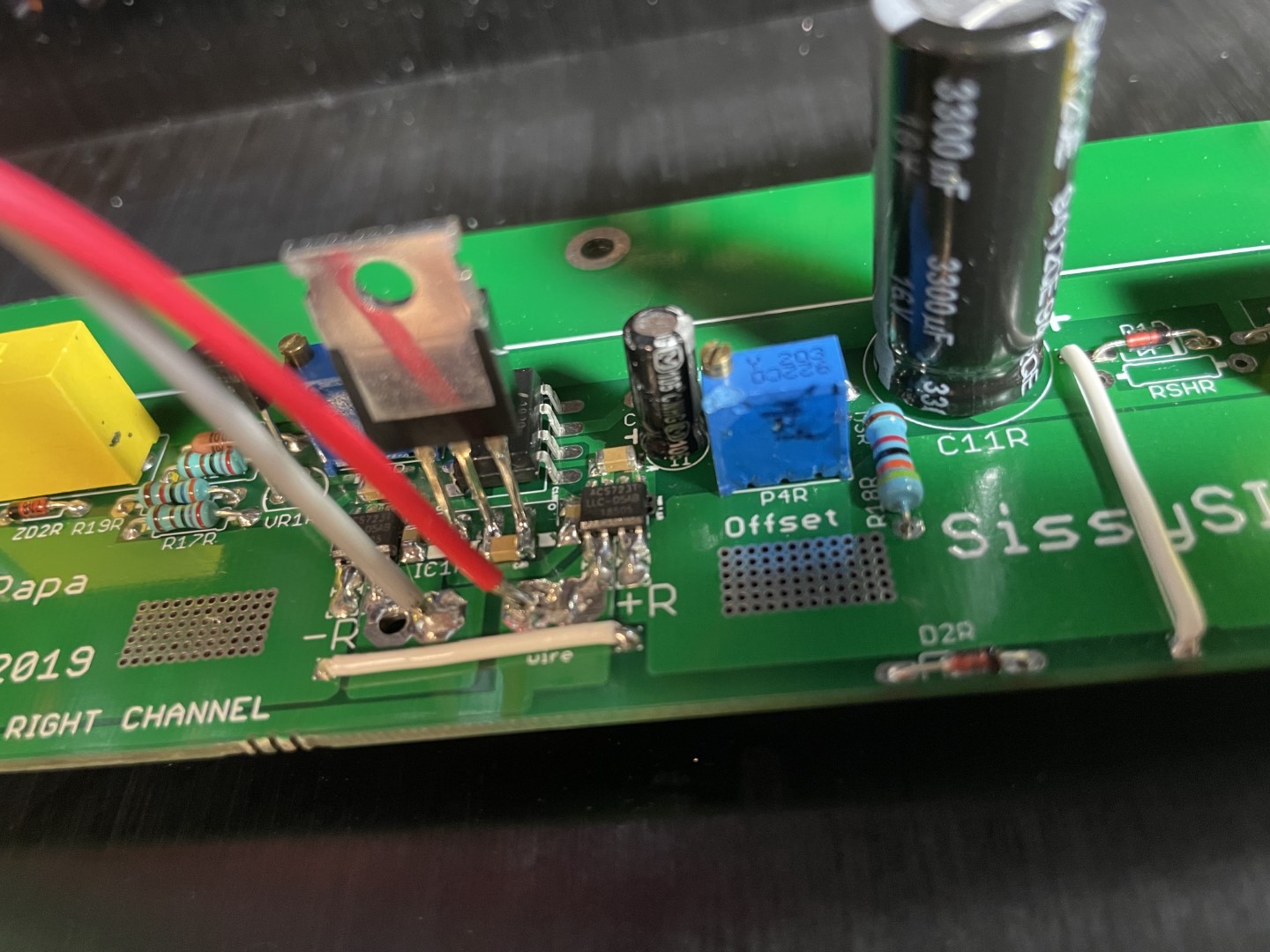

replace 5V reg, if you found there is no 5V
uneven loading of rails, when something is not operating normally - who cares.......
when channel is repaired, it'll behave
if 5V reg is Dodo, no use of thinking why - most likely you made some contact while re-assembling; reg is not in critical position in any case - rails are far from critical for 7805, loading current is small ......
well, if you can't see/find some obvious short between traces or pads, then first is to desolder caps
value of SMD caps - 100nF to 220nF
frankly, I can't imagine any other scenario than unfortunate short somewhere in your process of relocation of pcbs
I know it's tricky working with SMD parts, but that is pretty much sole possible solution to make it, without having square foot big channel pcb
besides - there is no bigger ACS package ...... only smaller
of course , 7805 is for replacement (even if maybe operational, it was stressed), hopefully after you find culprit what's wrong

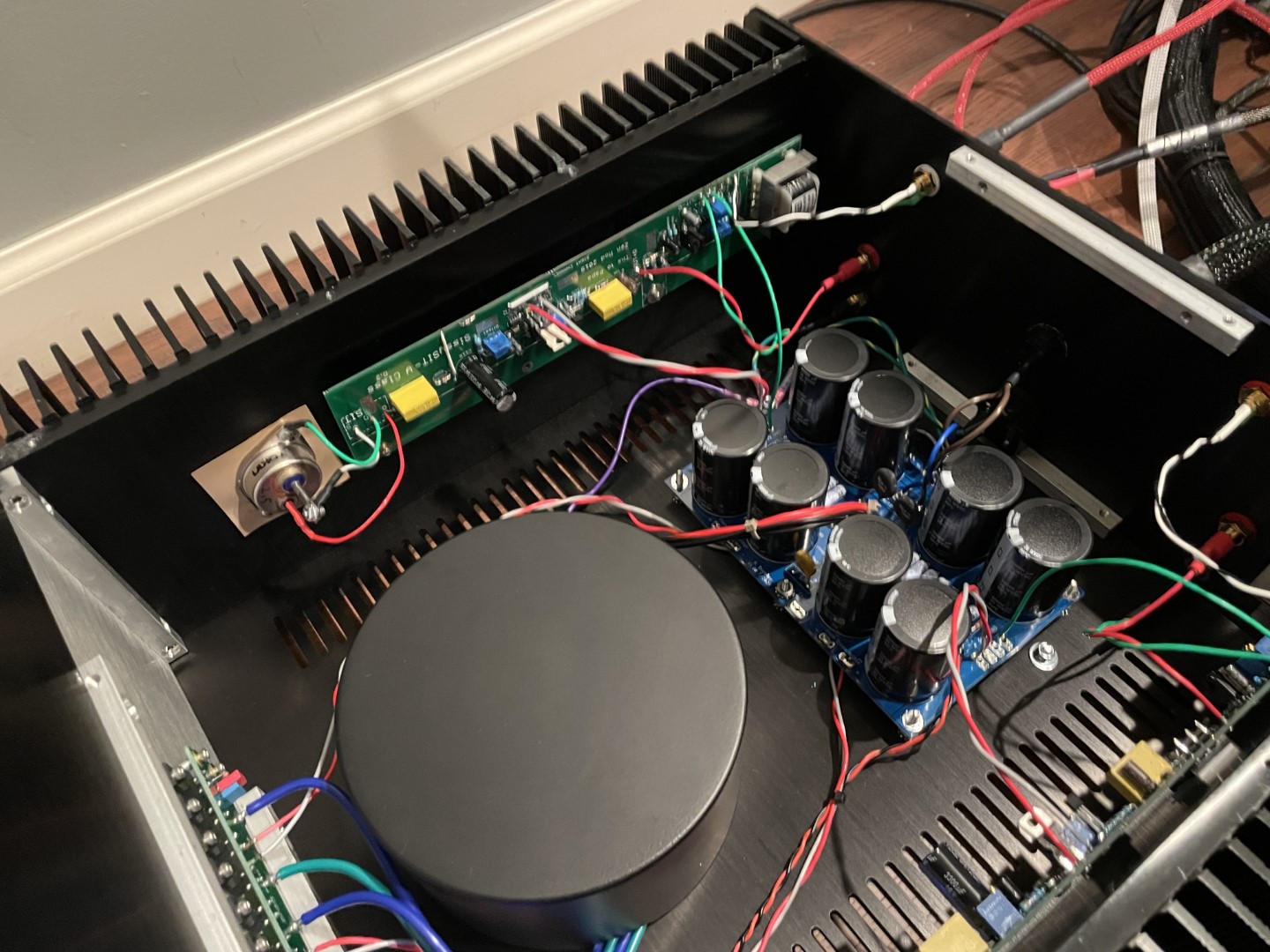

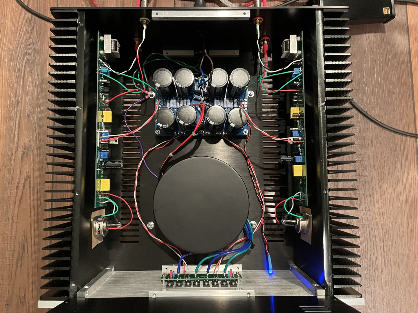

Turns out it was one of the SMD caps or who knows some whisker of solder under one of them that was shorting. Once I pulled those, resistance was back to normal. R and nF of those two once pulled seemed fine too?? Oh well... Had a couple 100nF from muses build of even smaller SMD package size, but made it work and it fired up like 'normal'.
One difference on this channel it did not startup at ~0mV Iq, more like steady 40mV at 0R on Iq pot. Everything reacted fine from there and I was easily able to dial both channels to ~1.8A and about 0mV offset without trouble. On startup the problem child channel was about a half second ahead of the other as they bias up to probably 2A, then settle back to 1.8A right with each other as they heat up.
