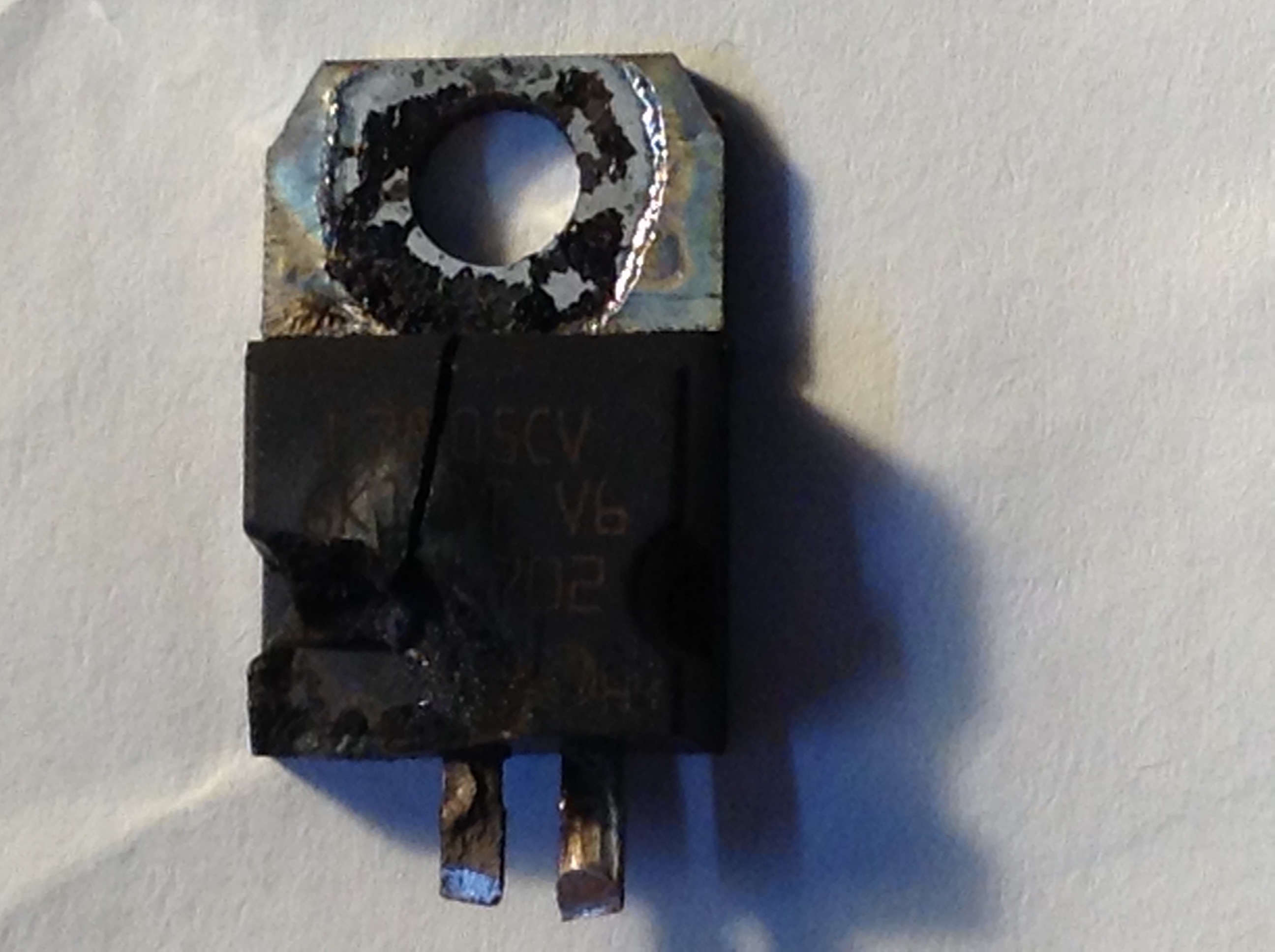

after disassembling and reassembling my M25 I got sloppy and confused some wires
(+ & -) after rectification capacitor-board input on left channel.
thinking all was fine i switched the brat on and left it (and the room) for some 20minutes -
coming back into some smelly ...
fearing the worst i flipped the switch off.
after the smoke vanished i saw a charred 7805.
did put a new one in and after eliminating my mistake flipped the switch again.
everything works within its prescribed parameters.
even the fleashit SMD resistors (or caps?) survived the misuse.
all hail to ZenMod!

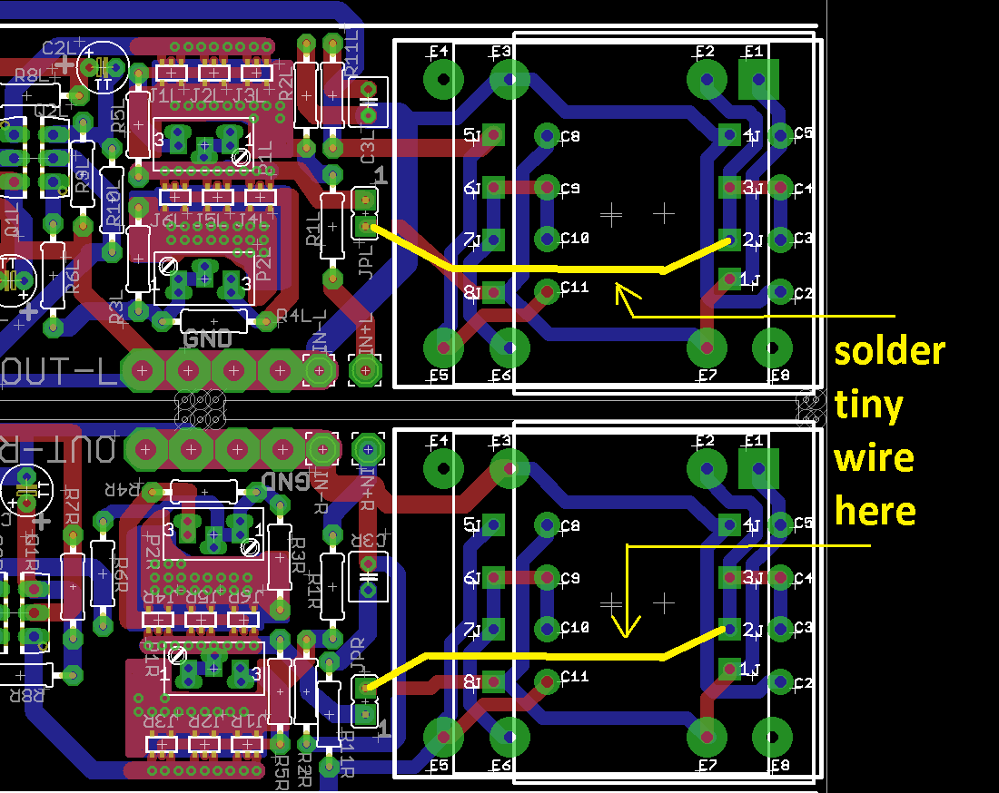

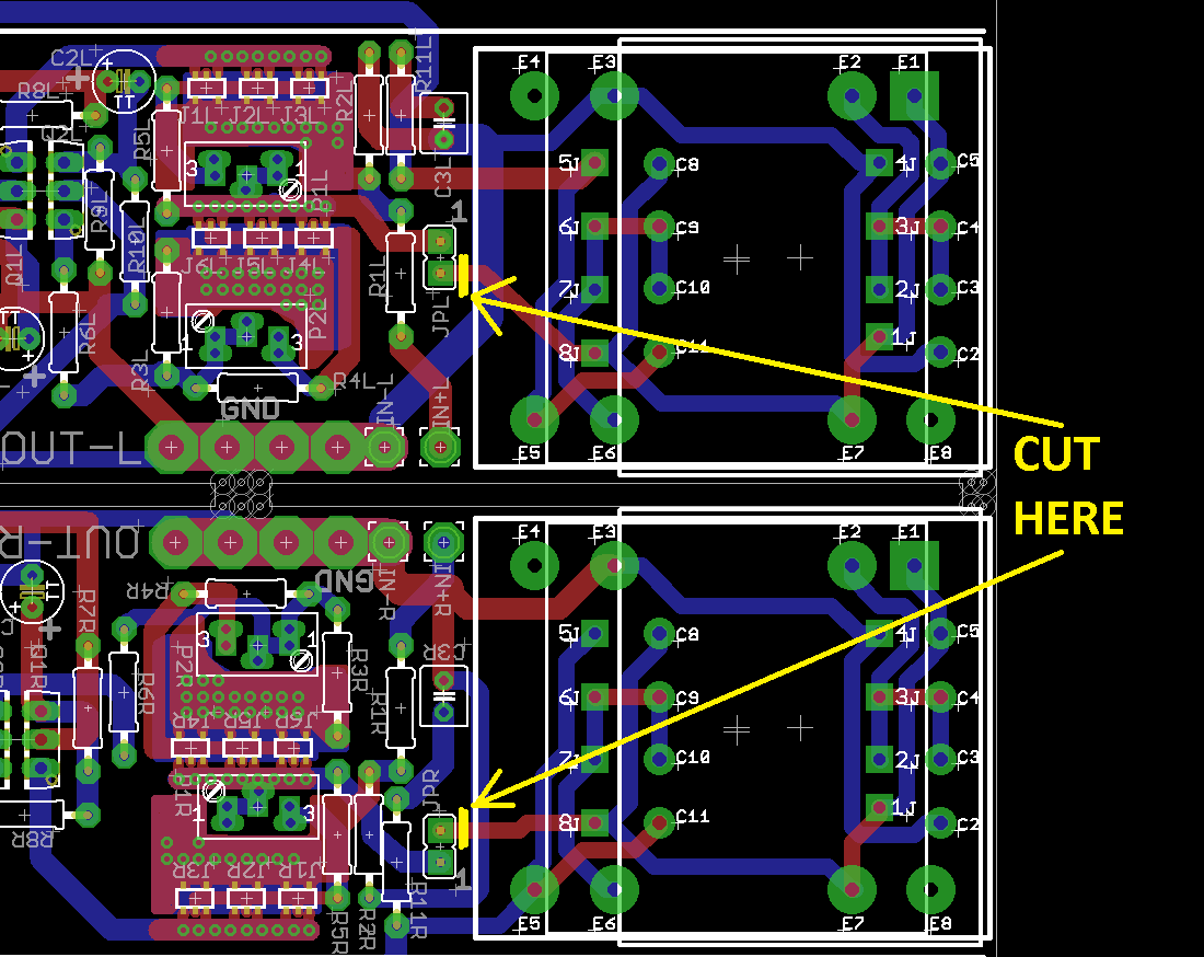

SissySIT R2 pcbs Xformer wiring fix, graphical files
Boyz and Girlz
I made a major mistake with SissySIT R2 pcbs*** ( besides that one with short between two resistor pads) - resulting in fact that with (wrong) Edcor 600:15K there is normal expecting gain, while with (proper) Edcor 600:600, prescribed Jensen and prescribed Cinemag - there is gain of just 6db , instead of 12db
bummer was while I was mental juggling with two Edcors and Cinemag and Jensen , among several other things always incorporated in pcb optimization, I made a mistake and took Edcor 600:15K in option , even if his 600:600 cousin is intended for use
so , fix is easy, both channels - cut one tiny trace , solder tiny wire from point A to point B
will post graphical info about fix tomorrow, now going to deeeeeeeeeeepest corner of room, to be embarrassed for a while
****that one having 6-legged optocoupler and just soldering pads for SIT ( instead of proper footprint for P channel mosfet)
So recapitulation :
- if you have Edcor 600:15K, do nothing , you're good - you have 6V/V gain, which is 15.5db
- if you have Edcor 600:600, Jensen JT-123-FLPCH, Cinemag CMOQ-4LPC, Cinemag CMOQ-4HPC , you have 2V/V gain, 6db , so we need to make fix shown on pics
xacto knife and tiny wires are all you need, besides good will to pardone moi for culpa, maxima :rofl:
for both channels - cut on upper trace going from jumper pin to xformer pin, then solder tiny wire (either on top side or bottom side, suit your self) going from same jumper pin to different xformer pin
Voila! there is 4V/V gain, 12db

So recapitulation :
Thanks Zen Mod!
