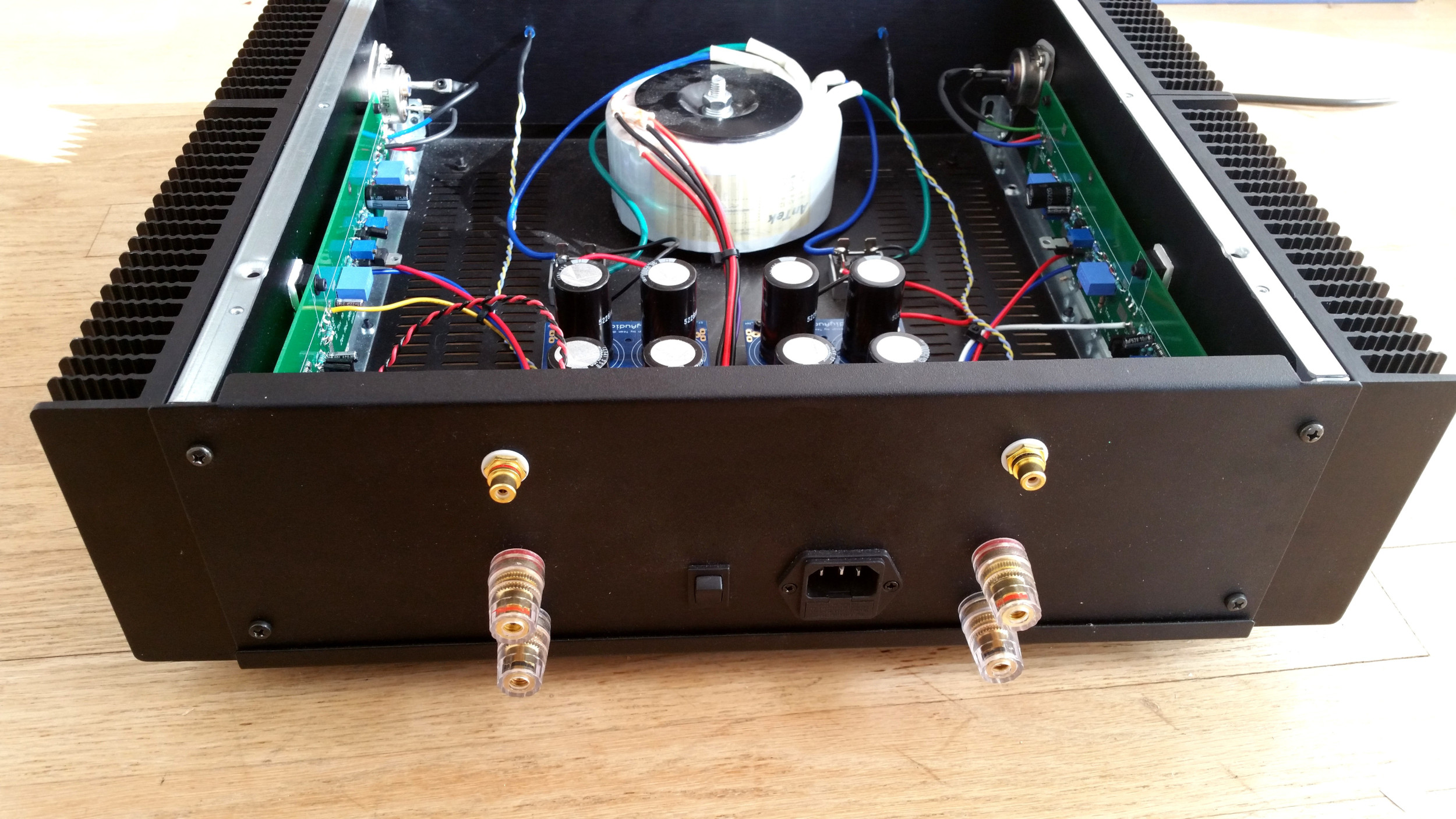

Well I was able to figure out the problem I. My right channel. It was a broken wire from the RCA to the PCB. Still a PITA replacing it, but better than the alternatives.
I was able to dial the bias in and the offset only drifts a little 10-6 mv in the right and 15-5 mv in the left.
Now time to take the amp off the bench and put it back in the system.

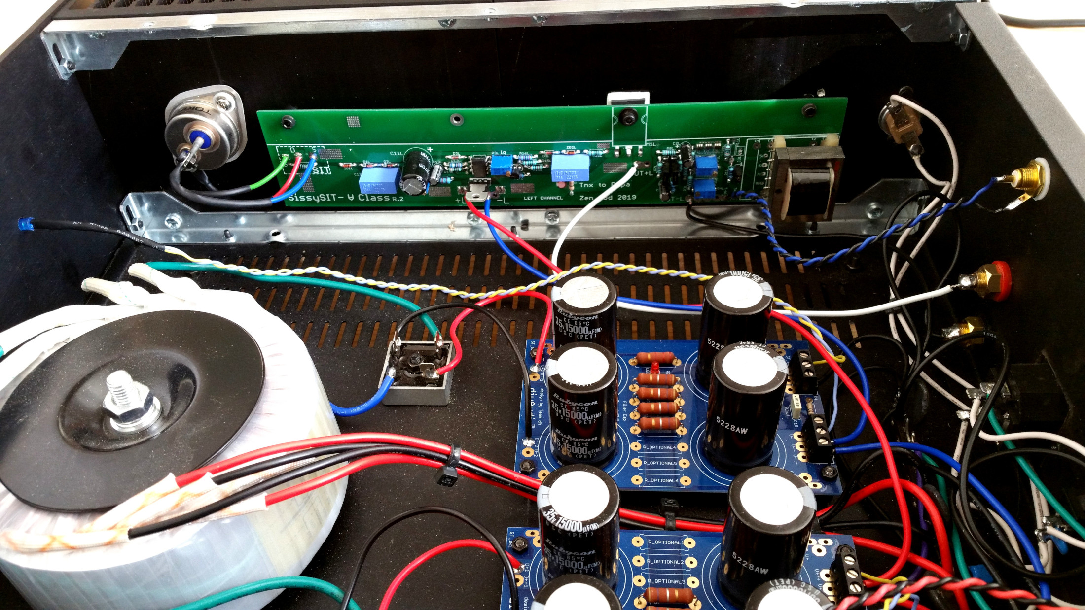

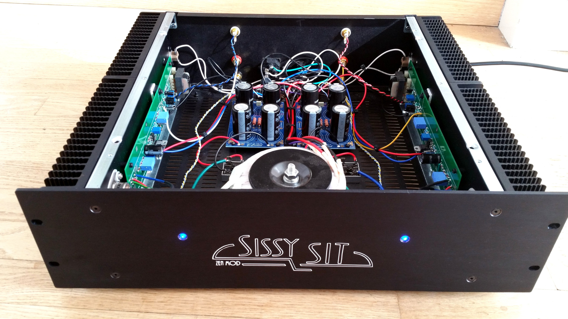

My Sissy is making sweet music now!
Thanks to Zen Mod for an awesome design!
And of course Nelson!
Prass got me a new set of THF-51's with the right
VGS and the system came right up!
Here are photos for inspection by Mighty Zen Mod!

Celebration for one more SissySIT joining the world!!! :cheers:
Is that the 3U/400mm case? What are your temperatures like with the top cover on? Did you get the back panel pre-drilled or did you drill it yourself?
Very nice amp! Are those thermal switches on the heatsink at the back?
This build deserves a 'fugly'!!! :cheers: :cool:
Thanks! Just finished it last night.
Yes, only had a 3U/400 case to use - we'll see how it works.
I'll transplant if I have to.
I have 75C thermal switches on it.
I did the back panel with step-drills, dremel cutoff wheels, and some filing.
