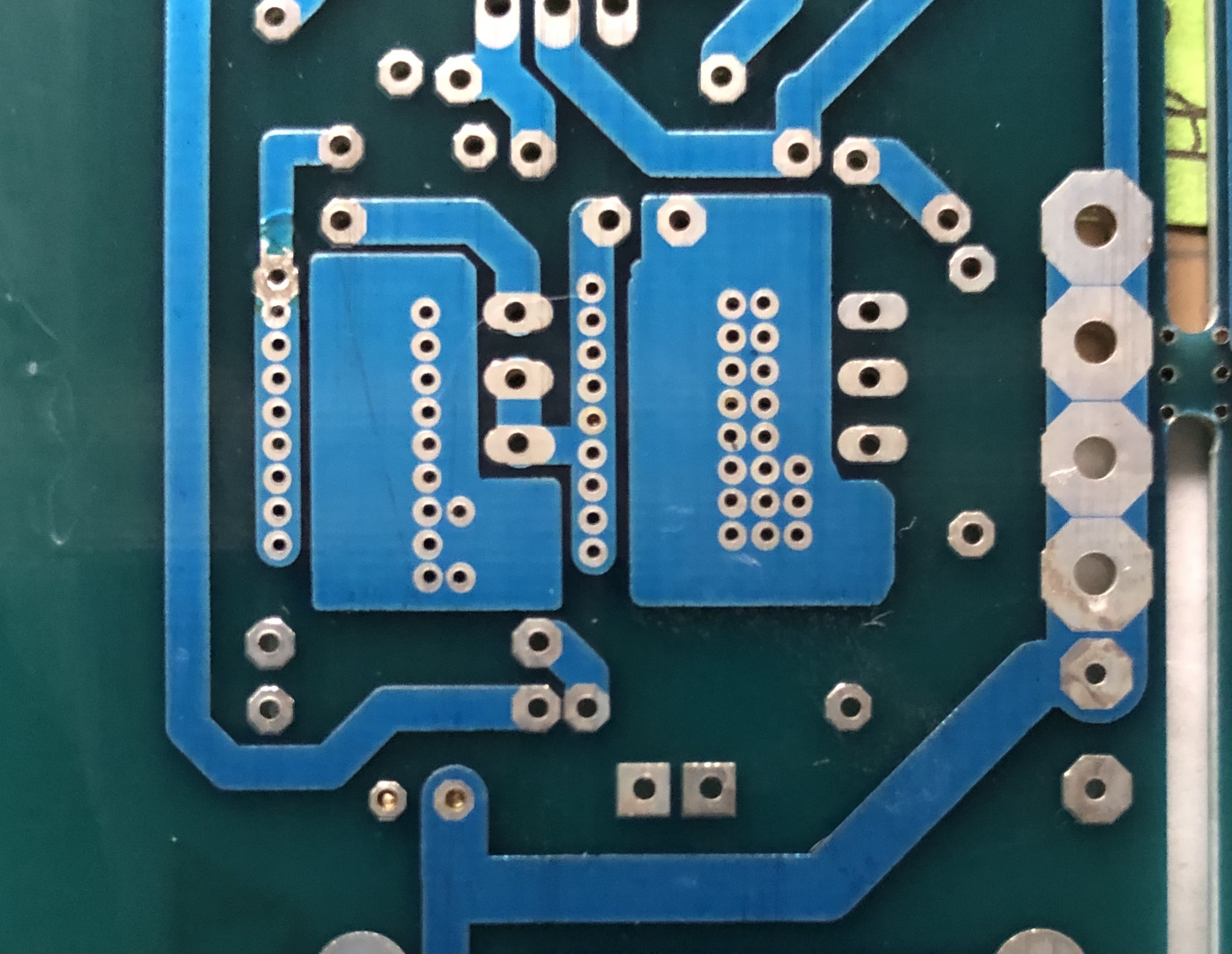

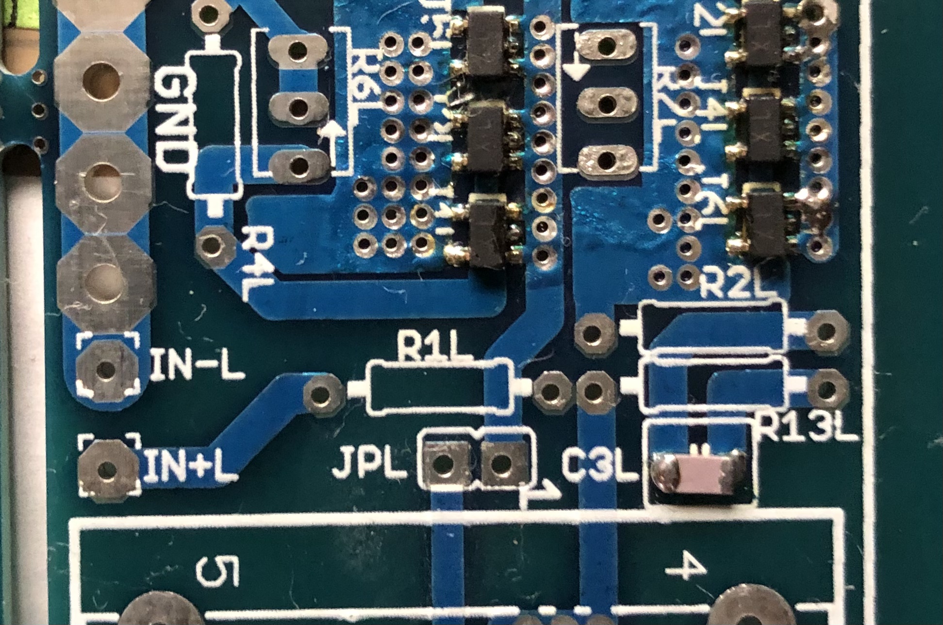

I have a set of 2018 boards, I just looked and don't see the same layout.
Did you change the boards since then?
Rush
I have the 2019/R2 boards....

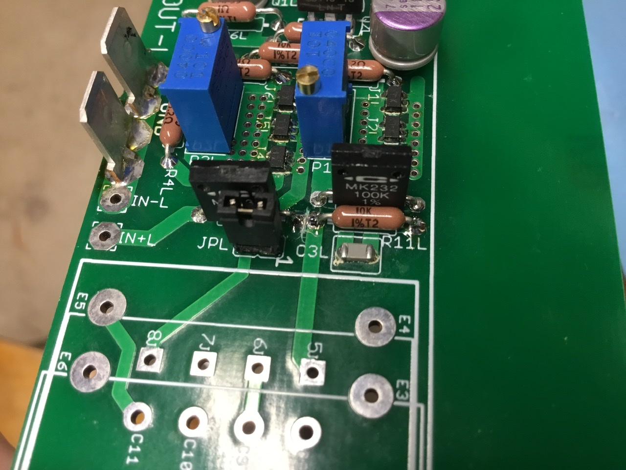

ZM..... Haven't been able to carve the time out to investigate why my right monoblock (left channel board), keeps roasting mosfets (which BTW tested okay after the fact? So they don't appear to be roasted afterall)—but in any event—3 times the right monoblock/left channel board has worked, played the sweet music... then suddenly spits 16VDC out the speak jacks after a couple of power cycles and moving it around the house (it seems).... since I can't quite get the full understanding of the schematic—at my current knowledge level... does this R1/R11 inappropriate mashup have the potential to explain my experience above—noted in past posts—seems like it does have something to do with DC offset when I follow the traces? (My R11 is not populated—using Cinemags)
Glad I check in occasionally. I still have not started my SissySIT project.
The issue doesn’t appear on my (older?) blue boards.
Also, there is different resistor numbering.
I’m pretty sure there might be a few other things I’ll have forgotten about and have to be careful to reread all the notes carefully more than once.
EDIT: LOL...I’m so slow

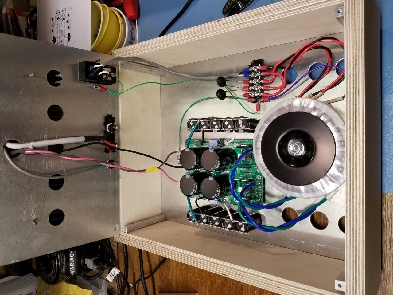

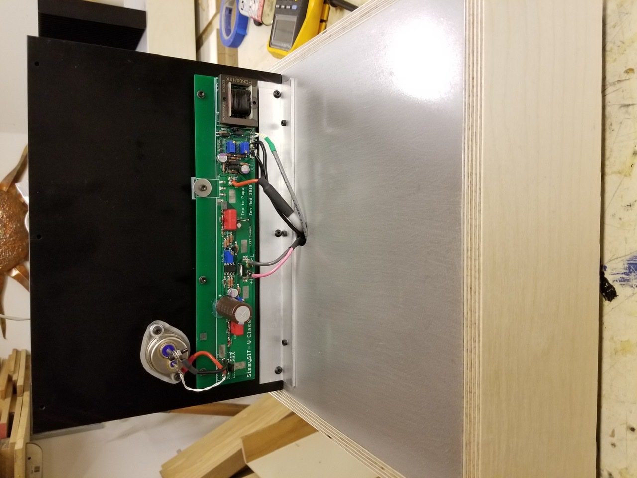

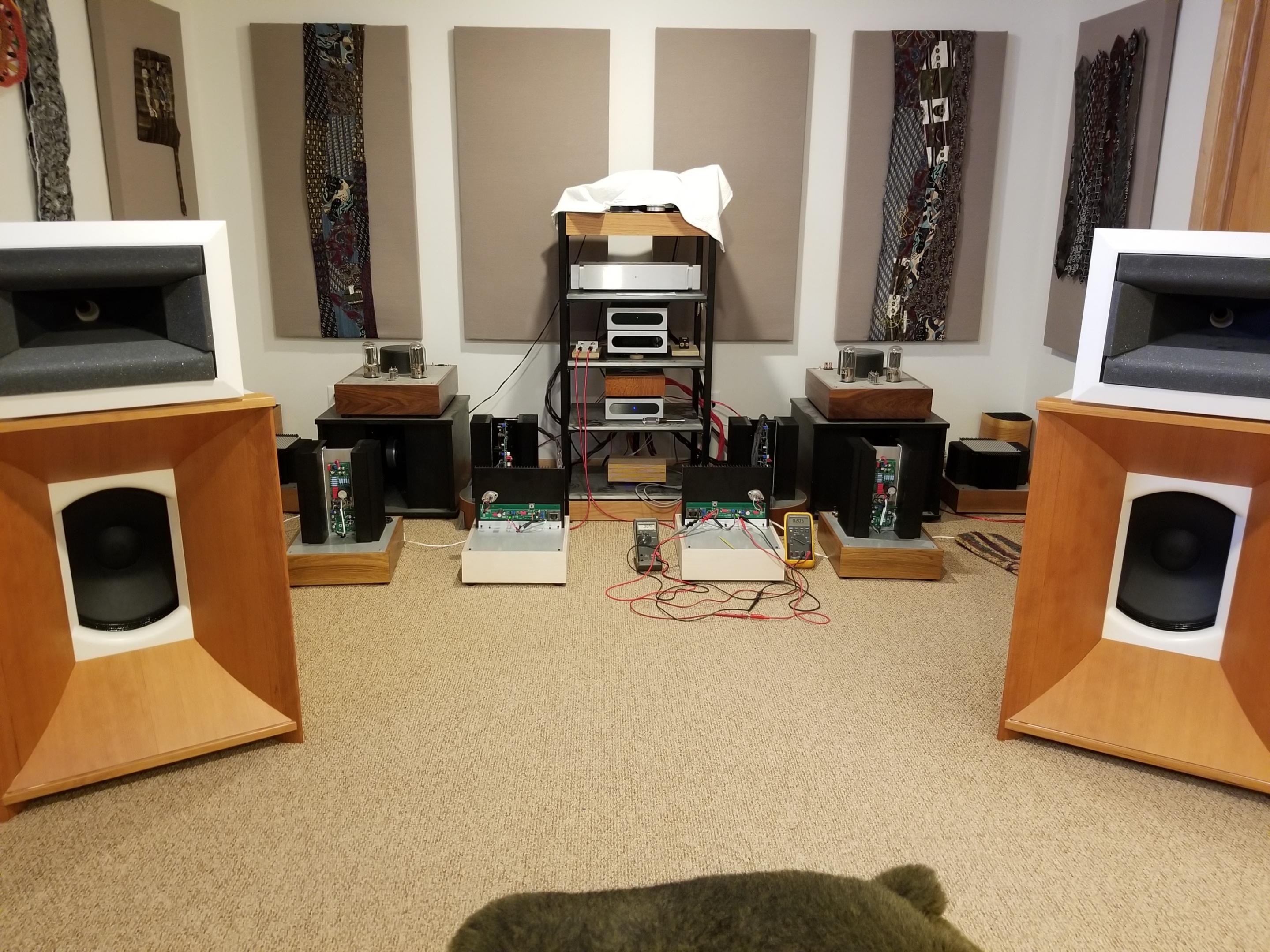

Up and running. Need to break in for a bit.
Pics for ZM🙂

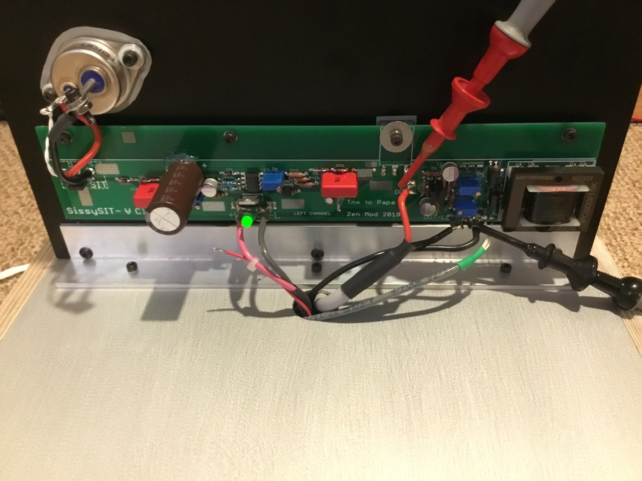

Since this is the tips and tricks thread.
I add a wire from the other side of the R in the power supply for easy current testing.
Also I’m shocked that ZM let this board out of the shop without an LED!🙂 so added here.
