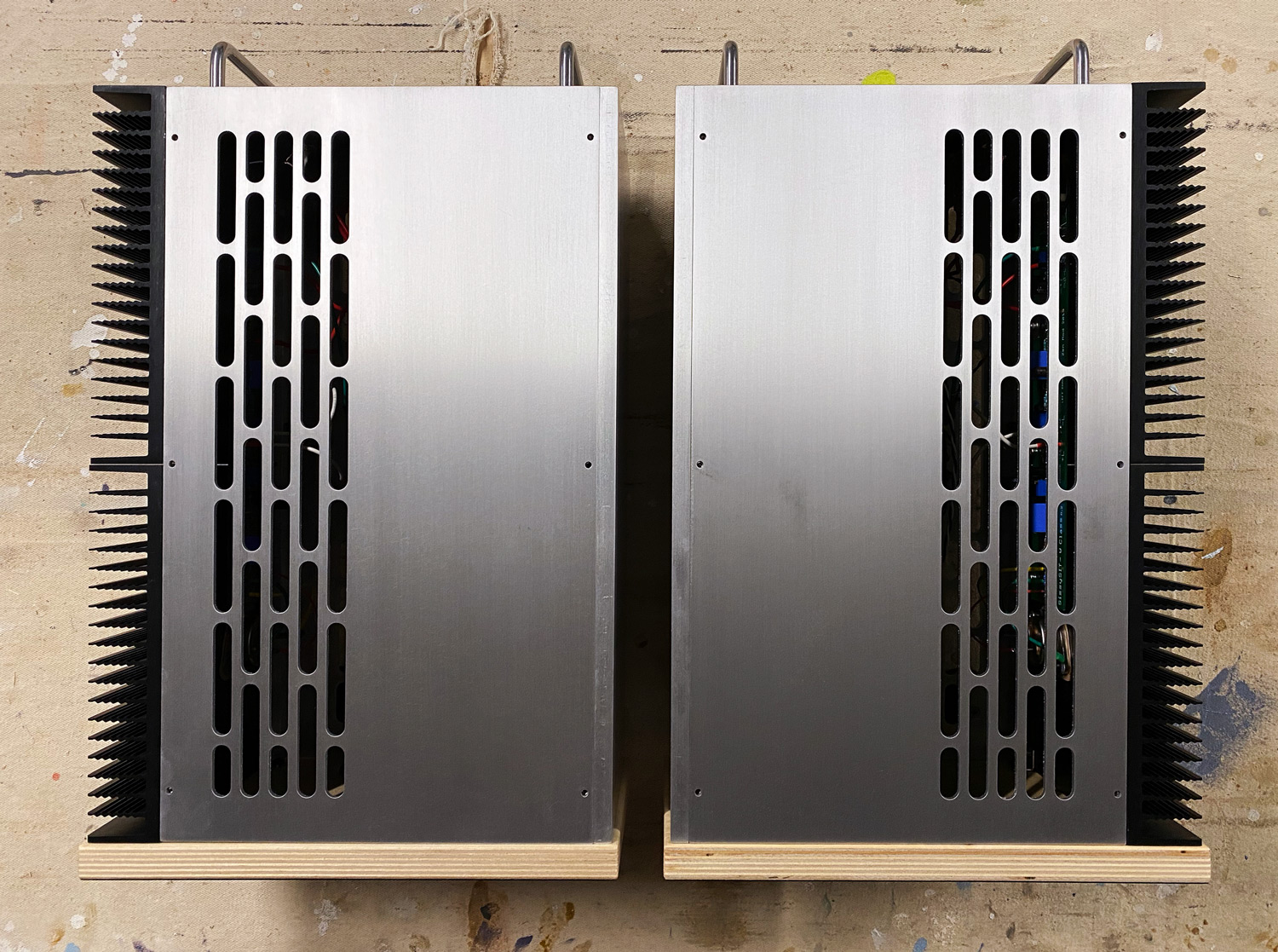

Gianluca - Would it be practical for your team to have a side panel with the same hole layout as the heatsink(s) to substitute in/out as necessary for single / dual heatsink chassis? I realize it would need to be a bit thicker for the tapped holes, but the existing rails could be used. It would make it easy for DIYers to have a modular set-up for various uses and re-uses for the same parts.
re: rear panels, I think we could/should leave that to ourselves based on preferences, but a back panel developed for a single channel could be nice as an additional thought for those that don't want too many holes and don't want to cut their own back panel.
What says the group? Is this worth a dedicated thread? Don't want to hijack this one.
10mm stock, same as fronts, is what I'm using for my side panels (~.375"), so no new materials required—emails sent to Jason and Gian—so this thread doesn't get too derailed—Sorry ZM!
P.A.—if you want to spearhead a separate thread—I will do all the drawings on behalf of everyone. I don't personally want to commit funds to it as part of a GB, since I have my own thing. I will happily do whatever to support the community though with skills.

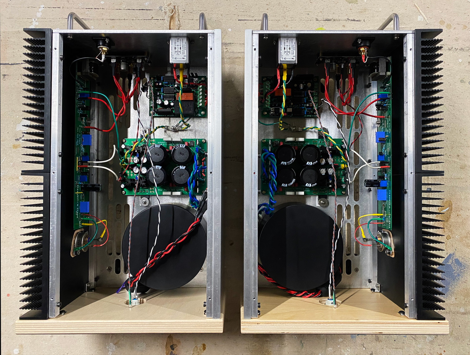

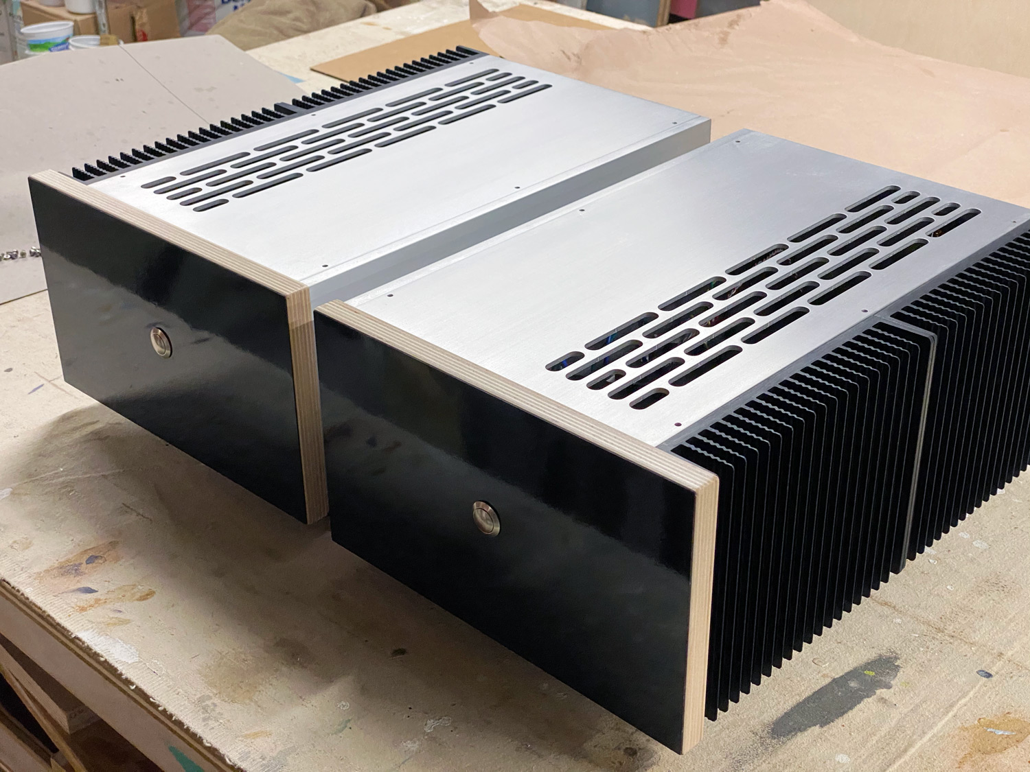

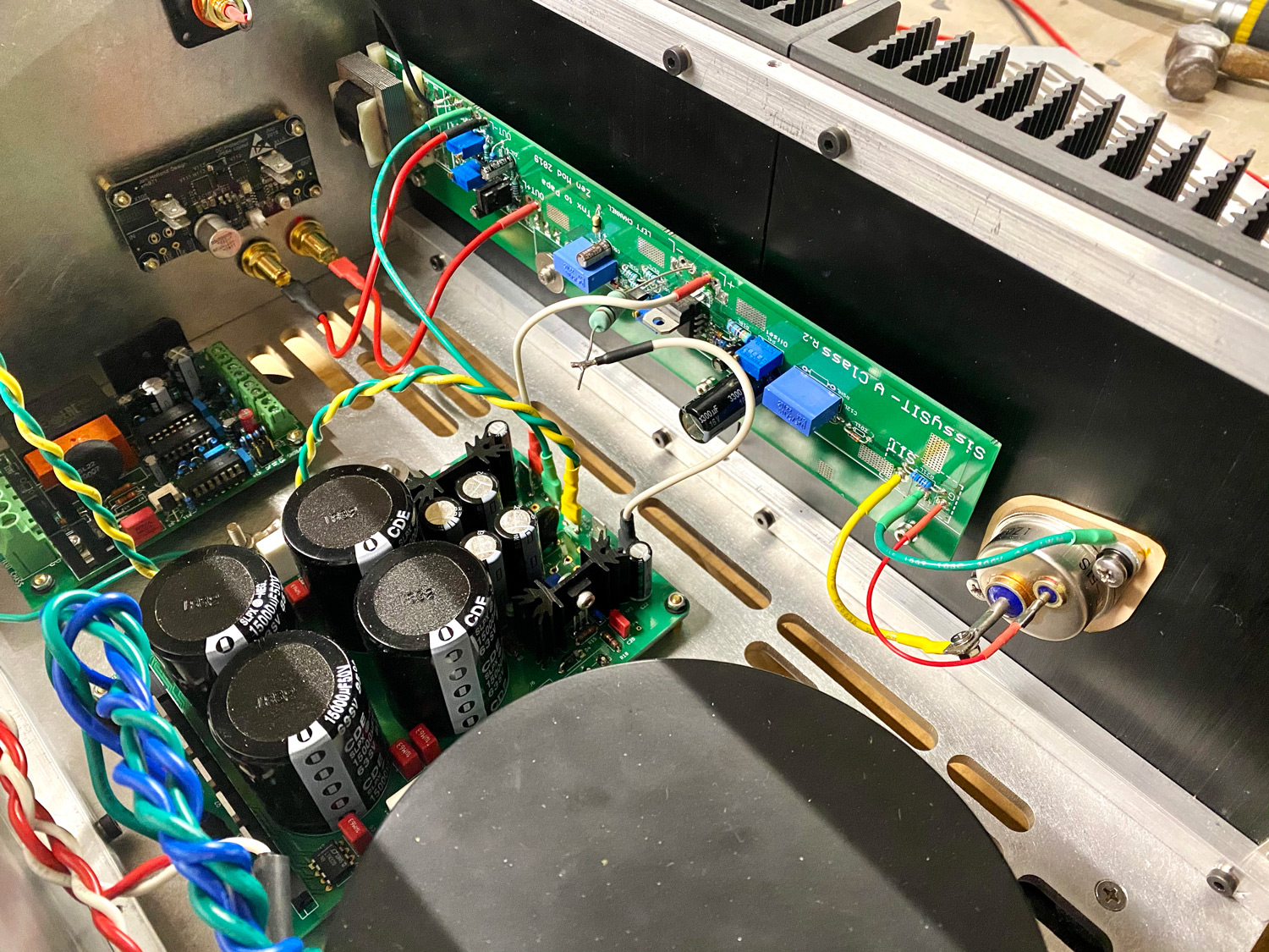

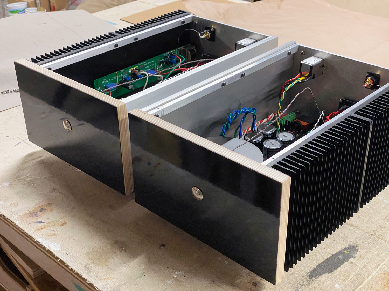

Some progress! And observations:

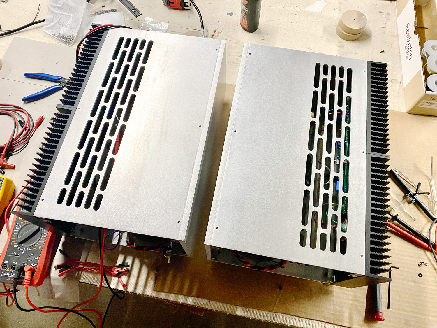

—For anyone curious about the SLB PSU—I have +/-27 rails loaded. Only reason for using it really was to play with something different after several DIY store PSUs—also physical size—which in the end turned out to be not relevant since I upped the sink height—which was a smart move. So, I could have L-bracketed the donuts and used the store PSU no problem. No way would I build this amp on anything less than 165 x 400mm sinks.

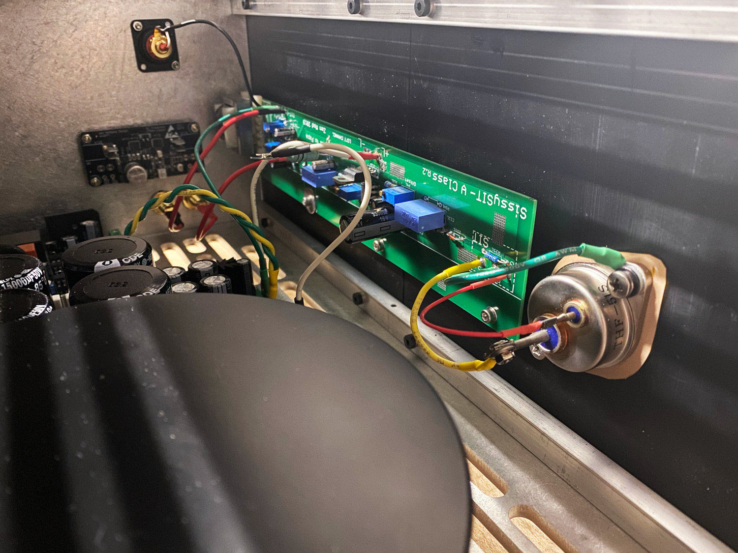

—Nice and warm—nothing crazy. During biasing procedure, LID ON seems very important per ZM instructions. Readouts are currently 182-187mV Iq and 0-20mV offset. Some fluctuations normal here ZM? Any lid off action will cause a swing. Seems to like around 185mV. Left (Right? =) channel was way more sensitive during offset adjustment—some "wild" swings there that I didn't experience on the right channel (30-100mV)—but also seems stable once "zeroed". Initially started Left with jumper installed—readings were way more stable until I figured it out! If I change meter resolutions, solid .18 Iq and .009 offset (or so). ZM—reasoning behind 1.8 vs 2A? Sound impressions? Higher bias better if sinks can handle it?
—Total failure on my part to zero Iq pots. NO idea—dialed out to as close to zero R as possible before install. When initially fired up—pretty much nailed both at 160mV... ? Per ZM "cry here" instructions—I took the more important concern to be the DC offset which was around 1V per instructions—So I just proceeded without crying. No smoke. Dim bulbed all initial fire-ups. No drama.
—Totally stole ZM technique of heatshrink dressing on wires—very cool—and I can use up random colored wire.
—FWIW this is the first build where the Anteks are truly not making any noise. I don't know if this is PSU related, or the massive steel cans?
I'll get them both up to temp again today—together—and verify readings—then solder in Neg and move on to buffer setting. Hopefully a bench listen later. Then I'll make the fronts—and finish aluminum surfaces. My super bad-*** speaks are currently not as awesome as they were/should be since it would appear that I have a rubbing voicecoil on one of the mids—waiting on a new part under warranty—might be here today!
Also plan to plug in headphones to jacks and listen to the "noise" and tune the transformer, and see what might be loud in terms of wiring...

OKAY! MUSAK!!!! YEEEESSSS! :D
Pics later... might be a couple of days—need to finish the fronts—Test speaks aren't very sensitive—phone as direct source is maxed, but sounds fabulous in the work cave. Lush and full clarity sweetness, getting just MORE as they heat up. Threw ACP+ in front of them cause it was handy—nice!
Buffer settings went per instructions. Again, no dramas. Finally gave up chasing the dragon that seems to be—by other posts and ZM responses in this thread—looking at the constant fluctuations in bias at 200mV range. They were both around 180mV and change with very close to 0 hovering offset when I soldered in Neg and moved on to next steps.
Haha—thanks ZM!
BTW—forgot to note—did my usual plugging in of headphones to the speak jacks to listen to some noise... uh... no clue what I might have done here—circuit topology, steel can on donut, wiring, combo of all? —I thought the amps were off. Just literally NOTHING to hear—except a pop when I pulled out and put back in the shorting plug......IDK. Real test will be in the main sys of course...

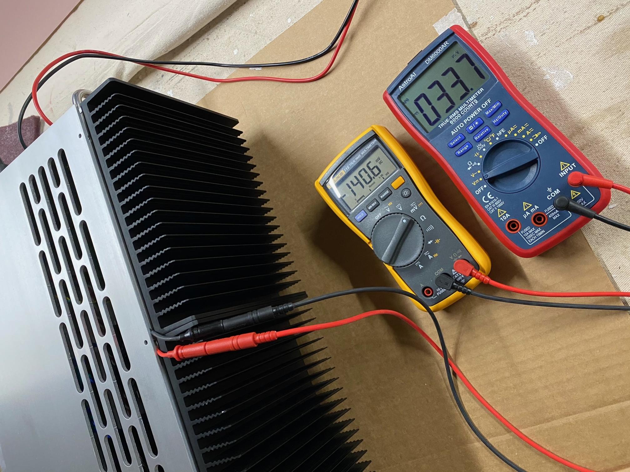

Trouble in paradise!
YES! Some drama!
Day before yesterday:

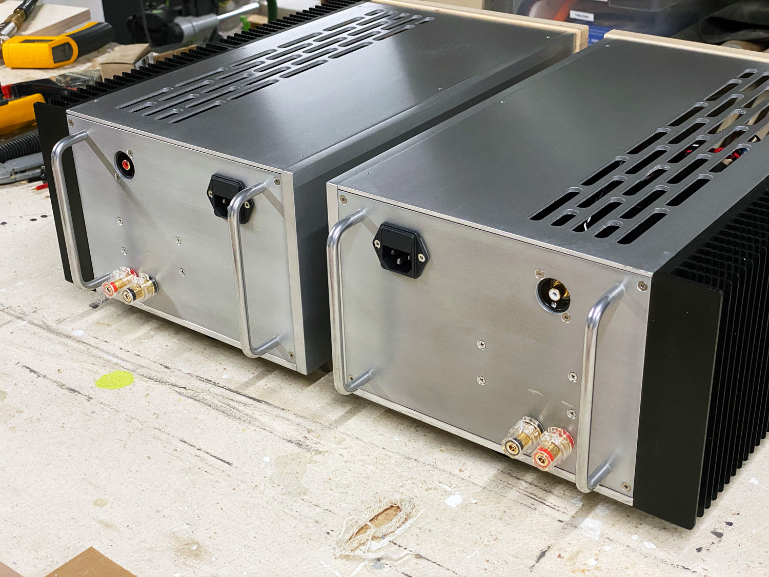

—Ran Sissy beasts all day in the test environment: Sounded fabulous. Added DC blockers, confirmed power, little LED lights up, all good. Play some more music. Yah! (No faceplates yet)
Yesterday:
—Added faceplates. Little messing about with a screwdriver from inside the case—being VERY careful, no drama to report, really no big deal. Added LEDs, Added final PWR switch.
—Then. Added them to main sys for a nighttime record. Remove M2Xs, add Sissys. Power left, great! Power right, no LED? Also no LED on DC blocker. Hmmm. Think fuse? Checked okay. Bummer. Back on the bench. Pull amp PWR leads. Confirm PSU is okay, no change in unloaded rails—DC blocker lights up. Happened to be on with 6L6. He makes me do math! Always a good thing. Hook amp board back up to PSU. Disconnect DC blocker, plug in amp to speak jacks, check offset—blocker works! BUT Pos 15-16VDC on jacks. Bad joint? Dunno, pretty careful there these days—flexing board, touching components whilst watching offset… no changes. Hovering around 14.95 and a bit over 16….
Sinks getting warm. No weird “power pulling sounds”. Sinks not warmer than previous all day music fest…No smoke, no suspect looking parts—instinct is telling me it’s something “simple”…but….enter dodo here.. Don’t see any evidence of shorts…
(BTW the "no LED" issue was that I had the leads reversed on Mark’s board.)
Fancy speaks on left channel sounded incredible for 5 minutes. Cry here. BUT DC blocker maybe saved some complex 4-order Xover madness and a ton of work.
Consult our Sissy leader—he has me do some basic checks—7805 (5V on output), R16, R17 V on all legs ref to GND, both gate resistors okay, reconfirm AC though rail voltages all good = must be 9140!? Only have some 9240s. Swap it out. Re-biasing right side now! Whew. It IS behaving in a more stable manner than previous.
