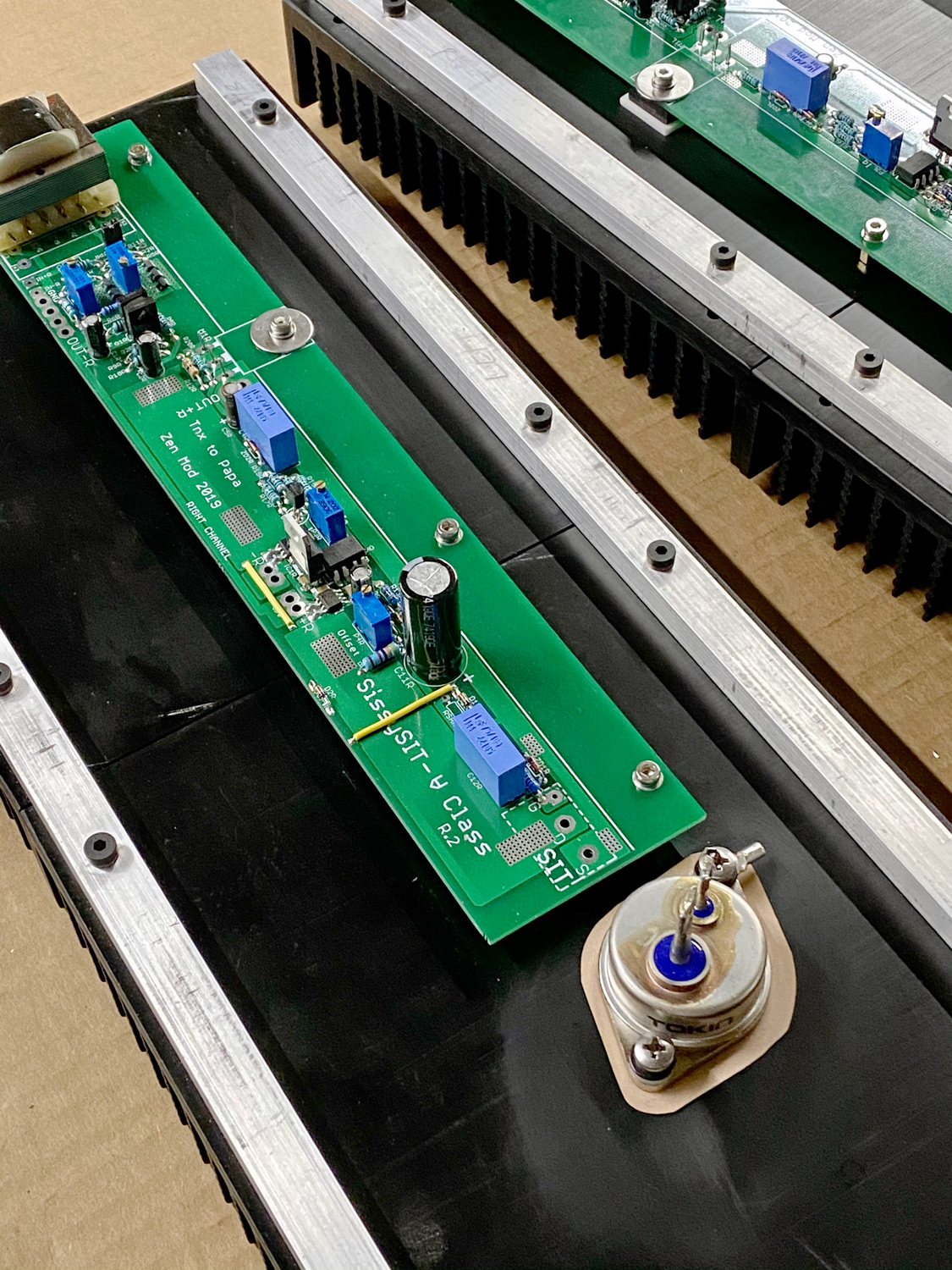

Started stuffing the SissySIT boards last night. The boards I have are from this years kit—green—single mosfet spot. They are marked "2019"—schematic on first page of this thread seems to be the most current with 10K in R9-R12 and the schematic I'm working from (and why I'm posting in this thread). BUT— You included some 3k3R and 6k8R in the kit (2 each—don't see on the schematic 2018 where they would go)—and I added 1K (R15) and some 100R (R21, and flying) from my stash—just want to make sure I have the right schematic! —nothing soldered yet. Building as monoblocks by the way.

well, do with values I sent - it's not that critical, later values are gilding the lily
R21 - do what you like - put shortie on pcb then flying R21, or leave R21 on pcb, if your wires are really short
Borbelly WCF option is deleted in his iteration.... reason - too much of good thing
ZD1 is properly oriented, pcb being strictly for SissySit

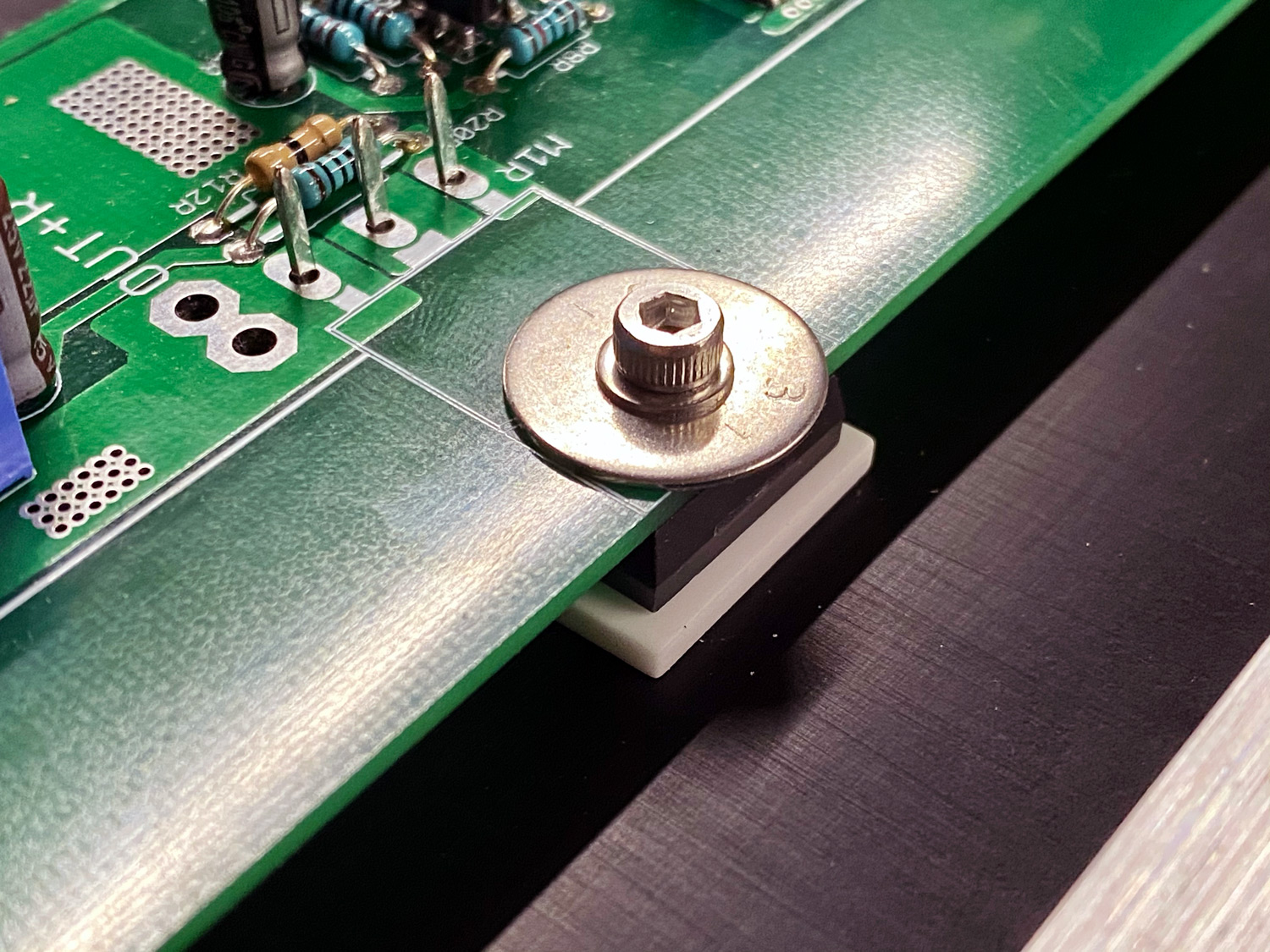

I was sceptical about the boards mounting only from the bottom arrangement—It's VERY solid however! (I never really doubted the ZM)

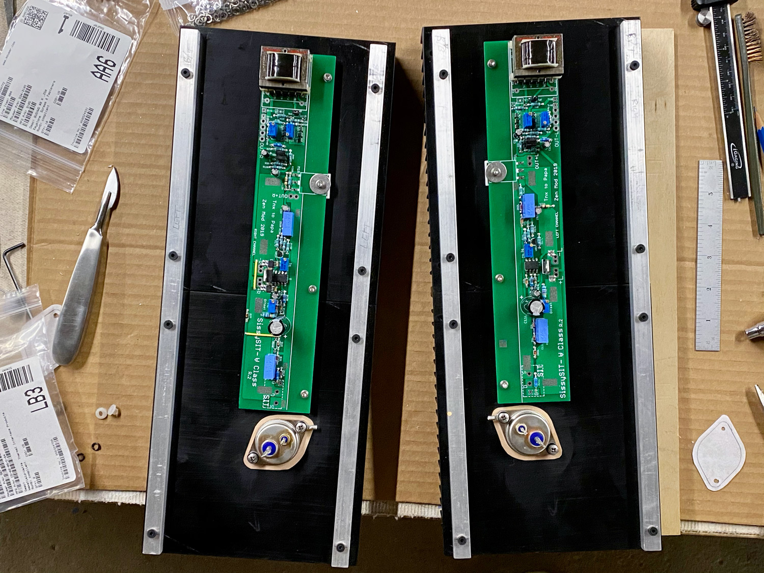

Also decided to not be a sissy and go with larger sinks—was going to go 120mm x 400mm—which I think would have worked? But this amp has higher opperating amperage than any others I've built so far, so 4U height. And unobtanium parts to worry about. M4 on the SIT bolts, ground ring under the insulator bushing.... nothing soldered yet.

though - for IRFP, I would use either Keratherm from Store , or Mica and goop, or that funny Alumina brick (+ goop) everyone are talking about and I didn't tried it , but no reason to be suspicious
other types of isolators I can't comment , I didn't use them
again - for SIT - isolator is not critical, due to sheer size of its case

And—ZM—I'm a huge fan of the ceramic blocks you refer to. Also, in the case with SissySIT, it gets the board a bit farther off the sink with your PCB clamping design—and will make the wiring poke-throughs a little more forgiving—avoid shorts potential.

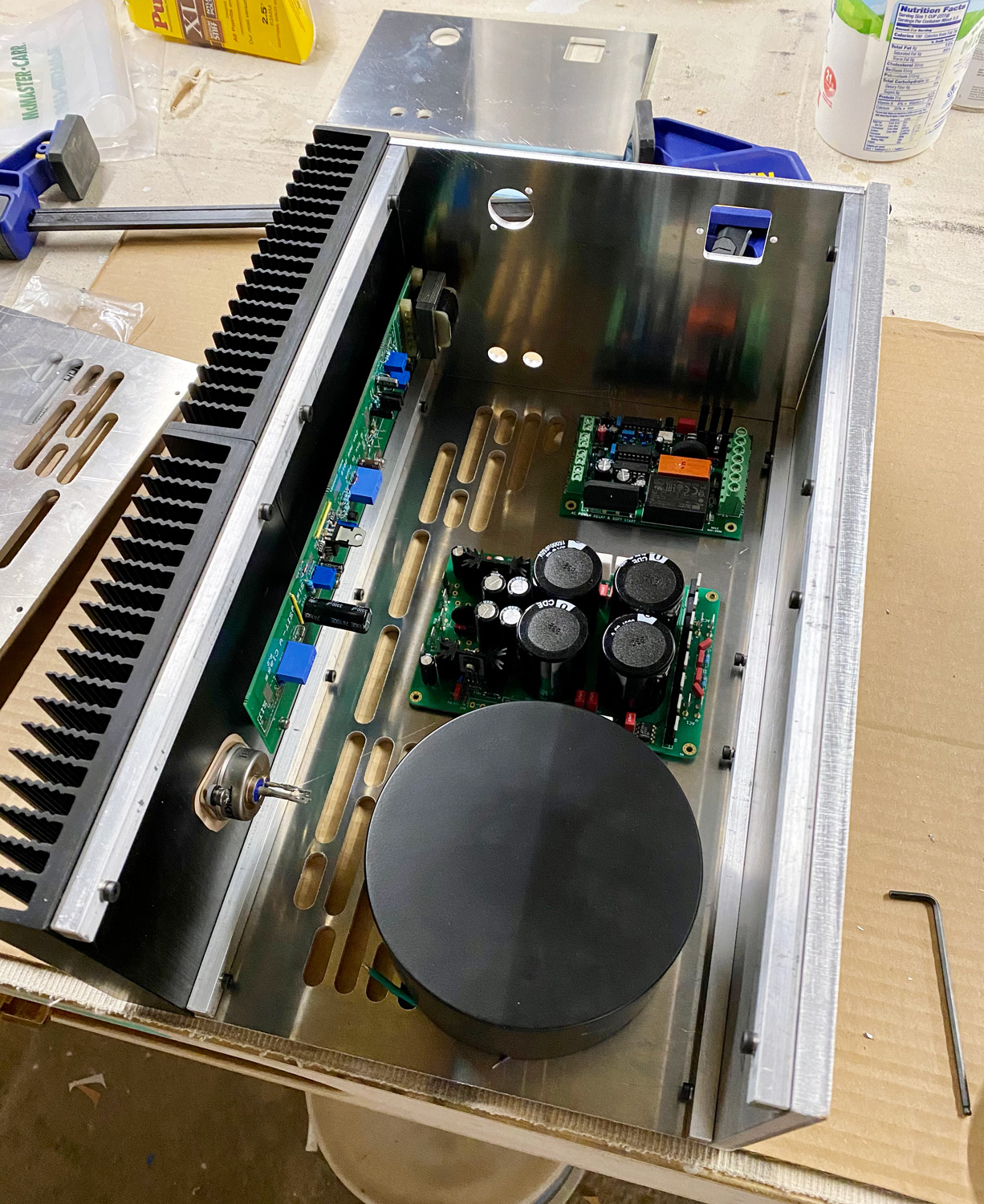

DIY PSU will fit. Already tested that in M2X. One detail is the top and bottom plates sit proud of the sinks/side plate and overlap a bit with the stock rails—which I'm not using. Also my bottom plate is .25"...but all easily adapted.

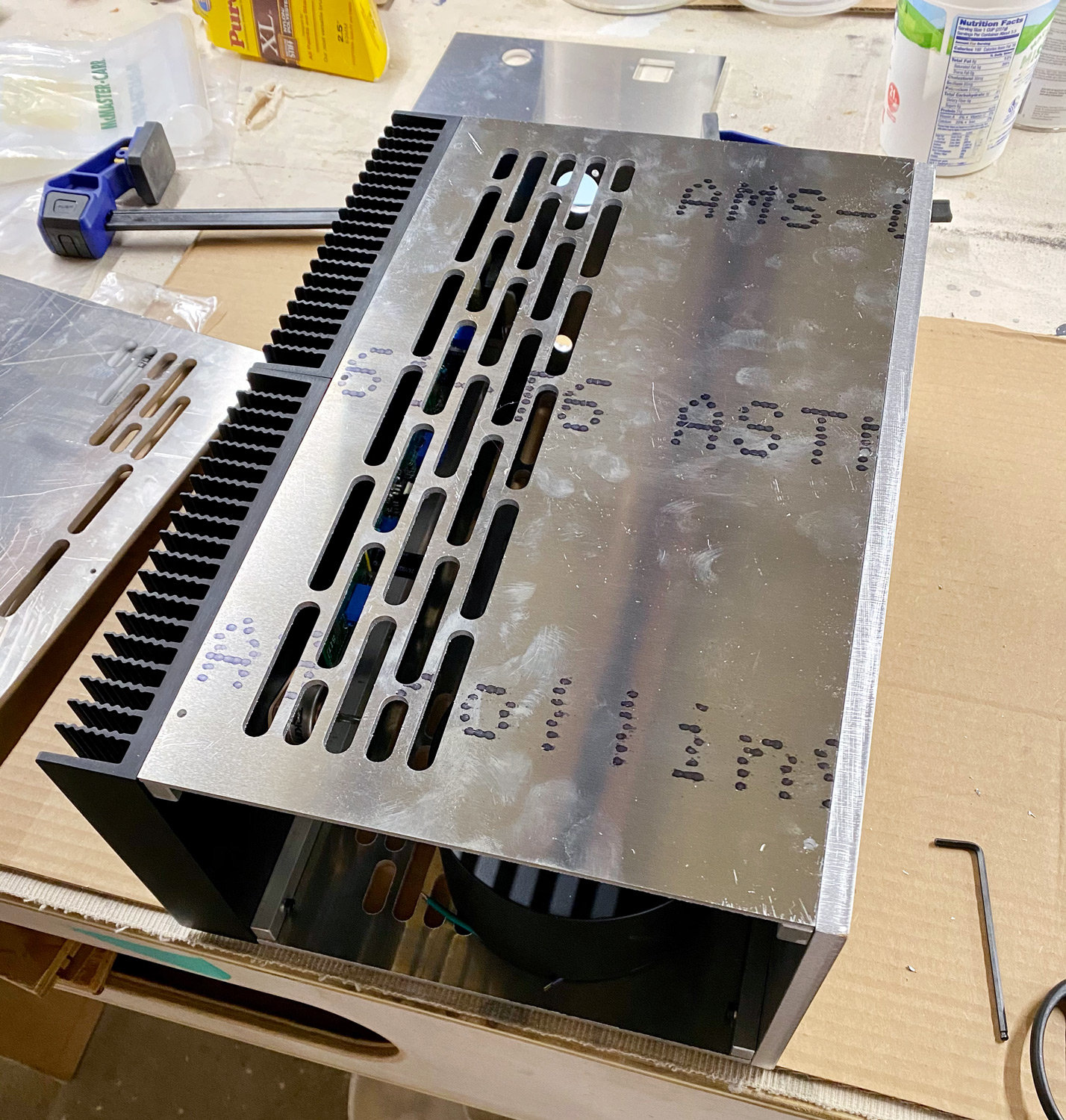

ZM! Mono-mockup. Based on the 165x200mm (x2 each) sinks from Modushop. Left. Err right?
Very nice (as always)
I was contemplating on something similar for my f4, but in a stereo chassis. slice the chassis in a left/right halve, turn them 90° (so that the back connect and the front-halves become left/right. Output on the sides, input in the center (rear or top) Not very effizient but fun...
