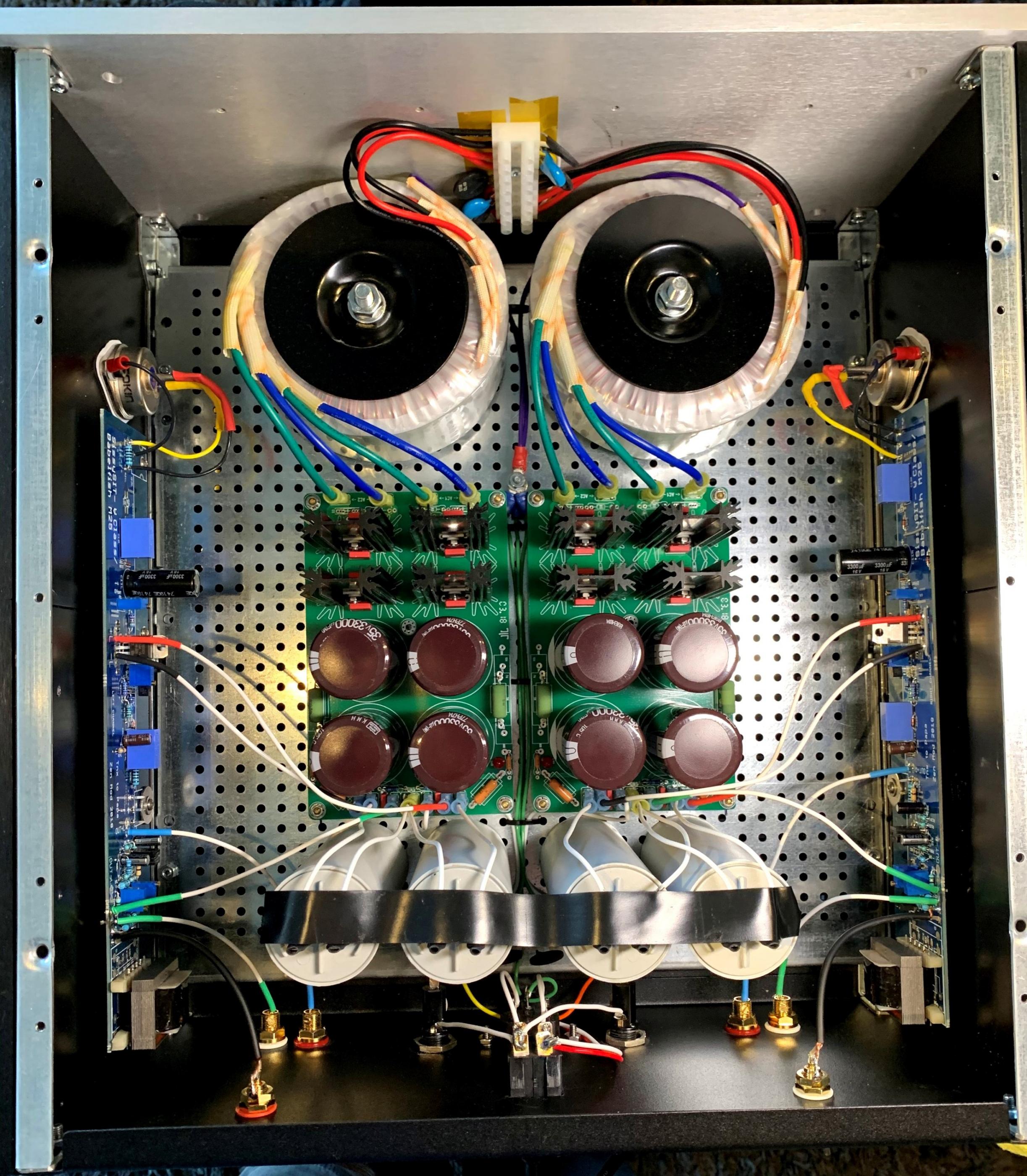

I finally finished my SissySIT after it was put on hold because COVID and being in California for almost 5 months. Back in February I had the amp completed and was on the last adjustment and could not get R7 on the left channel to make any changes. I did some troubleshooting and it appeared that the resistor was bad. I ordered a new one and never got a chance to swap it out until yesterday.
After swapping the resistor I was able to get the amp dialed in and it played music. I only have a couple of hours on it, but is sounds really good to my ears and I could not be happier with it.
ZM thank you for a great design and making it available to all of us.

I used the Modushop steel Dissipante 4U 400mm.
I believe they are about 24V each. the amp is dual mono and I'm using 2 Antek 18V 300VA with the CRC Power Supply (Class A amplifier) and a pair of 50uF film caps per supply.
I don't remember the temp, but it is a little warmer than the M2C, but not so hot you can't touch it.
