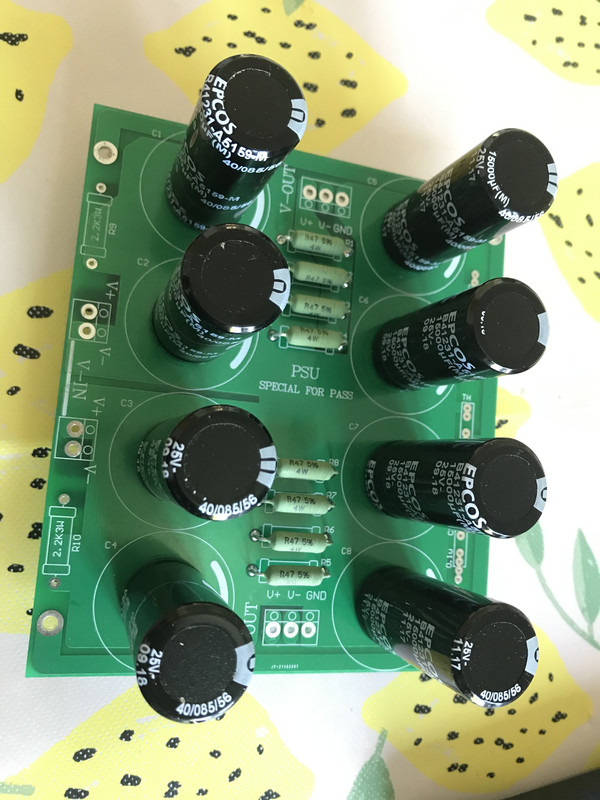

What caps are people using? I had followed the Pass FW F6 schematic and suggestions and am about to use 8x 15000µF per channel as per the schematic, so 30mF -R- 30mF where ZM suggested 33mF, so should be within suggested range? The caps look quite small on my PCB and I see other people using much larger ones. Any benefit or are those just what you had lying around?
I am using the Epcos 25V-15000µF now.
well, if you have those so called Computer Grade (or something like that) , big ones with screws etc. - use them - usually much higher ripple current and impeccable behavior through entire freq. range ( Philips ones I used in few of my amps are insane, rated to zilliion amps at 20KHz)
if you don't have a purse for these, use snap in caps, as us mere mortals do in most cases
33mF/25V , either Pana or CDE or whatever - nice ones
Well, I had already ordered these ones so should be fine I think. Still mere mortal greedy boy.

Where did you source those boards from?
