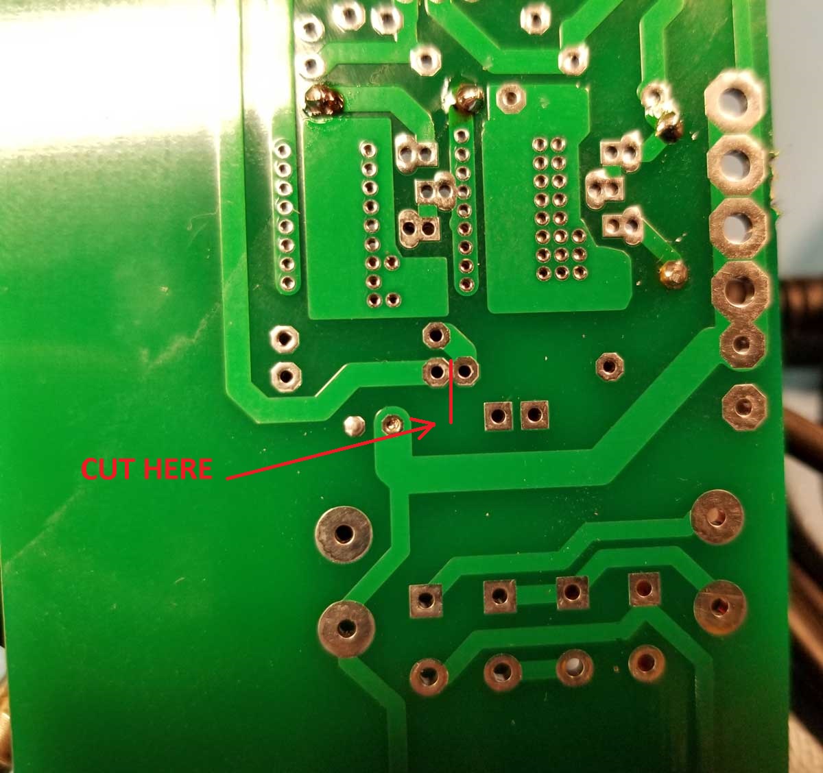

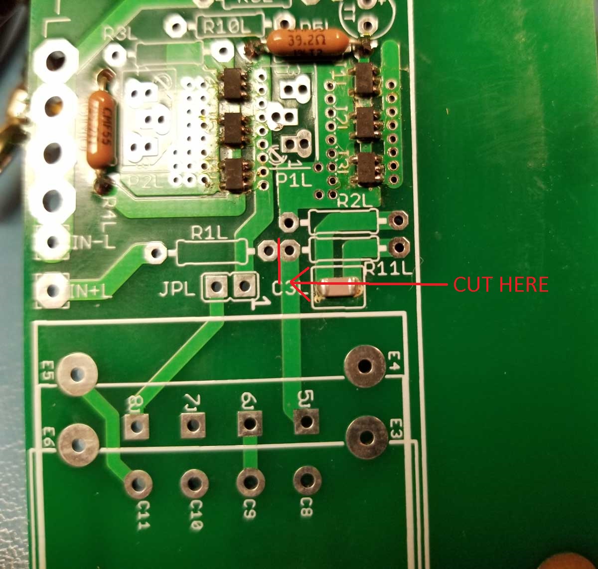

SissySIT R2 pcb error !!!!!!!!!!!!!!
Well, Mea Culpa, maxima!
Just got a word from Chuck B. - he spotted an error on L Channel pcb he just got - R1 and R11 are having touching pads, which is noooooo good
I didn't had that on set of proto/confirmation boards of these and only explanation is that I made unintentional slip/move of R1 (area) in process of making Gerber files, without realizing
As I just wrote to Chuck :
What can I say .... it's embarrassing 🙁
remedy is simple - just take razor knife and make a cut on both sides (top and bottom) between R1 and R11 meeting pads
Sorry again
