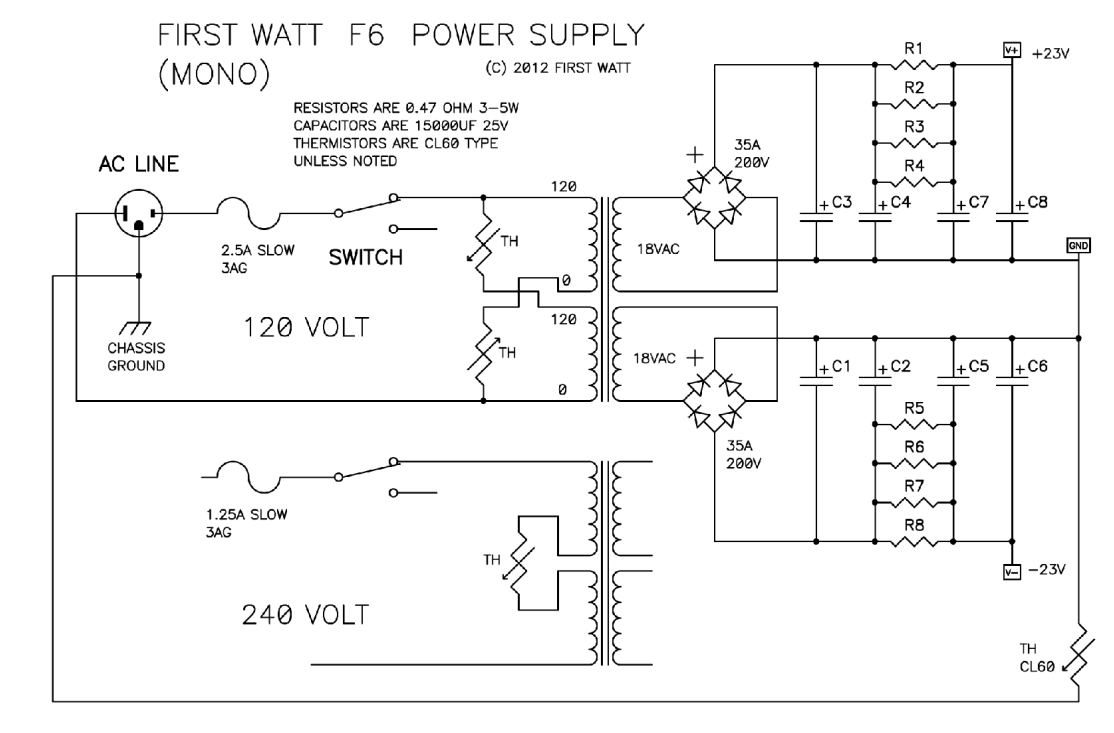

I made this one, and labeled it - for 2 Donuts , each having 1 NTC per primary
so , 2 pairs of input wires , 2 pairs of output wires
with some simple ingenuity , it can be used for whichever arrangement you need it
post sketch of your intended Donut(s) , and I'll edit your sketch to accommodate your needs
shoot for little lesser Iq , 1A5 or 1A6 and it'll be jolly - if these Donuts are of good quality , they will not complain with constant load of approx. 50% of their capacity

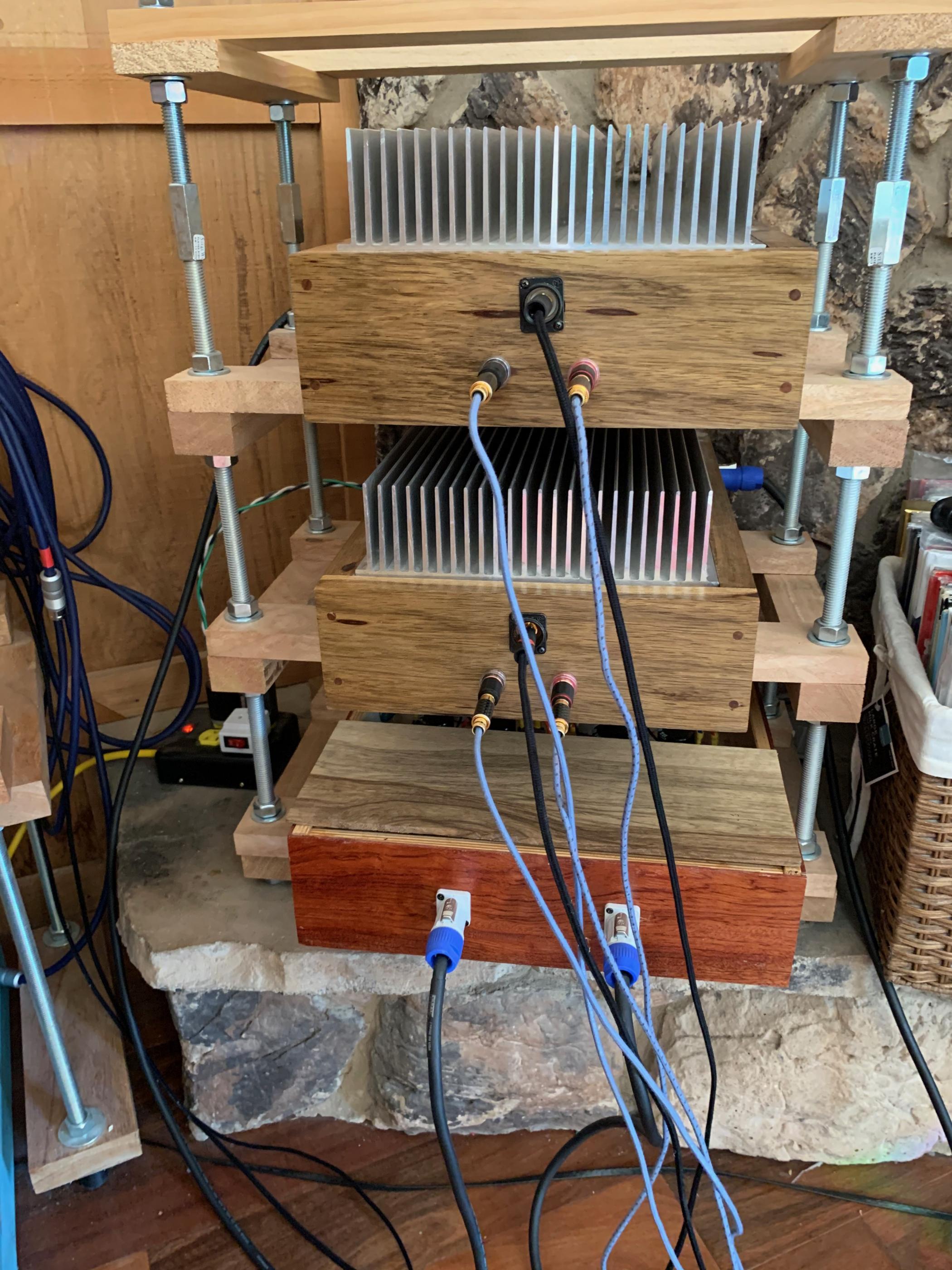

SissySit is up and running thanks to ZM
Congrats, came together nicely.

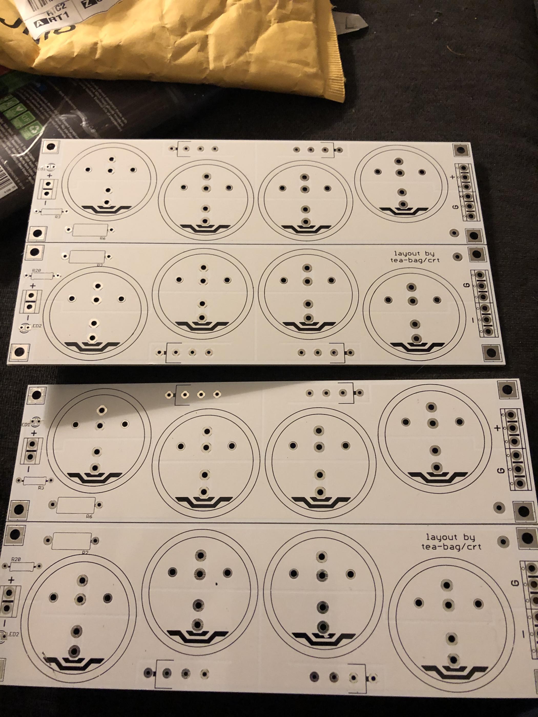

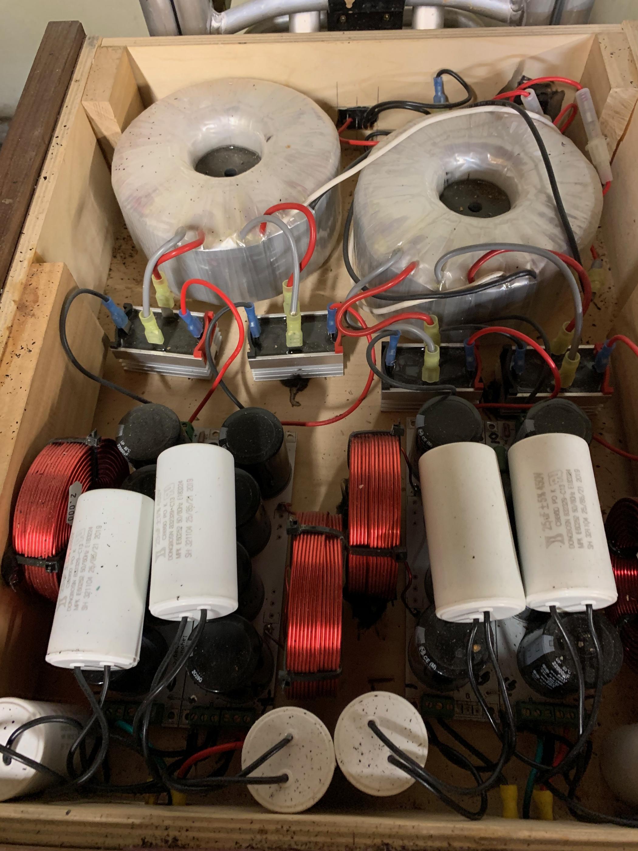

Found these in my stash, tea-bag`s PS boards, so one board for each site (separately L and R channels), four bridge rectifiers, two 2x18 transformers feeding each board, complete independence. I will lift the boards and run the AC lines under all the way to front area where the toroids will live.
the you're Happy Camper , same as I am with little ones I'm having inDEFiSIT
What a wonderful life to be the ever omnipotent, omniscient, omnipresent ZM.
Those are great PS boards. Use them in all my builds except F5, first diy Pass amp. My favorite power supply boards, tea makes them bomb proof.

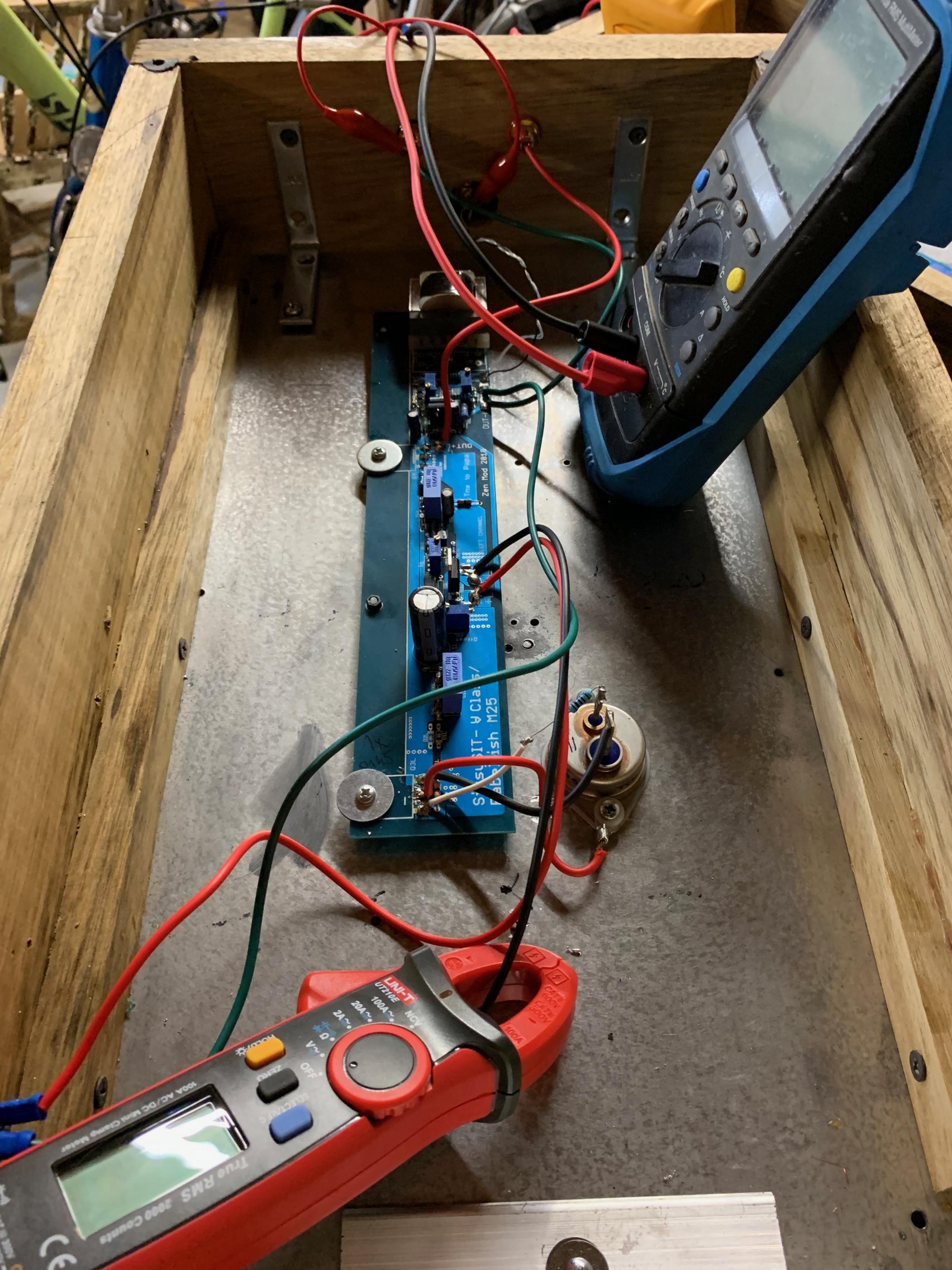

Started to do the adjustments with the help from Song. The left channel behaved and we were able to achieve the 20mV and 0mV input offset but the right side is stuck at 180mV and unable to go down. We used a variac and the input current draw was 400mV which seem high.
Any advice much appreciated.
