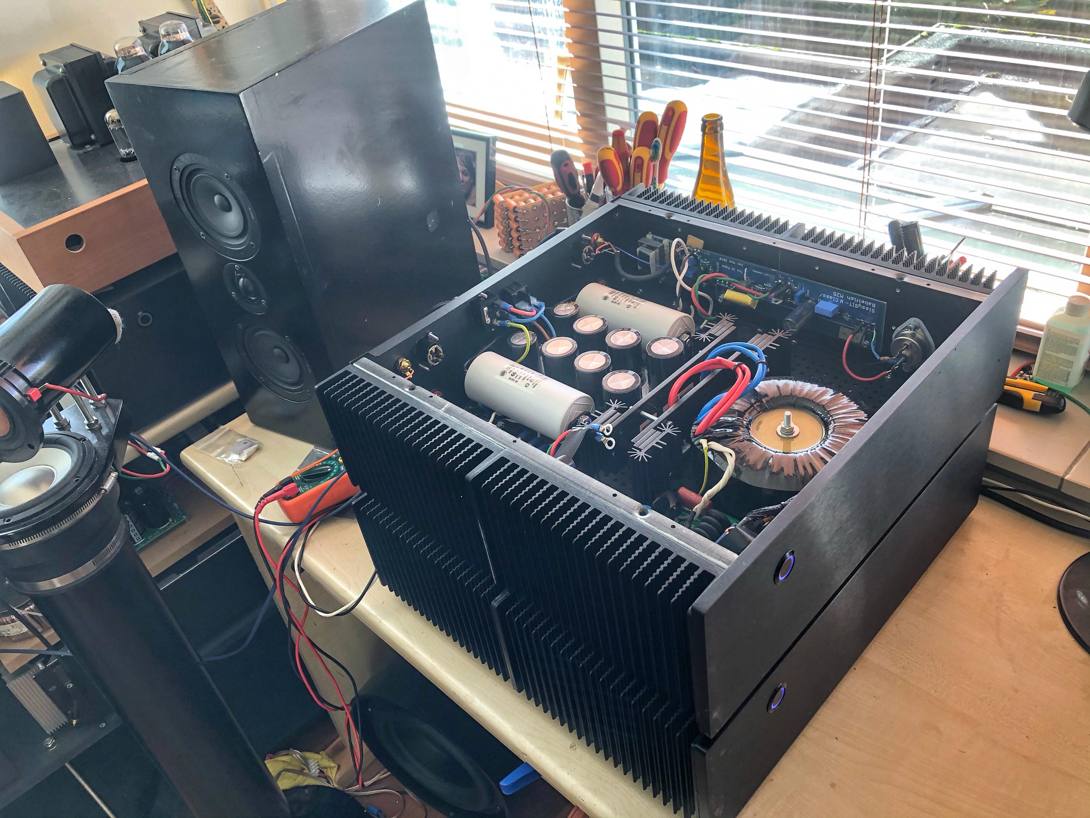

Dual mono in my older M2 chassis, can switch easily between them

@ brianco, indeed have i thought about making a cover from glass or acryl
but thats undermining the idea of an open structure.
there is nothing hazardous or fragile to touch.
I'd consider most tubeamps more endangered to brute force
but most of'em show their precious bulbs freely.
so what? using a soft brush now and then will do it.
thanksanyway
cheers
A.

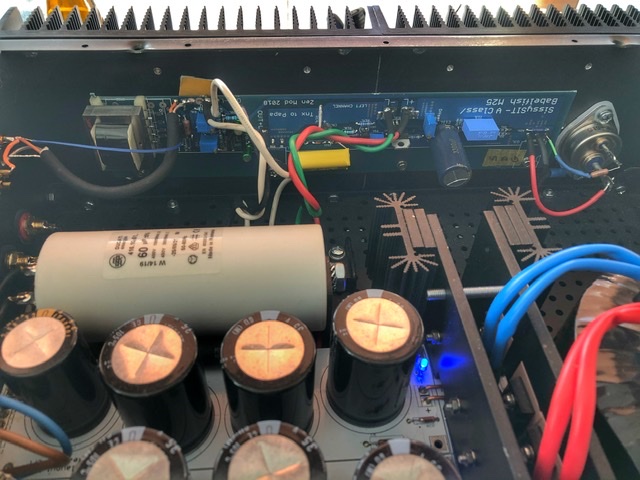

The heat sink is overkill for only the diodes, but I underestimated the dissipation on them once...
@ asanden, nice and tidy build and not your first telling from the pic.
is the heatsink midamp only for rectifiers or do you hide some regulator?
btw: do you drive your LX-minis+ with M2 and/or sissysit? (low SPL?)
cheers!
A.

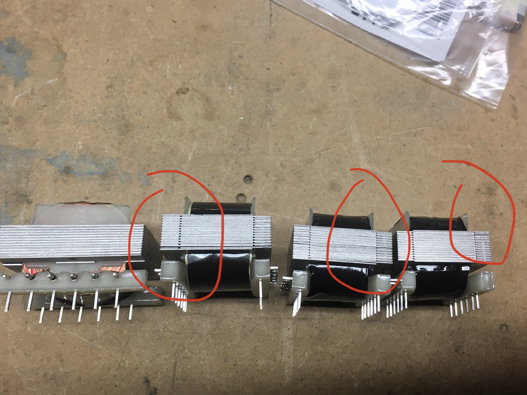

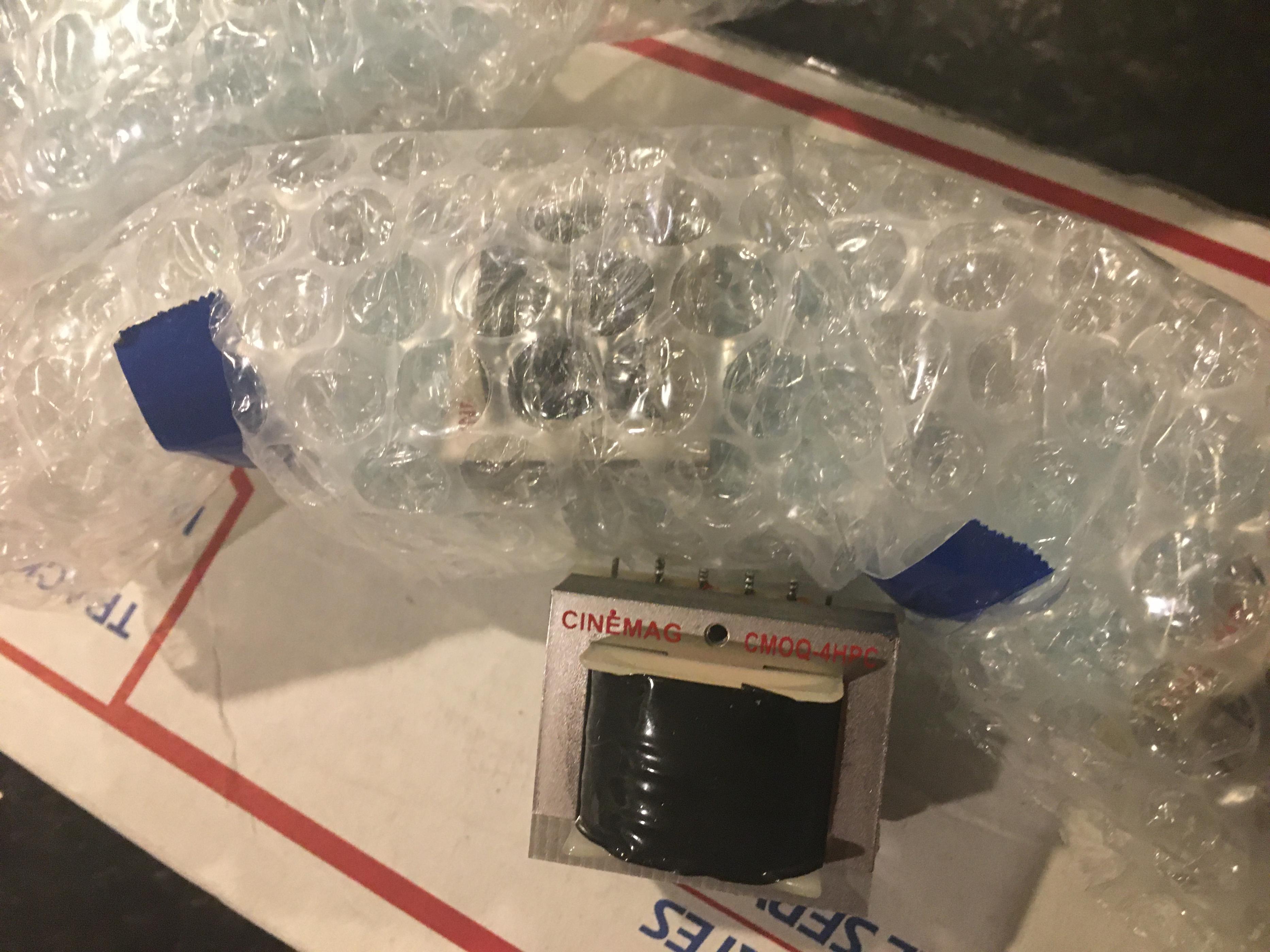

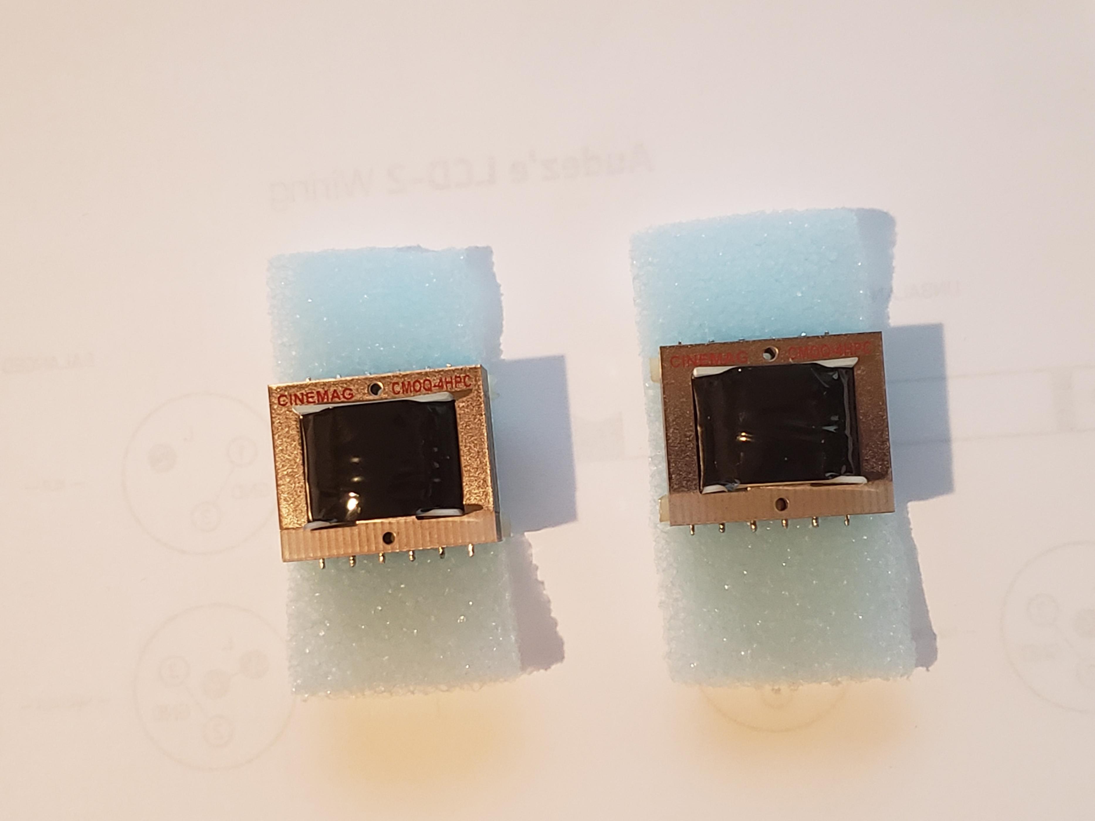

Glad you got your cinemags. I got mine too but noticed some gaps in the laminations.
I called David he said it was no big deal. Do your transformers have lamination gaps?

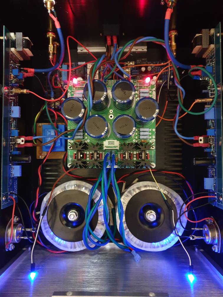

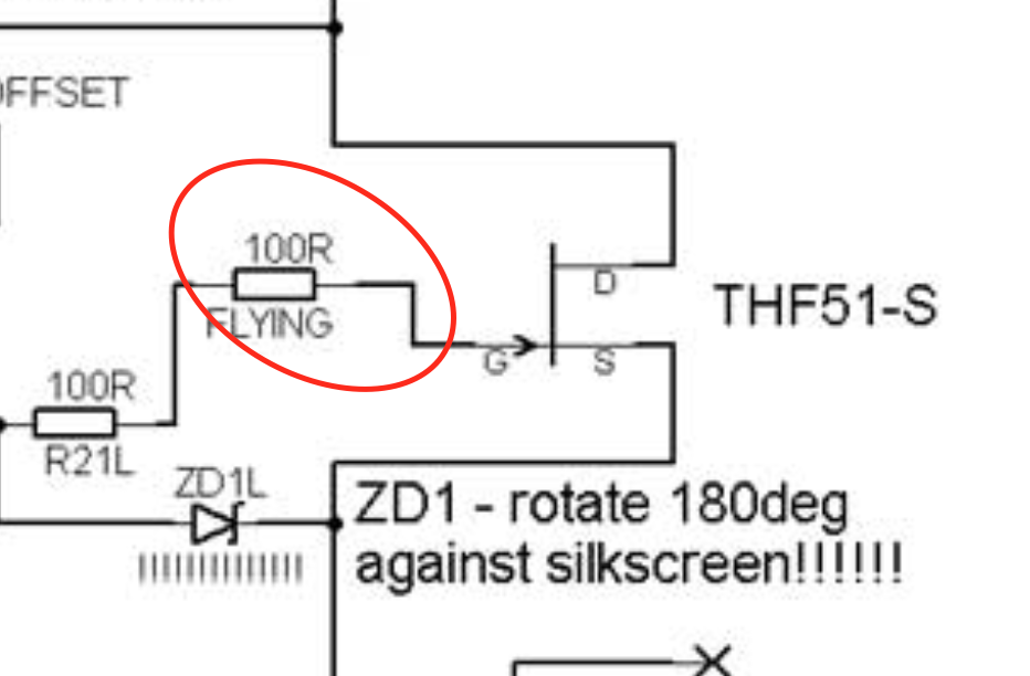

Some progress since my last update.
With lots of help from Song, we managed to get amp up. I managed to bias the right channel but did not have any luck with the left. No matter how I turn the IQ or DC offset, I can't bring these 2 parameters down.
Song suspects a broken 7805 or the opto. I run out of light to troubleshoot, will have to wait a bit as I am out of town starting tonight.
In the meanwhile, any thoughts what else might be broken?20191106_211226.jpg
