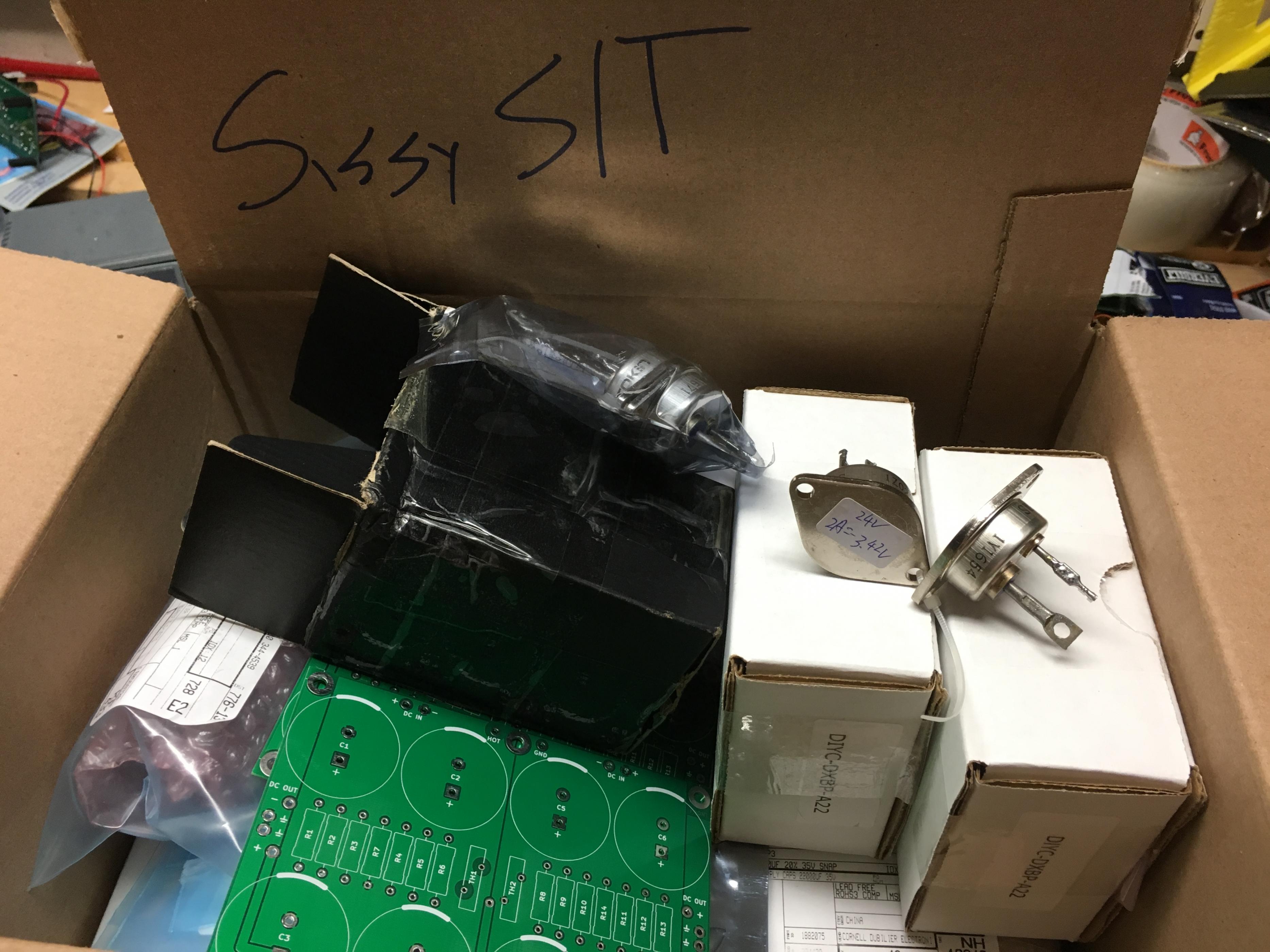

I reheated all solder connections on both boards, front and back. There was at least one bad joint on the board I had a problem with. I cooked up and biased. I’m around 1.8A on the outputs. It’s never rock solid at 1.8, but close enough. Offset is also not able to stay rock solid.
This time I got front end to dial in nicely. 20mA / zero offset.
Put in jumpers, attach sacrificial speakers, play some Emilíana Torrini, then some Eilen Jewell. Beautiful.
DC offset on outputs is higher than I would expect. 200mv+. Is there a step to adjust offset after installing jumpers that I skipped? Or do I just live with it? What is an acceptable value?

if you can't get 0 offset and you're still on positive side, either increase P2+R18 combo or decrease R19
it seems you got tricky combo of Ugs voltageswith your SIT and mosfet
easiest - just solder additional resistor across R19 , piggy-back style
180K will do , to get it to 30K
don't forget to re-bias and re-offset
both Iq and DC offset strict in temp equilibrium , nature of the beast ....... it could be done more precise and stable but no way without resorting to servo(s) and that would be simply too tricky to troubleshoot in case of any of common Greedy Boyz Palette of Mistakes
NB that input buffer DC offset is having nothing with OS DC offset - there is no "after installing jumper" consequence
buffer DC offset is all about not magnetizing autoformer, and there is Silmic+MKC combo afterwards , for DC decouple between FE and OS
so , to recapitulate - you want 0 DC offset on output in temp. equilibrium state and steady mains , simply don't bother thinking about powering up,heating up etc. - it behaves enough even for Lowthers

I am also having issues with my left channel as I couldn't dial down the climbing offset. Checked on the 7805 as instructed by ZM and also looked at the voltages of pins 3(-3V65) and 4(-4V84) of the optocoupler.
ZM, how much of the offset can I dial down if using 180K resistor to piggyback with R19?

try it, no easy prediction due to culprit
offset issue means increased/not steady gate leakage of SIT in question
if too persistent , nothing else than replace it , and use in Papa's big SE amp

Thanks ZM. I did not include the 100R flying resistor in my build, just to eliminate that this is could be the culprit. Can you confirm?
180k piggybacks installed on R19. Cooked and adjusted for 2.5 hours. Still drifting bias and offset. Are there certain critical voltages I should measure and report here to help troubleshoot?

Well, how much drift do you actually have ?
My SissySIT at its current settings moves between 180W overall power consumption when cold to about 230W when hot ... strong dependence on wall voltage as well, bias could change by close to 10% with a change in wall voltage (corresponding with rail voltage) of 5%.
Accordingly, when I set the DC output offset at zero for, say, a rail voltage that corresponds to 225V wall voltage, it will move between -50mV and +50mV when wall voltage varies 220-230V.
In a discussion with ZenMod, we found that this is within the design parameters of the bias circuit because of the combination of depletion mode and enhancement mode output device.

be sure that you're at temp equilibrium?

I cooked for 2.5 hours. I was around 48 degC at the heatsink fins. Chassis is Deluxe 4U - standard depth.
so, after that time you're certainly in temp. equilibrium
what values of Iq and offset you're getting and how much they're changing, in time ?

All testing below under temp equilibrium.
One channel I'm setting around 1.8A. That stays fairly stable. When I work to zero the offset and let cook for a while (say 15 minutes more) it may drift to 35mV. This is probably OK.
The trouble channel is I set for 1.75A and let cook. I walk back and it is is at 1.95A. I dial it down. Say 1.7. Then it drifts back up after 15 minute cook. I try to zero offset. After 15 minute cook 100mV or 150mv offset drift. repeat the cycle. It never settles to steady Iq or offset.
I have my 2nd set of boards and parts currently not assembled. I can remove a MOSFET from Kit #2 and replace it on trouble channel to see if that makes a difference. I can also do a Vgs check on those 2 loose MOSFETs to pick the best fit.
I thought I might try to switch SIT's between the channels. Or take the spare SIT's for the 2nd amp and switch one in. BUT if I assume Pras matching is good, my SITs are at 3.42V, 3.42V, 3.4V, 3.4V. They are all very close... So this is probably not the best approach?
Another thought was is build the other set of boards (I need to do it anyway), with very close attention to details. Measure each part, find any buggers mixed in, cross off each part on schematic when installing. Then visually compare the 2 boards to ensure all resistors are correct, diodes are correct, etc.
I can also go and measure voltages at certain points to see if that shows something wrong.
Another option, I do have a some matched quads of IRFP9240's on hand. Vgs for these are in range of 3.85 - not sure if that is OK, too high, to low? If I do use 9240's would other values on the SIT board need to change?
Thoughts?
