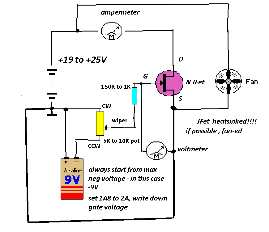

I have the page bookmarked for matching SIT devices can I try that, 24v and 9V on potentiometer.

ZM's test will tell you whether your SIT is good for SissySIT voltage and current.
A simple test that gives basic information whether there is a short is this one in post #8:
VFET testing method and result
Source,1K,+9v-, grid. (Testing SIT)

There are three tests:
1. NO battery. Diode test D-G, and S-G. Should show as diode.
2. NO battery. Connect G to S with 1K resistor in series, measure resistance D-S. Should show low resistance.
3. Battery with 1K resistor in series, positive to S and negative to G. Measure resistance D-S. Should show high resistance.

When -9V is applied to G-S, D-S should measure very high resistance as the negative voltage to gate turns the device off.
When you shorted G-S and measured a low resistance, that is expected as the device is turned on fully and D-S is fully conducting.
I thought it was a positive device so I used +9v.
Closed loop meaning no resistance. Fully connected. OR

D-S measures 0r4 without power, and 0m1 with -9V to grid, 1K, source.
