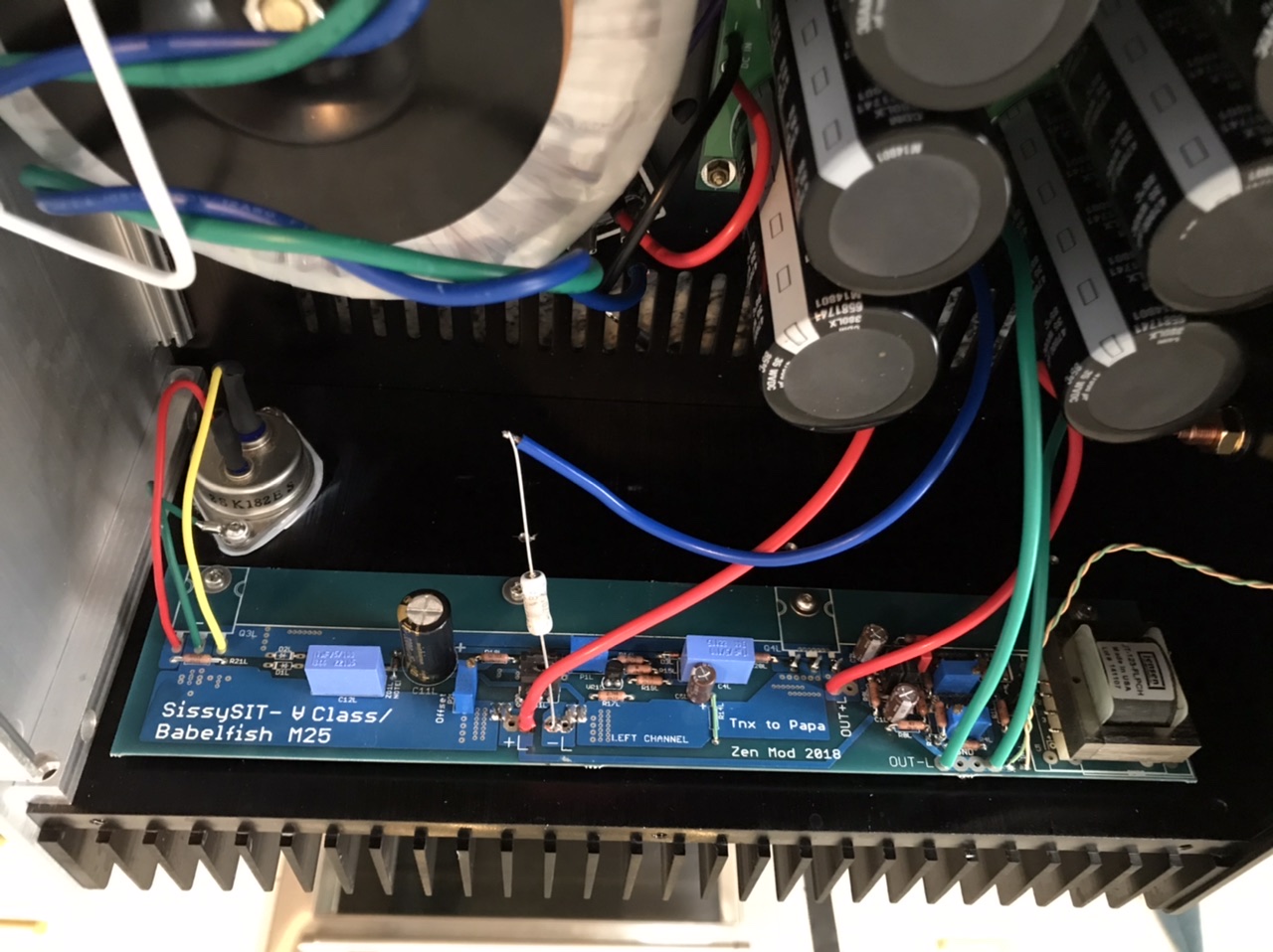

I replaced the Mosfet on the drifting channel. @170mA the mosfet tested Vgs of 4.1V. The ones in my 2nd kit also measure 4.1. I cut the pins removing it from the PCB, so I have some more Mosfets on order from Digikey. Hope I can get 4V+ Vgs in the batch I ordered. I should learn to have more patience in solder removal, because this time it is costing time and money.

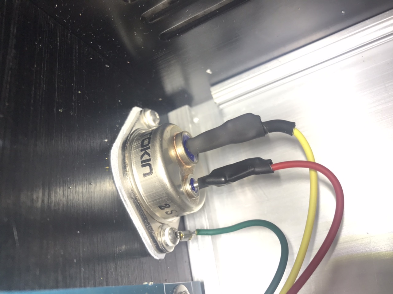

When I went through the drifting channel checking for any other things, it turns out the screw on the SIT with the wire and eye connection was not very tight. I suspect that poor connection may have been problematic. I tightened it up.
The channel was better to bias after these updates. Still a little drift/float, but I decided to call it "good enough" and go into field testing. I lent it to a friend for a few weeks while I finish his 2nd F5 Turbo V3. When that's done I'll build SissySIT #2 for me, I need 4 channels to run in my active horn system.

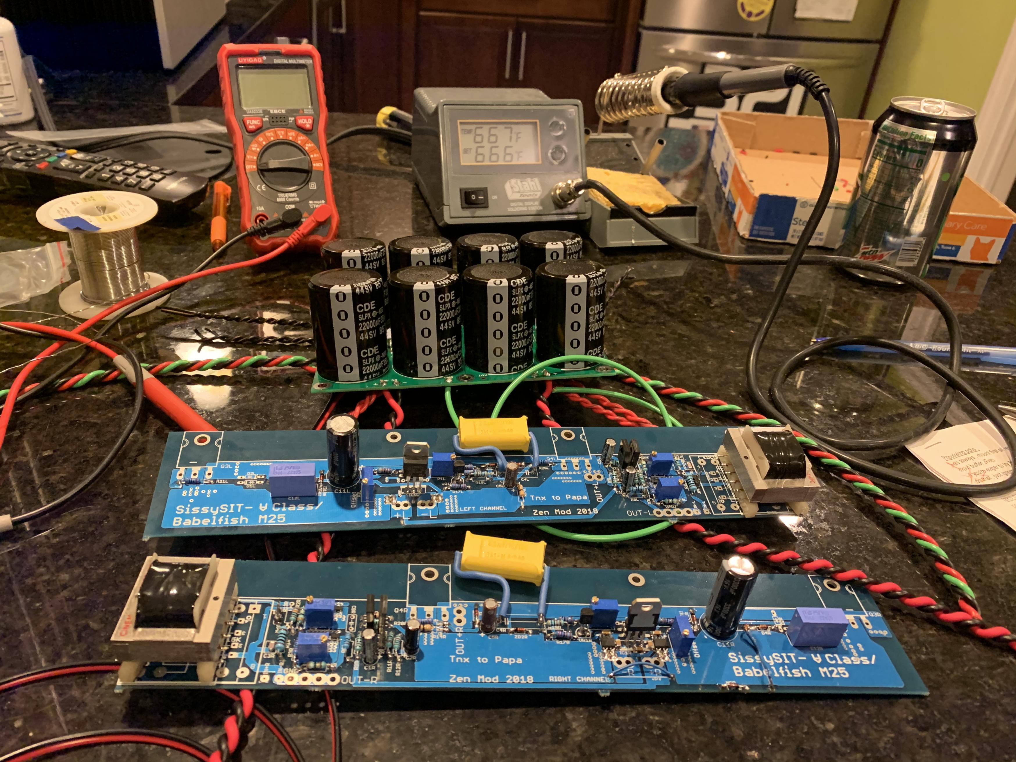

So after setting p1 to 0r I am still having high draw to the point of melting fuses.
I have the Vfet and mosfet isolated, where’s the short?
Or is my R47 to small and wanting to become a light bulb?

But from what I’ve seen so far it looks like it’s pulling over 10A per channel. 🙁
The power supply is making 24V +/- and working great.
What could pull this much amperage?
Vfet drain to ground measures 100R on left and 1K on right.
Could Vfet bias be starved with R47 and causing runaway?

describe your PSU , +/-14Vdc doesn't make sense , except in case of juicing same 10A on both rails
drain to gnd is not telling me anything - too much things connected , so really not relevant info
buzzer/diode test poor mosfet between all pins ; it's highly possible that you killed poor bugger in first moment
Another possible issue - check that there are no shorts to the heatsink caused by long component leads protruding from the bottom of the pcb. The pcb is very close to the heatsink to suit the mosfet thickness so clipping all leads short is critical.
