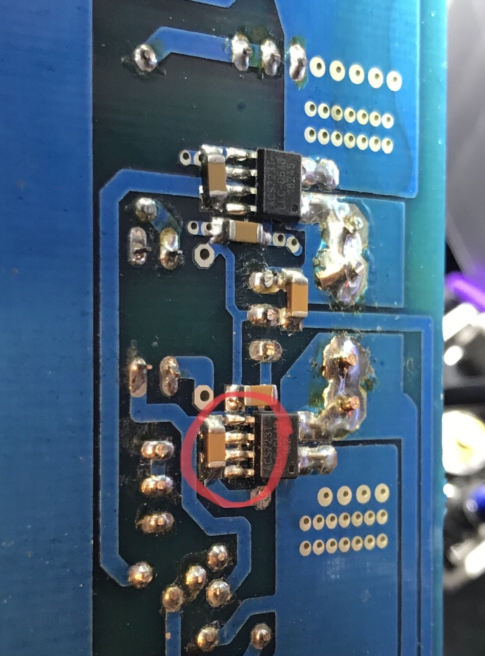

Ok, so after scratching my head all morning I decided to redo the Tokin Drain connection, scratch and clean all the close solder connections on the board. So after all that I’ve reinstalled Fets and powered it up with 60w bulb And 3A fuse. The bulb lights up and goes dim.
Offset measured 10V, draw across 0R1 was 60ma.
I’ve done the work to both boards but only powered up one.
What should I try or measure now?

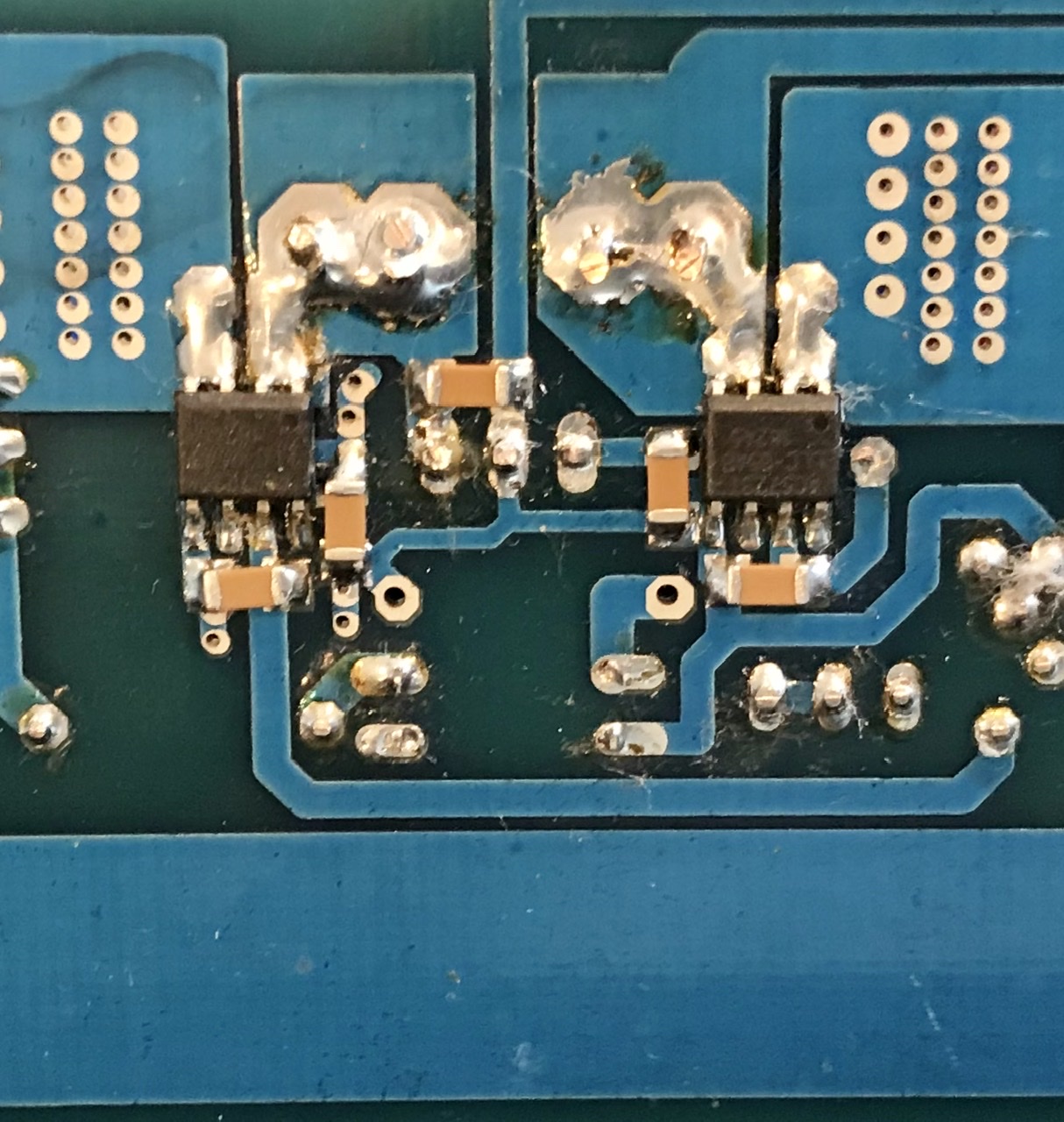

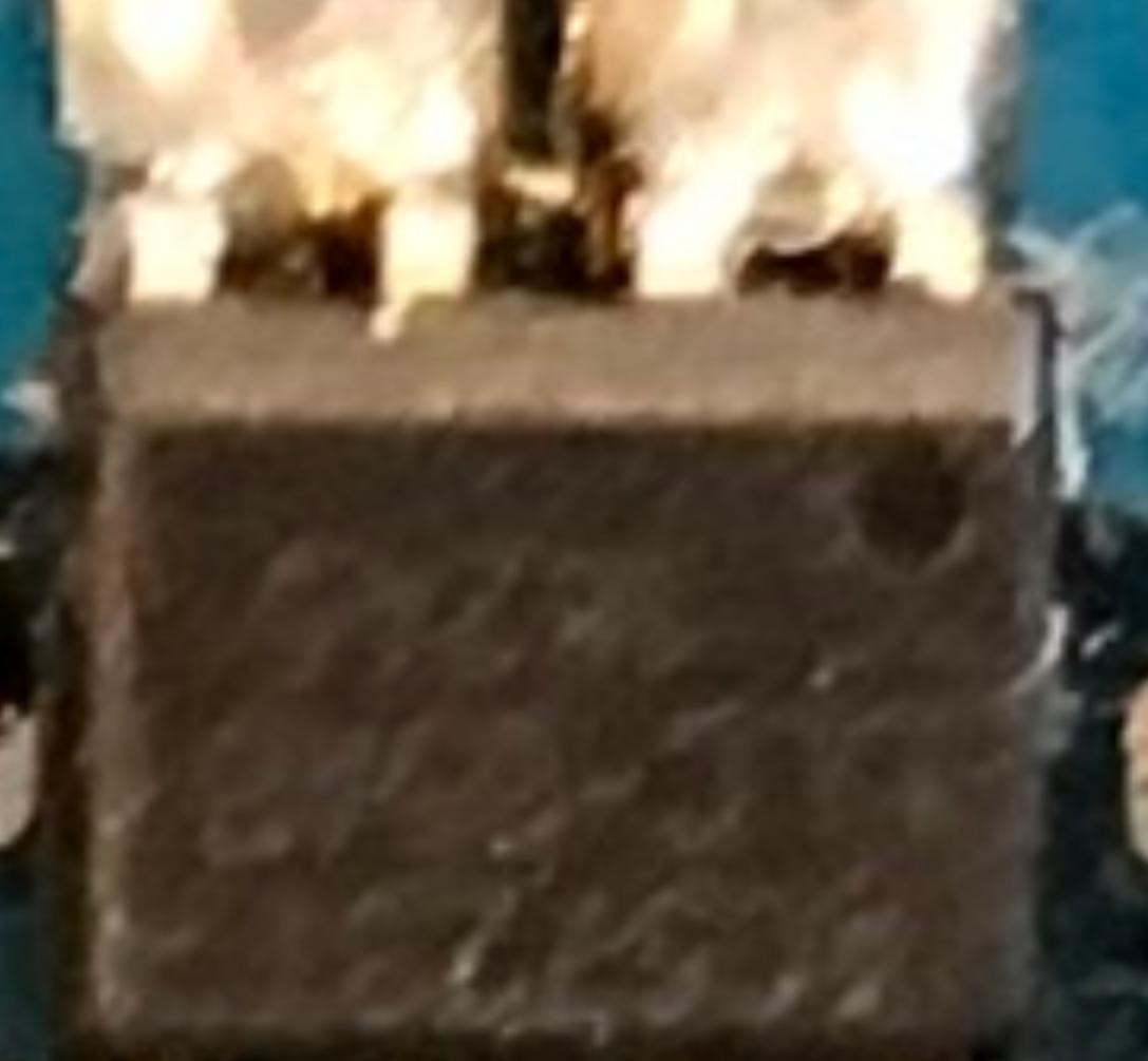

Powered it up and small puff of smoke around hall devices and dead 9240.
I will check resistances on hall devices to see if any are different.
The left hall has very little gat between the lower center pins.
I think there was a small puff of smoke from this general area.

yeah , check that
I'm checking for shorts after soldering Halls, with 17 lenses and MW light , in same time checking orientation of halls
while developing , I had rotated Hall , I had rotated 7805 and I had small wandering solder blob/ball wandered from who knows where , ending where I didn't need it at all
that's why I'm hysteric in checking every Hall , also after soldering PSU wires , when making an amp
however - as I'm always blaming Pa , feel free to blame me , if you find shorted Hall :bawling:
sole good thing is - it can't be destroyed if there is short , exacto knife is enough to cure it, if you're rather using it than solder tip
and , if doing those wires again , be gentler than you did

I think ZM is being kind. It looks like you've used quite a bit of solder around those legs. Good news per ZM - just clean it up.
I'd hate to think one of your SITs is shot.

What confuses me is how I pass the dim bulb test for 30seconds+ and then go direct and get huge amp draw and fry the 9240 in less than a second. I’m on my 5th one and the heat from unsoldering is taking a tole on the pcb. One of the barrels came out this time.
I think there’s a bridge in the middle here. It’s tucked under the hall devise.(shiniest jewel) I’ll have to remove the cap to get between. This stuff is so tight A knife will make a mess. I’ll just keep taking photos to get “eagle eye”.... I’ll also check pinout of hall to understand effect of a bridge in this location.
Yes I to think Tokin is ok, it conducts and closes. 9240 just conducts on every pin. I will have to make artwork from dead bugs.

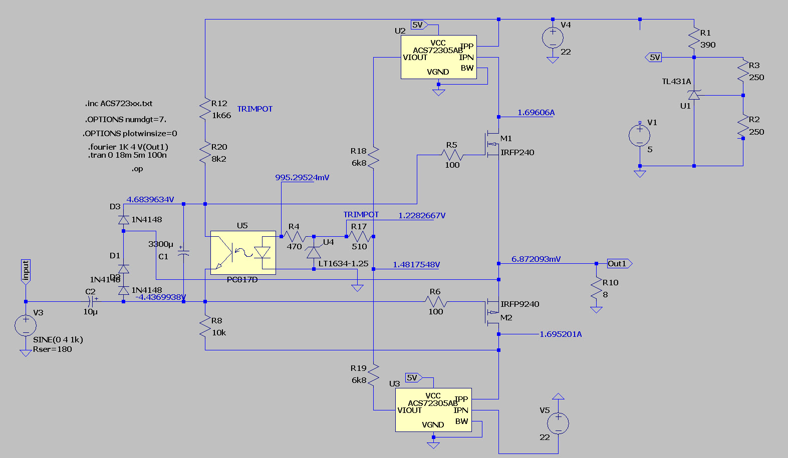

So after looking at schematic that jumper puts 5v on Vout of hall device. Will that kill 9240?
