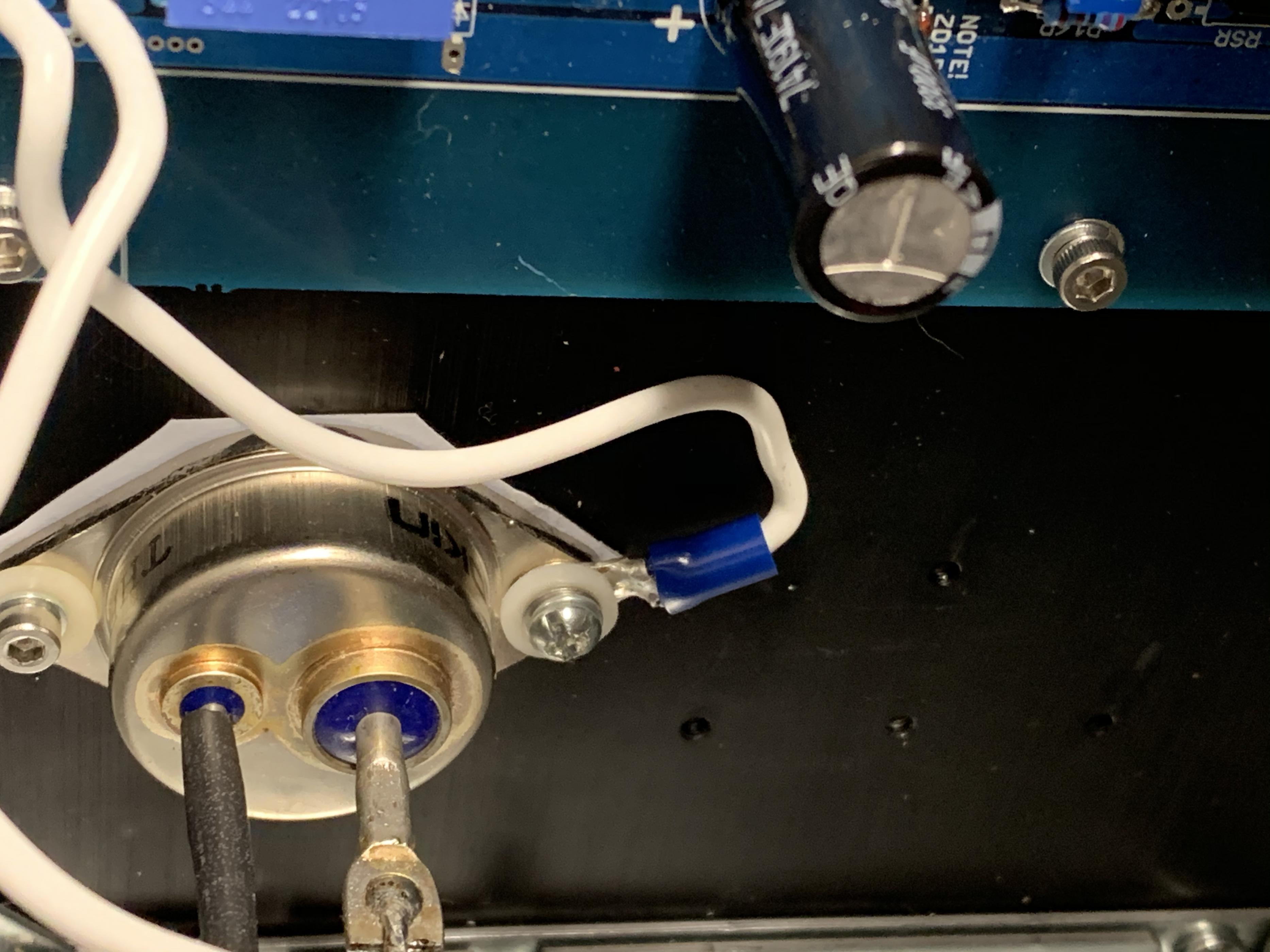

I am re-biasing SissySIT #1 after fixing snubbers. I also made a change to eyes on SIT connection. Amp is behaving much better. Was it my power supply or a suboptimal connection to SIY?

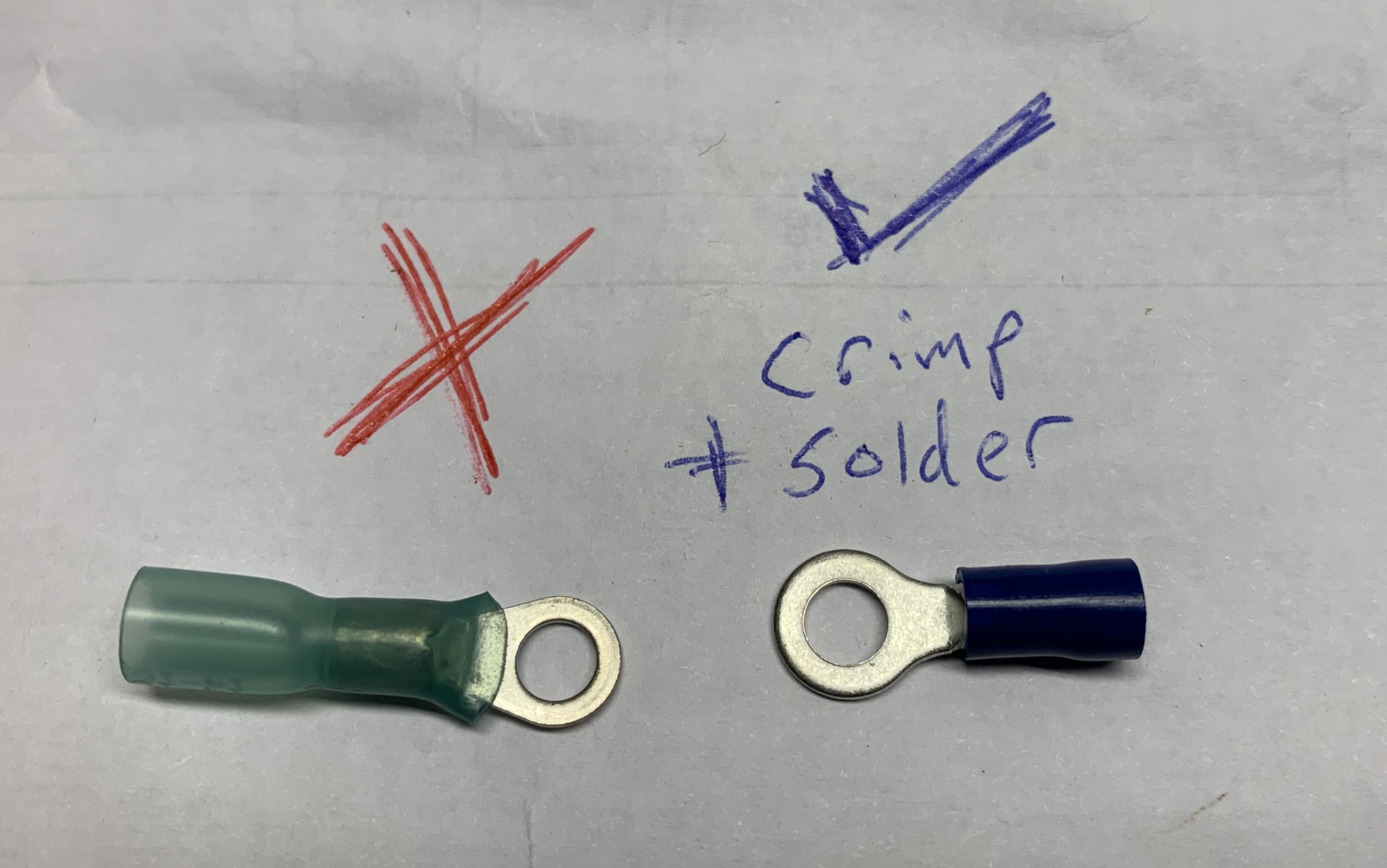

-remove plastic drek ; easy if you heat it shortly with heat gun , set to mid temp
-usually it's needed to cut solder connection on upper side of lug with cutters (pliers) so you can squeeze wire properly - each half independently
-solder it properly
-place heatshrink tube of appropriate color and dress it with heatgun
-that's proper connection

I thought I was alone in this process! Grab eye with old heavy needlenose, hold in flame of gas stove (in my case) scrape off plastic bit. crush and solder covering with shrink wrap.

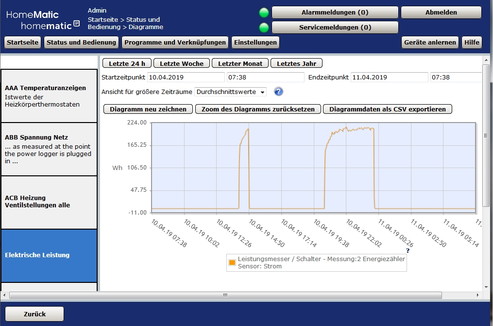

I have tracked the total current draw of my SissySIT with an energy meter. The total draw for the amp levels out at around 230W, usually. (the label on the Y-axis is not correct - it should be W). Amp is not in constant use at the moment; the next time I open the amp, I will adjust bias down some more.
