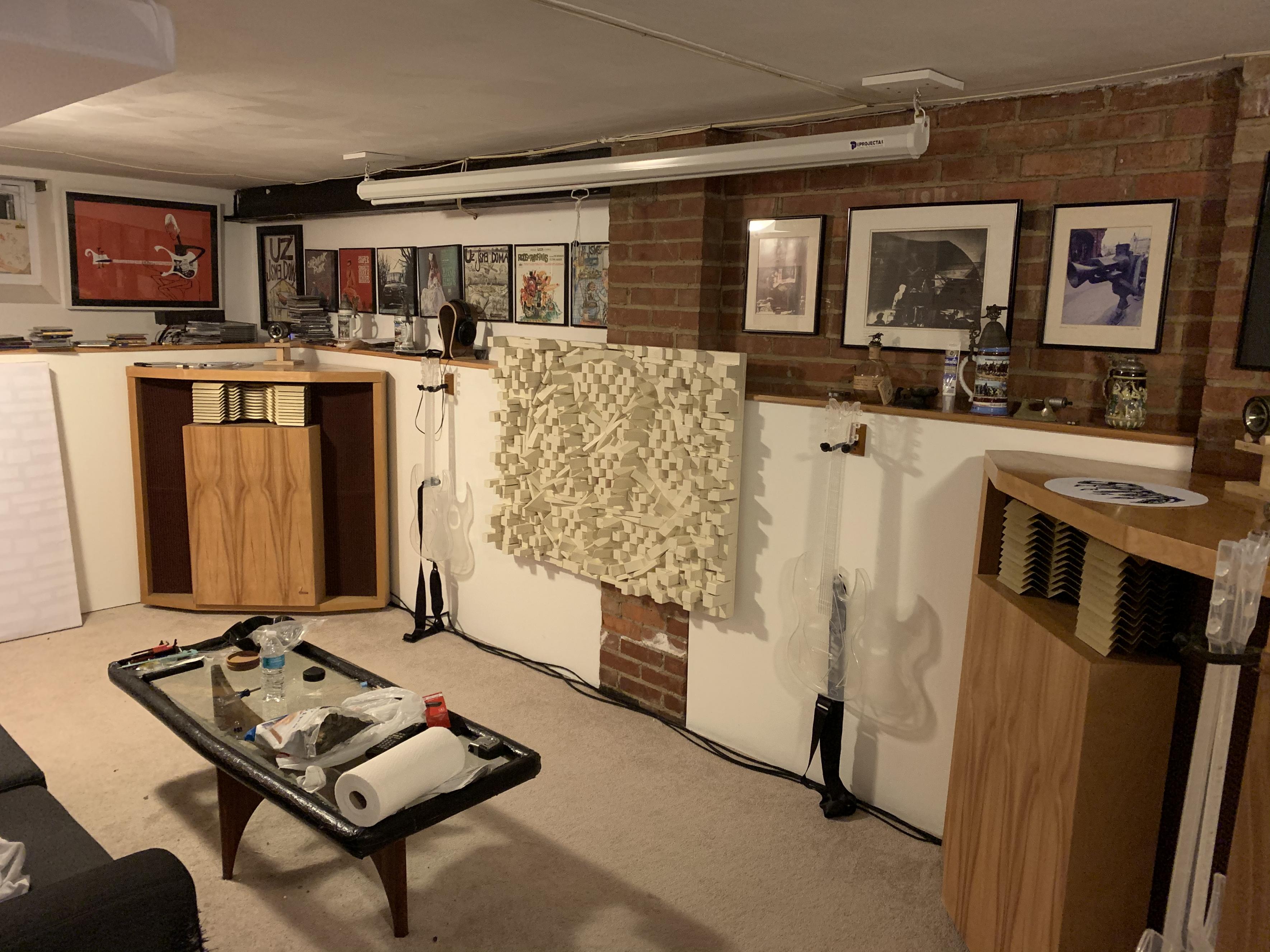

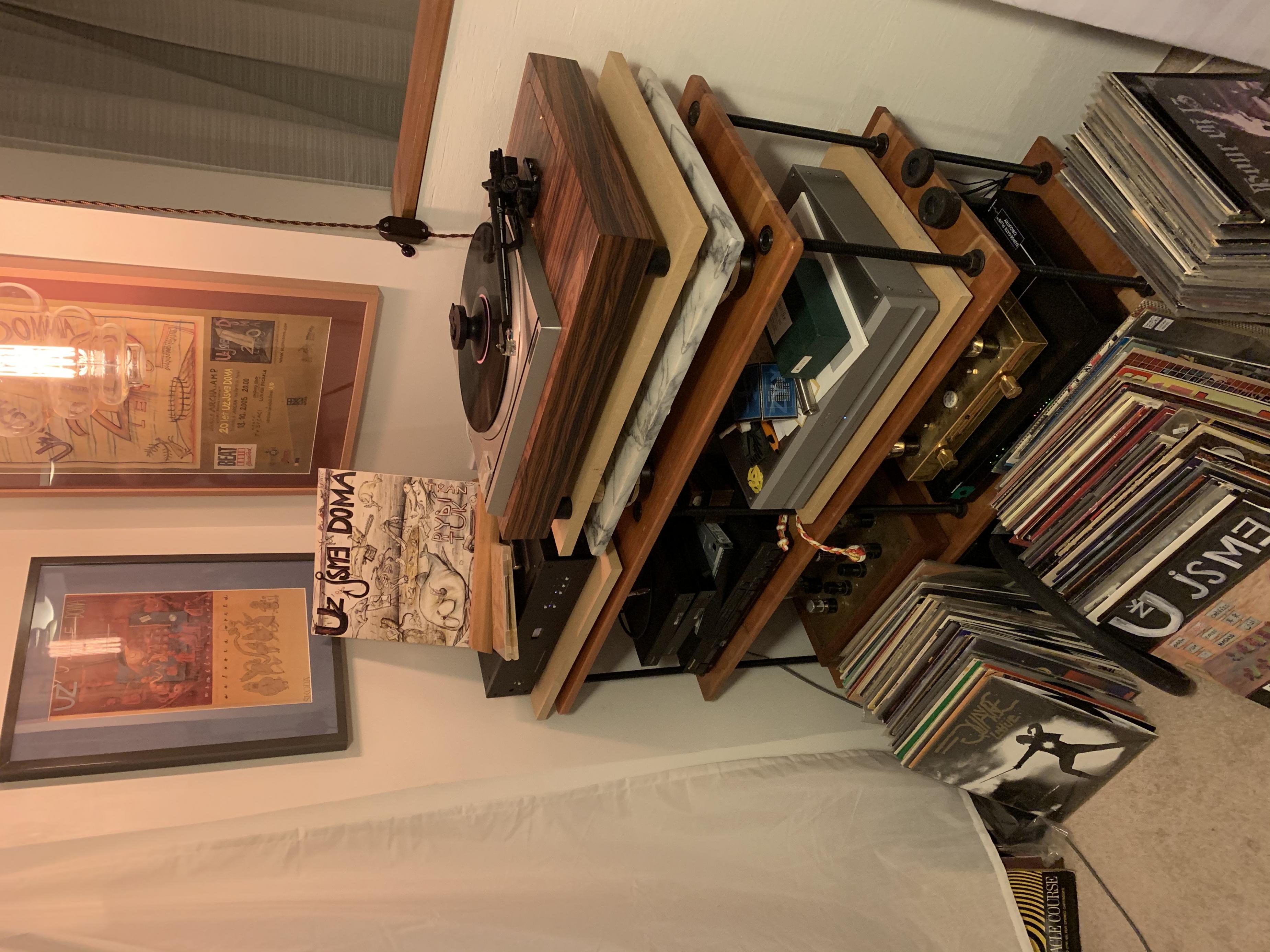

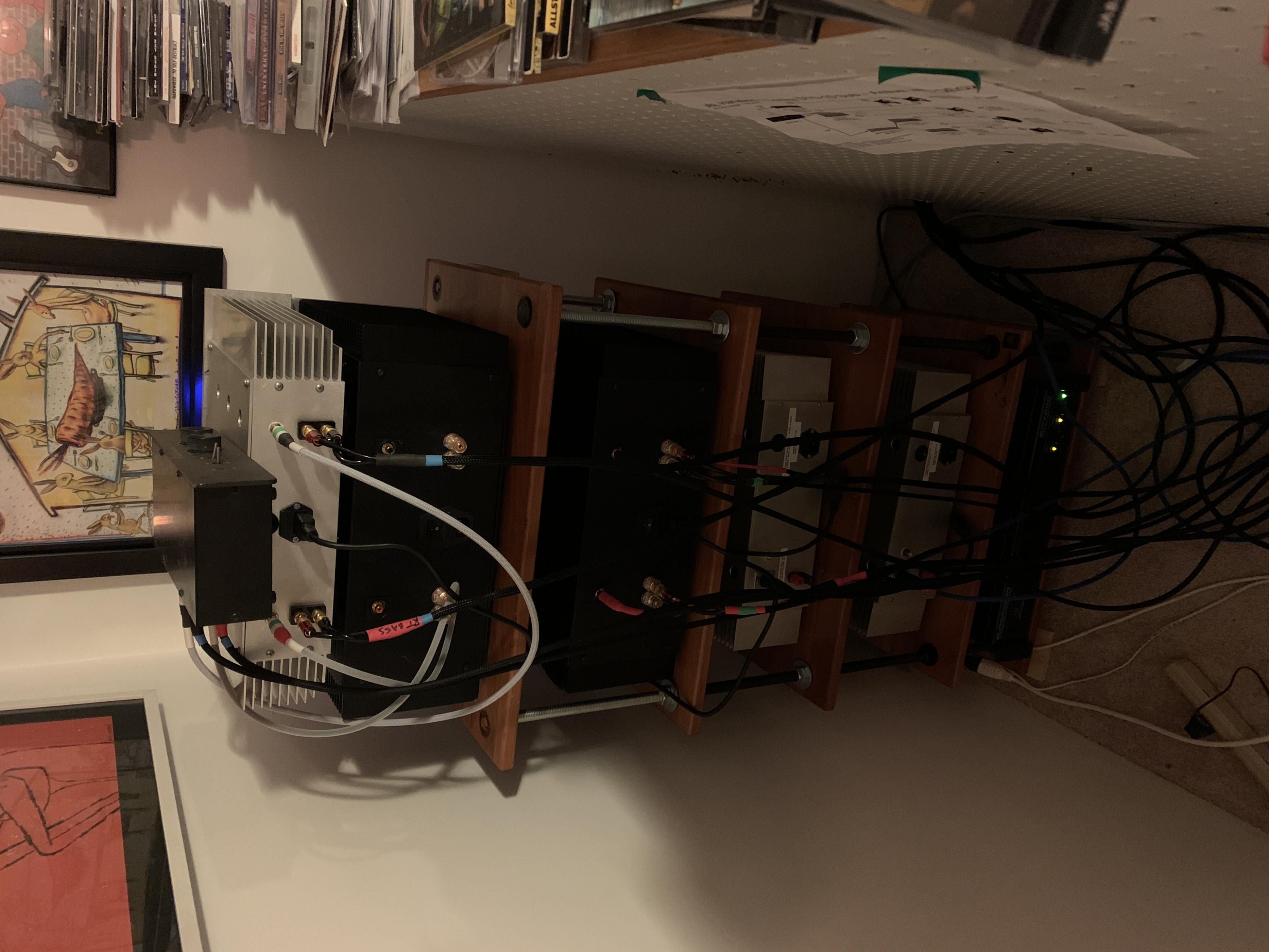

ZM - here you go. The amp rack is top to bottom: F5, sissy x 2, aleph J mono x 2, Behringer. Passive pre on top temporarily for F5. J Mini stereo amp is by my workbench, and F5 #2 is on the floor.
Need to do final tuning in DEQX for levels.
I’m listening to a favorite John Zorn Masada album now. Sounds incredible. Listened to a Haydn quartet, amazing. Albert king, Cars, and more were also wonderful. This has a magical midrange and highs.
