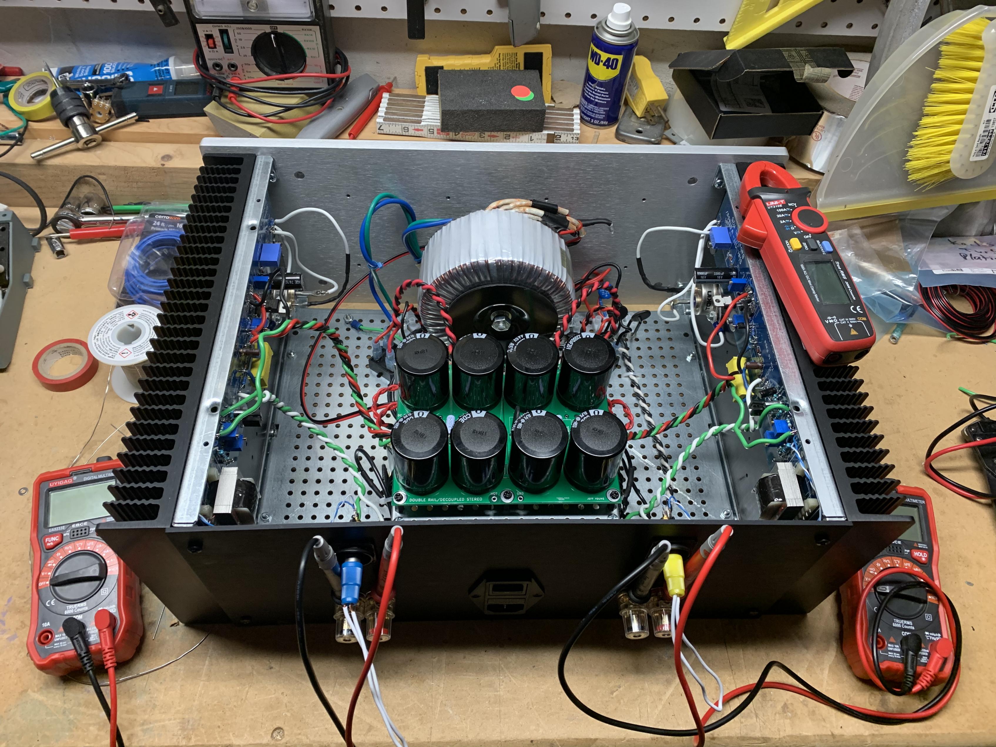

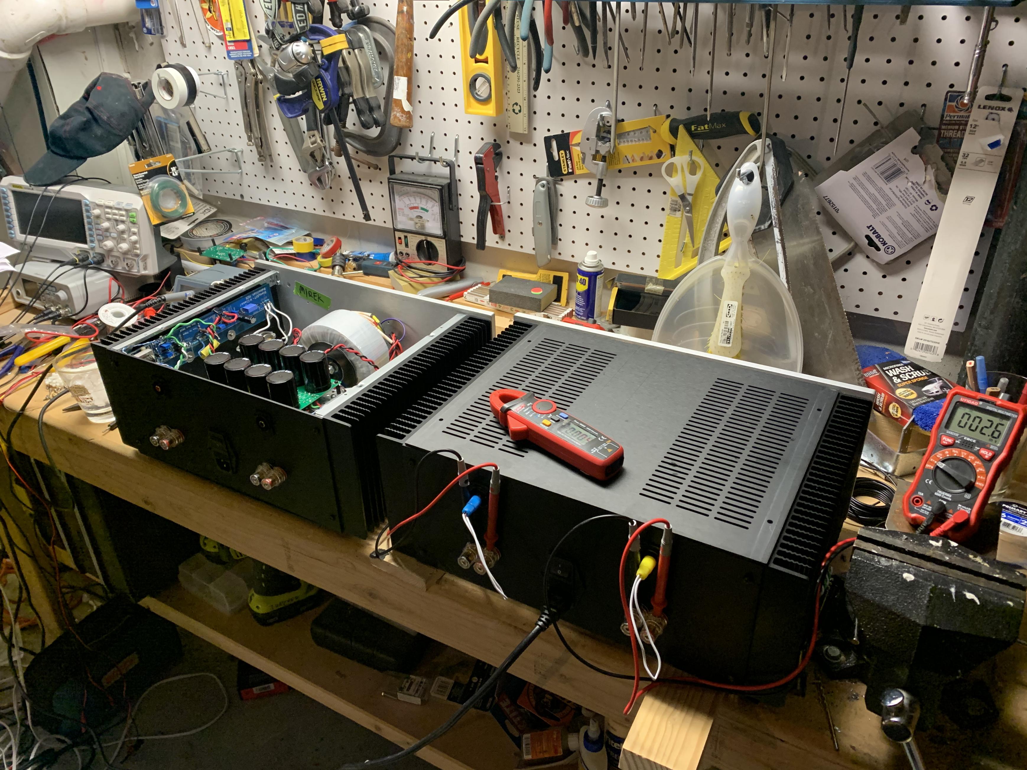

Sissy #2 was finished now is in bias / cooking mode. This one is much more stable than #1 with respect to coming up to bias and holding offset.
Differences are:
I bought all new Bourns trim pots with the legs aligned.
9140s are from an order I made
I noticed my snubbers (Rs, Cs, Cx) were after bridge rectifiers, not before.
Tranny is antek an-4218, #1 has AS-4218
#1 has 180k parallel resistor on R19
I think build #2 got more attention to every solder joint and wire twist. It’s a cleaner build.
I cleaned up snubbers on #1, and I’ll check bias on it after #2 is stabilized. Can’t wait to put these into my system. Gotta have both with my active system.

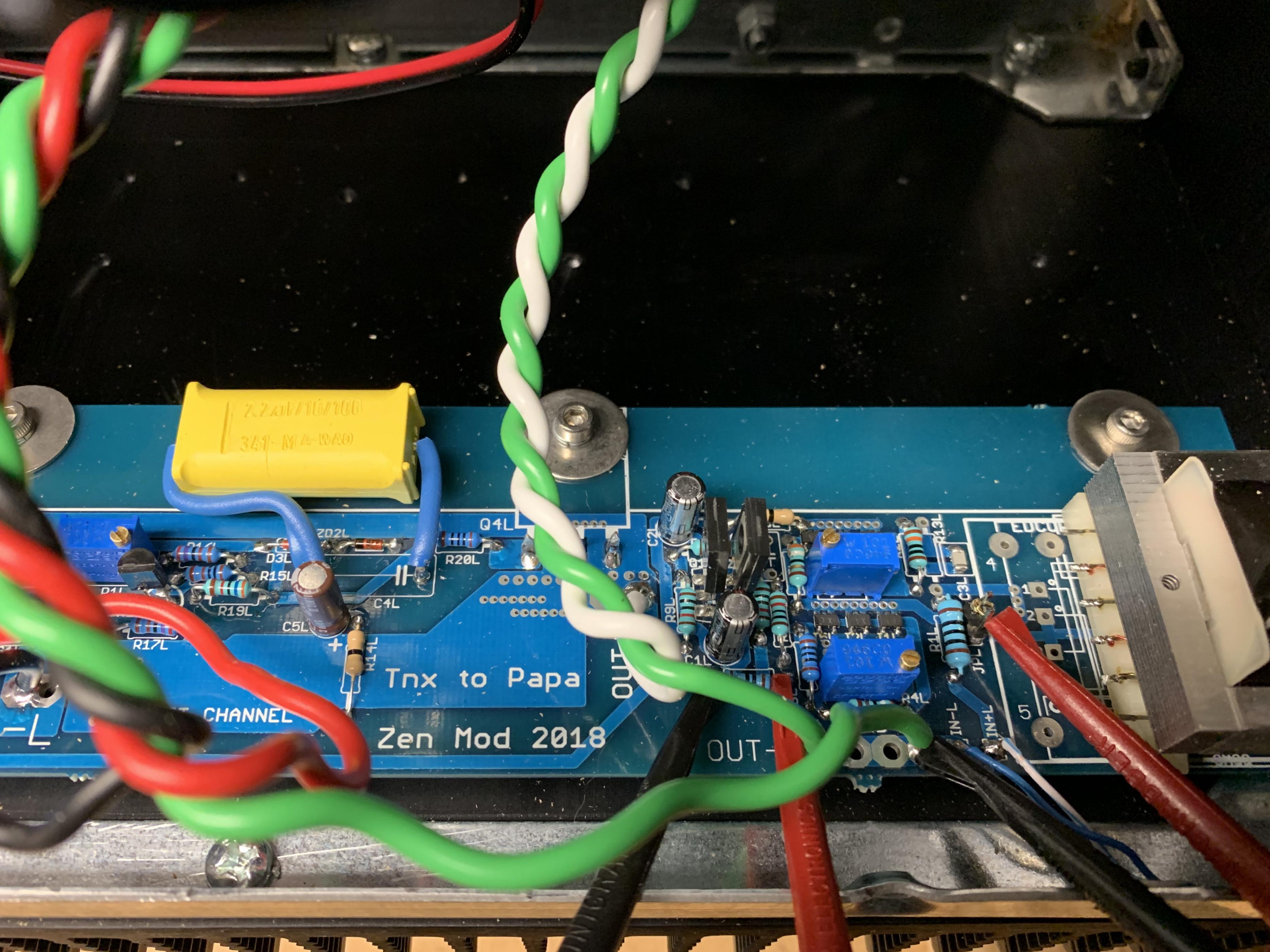

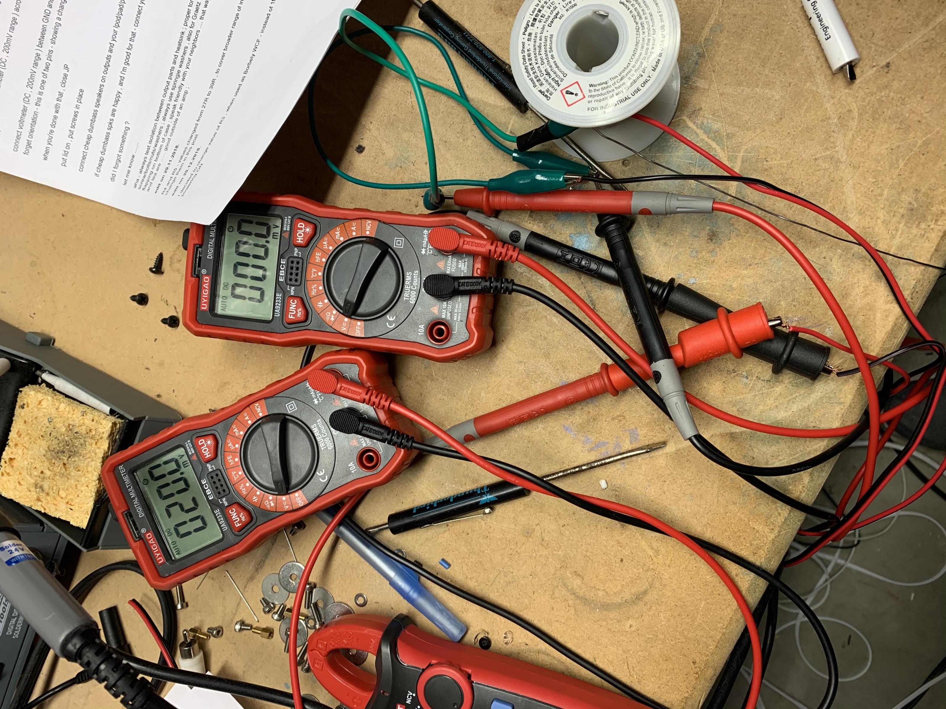

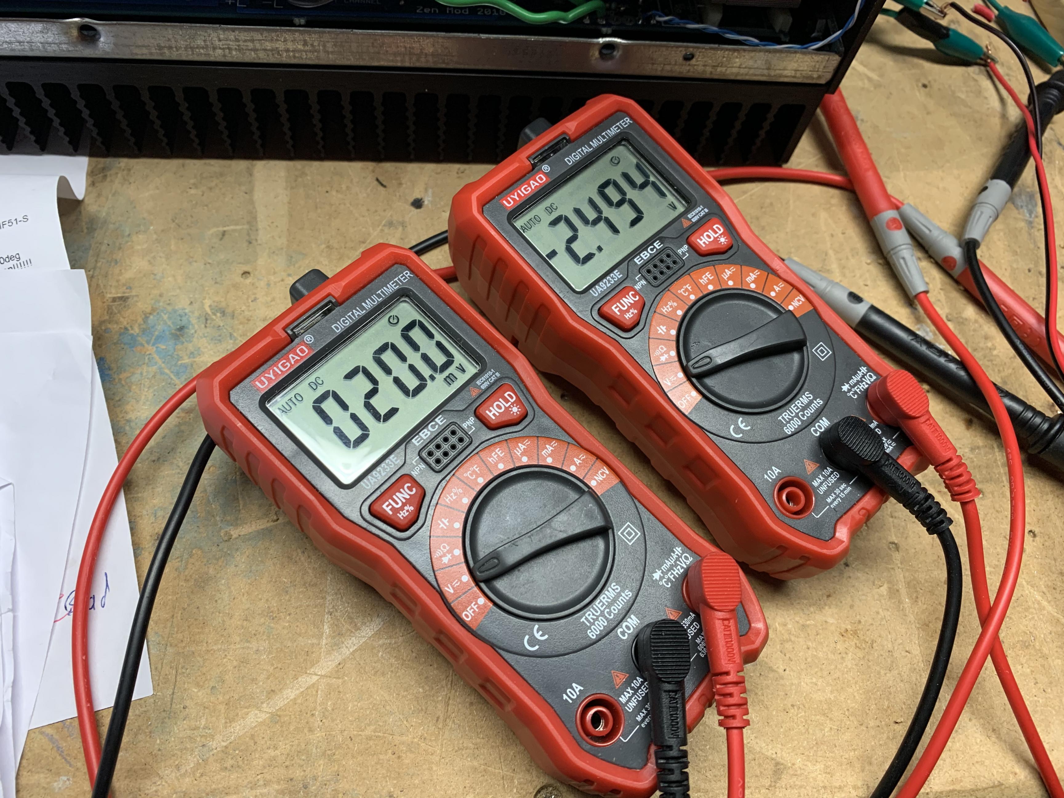

ZM - need some advice. SissySIT #2 output biased up very nice. Right channel input buffer was easy to set to 20 mA and 0 offset. Left channel input is not playing nice.
I double checked R6 max and R7 zero. Both are set correctly. I get 13.2 mA and -1.8v initiallly, then I adjust for 20mA, offset voltage climbs up. Adjusting R7 increases offset even more.

It works much better with 47k in R18. 12 ohm resistor makes 9240 go to heaven.
1amp fuse plunged into power biased up to 128mv on 0R1 resistor and still adjusting.
When I measured 10V offset earlier today with bulb test That was clue.

source resistors are 39R and trimpots are 100R ?
be sure that all solder joints are pristine
