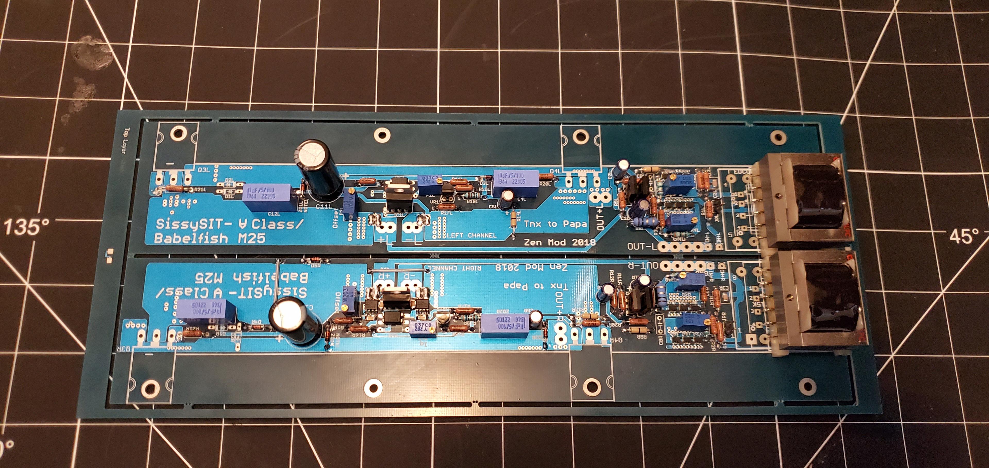

... because pictures or it never happened
It was late and the lighting was pretty bad but I will post better pictures as this progresses.
Some things I learned from stuffing these:
- MZM gives you 10 diodes (1N4148) but you only use 6 for M25 (D1, D2, D3) and 6 for Sissysit (D3, D4, D5) so you really only need 6 and the extra 4 are gifts. If this is totally wrong please let me know.
- don't think you can be cute and replace the series resistance at R21 with a single 200R until you've read the post where it says to put 100R as close to the gate as possible (directly at the SIT) or you'll be desoldering like I did
- CBL on the left channel is best soldered from underneath to avoid getting close to the 2SK2145 or you'll be in there with a magnifying glass and solder wick and flux like I did
- Home Depot carries #6 and #8 split/lock washers in the tiny bins
P.S. You do need to read this thread (especially post #1) at least 5 times

I'm going to try to see is there anything suspicious at most right pic
in a meantime - solder those resistors in 1-pin headers , just in case
even if one wants later to remove them , it's easy
The amplifier gods have smiled upon me. Got the amplifier ready to try soldering in the optional resistors in the 1-pin headers and decided to do some DMMing and check all my resistors on the input side of the buffer.
R1 started at 100ohms, but rapidly fell to 50, before jumping back to 100 again. Replaced it and the motorboating is gone.
Hopefully my screw taps hold out for one more re-tightening. I tried so hard not to remove the board, but couldn't suction out the solder for the back pin of R1 and had to get on the back of the board to clean it out.
Thanks for the troubleshooting help. ZM, the pre/post buffer information was essential.
Screws are in and music is on in the big system. Still very very nervous that something will smoke at any moment, but it's looking promising.
Thanks again for all the help. Will certainly post more once either something breaks or I'm confident things are working...
