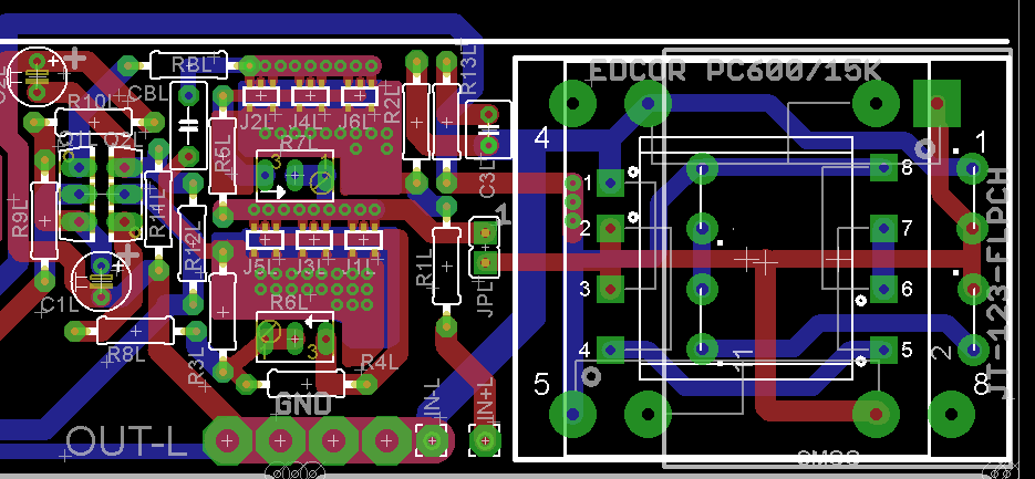

find enclosed little pic of relevant pins of jumper header ;
as shown on pic , upper pin is buffer's side , while lower pin is xformer's ( and rest of amplifier , downstream) side

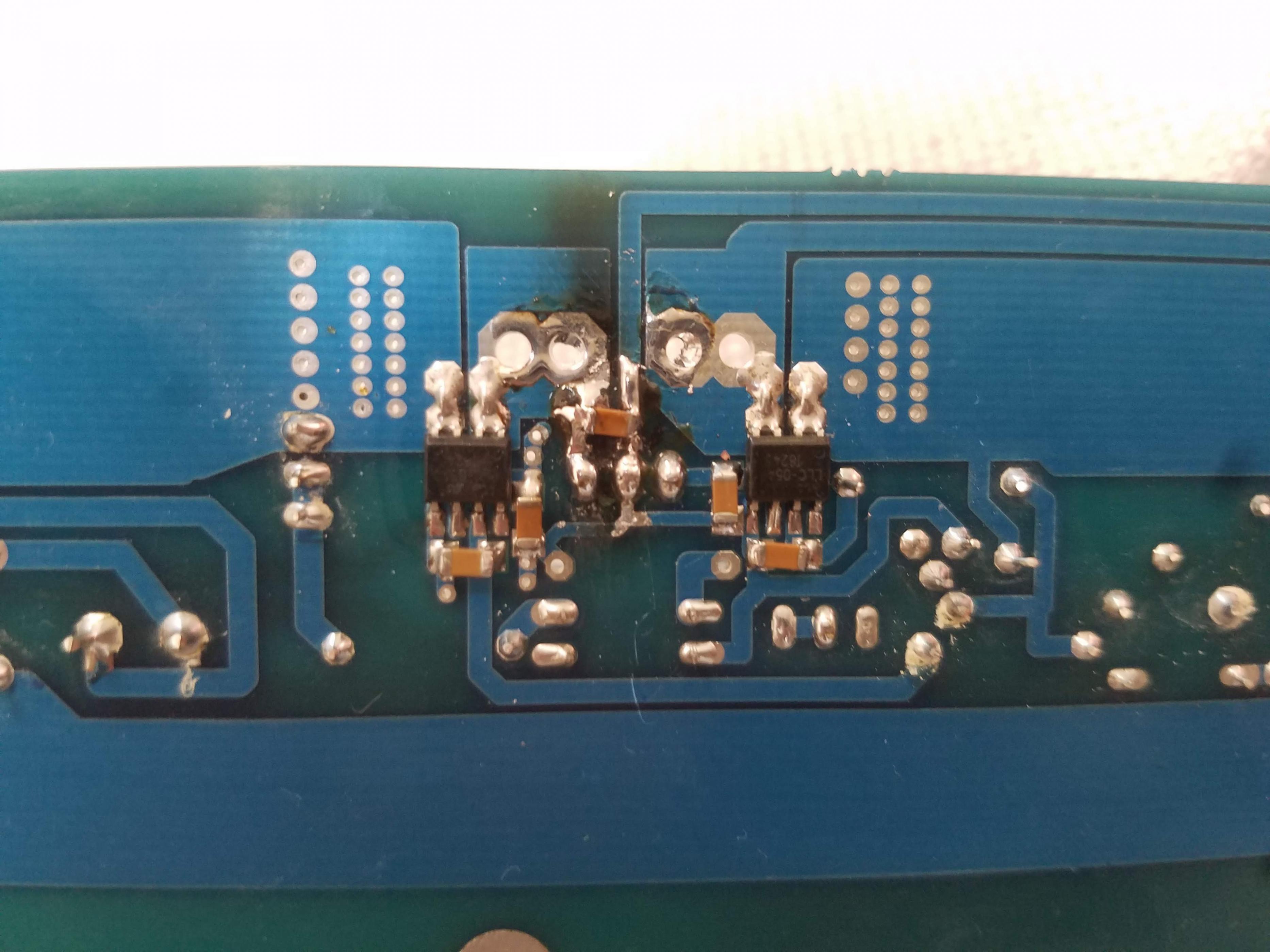

Also, I never got to this point with the "old" left channel board. The capacitor got melted before I got to test for sound...

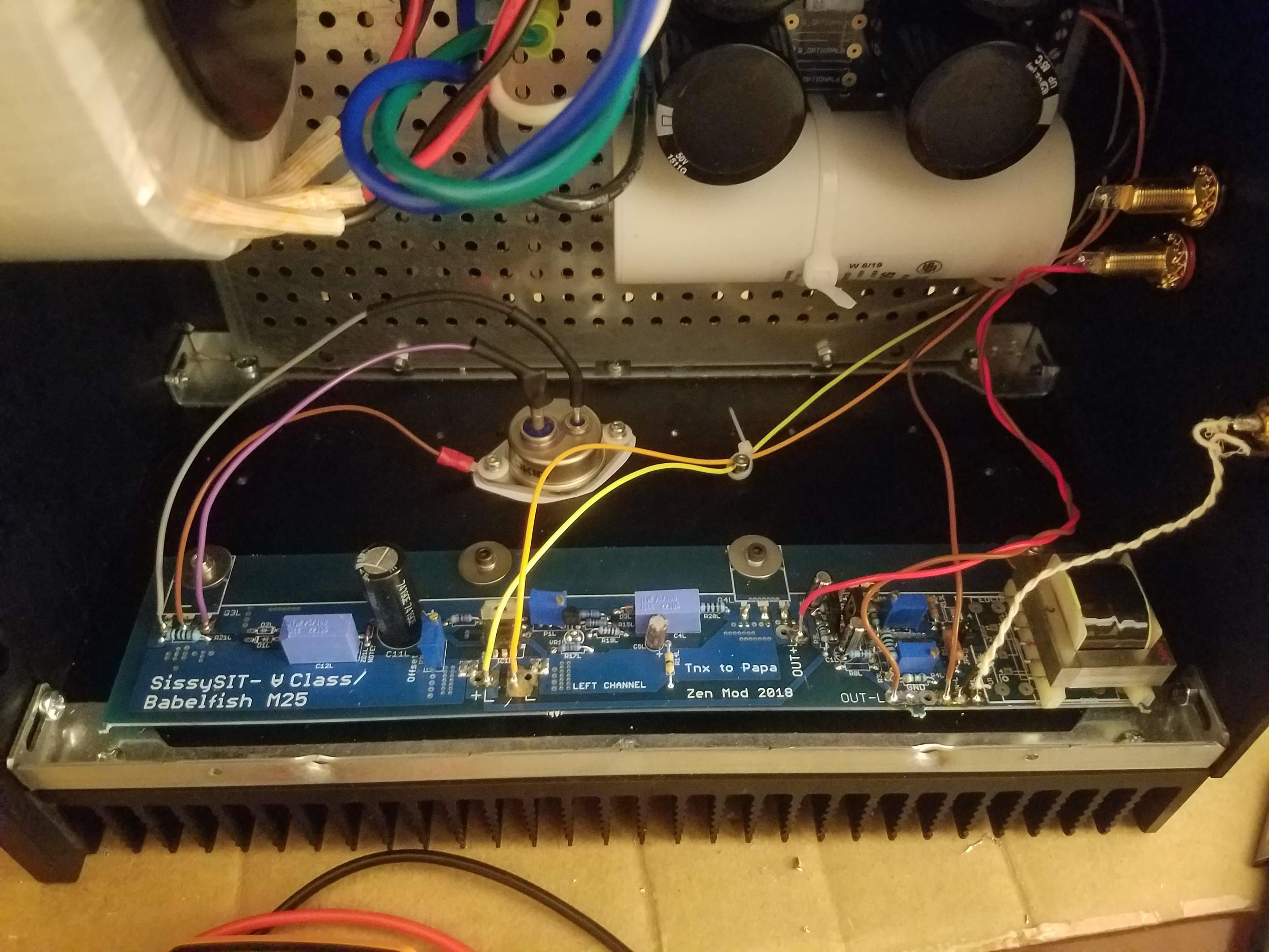

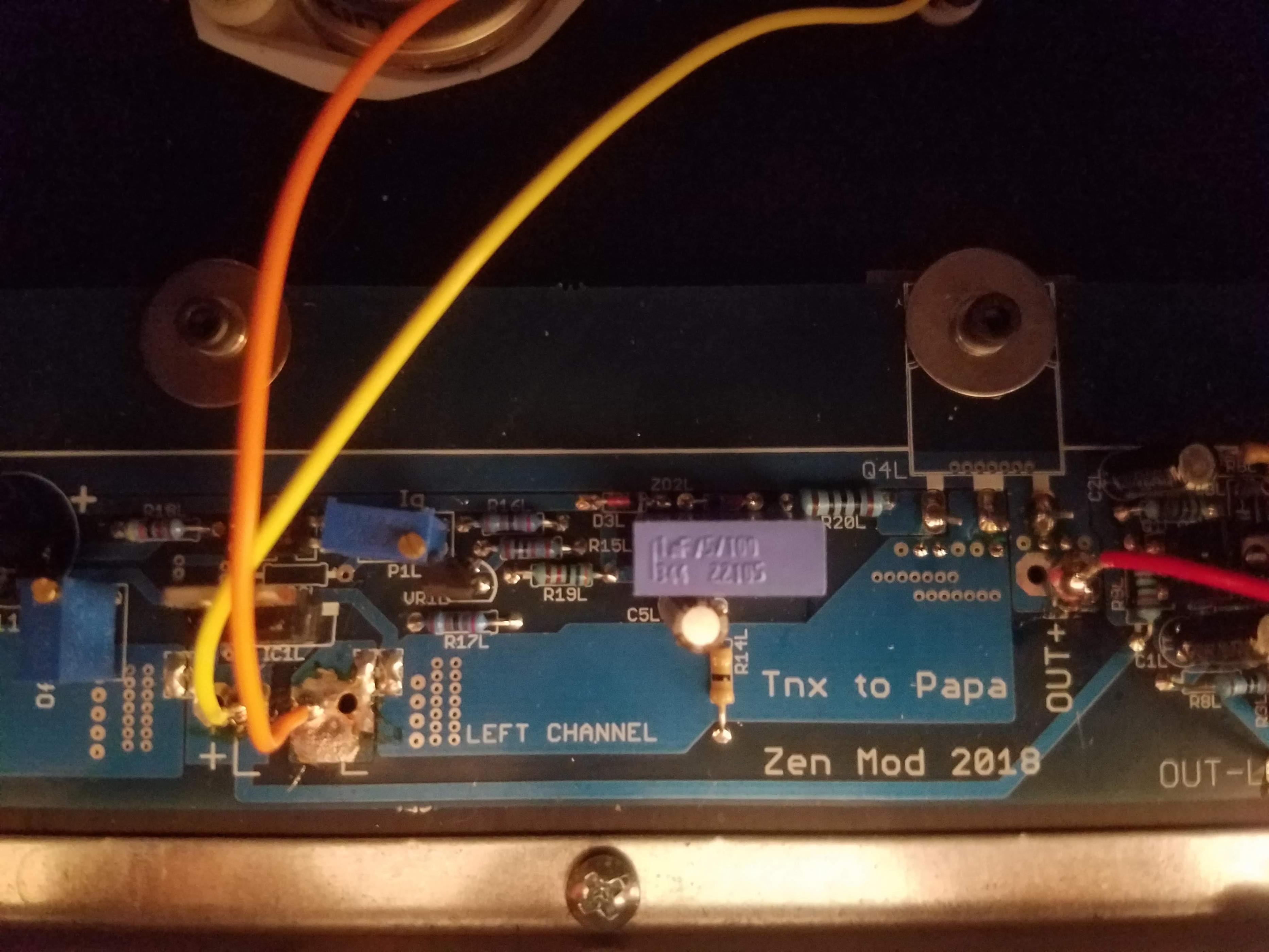

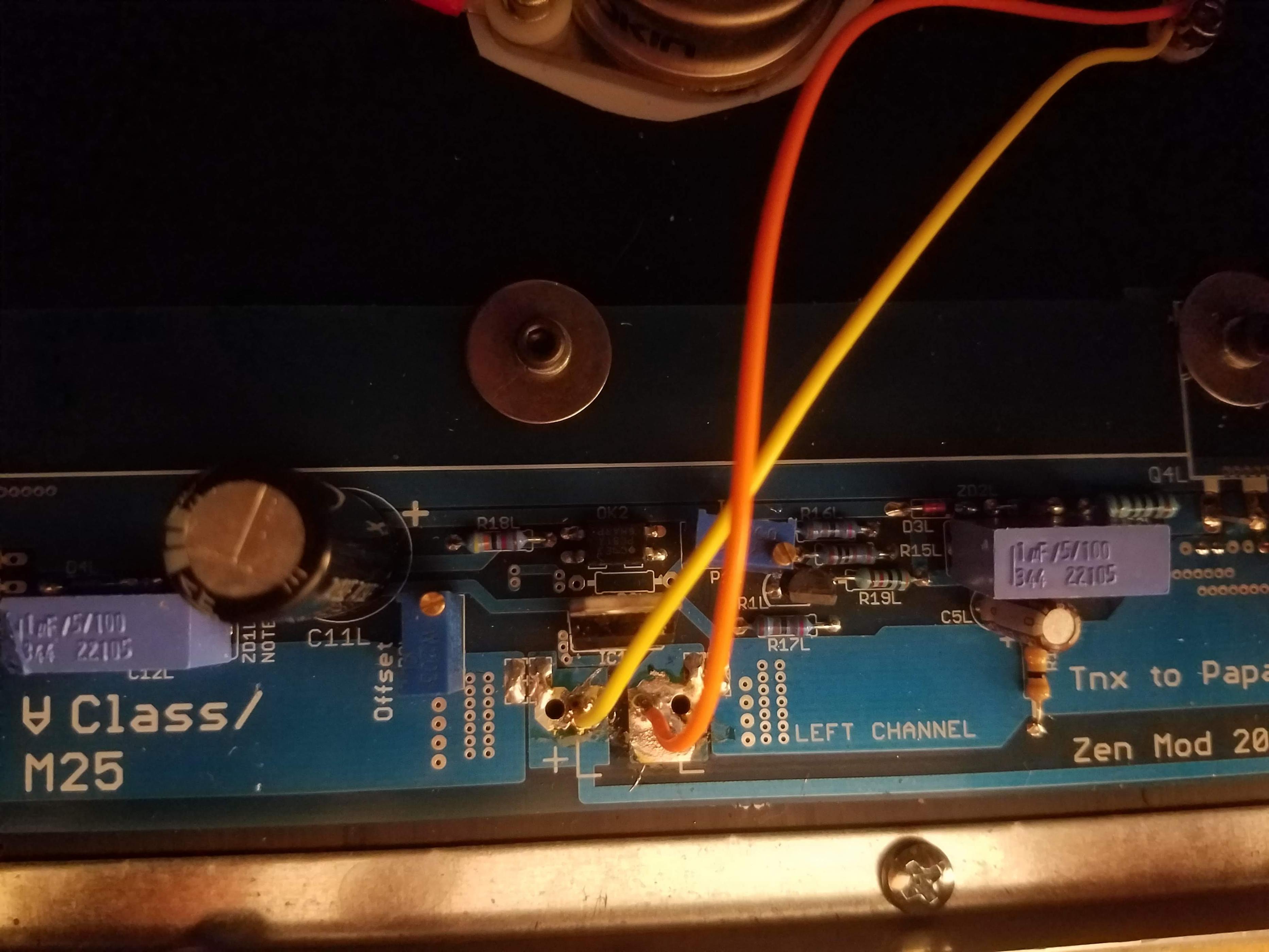

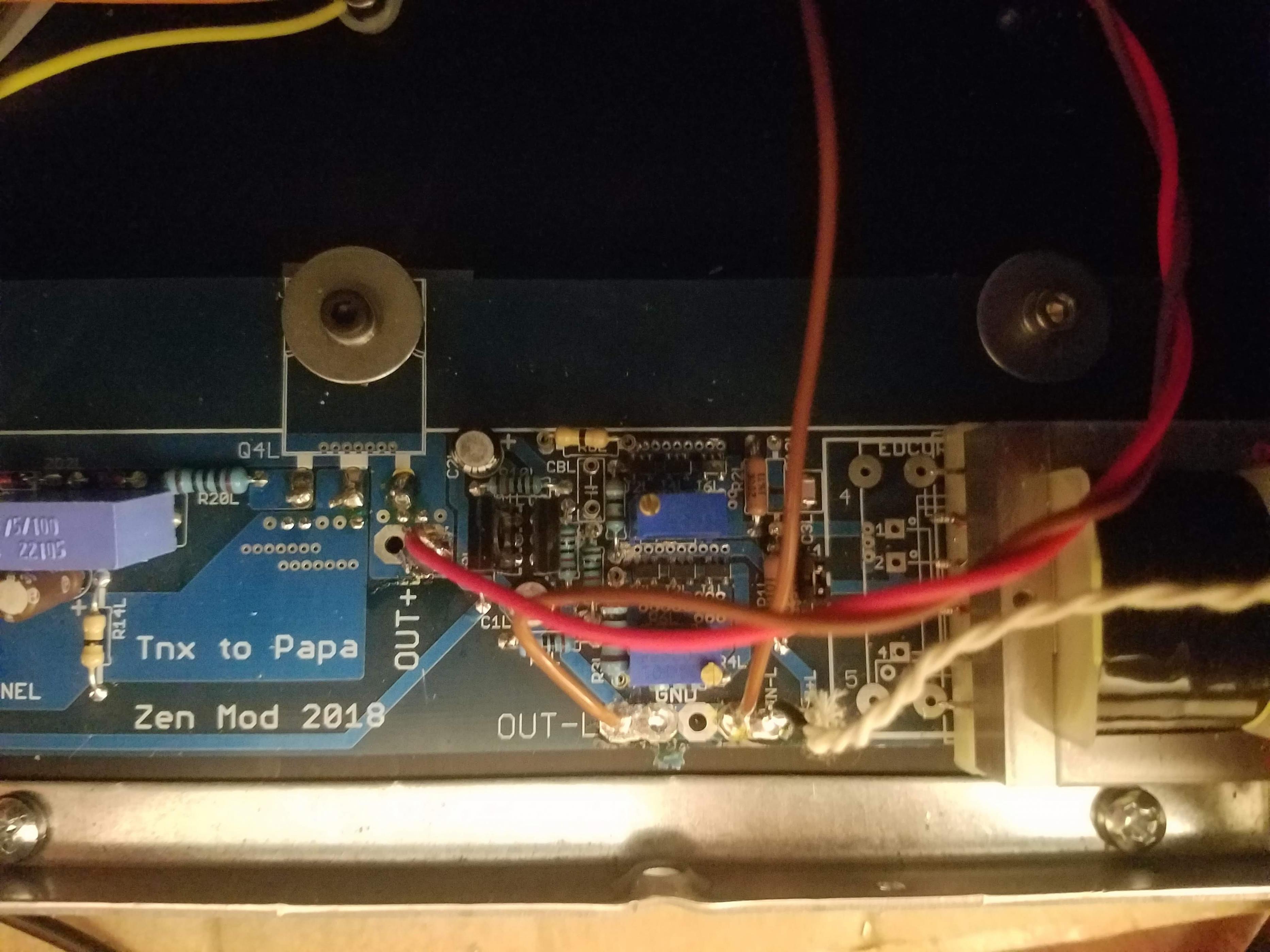

Pics...
Not my prettiest work and I did accidentally get the soldering iron on one of those boxed caps while attaching the SIT.
