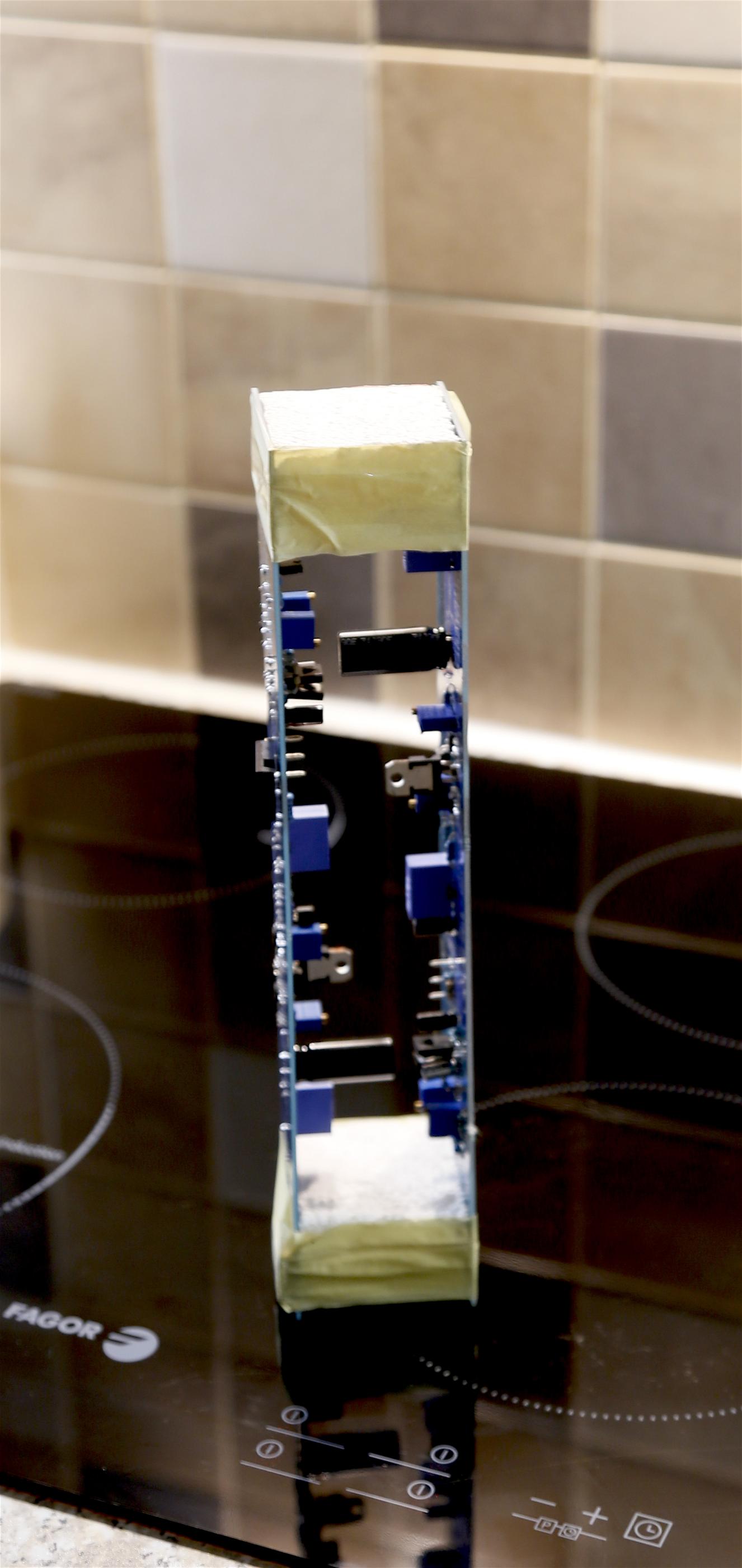

Here is one of my yesterday parcel! (and a couple more)...
The Boards are 'burning in".......NOT😎

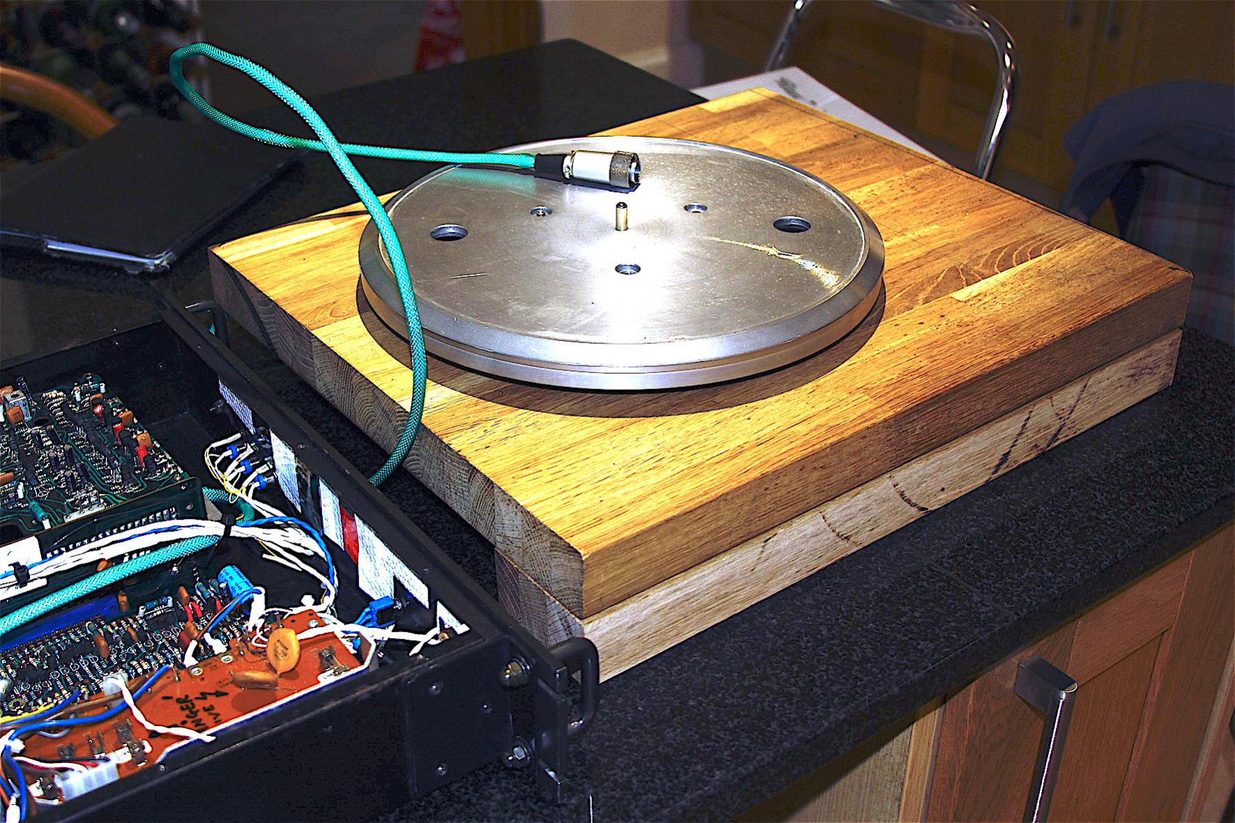

The SP10 is a very ambitious project...just motor and platter in a new plinth...not this kitchen top mock-up. ALL electronics are in the case to the left, and the umbilical carries all power and controls. 🙂
The other one was a garage😱...I may just tidy it up soon!
