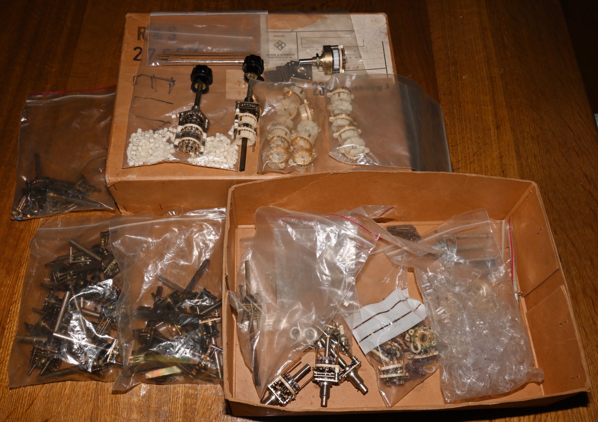

I found a box filled with very vintage (very old) Elma stuff. Maybe you can use that instead of the SJEPs 🙂
I have probably no use for it. It was from a time where you built your rotary switches from scratch. It requires that you can buy the individual contact decks (or "wafers" seems to be the name Elma use). I think today you can only buy a finished assembled rotary switch. I don't use rotary switches I switch manually at "RCA level".

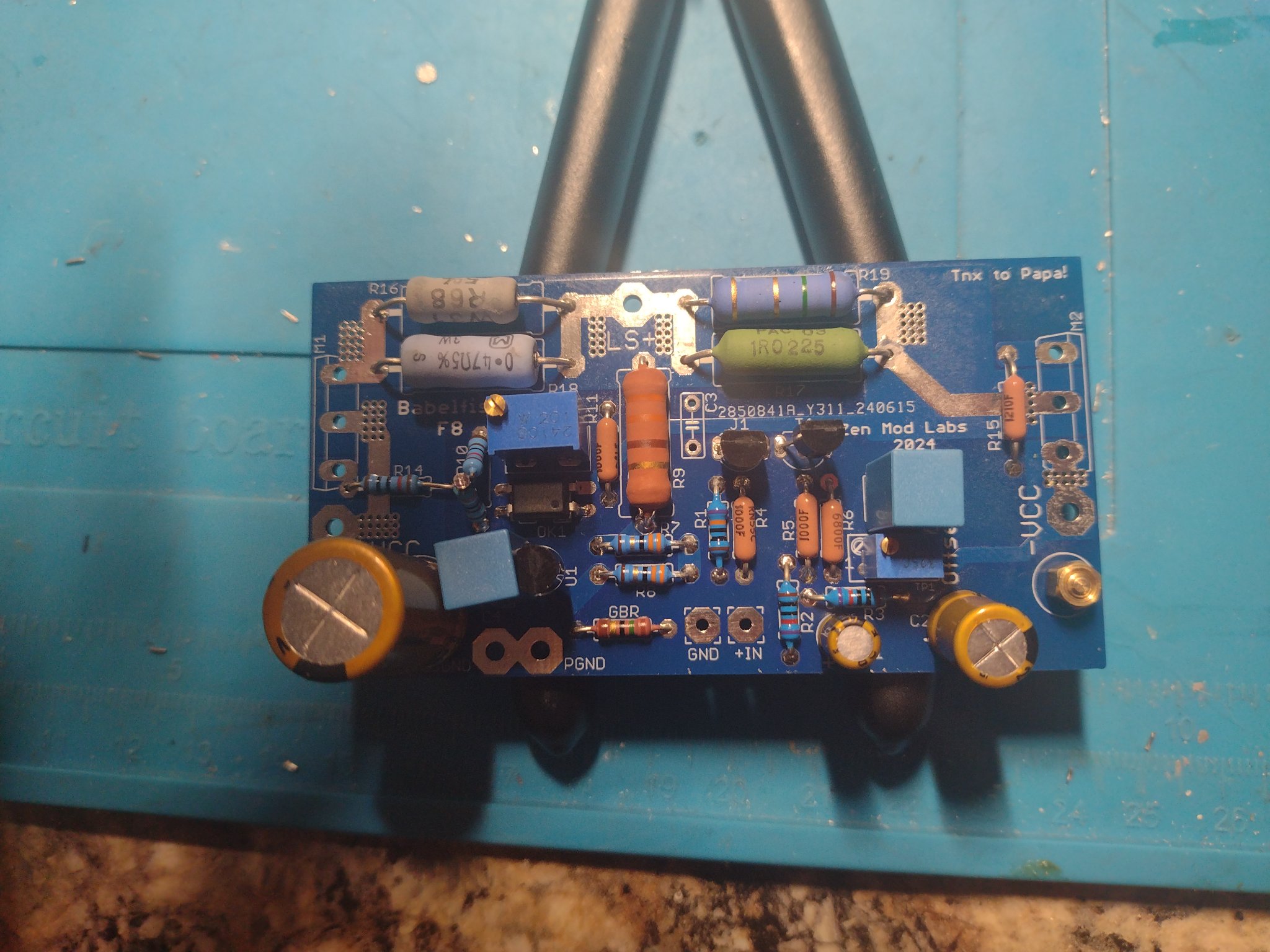

I have ordered some boards as I found the design interesting.
Very simple and with some gain. SE (2nd harmonic dominant). Low output impedance. Low THD. Large bandwidth.
One major difference from the original F8 is the "missing" output capacitors (symmetrical PSU).

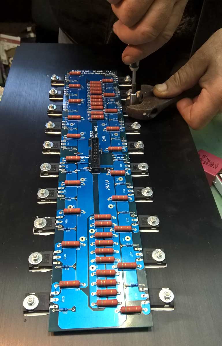

A practical question to prepare the build in my head:
What is the trick to know exactly where to bend the power transistor legs so everything fits?
I assume you mount first the two power transistors and bend the legs (90 degree or so) and then place the PBC and then solder the power transistor legs?
I have built some amps and don't recall bigger troubles with this so will probably succeed again 😎
If you look at ZM's drilling details in post #1, you will see that the distance from the FET mounting hole to the pcb lands for the legs is 20mm. So that basically means you bend the 3 legs at 90 degrees upwards at the point where the legs transition from the wider width to the narrow leg width.
I bend these first, then mount the output fets to the heatsink with M3 screws and insulator/grease. Then carefully lower the finished pcb over the 6 legs that are pointing up at you and push the pcb in place (I use 6mm nylon threaded spacers) and solder the fet leads to the lands on the front of the pcb.
Job done.
I see......thank you!
Will check my SJEPs when I find them to see if they have this "leg feature". If not I can set a little mark where to bend.
I will try not to have any mechanical stress at the power transistor solder joints when everything is mounted/soldered.
The Semisouths are the same. I hold the three legs with fine long nosed pliers at the point where the legs transition to the narrower width and I bend the legs up. That way you are not putting any stress on the legs next to the plastic fet body.
You might just have to tweak the legs slightly once the fets are bolted up to match the pcb mounting holes.
By the way, do not overtighten the fet mounting screws into the heatsink. 1 to 1.2 N/m is recommended if you have a torque driver. I do these up finger tight and once the pcb is on and soldered then I do the screws up just tight with a large diameter flat washer and spring washer..

for convenience, use appropriately sized adjustable wrench
for mica & goop, torque scwdrvr is not so important, while for Keratherm and Alumina pads, it is
