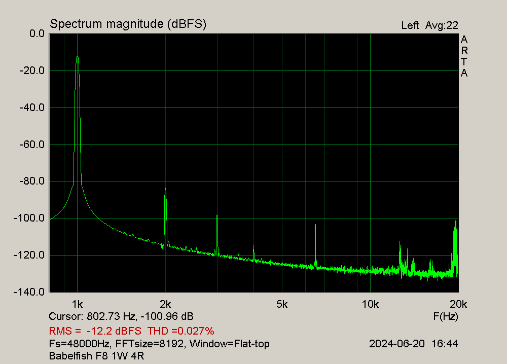

I looked a bit at the distortion measurements (MOSFET vs SIT) and tried to make some conclusions.
What I see is that if low output power (1-2 W) then MOSFET shows a little bit lower THD with a bit of 2nd, very little 3rd and then almost nothing else.
The SIT is close but also has a higher harmonic spike so not as clean as the MOSFET?
For high output power (15-25W) the SIT shows much less higher harmonics and lower THD.
Is that conclusion about right?

believe me - whichever you choose to build, if using proper speakers, you'll hardly hear any significant difference
there is difference, but I'm 158% sure - more realm of personal taste than anything else
and, there is a fact - no-one is building FW format amp, thinking of using it in near clipping domain
same as if contemplating how fun is 300B amp in 9W region
Yes, we normally listen to 0.01W - 0.5W ....and maybe 5W in peaks if playing loud using sensitive speakers.

I think it is elegant to use a symmetrical PSU for a single ended output stage to avoid the output capacitor. Most SE amps we see here has an output cap.
Ok....my SJEP is the 120R100 .....not 085.
But why does the SJEP show this 6. harmonic (or 7.)? ........it is some dB down so maybe not to worry about......will see if I can sleep after this...... 🙂
always take a look at broader picture
in this case, entire set of graphs, and also take in account testing setup - T-Bed deliberatelly less than optimized and tidy
so, glitch at 6K5 hardly being anything else than ........ glitch
