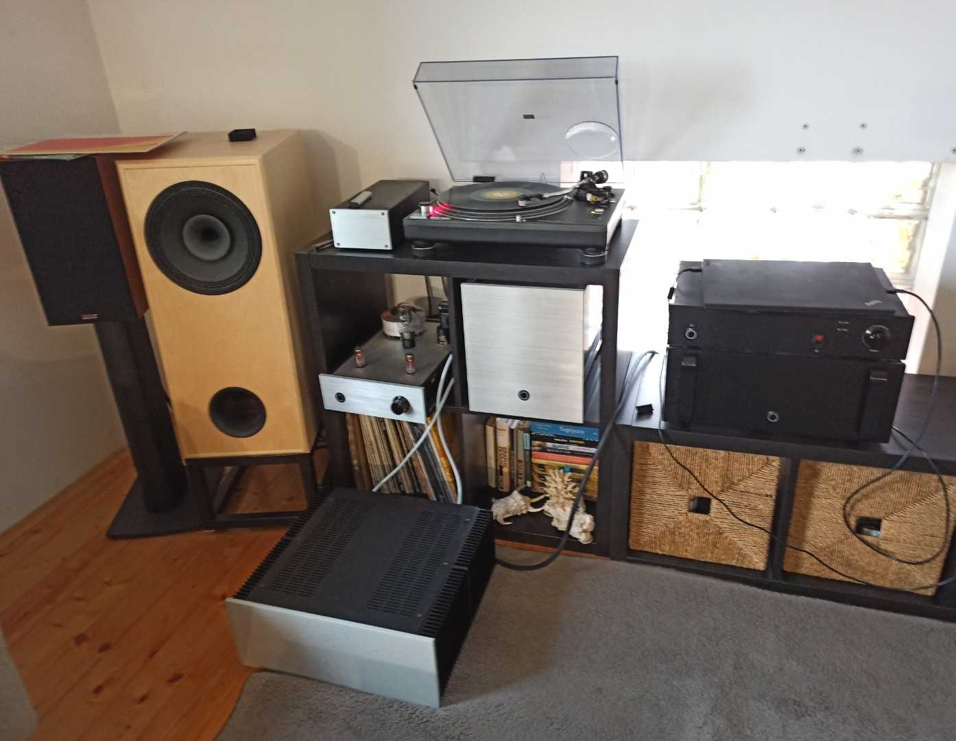

I am one of the few lucky ones who had the opportunity to build this amp.
Previous amp was Babelfish 2J, and at that time I though it was the best sounding SS (Solid State, but also reads SemiSouth) amp ever!
BF8 simply takes it to another level, again... The new best sounding SS amp until the next one 😀

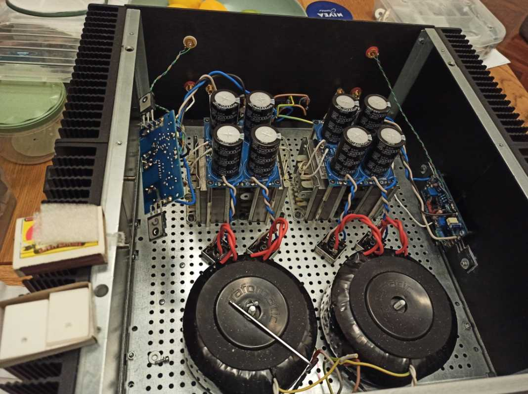

Bias settings? At (R17,R19) Just checking my math, 0.6ohms of resistance so I want about 1.08v reading across these resistors to get the 1.8A bias?
Here is the pudding...one picture from ceramic insulation replacement instead of mica.
and another one where we compared it to B2J
