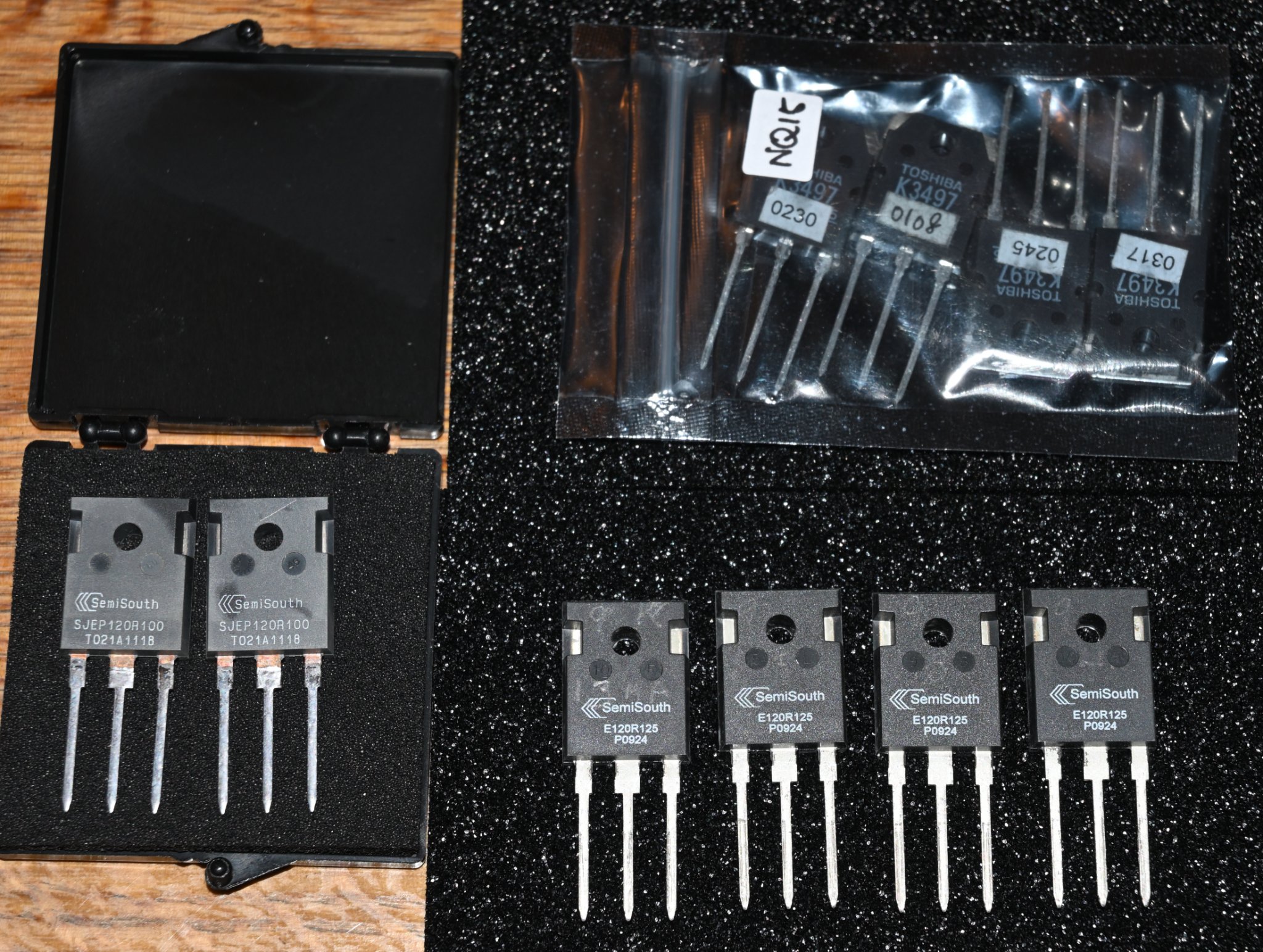

I found the small bag of SJEPs + some Toshiba's.
There are two R100 and four R125. On R125 is written 13mA on three of them and 14mA on the last.
The Toshiba's 2SK3497 was meant to be the current source transistor in a J2 build instead of waste SJEPs for that.
Think it was DIY name "EVUL" .....something like that.....that offered them matched for the J2 build. They are probably for no use in this build.
R100 or R125 for F8?

use pair of R100 for B. F8, leave precious's quartet for something in future ....... who knows what Guys can bring to the table

I will use the IRFP150 as Mu follower and the 2x120R100 I have.
I tested both 120R100 using the small Peak tester and both are recognized as N-channel JFETs.
One of them was recognized as "bi-directional"/"symmetrical" so tester could only tell which leg was the Gate. The other one the tester had a suggested for G,D,S. Probably these devices requires more "juice" to work as intended. For now I take for granted that both SIT's works 🙂

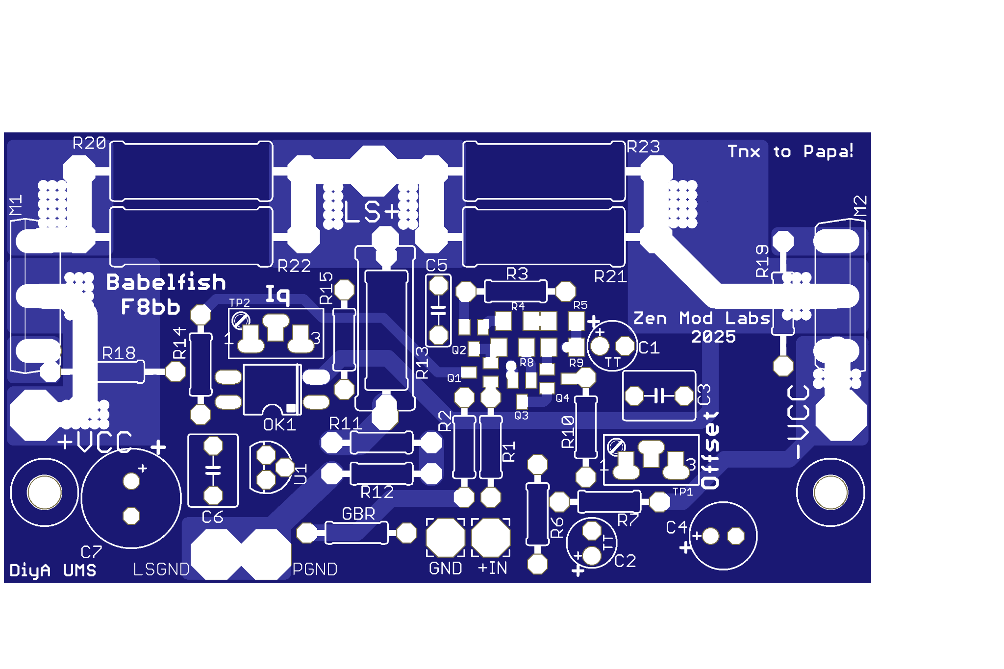

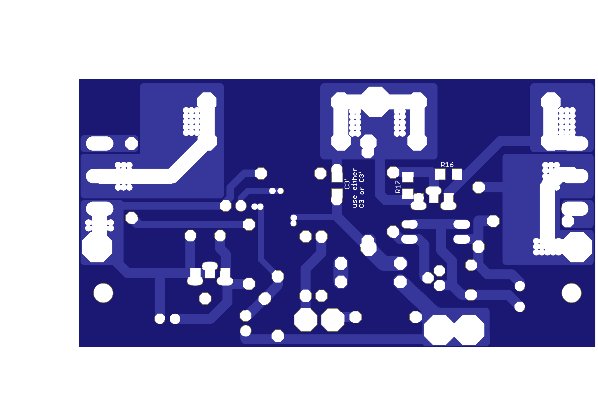

When we will be able to see new F8bb schematic? 😊 Someone have extra SJEP-s to offer?had an idea last night ..........
I ordered two sets of PCBs. One set with all components and one set with only smd's mounted (I am lazy).
I don't think ZM has mounted my boards yet......but who knows 🙂
But have anybody been able to see what the differences are between F8 and F8bb?
bb is a fun, will do reality check in week or so
