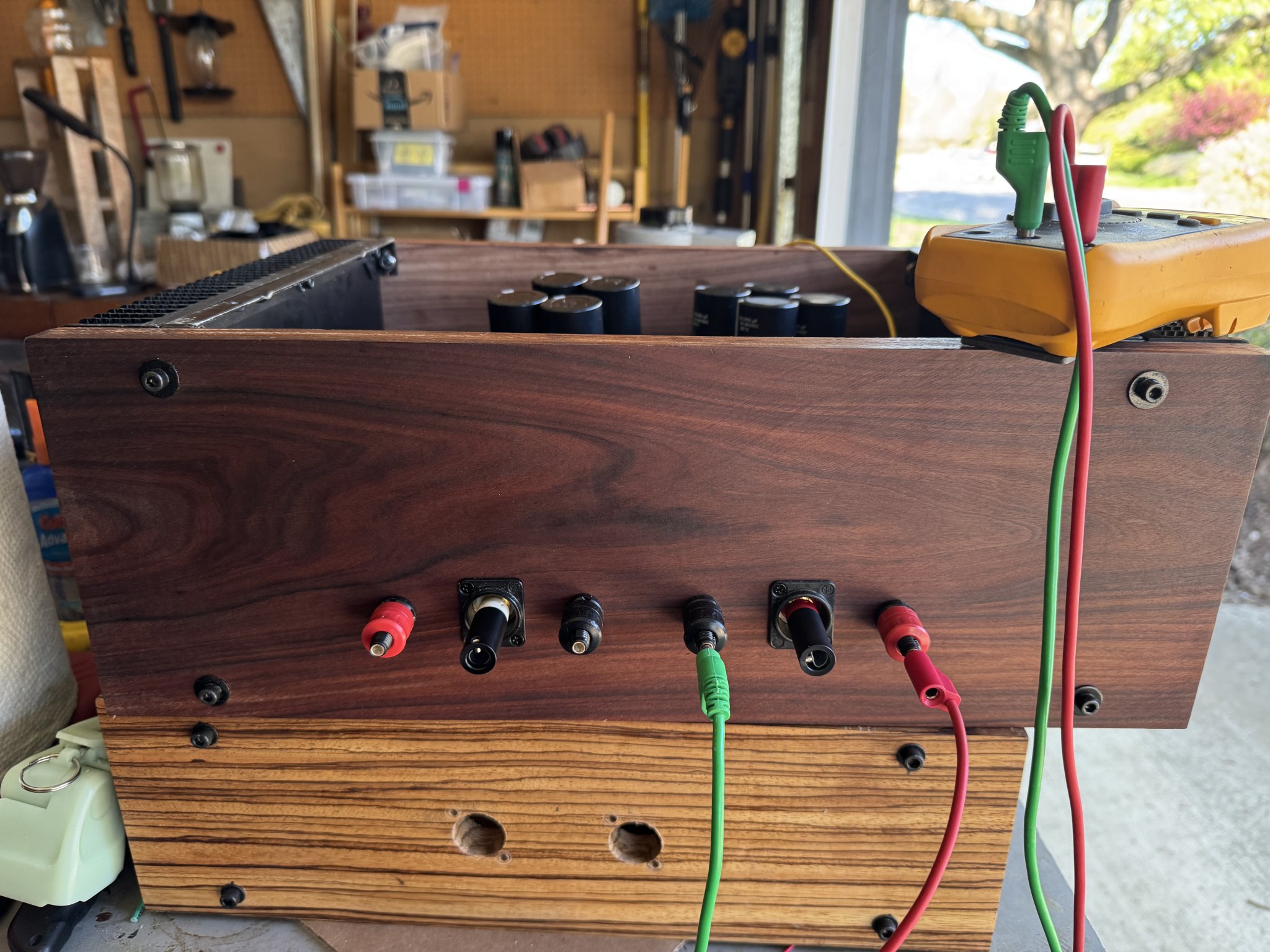

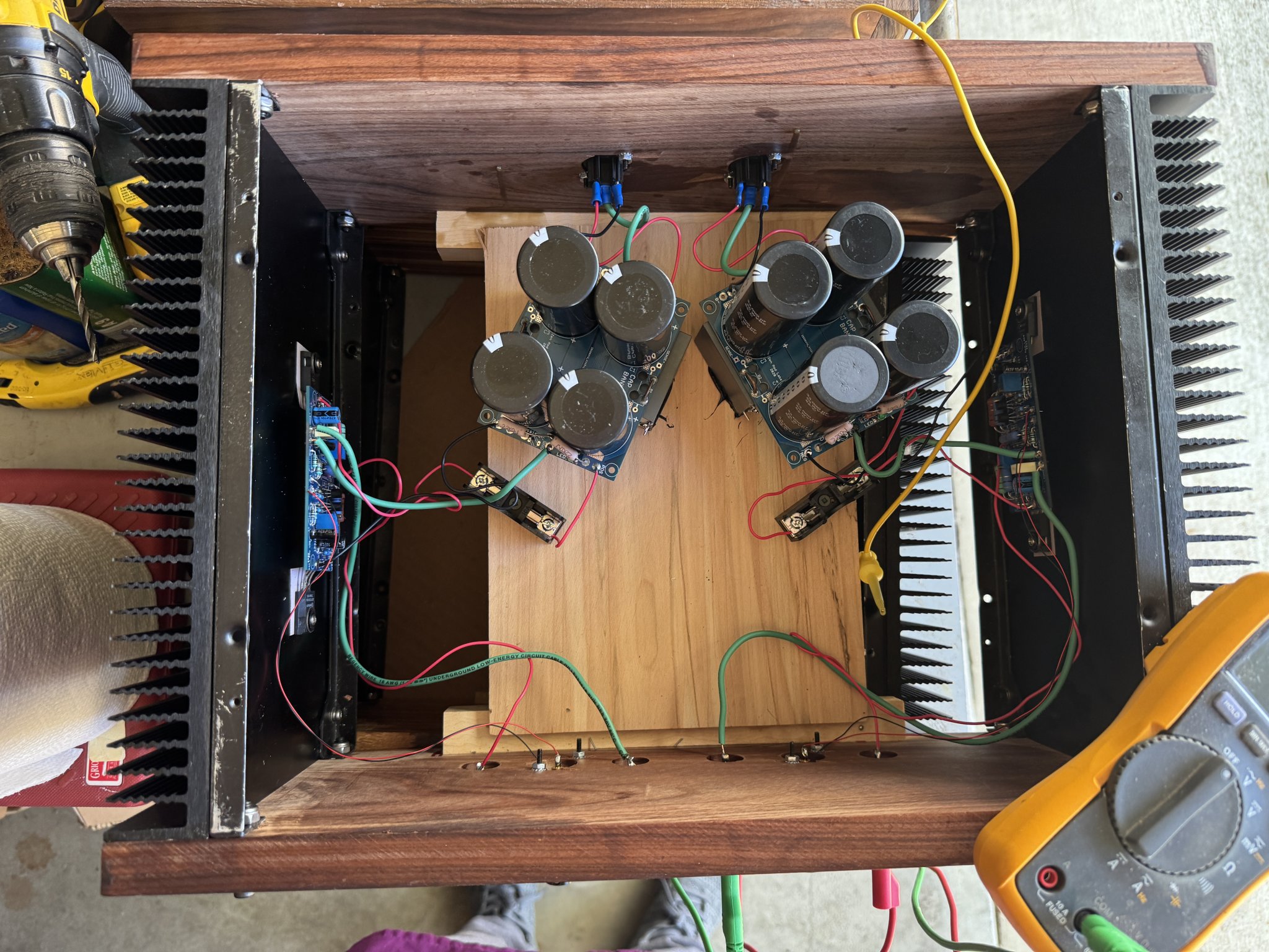

Got the F8 in my system yesterday - of course the sound is fantastic - it makes you want to listen !!! depth of soundstage. placement of instruments etc all there
Excuse the pics - I have a common PSU I use with all my 24V amps - CLC in box R from Powercon and another C in amp box
you are right - they all sound f'ing outrageous
