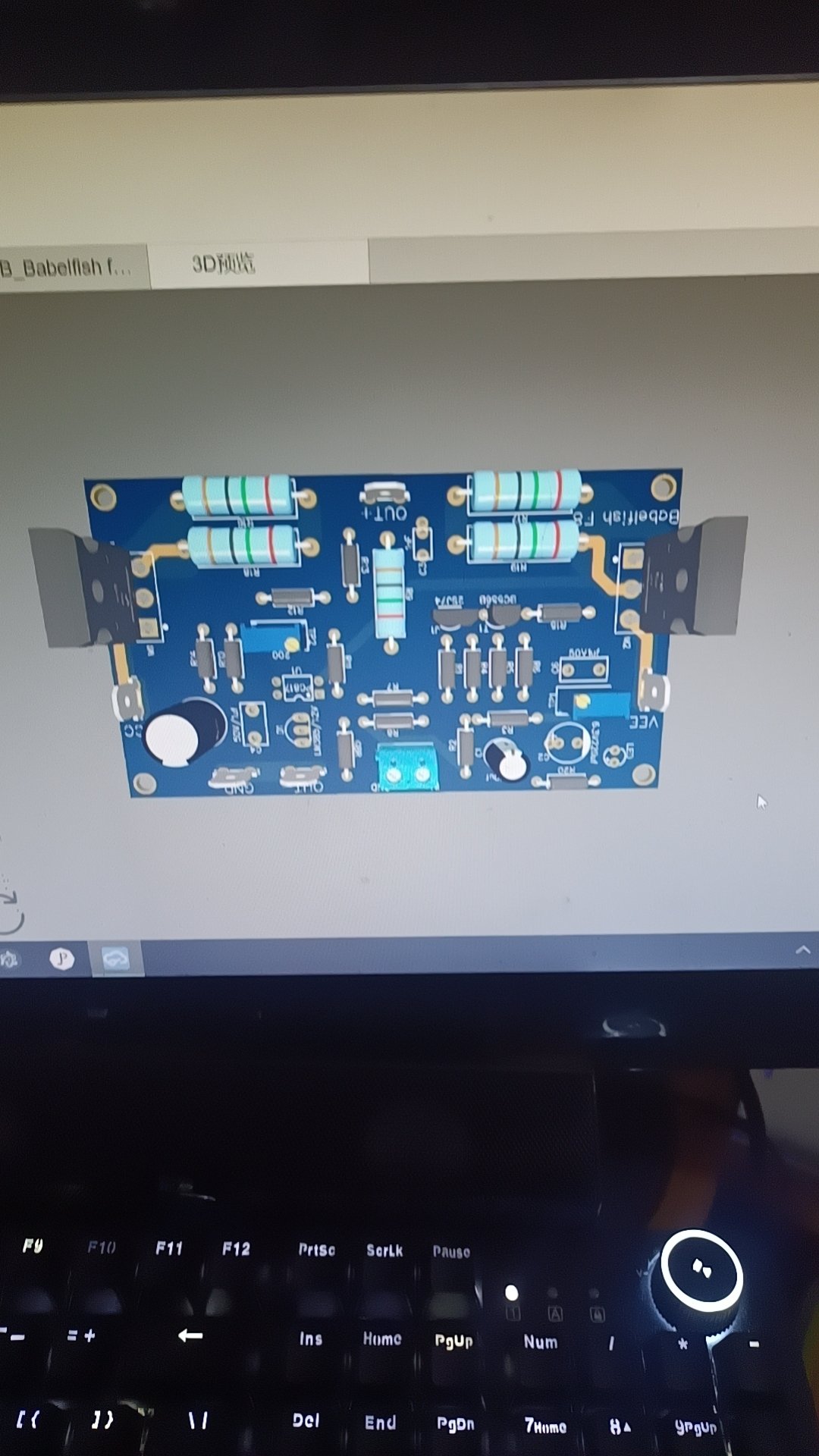

It is feasible to connect power transistors in parallel?
first make present amplifier properly
then, if you are able, try whatever you can to make it better; I can help with that too, but first thing first

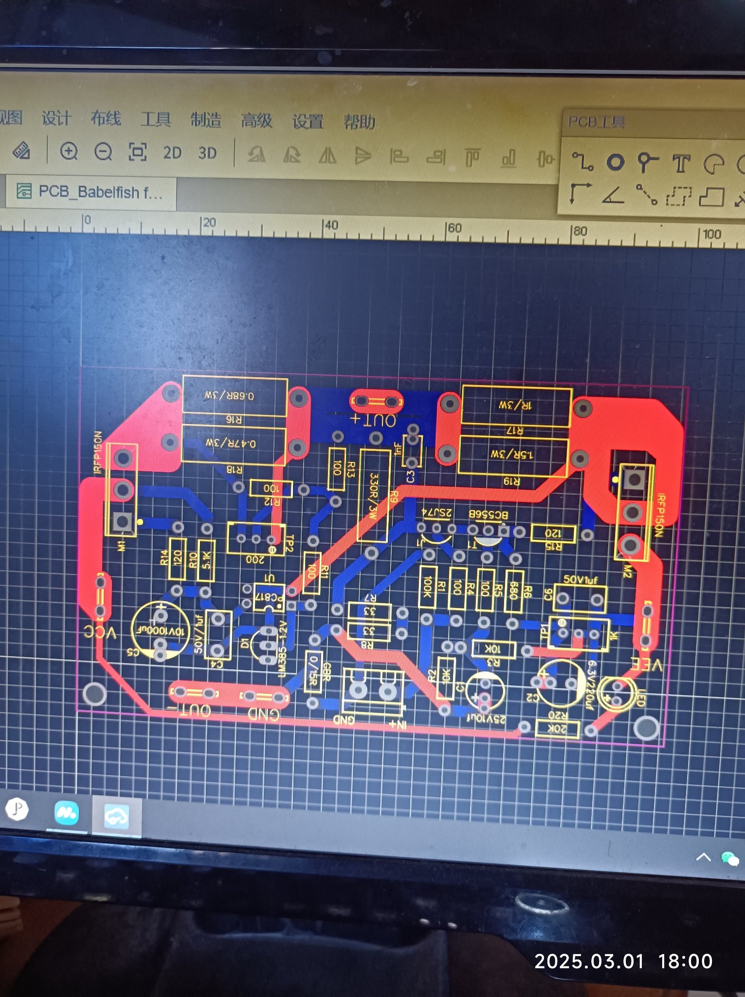

Sir, I don't think you've understood what I mean. Please forgive this lousy translation software. What I want to say is, can four IRFP150s be connected in parallel for the Babelfish f8?
they can, but with changes in circuit, and only after explanation what intended goal is
can you clarify, then, do you have amplifier already made by present schematic, properly set ( standing current and DC Offset)?
Yes, I made it exactly according to your schematic diagram. It works quite normally. The static current is set at 1.5 to 1.8 amperes, and the midpoint voltage offset is about 60 millivolts. At present, I think its low-frequency performance is insufficient, so I plan to connect four IRFP150s in parallel.
what you are trying to drive with amp, which speakers?
I can't see how is possible that amp is not behaving well, if combined with adequate speakers
post some info, and pictures of your build
