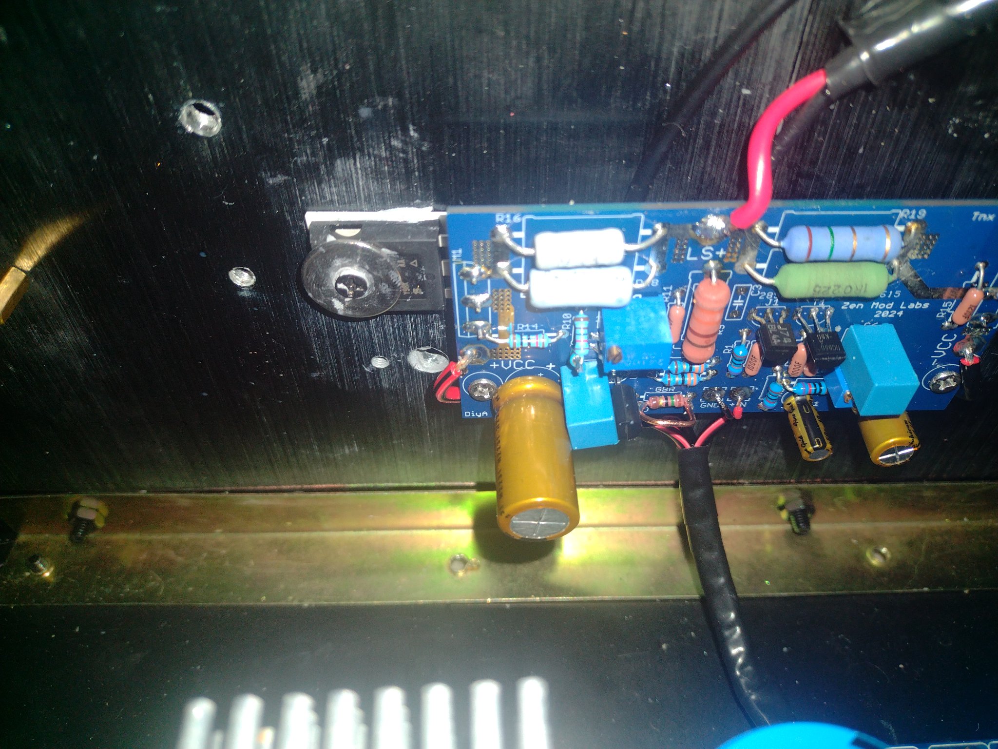

I was comparing the XA252 to the Babefish F8 tonight and noticed I had hum in both speakers when I put my ear to the driver. So just for fun I thought I would try what MEPER did and bypass the GBR, guess what, this amp is now the quietest amp in my collection. Of course your milage may very but it worked for me.
The 2 amps definitely have their own sound. To me the F8 sounds more focused and a bit softer in the treble, images slighty better than the XA252. Both amps tested with Iron Pre and Miro's ad1862 dac.

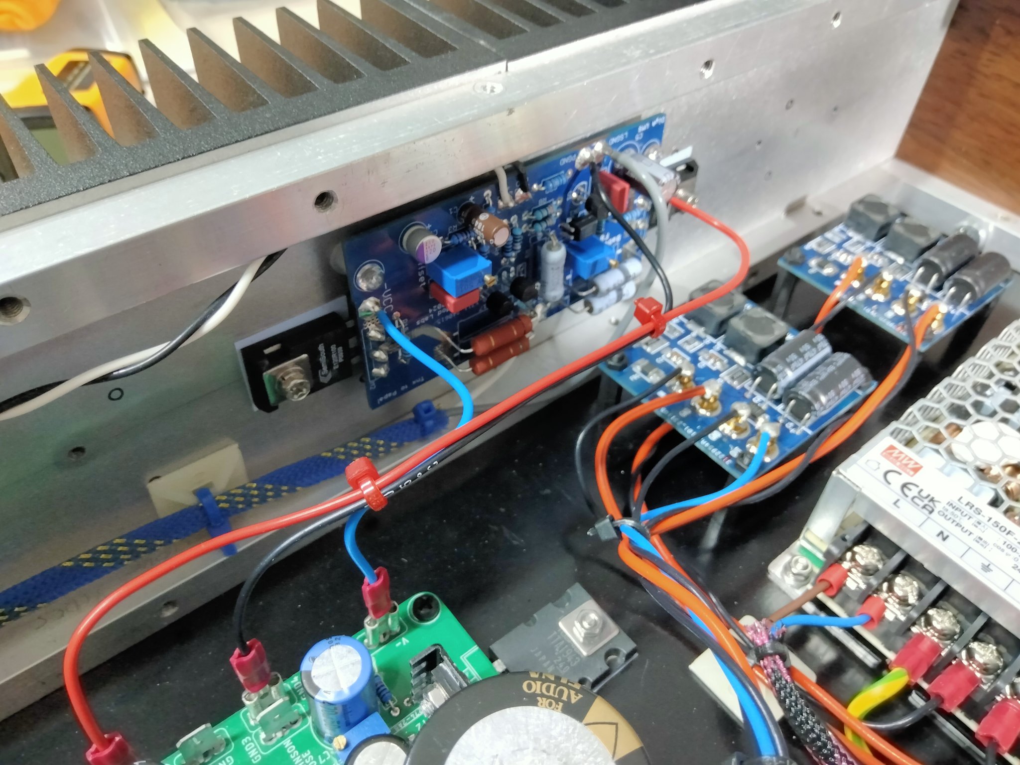

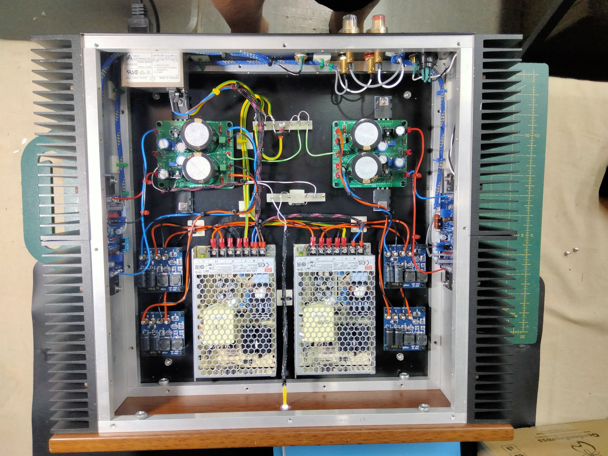

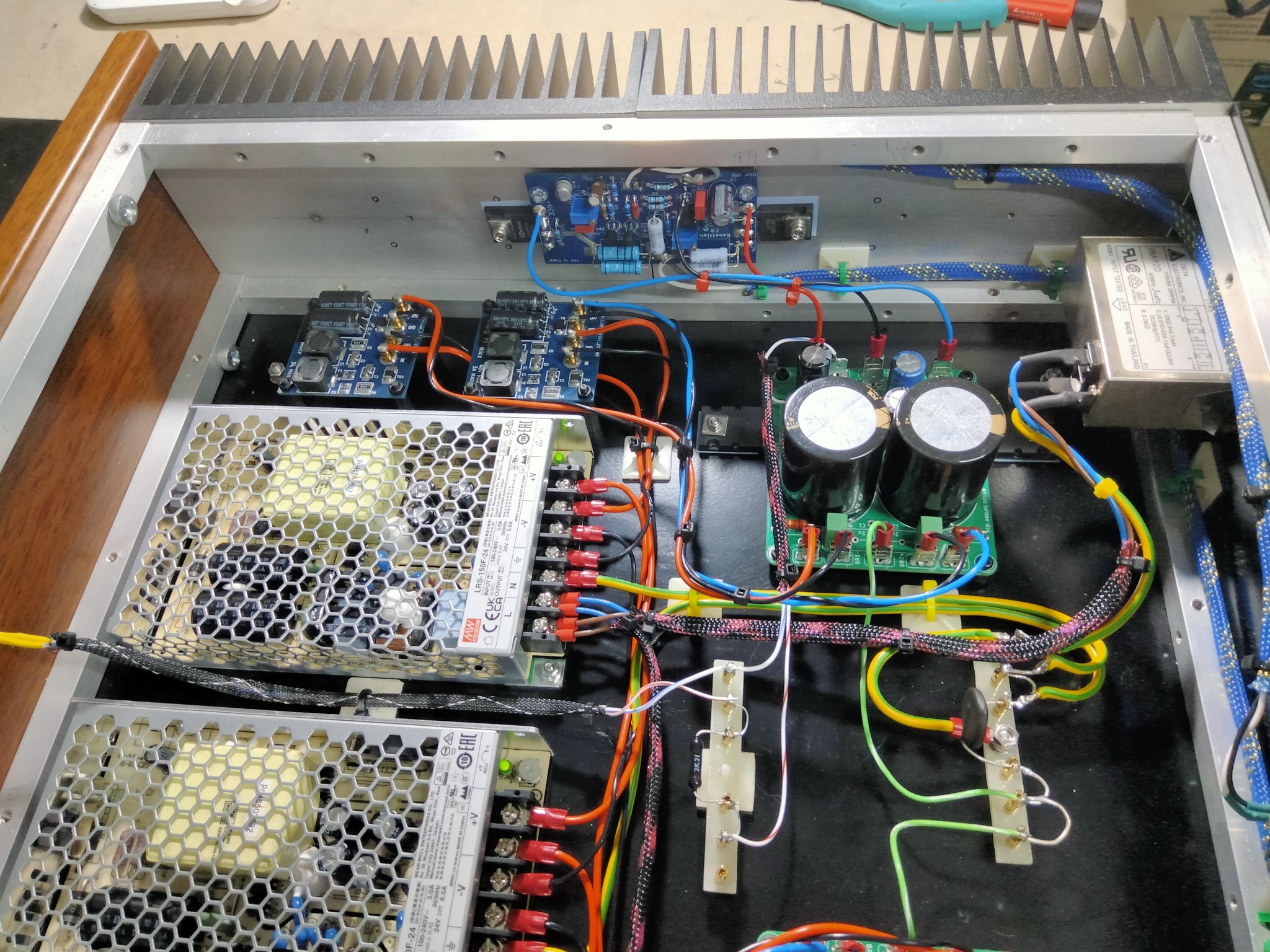

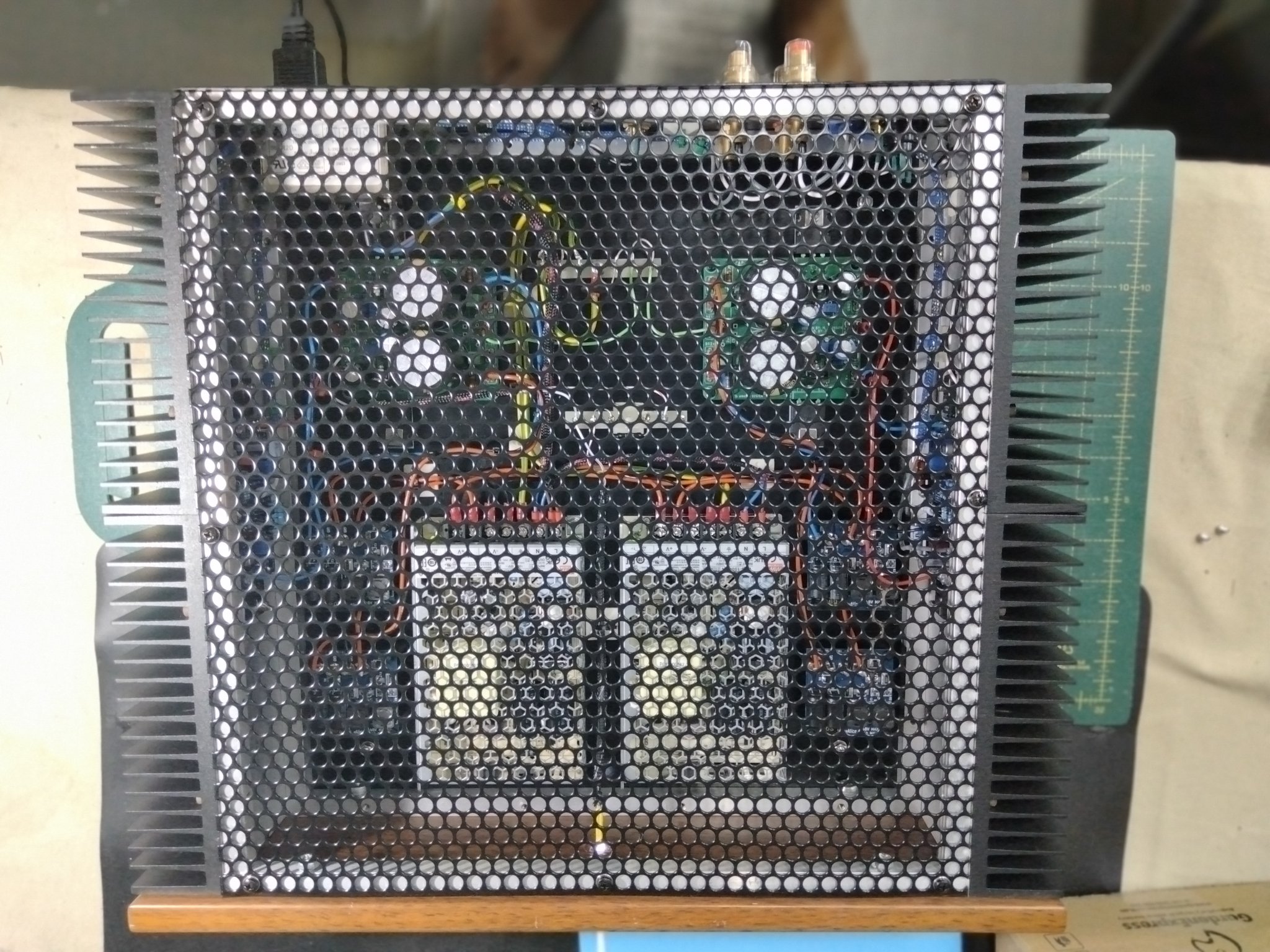

As I mentioned previously, using smaller heatsinks. Iq set to 1.3ADC, DC fails set to +/-23VDC on the cap mx supplies and the offset sits at less than 5mV after warm up. Heatsink temp is 50 deg C.
Yes ZM, sound is beautiful on the test speakers, will leave it there for a few more days to run in though and then recheck bias /offset.
Thanks for the comments.
Big thanks to Zen Mod, for the design, Mark Johnson for the Amy Alice SMPS filter boards and Cap mx circuit and member birdbox for the great wiring diagram using twin SMPS with 4 filter boards for dual +/- supplies.
very good, best that all are going to use switchers for PSU
