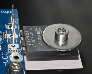

Looking over my parts list, casually making notes. I happen to look at test bed pics on the first page...
What is the story behind the 1 Dinar washers!? Are these that extra bit of magic I will be missing from my F8 build?
Is it acceptable to drill a few Loonies and fasten to mine or is this a Babelfish trademark?
it's just that I was once short with big washers, I knew that I couldn't get them from local store, waiting for order and delivery logically out of question ........ so I've just took 30 or 40 dinars over to bench drill
