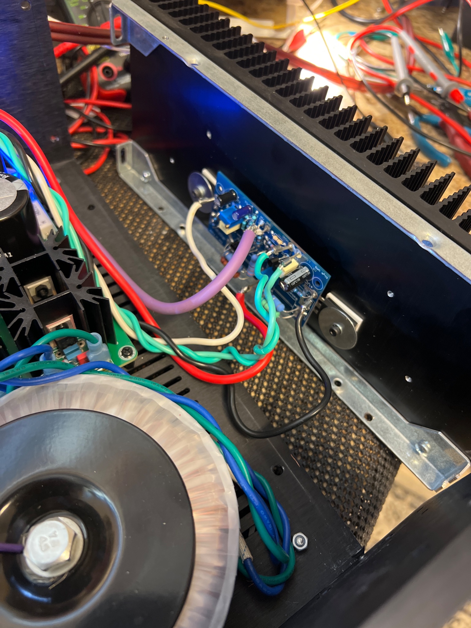

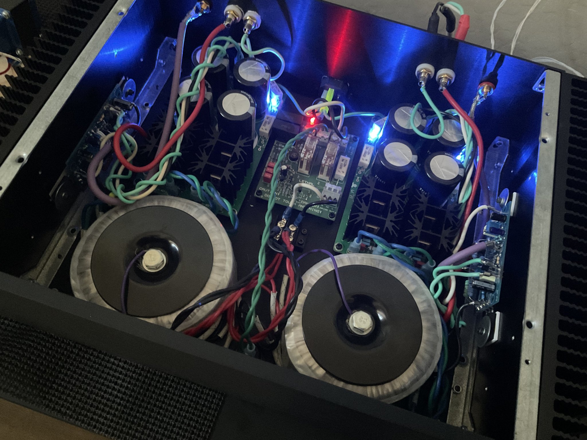

One channel running….
Reactions: birdbox
I took a break after getting one channel running. Sounds very good on the Radio Shack Minimus 7 shop speaker, which is a speaker I have listened to for 35+ years. If it sounds good on that speaker it’ll sound great in the main rig.
I’ve got Iq at ~1.5A and with the 3U is all the idle current I want. I will run squares and distortion measurements at some point…..
Reactions: tonyEE and birdbox
