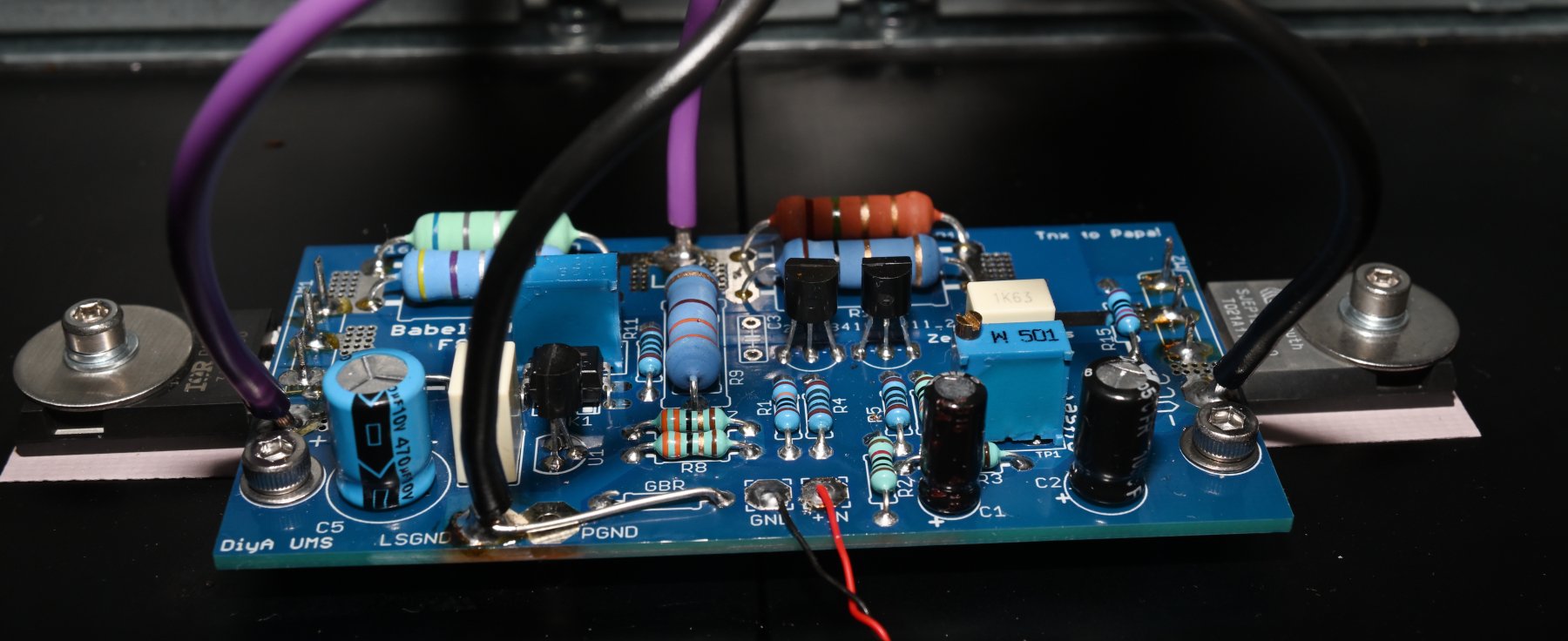

I used a 10R 0.5Watt metal film resistor for the GBR position..
The amp is dead quiet with no hum or any other noise, not even a turn on thump at start - probably due to the slow ramp up Cap Mx in the PSU.
This is the psu that feeds the dual supply cap mx boards (1 for each channel). Thanks to member birdbox.

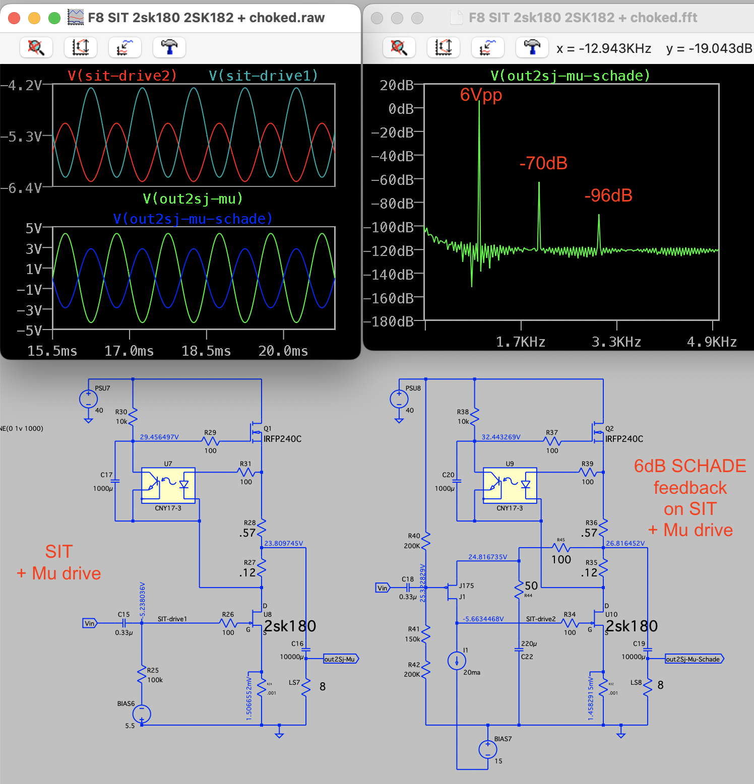

Right now I have a choked 2SK182, common source. Choke is BIG and weights almost 2Kg. Great sound, see my avatar for the distortion spectrum . .
I am thinking of adding a Schade feedback to that. [Like always. Just for fun. Just as a PASS-time.]
To get there I first show the circuit I saw, added here (somewhere). This is F8 MU-follower with Schade feedback with a SIT or power jFET (SJEP...). The feedback is the trick. So how to configure that?
First, the Mu version, left, of this F8 reference: and then right, Fb added : 2nd H is -70dB with (6Vpp).
Left Spiced reference mu driver. The CCS needs to be big (not a resistor) as the SIT needs current capability; so I took here 20mA. [10 might not be aneamic yet.] Current right should be increased somewhat.
My goal is to see how such Fb would work on a choked amplifier. "Naturally I look for any opportunity to improve the performance of a circuit, and because I don’t mind throwing away a little gain, I considered using "that harmfull" (Schade in Dutch means harm.
Hmmm. Too bad...) negative feedback on the circuit." And that will not be an F8, just a Shady Ben.

I just made the GBR in one channel = 0R and that cured the hum. No hiss either from the tweeter with ear 2 cm from dome.
It was really an extremely dramatic change so now one amp is playing music. Iq is just below 1.9A (1.125 V over R17/R19). Rails are -+24.3VDC. I use a power plant so mains AC is regulated to 230.8 VAC.
I don't hear any power-on / power-off sound. My speakers are 94 dB in sensitivity.

After removing the GBR I made the solution below so I only needed to suck up one hole.
That is often the worst part if space is limited to suck up the solder after removing a component so holes are ready to accept a new component.
now, there's a trick; Herr Schade never had intention as we are having now - using his name and tricks to mimic triode with non-triode-like part ........ his tricks were made for bettering entire circuit, in most cases much better than simply changing parts in no-nfb circuit and hoping for best; I mean, guy was a Scholar and Engineer, for start
as a matter of fact, any sort of feedback is in general changing transfer function of entire circuit in a way that it can easily resembles having triode in circ, even if there is not one
so ............ call it as you like, but I confess that my predetermined and twisted mind first acted thinking - wtf is now with making triode more triode ...... using Schade feedback on SIT part
anyhow, if you like it, go for it!

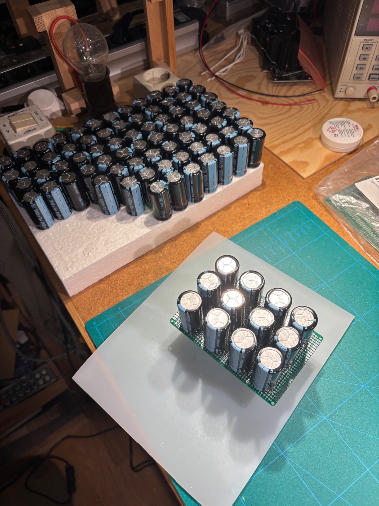

I slammed in 6x6800 per rail for a test rig. Maybe a tad to stressful for the average 150 VA tranny no?

For my F8 where i reuse PSU for the M2X I use CRCLC configuration. The CRC is 2 x 33mF for each C and the last C is 33 mF (for each rail).
This gives me very low ripple for 1.4 - 2 A Iq.
I don't think you can say more is better as the high peak currents through rectifier creates noise and transformer should be able to handle it also.
It also depends on Cap ESR how "wild" it gets and which configuration you go for. CRC og just C 🙂
Yea, I don’t know the ESR for those Jamicon 35 v 6800 uF, and I can’t measure them either with any instrument of mine. But I have s**tloads of them so I thought I could make some modules for testing trannys and PSU configs.
Probably those Jamicon is not very low ESR but "just" fine general purpose caps. There are mixed feelings about them. I have no bad things to say about them. I have some smaller ones I use now and then for PSU filtering. They also measure fine using a prof LCR tester. According to their own web they are very good 🙂
